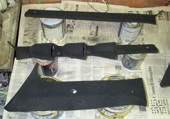

Here's a bit more flocking I've done tonight - the A and c pillars - the drivers side A pillar has also 3 guage pods grafted onto it.
http://www.elsamak.karoo.net/pillar2a.jpg
Enjoy
Joff

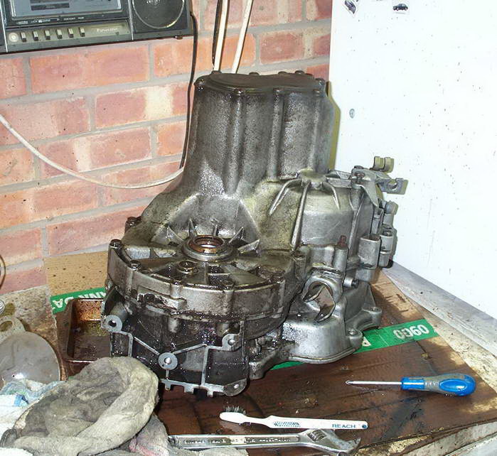

As my engine is nearly ready to be installed - just got to rebuild it first - I thought I would get the gearbox situation sorted .
It was all covered in cr@p after 5 years in my nova -
http://www.elsamak.karoo.net/F28-1a.jpg
So set about stripping all the crud off with some gnuk type stuff and after a few hours work and some new gunmetal grey paint we have a nice clean ready to install F28 six speeder :-
http://www.elsamak.karoo.net/F28-2a.jpg

How did you mount your 6 speed mate? As it looks like you still have the standard nova mount on the chassie?
Keith
lovely.....................i'm lookin 4ward 2 the end result
just what i thort? i hadto chop move and weld my new mount onQuote:
Although the mount on the chassis leg looks standard ..... it isn't !!!
The original leg nearest the bulk head was chopped off and rewelded on the otherside of the leg (about 1.5 inches nearer the cross member) that was left in order to clear the bulk of the F28 box. A bespoke mount was then made up to connect the gearbox to a TAS group N rubber and the chassis leg.

You also have to remember that when I originally did the F28 conversion back in April 1998, there was only one other nova in existance with the F28 (Andy Windsors citrine yellow one) and he was somewhat tight lipped on how he fitted his box so it was a bit trial and error on the fitting, the linkage and the tiebar clearance issues.
Also it was only Courtney willing to help with the speedo problem and the fitting of the F20 speedo drive ring on the diff.
Having now looked at the kits available and other peoples ideas I would do what Rick Draper has done and weld a drivers side mount onto the passenger side chassis leg and make a bespoke mount to this.
Joff

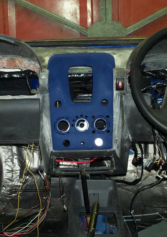

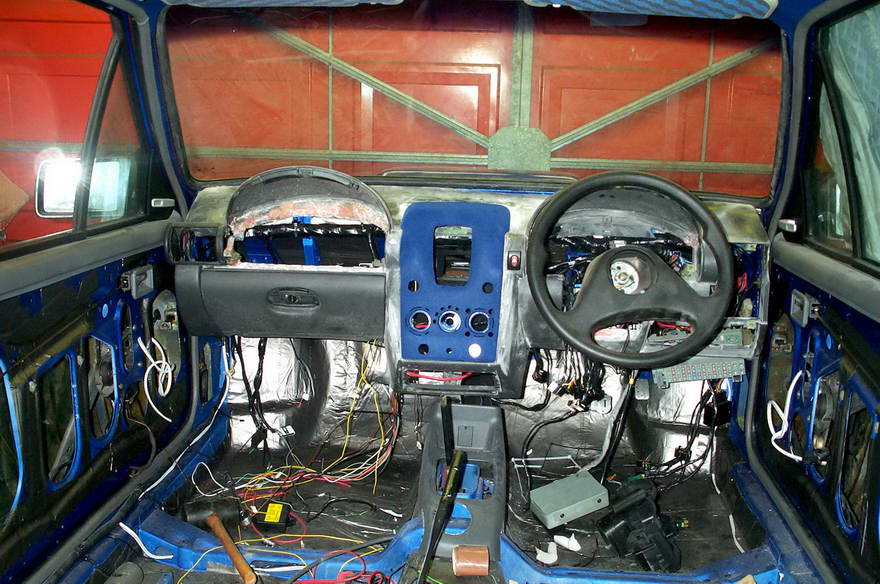

I have now flocked my central section of the dash in my nova - here's the results :-
http://www.elsamak.karoo.net/centre3a.jpg
http://www.elsamak.karoo.net/centre4a.jpg
Just need to flock the rest of the dash grey and were getting somewhere!!
Joff
looking excellent mate! whats going in seat wise?

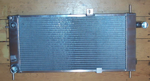

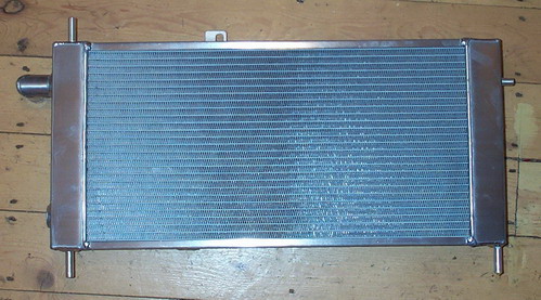

Radtech have been very busy for me making up a new radiator which has a thinner core than standard but higher density of vanes making it as efficient. This is so there is more clearance behind the radiator where the turbo lives as it is very tight in there!
Front
http://www.elsamak.karoo.net/Rad1a.jpg
Rear
http://www.elsamak.karoo.net/Rad2a.jpg

cool, love the rad,
How much did the rad set you back?
Nice rad, should reduce heat soak as well with a bit of luck!

Joff, where you planning on mounting your rad fan? front or back? which fan have you gone for?
Simps.
Twin 10"Kenlowe :-)
