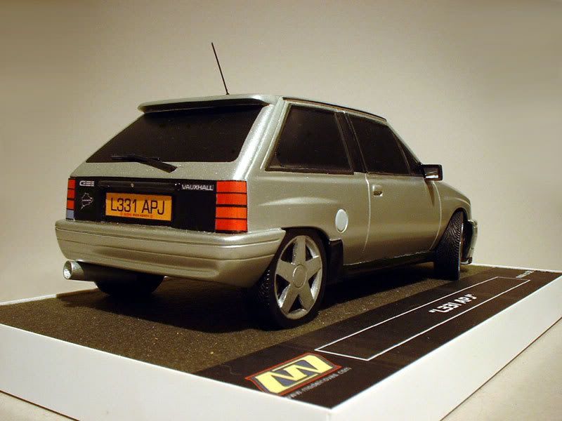

nah - just finished 4 models though - theyre generating cash for the Christmas budget.
heres a few pics

models are made of resin - the shell is one piece (minus the wheels, exhaust, grill section, bumpers and skirts). i then made indiviual sections (bumpers wheels etc), took molds and then use resin to make the various parts.
Its then a case of clean them up and bond it together (easier said than done!).

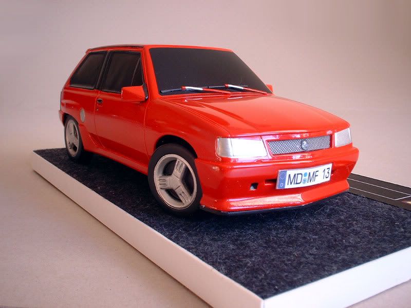

James - re the models - I made a "master" model and then took a mold using silicone rubber. I'm currently on my 3rd master (I keep making tweeks to it as I go). The master was initially made out of balsa wood (to bulk out) then overlaid with a modeling material called super sculpey, followed up by plastic detailing (windows etc). Ive been doing it as a hobby for a few years - more as a side line to fund my nova rebuiltd addiction (its a monkey I will shift off my back eventually!). It also keeps my hand in with model making - a drgree course I did at uni and want to get back into - eventually...
As well as the main body shell, I also made separate body kits including mk1/2 bumpers, various styles of mirrors, mk1/2 front grills, lots of different alloys, mk1/2 spoilers and some front/rear splitters - molds have been taken of these as well.
The models are made out of casting resin taken from the above molds. I start with the basic shell (the nova body) then add bumpers, front ends (mk1/2) and side skirts as well as any other detailing like mirrors, alloys, wipers etc. Each cast is poured by hand (time consuming).
Each model is sprayed in original vauxhall colour paint. They are then mounted on display stands.
The amount I charge mainly covers the time it takes to make them, materials (resin, paint primer etc) and packaging andnext day delivery. Time is a big factor - I toyed with setting up a small business and getting the parts made professionally but because each one is custom made and unique to that particular model (no 2 cars turn out the same) it worked out too expensive - at the moment I have a full time job, full time wife and other projects (me nova being one) so I only do it as a hobby.
I usually only make a few a year - mainly because of the above commitments and also because I'm lazy! Also it keeps my nova on the road (as well as allowing me to buy more resin).
