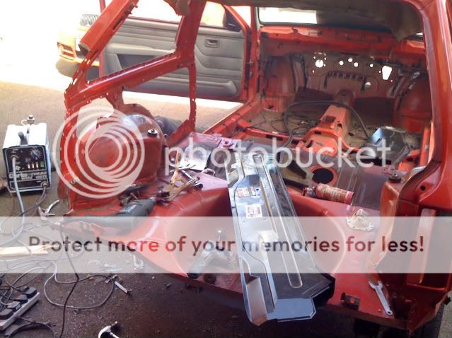

so what im thinking is to cut the centre out of the rear floor section, repair the inner rear wheel arch, brace the rear substructure then repair the other side then fit the boot floor, then replace the rear chassis legs?
any better ideas?
i'd rather start at the rear ( ooh err ) as this would be the hardest section and the most probable to go wrong,
any input is welcome ( apart from reshell comments )
Are you fitting the whole new floor then ?
As you might want to have the rear lower edge of the quarters off to access that area if you are
If I were doing it I'd somehow be thinking of doing the floor, legs and inner aches with the rear panel still on for some support,
DO NOT GIVE IN THO !!!!!!!!!!!!!!!! GET IT DONE :d lol
Triangulation is best, I would weld in some bar/box section to maintain the shape of the rear of the car.
Prob best to weld to the roofs inner side strengtheners and join to the opposite side inner quater and arch etc. Use multiple bars front to back and measure everting befor you start cutting just in case you get some movement.
I reckon before you get to this stage you want the floor legs and inner arches all done
http://i499.photobucket.com/albums/r...S/IMG_0264.jpg
cheers lads, i am fitting the full floor Edd, rich i was going to weld a rear strutt brace between the rear turretts and a triangle form each turrett to the opposing roof corner as you say, measurements will be plenty as i dont want any flex as this would spell disaster, i have rear inner arch panels as templates to repair the sections and the rear panel will still be in place to hold ech side together,
as you can understand nobaody has removed and refitted a full boot floor and rear chassis legs before so its a little frightening lol

IMO if you have the bracing done as you said it's time to crack out the drill mate, get the legs and floor out and go from there
