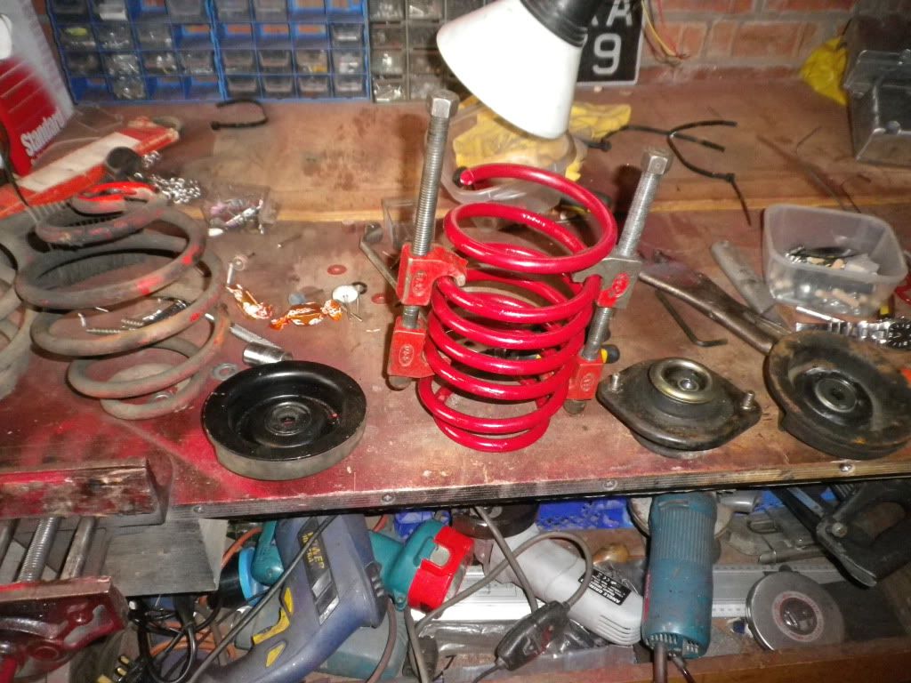

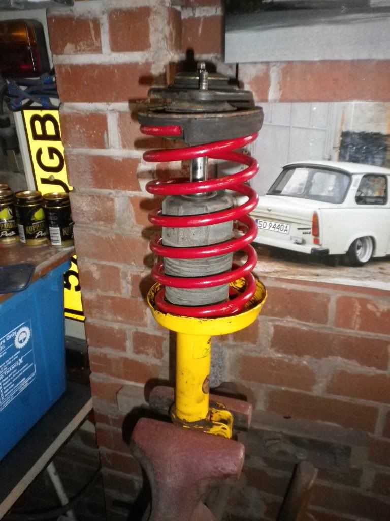

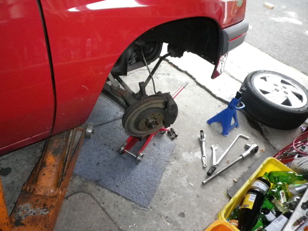

so crossed a couple of things off my list today, fitted the -60 springs i got from shaun and replaced my SOLID mount with a competition one....
in bits:
http://i71.photobucket.com/albums/i1...a/IMGP0800.jpg
old vs new:
http://i71.photobucket.com/albums/i1...a/IMGP0801.jpg
add this:
http://i71.photobucket.com/albums/i1...a/IMGP0802.jpg
get this:
http://i71.photobucket.com/albums/i1...a/IMGP0804.jpg
Rinse and repeat for the other side and the back and you get this:
http://i71.photobucket.com/albums/i1...a/IMGP0805.jpg

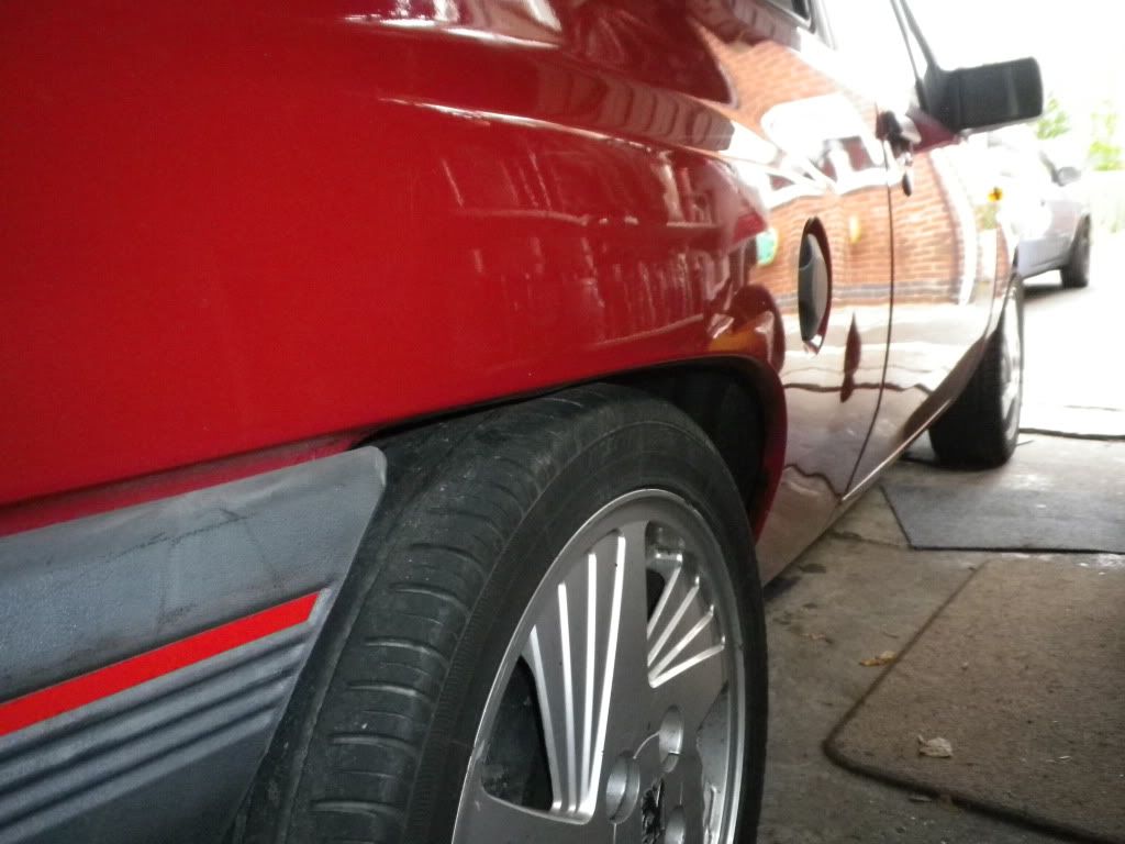

its seemed to have made more difference on the back but the car still sits right so meh (a tiny bit of rake, just right).
lowering it that bit more and cranking up the dampers (ive turned them up to half way) has made a big difference.
easier to see the amount its dropped by in the garage so heres the gap before:
http://i71.photobucket.com/albums/i1...a/IMGP0798.jpg
and after:
http://i71.photobucket.com/albums/i1...a/IMGP0799.jpg

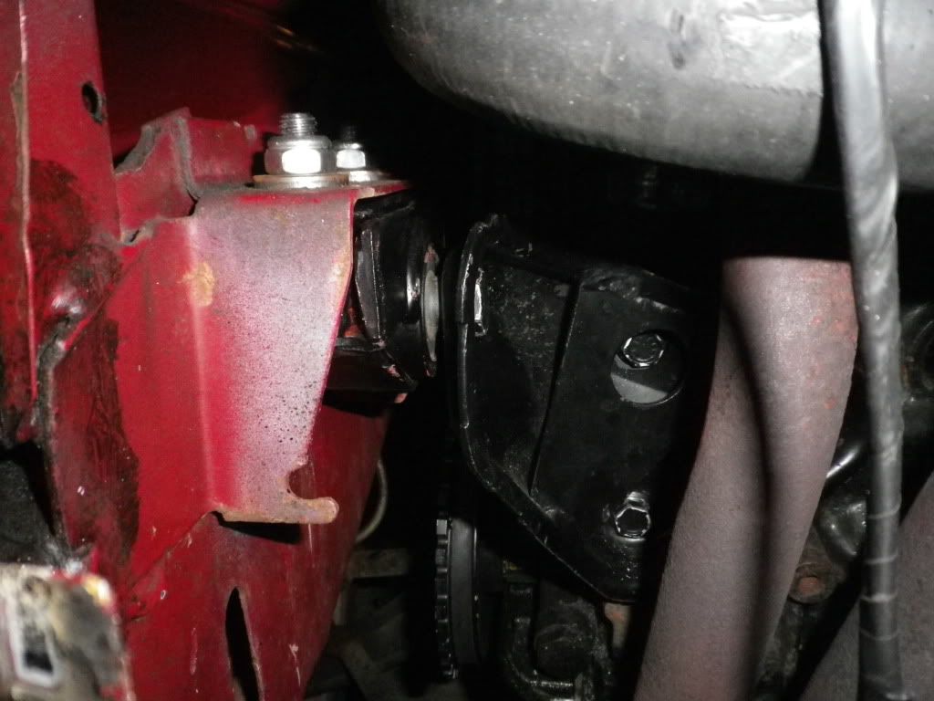

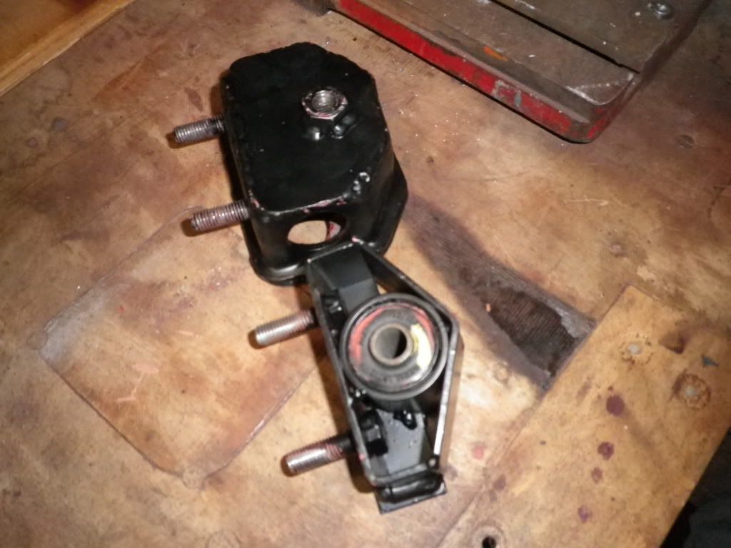

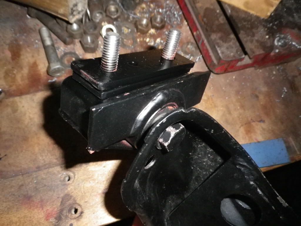

Decided after that to just quickly swap over the drivers side engine mount, so whipped the old one off, ssat it next to the new one.... hang on.... spot the difference...
http://i71.photobucket.com/albums/i1...a/IMGP0819.jpg

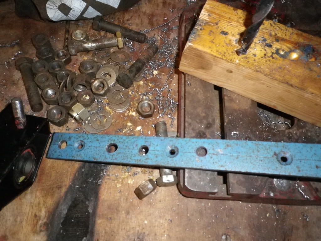

being as i already fiddled with the mount to get the engine level this wasnt gonna work, so found a bit of decent thickness bar kicking about - drilled a few holes (bloody hard stuff as well)...
http://i71.photobucket.com/albums/i1...a/IMGP0823.jpg
to get this:
http://i71.photobucket.com/albums/i1...a/IMGP0825.jpg
bolted up lovely:
http://i71.photobucket.com/albums/i1...a/IMGP0827.jpg
has made such a difference to the noise inside the car, its like ive fitted another silencer... or a different engine - will get the rest fitted at some stage, but no rush now.
looks beter lower matey much beter!! also im liking the hilman imp on your poster lol
cheers mate. the poster is a trabant tho! theres an imp on the pic above it tho - how did you know that?
finally got it lowered (slightly)
bet it makes a huge difference ?
yeah it does mate - it feels much more confident when chucking it about - and the engine mount - feels like a different car!Quote:

Looks good, what make were the springs you got?
Wonder why the solid mount was different - made for a big block mount?
im told theyre hottuning/jamex ones - they (unscientifically) feel stiffer than the spax ones that came off and definately feel stiffer on the car.Quote:

i dont know mate - but i didnt think about them being big block mounts so you could be right there! its all good with the spacers on though!
