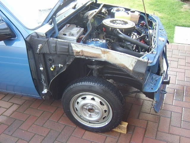

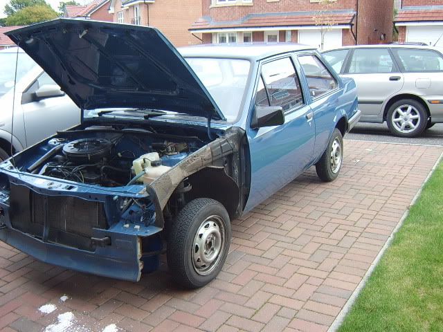

Removed the front end and stored parts as I went along.
http://i73.photobucket.com/albums/i2...l/wingsoff.jpg

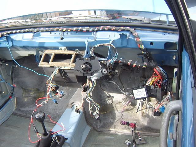

Dashboard was next to come out.
http://i73.photobucket.com/albums/i2...l/dashout1.jpg
http://i73.photobucket.com/albums/i2...l/dashout2.jpg

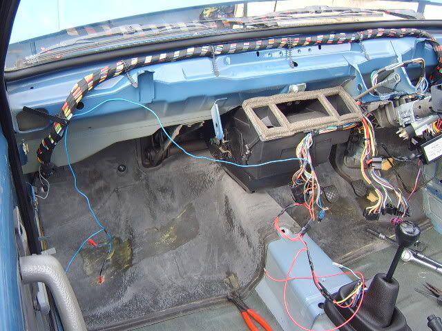

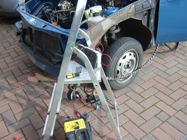

And to round off Saturday disconnected the interior wiring loom, pulled it round to the front of the car so I could check that the rev counter worked. Earthed the loom to the slam panel, connected a wire from the coil to the rev counter.
http://i73.photobucket.com/albums/i2...untertest1.jpg
Started the engine with a screwdriver and hey presto a working rev counter.
http://i73.photobucket.com/albums/i2...untertest2.jpg
Well Chuffed...

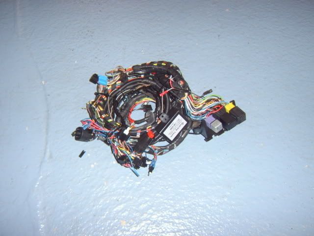

Tonight, removed the loom from the car and set about making my rev counter wire.
http://i73.photobucket.com/albums/i2...terwiring1.jpg
Positioned the wire where it would connect to the rev counter and ran it into the loom to a redundant wire that would normally feed the bonnet lamp. Where it comes out the other end, cut back into the loom to splice with the green coil wire. All taped up and tested the curcuit.
http://i73.photobucket.com/albums/i2...terwiring3.jpg
Job done.
Coiled up the loom to store away.
http://i73.photobucket.com/albums/i2...ngcoiledup.jpg
