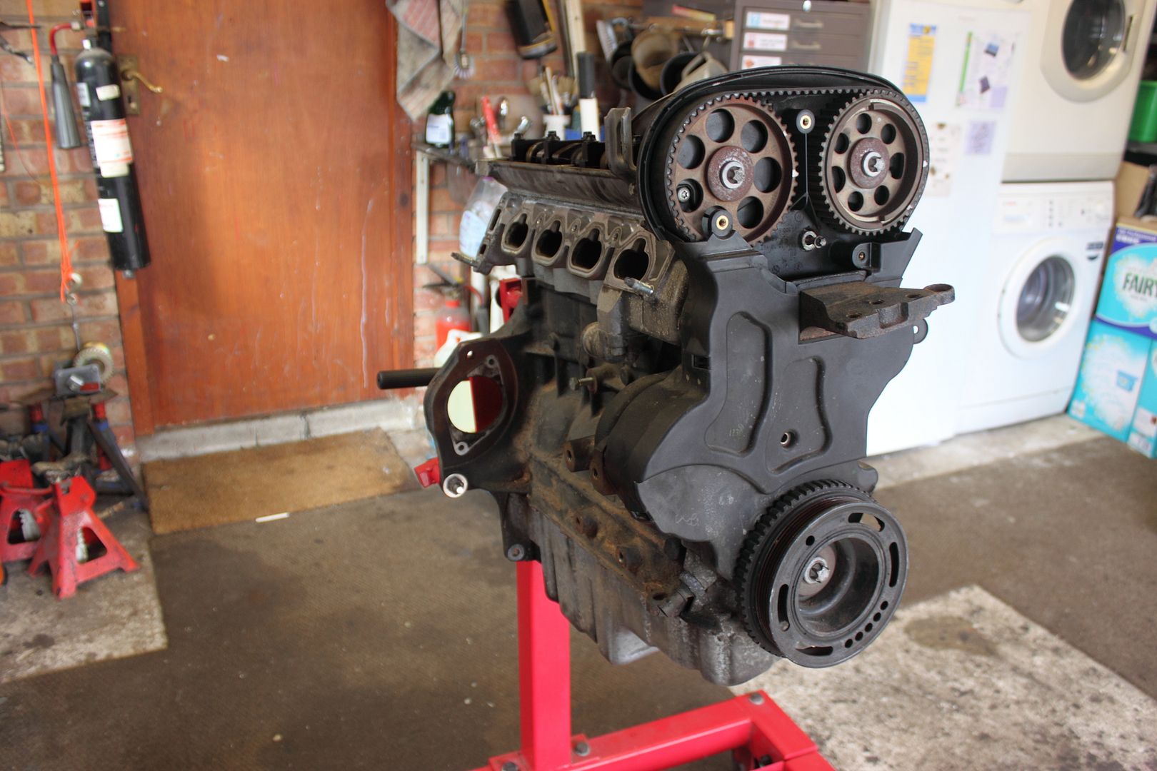

Due to an ever increasing oil consumption problem it has come to the point where the engine needs replacing with a new one, so...
I sourced a replacement 1.8 16v from a contact in Nottingham and picked it up a couple of months ago. I should of started work on the engine in mid July however due to a reoccuring back problem, I have only now been able to start stripping the engine.....
http://i2.photobucket.com/albums/y15...a/IMG_9197.jpg
http://i2.photobucket.com/albums/y15...Z18xe001-1.jpg
First job was to strip all the cambelt pulleys and associated gubbins off the side of the engine...
http://i2.photobucket.com/albums/y15...a/Z18xe002.jpg
Then it was off with the cylinder head ....
http://i2.photobucket.com/albums/y15...a/Z18xe003.jpg
The bores seem to be in good condition, I will give them a light hone before the pistons with the new rings go back in. Seemed a fair bit of carbon on the piston crowns which will get cleaned up ....
http://i2.photobucket.com/albums/y15...a/Z18xe004.jpg
Next job was to remove the pistons ...
http://i2.photobucket.com/albums/y15...a/Z18xe005.jpg
Had a look at the shells, seemed to be in good order with little wear, they will be replaced anyway as a matter of good practice...
http://i2.photobucket.com/albums/y15...a/Z18xe006.jpg
Got two pistons out before it was time for tea, will remove the other two and the crank shortly.
Plan is to hone the bores, and clean up the block. Rebuild the bottom end with new bearings and oil pump. I'm going to strip the head, clean the inlet and exhaust ports up, remove and clean all the valves up and reseat them in the head and replace all the seals.
I'm cleaning out the lifters rather than replacing them, as at £16 each from Vauxhall I could spend my money better on other things!
Cheers
Joff

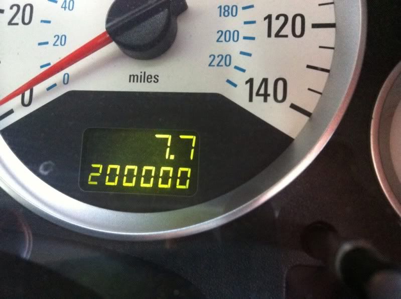

Theres nothing wrong with the disastra anyways, i really like mine, and its just turned 200,000 on the clock last weekend :eek:

And still sweet as a nut :d
