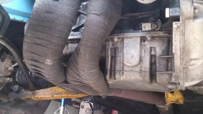

By the end of 2012 the x16xe sump that RetroPower had modified and fitted for me was weeping oil.
http://img.photobucket.com/albums/v1...pse575063a.jpg

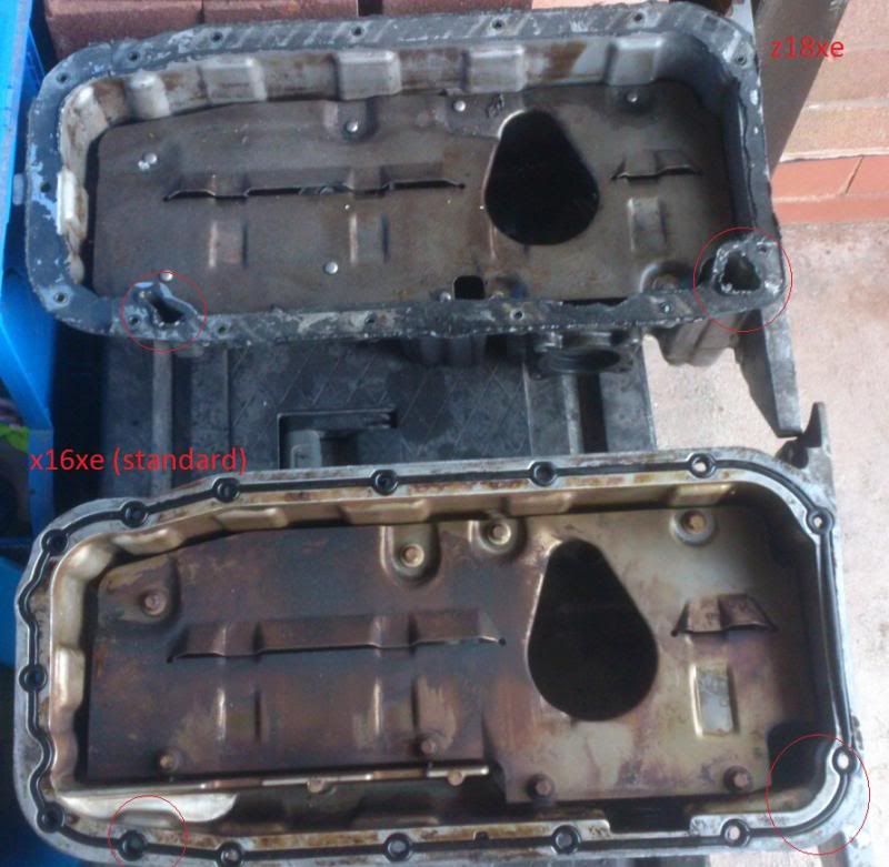

So I took it off and decided to look to going back to the original Z18XE one - but it would also need modifying to fit around the BTB manifold I was running also to be shallower; the same depth as the X16XE sump.. which is why I used the x16xe sump in the first place. It was thought the circled in photo oil drain ways were a cause as they are positioned over the flange and gasket on the X16XE sump. In addition, I had been running the X16XE sump without the top baffle/crank scraper.
http://img.photobucket.com/albums/v1...pse77d06cd.jpg
Anyway, I spent some time working out how the Z18XE should be modified before later in the year sending it off the Adam Dewis Motorsport for the modification.

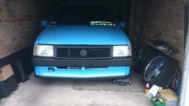

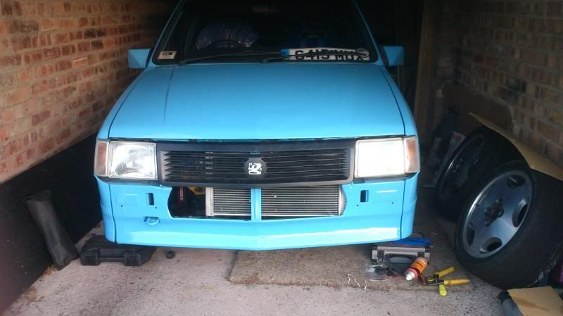

In the mean time during Feb '13 I sent the car off to get the front valance resprayed/tidied up in preparation for its 'new' but old, original front end set up. Deciding to ditch the deep GTE bumpers. At the same time I was working on the top, under slam panel radiator fixing.
http://img.photobucket.com/albums/v1...psd6bc8951.jpg
The black mk1 grill and faded grey mk1 front bumper were treated to black plasti-dip and fitted.
http://img.photobucket.com/albums/v1...psd5586a25.jpg

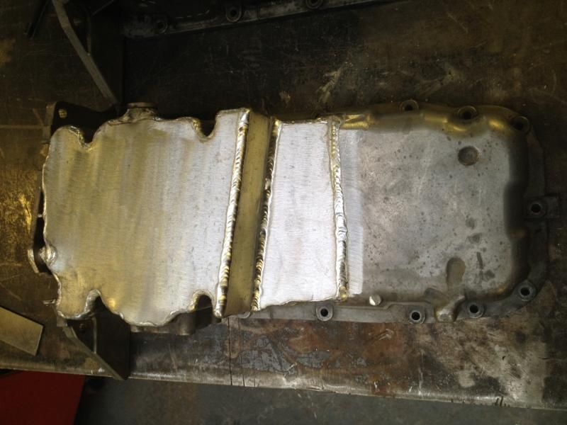

In May '13 I was to start the sump swap over, fitting Adam Dewis' modified Z18XE sump. It just about fit into place and for a little while all was well. Look; a completely newly made from scratch sump bowl:
http://img.photobucket.com/albums/v1...pse687da03.jpg

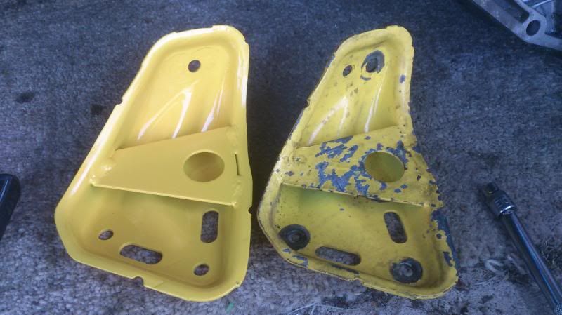

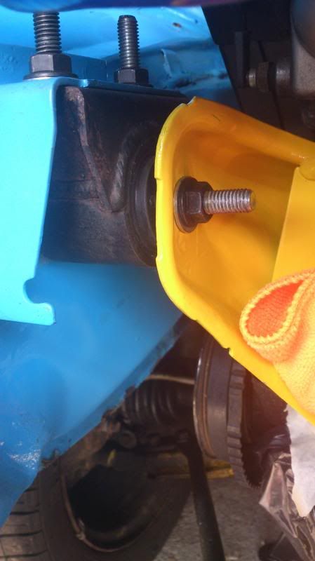

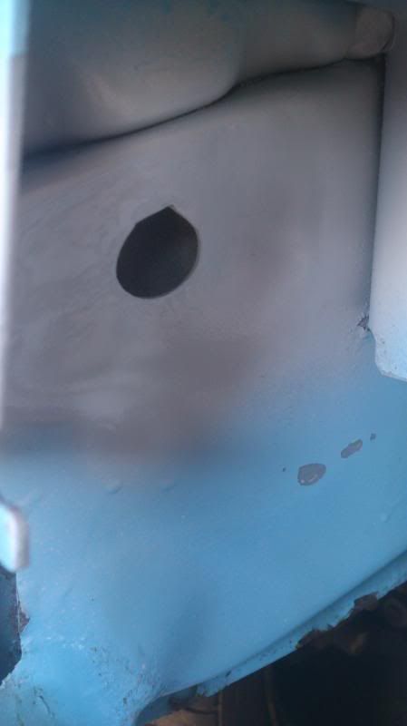

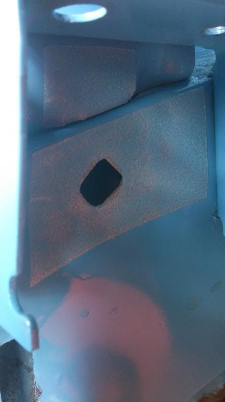

Also sorting the engine mount - it needed a new hole drilling slightly higher to raise one side for the engine to sit more level, so got that done. Had the two original holes plug welded of course.
http://img.photobucket.com/albums/v1...ps2f8c3c15.jpg

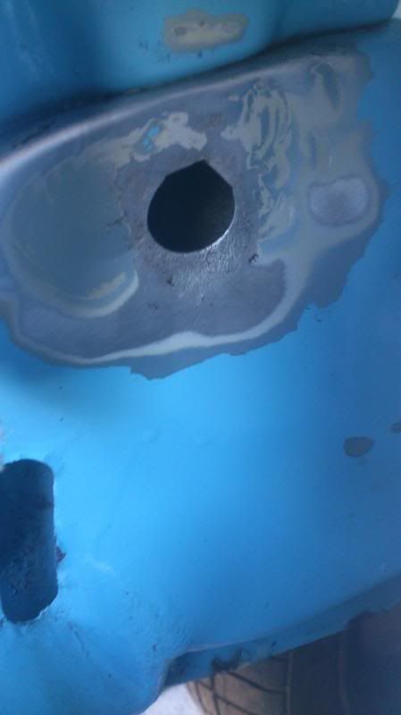

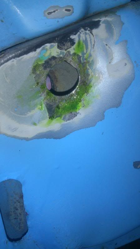

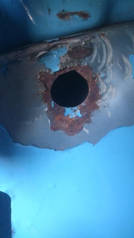

Whilst it was off an area of corrosion behind the engine mount could be sorted..
http://img.photobucket.com/albums/v1...psf12401bd.jpg
http://img.photobucket.com/albums/v1...ps854efc79.jpg
http://img.photobucket.com/albums/v1...ps161614a5.jpg
http://img.photobucket.com/albums/v1...ps800c8653.jpg
http://img.photobucket.com/albums/v1...pse5ec7e4c.jpg
http://img.photobucket.com/albums/v1...psfe60ed10.jpg
Refitted the mount, engine back in a better position.
http://img.photobucket.com/albums/v1...psb783a2a0.jpg

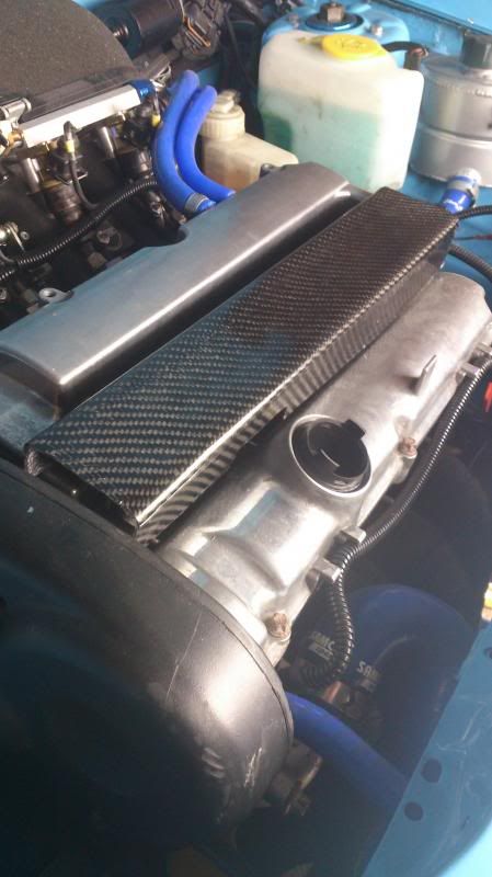

Two other jobs under the bonnet were - a new, more functional oil catch tank. Relocated to the firewall/bulkhead to tidy the engine bay a bit more also a CM Composites custom made carbon fibre spark plug/coilpack cover:
http://img.photobucket.com/albums/v1...ps54b55a0f.jpg

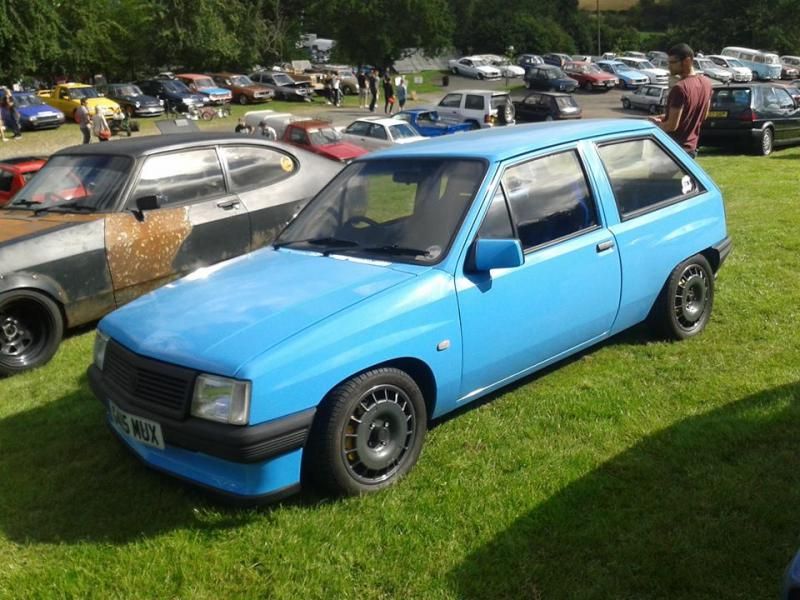

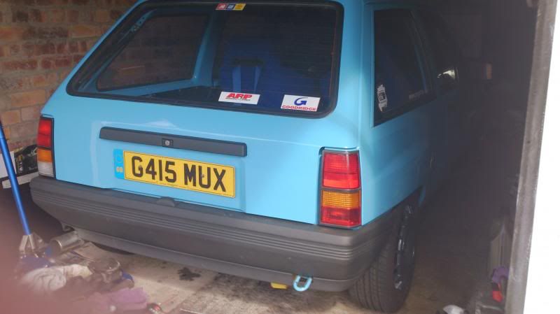

With the front end complete; all that was left was to plasti-dip and fit the o.e spec. rear bumper. New wheels too, of course. Luckily I ordered the set of 4 5.5J x 14" TH Comps in ET45 just a few weeks before Compomotive closed its doors. Last 4 stud Vauxhall friendly set..?
http://img.photobucket.com/albums/v1...ps130de390.jpg
Made it to RRG'13 all sound and happy.
http://img.photobucket.com/albums/v1...ps2115e85f.jpg

A couple of months later, Dec '13 - the Z18XE sump was leaking again. My thinking; the flange/ mating face was too warped from the welding/modification. I left it over winter, had enough of sump lark for one year.
