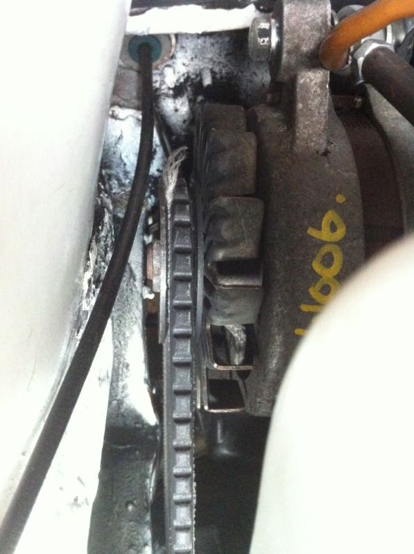

After Blyton all those months ago I thought now was the time to sort out the problems I had encountered.
First up, spotted this! So need a new one as it has started fraying!

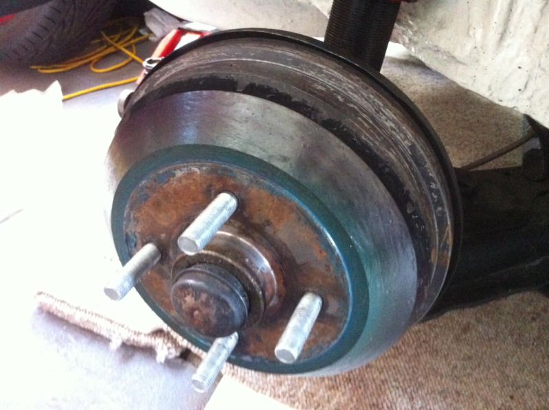

Next was the problem with the rear brakes. They were basically getting seriously hot and sticking on until they had cooled. One hot drum!
http://img.photobucket.com/albums/v3...nova/Drum4.jpg

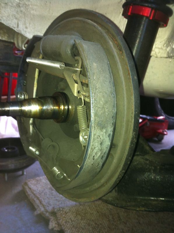

So whipped the drums off and here's what was left of the shoes!
http://img.photobucket.com/albums/v3...nova/Drum1.jpg
http://img.photobucket.com/albums/v3...nova/Drum2.jpg
http://img.photobucket.com/albums/v3...nova/Drum3.jpg
Not sure what to think at the moment other than I need new shoes! I'm not sure if it's doing it because:
a) Too much rear bias, athough pedal box was at least 85% to front
Possible Solution: Fit an inline bias
b) The adjuster is adjusting up everytime I'm braking hard and forcing the shoes to constantly sit against the drum
Possible Solution: Remove the adjuster lever and adjust manually every so often.
c) Having no handbrake cable is affecting adjustment?
Don't know whether this matters or not. The handbrake swing arm has been welded up so it doesn't interfere with the working of the drum as no cable attached.
So if anyone has any ideas on this I'd welcome suggestions!
My alternator belt turned itself inside out too and ran on the outside of the bottom pulley. I slackened the tension off and it's been fine since. We can get you a belt from Halfords if you want, they're about £2!
Does the alt not touch the leg too? Looks like its mm off... I thought the hand brake cable did hold the shoes in a bit (as it's an **** to fit) but i might be wrong.
