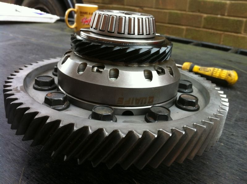

Got the diff in the box today. First off got everything cheaned up and the final drive gear swapped over onto the quaife. Then soaked the old diff speedo ring in boiling water, prayed it off gently and fitted that too.

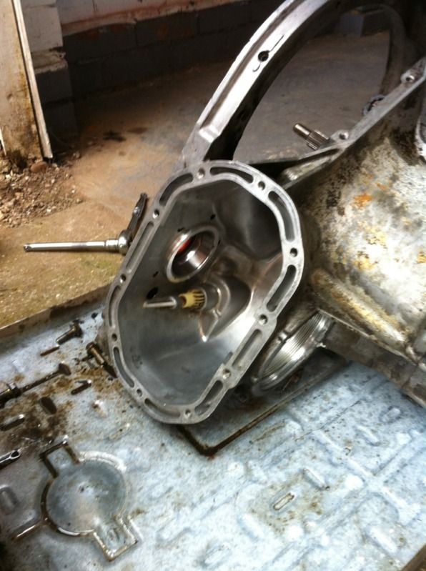

New bearings, races and seals fitted too and the cleaned out box awaiting its new diff!
http://img.photobucket.com/albums/v3...e/df686762.jpg
All ready to go back in the car :)
Standard diff with a Quaife sticker lol Nice work, can't wait to race you at Blyton!
