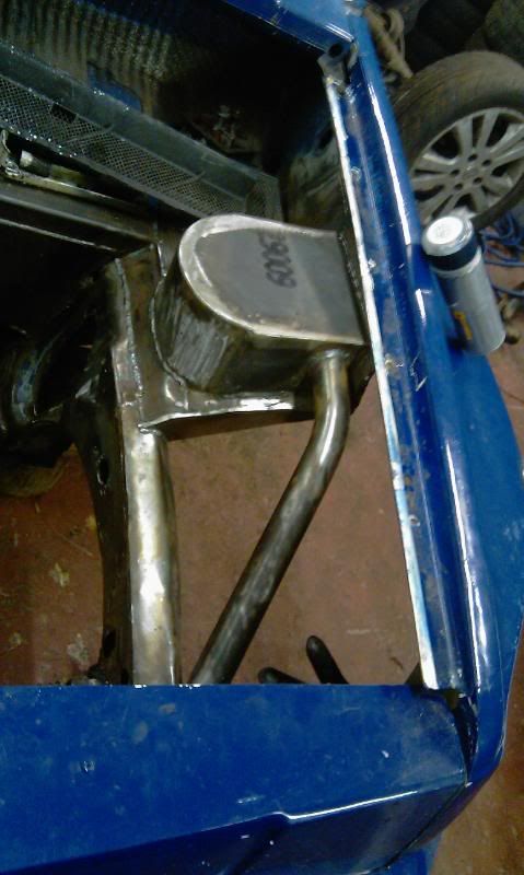

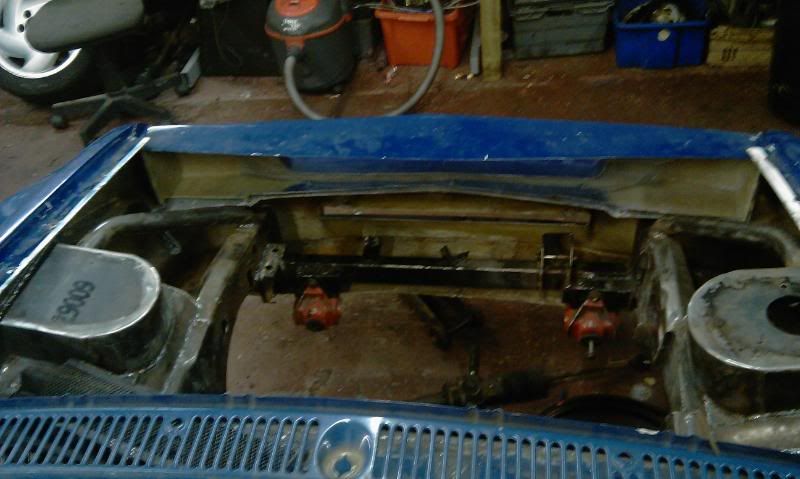

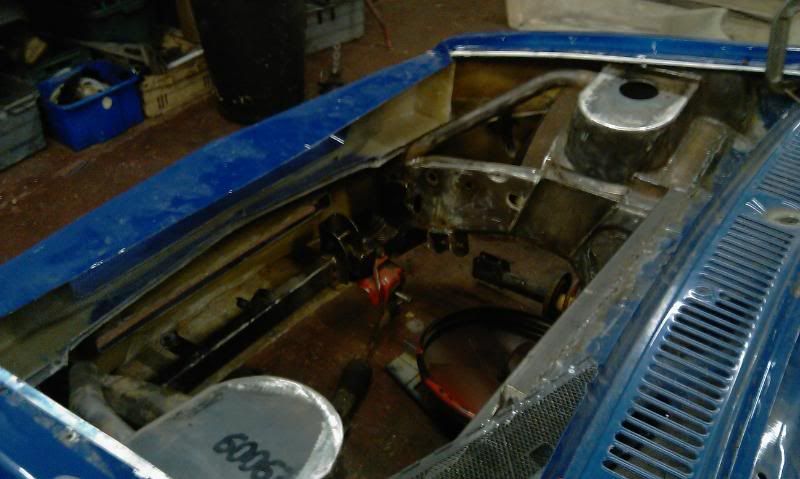

Following a visit from Steve Porter today, I've decided I need to lose metalwork out of the front inner wing area, just like Steve has done on his car (photos copyright and thanks to Mr. Porter);
http://i285.photobucket.com/albums/l...t/IMAG0820.jpg
http://i285.photobucket.com/albums/l...t/IMAG0821.jpg
http://i285.photobucket.com/albums/l...t/IMAG0822.jpg

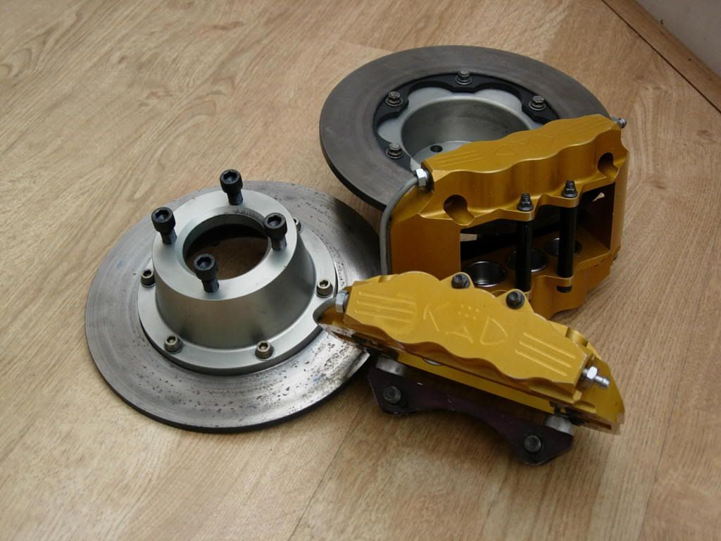

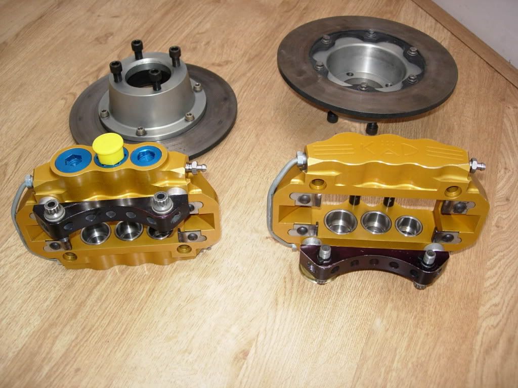

I've also bought some 6-pot KAD brakes (from a Mini), complete with discs, which I'm hoping to adapt to fit, in much the same way as we adapted KAD rear discs to fit;
http://i285.photobucket.com/albums/l...t/DSCN0616.jpg
http://i285.photobucket.com/albums/l...t/DSCN0619.jpg
As you can see, they are solid, not vented, and they are smaller in diameter, so less weight too. The Nova weighs much the same as a Mini now, so they should be adequate for the job.

On initial viewing of the front Alloy Bells, it looks to me as the offset is way too high - ie. the disc will sit too far in !!!
I looked at fitting some Astra Grp A front discs my mate had to my project but the brake bell had a deep offset and ment the disc touched the nova front knuckle :( - Back to the drawing board !!

The brakes will be with me on Monday so I can start doing some test fitting, but I am 99% certain I'm going to end up having alternative bells made up.
I could possibly make you some new bells if needed as i'm a precision engineer my trade.Quote:
