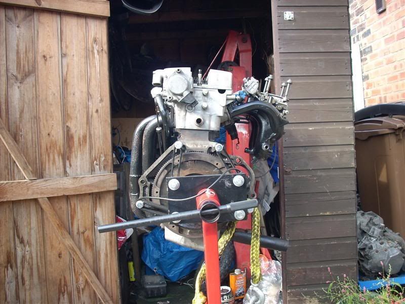

Head on and torqued up. Stuck a bit of oil down the spark plug holes into the bores, to hopefully stop them rusting. Engine will be sitting for a while yet.
http://img.photobucket.com/albums/v8...w/DSCN1152.jpg
Inlet done black, injectors/tb/rail cleaned. Needs a set of jenveys on there, but oh well lol
http://img.photobucket.com/albums/v8...w/DSCN1160.jpg

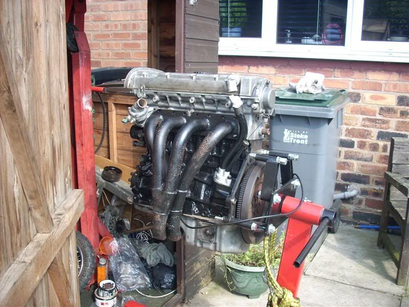

Exhaust manifold test fit, i wanted to see how far it "stuck out" past the sump, as i dont know how best to join it to my exhaust system yet.
Its not a std manifold i dont think, looks like a SBD type A
http://img.photobucket.com/albums/v8...w/DSCN1153.jpg
http://img.photobucket.com/albums/v8...w/DSCN1161.jpg
Manifold will be heat wrapped black before fitting it properly. :cool:
