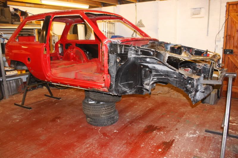

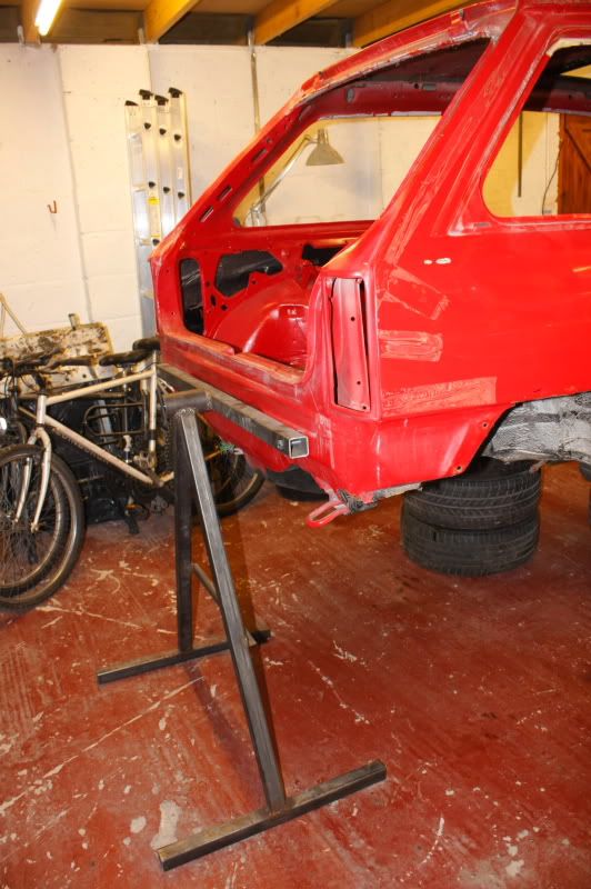

I bought 2 A frame rotisserie style kits from www.mk2mania.co.uk for £120. They came flat packed and were really easy to weld together
I started by raising the nose back up
http://img.photobucket.com/albums/v1...stripped13.jpg

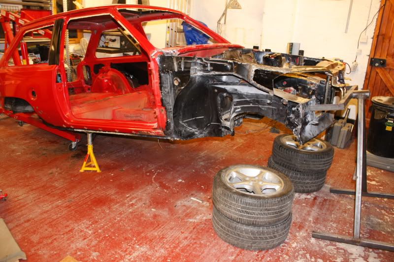

I then bolted the special bumper bar to the chassis via the existing bumper iron bolt holed. With the front of the car modified the company made custom arms for the project at no extra cost!

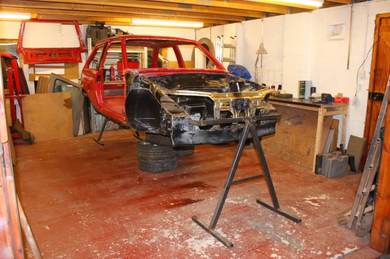

I then lifted the shell up (not v heavy at all!) and slotted it into the A frame...which was then bolted
http://img.photobucket.com/albums/v1...stripped14.jpg

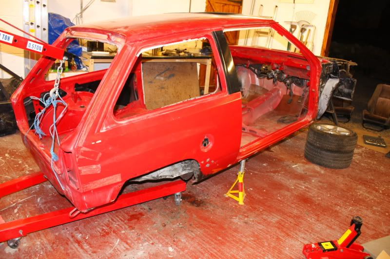

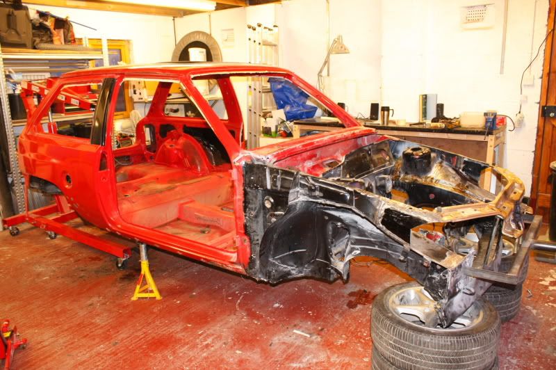

At this point I realised Id done it back to front - your supposed to bolt the rear A frame on 1st due to weight distribution however using my handy engine crane I managed to lift the rear of the car high enough to get the rear bar in place and slot the A frame in to position.
http://img.photobucket.com/albums/v1...stripped18.jpg
http://img.photobucket.com/albums/v1...stripped15.jpg
http://img.photobucket.com/albums/v1...stripped16.jpg
http://img.photobucket.com/albums/v1...stripped17.jpg

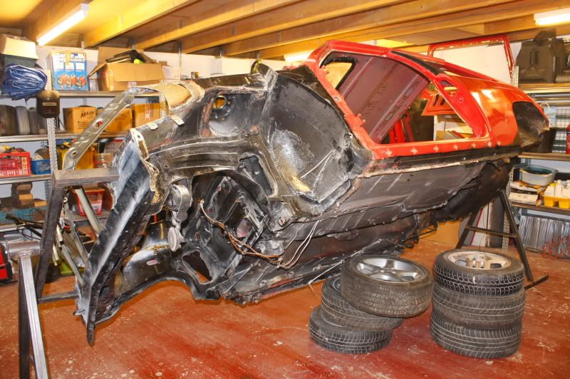

The car can be rolled a full 180' either side and is so light it can be rotated with one hand!
http://img.photobucket.com/albums/v1...stripped19.jpg
The plan now is to repair the sills and rear 1/4 panels - I'll then lower the car and repair the rear panel...
