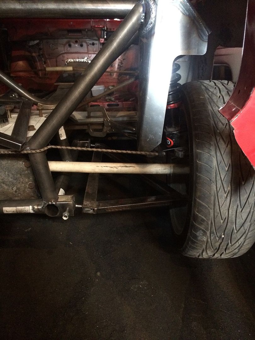

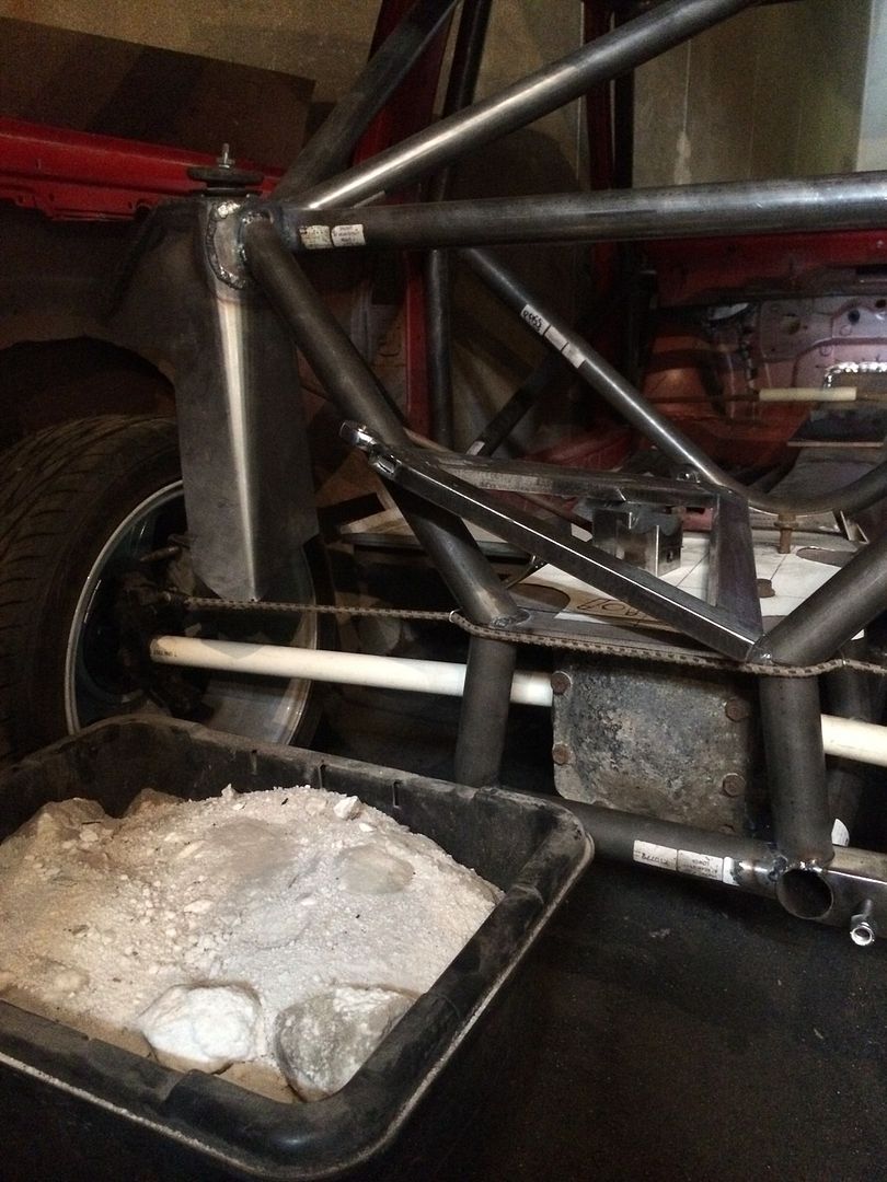

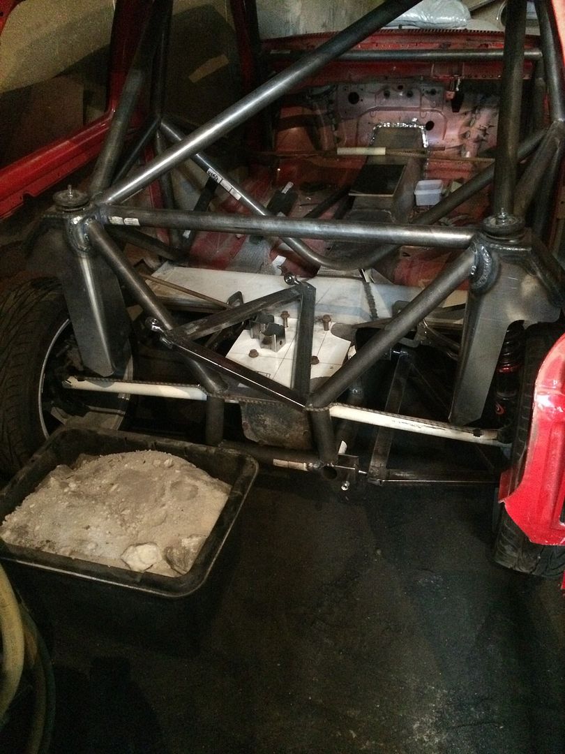

Bit more done on the back end. Starting to take shape! Just got suspension bits in but nothing's in place properly yet.

You sort choice of topmounts in the end then?
Rear cradle looks good, with using the nova hubs on the back, will you ad in extra support ?( as in like steering movement as you'll only have one side held in place with the std steering arm mount..)
I think the plan is just to mount it off steering arm and wrap the lower arms in steel to add strength there aswell but seen this today when was in speaking to the fabricator and looks well weight has been kept ryt down with light materials used and I'd imagine would be one the best 4x4 Novas about some really good work went into this
