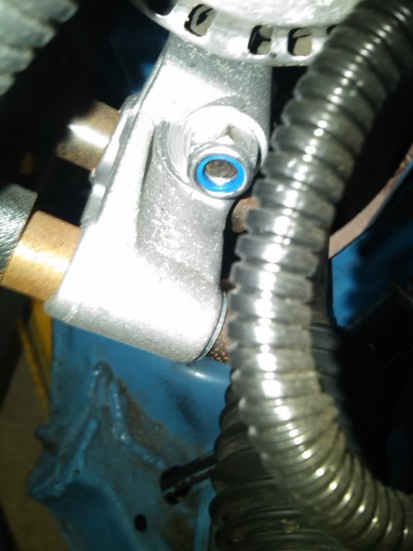

In preparation for mapping i wanted to rid of this naff bodged alternator mount
http://img.photobucket.com/albums/v1...10611-1349.jpg
..and in turn discovered why a little slack may have started to creep back in:
http://img.photobucket.com/albums/v1...10615-1528.jpg
Bolt wasnt quite in the nyloc bit..

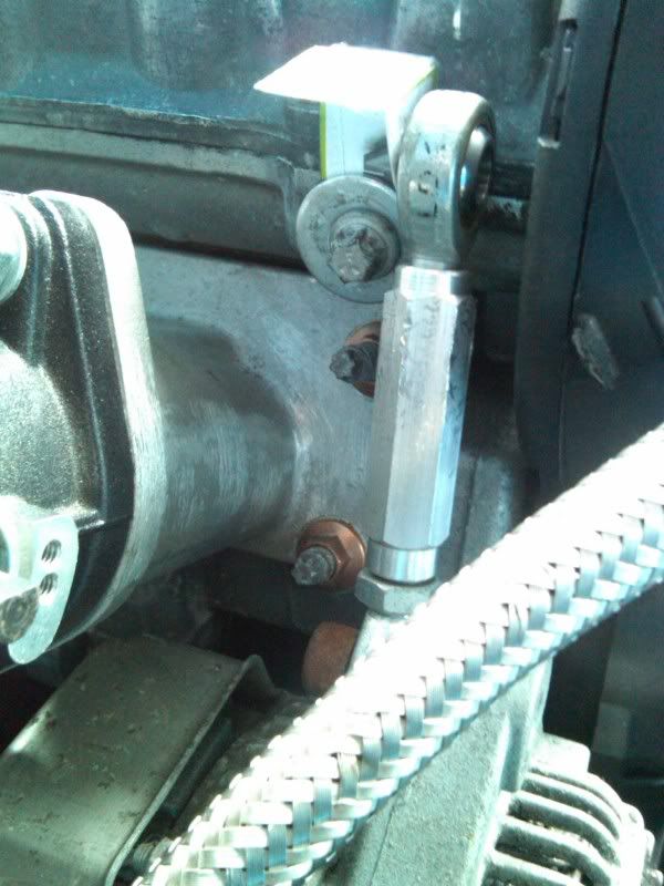

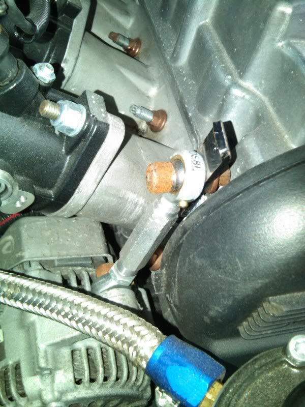

Sorted a longer bolt no problem, then went about mocking up a better neater top bracket..
http://img.photobucket.com/albums/v1...10617-1532.jpg

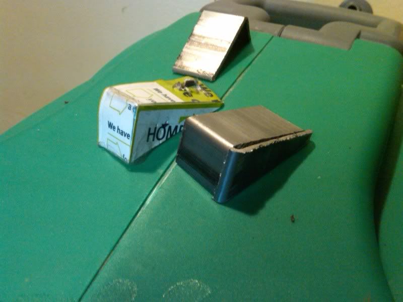

Then cut it out of 40x20x2 box section, ready to be welded:
http://img.photobucket.com/albums/v1...10622-2030.jpg

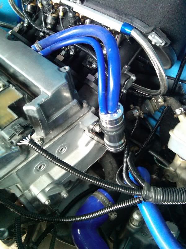

Fitted a smaller, neater catch tank..
http://img.photobucket.com/albums/v1...10619-1450.jpg
..But i still dont like it lol. It'll stay for now - its secure, fairly subtle.

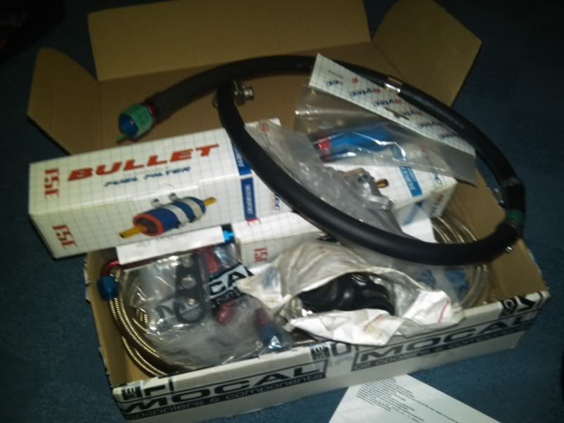

And lastly for now; just kept accumilating parts for the fuel system upgrade:
http://img.photobucket.com/albums/v1...10624-1845.jpg
Theres still a couple of meters of hose im waiting to be delivered and a connector or two.
With those, and the alternator bracket made, fitted and all going well ill take it for mapping. Hopefully next week or so, prob after billing lol :-(
