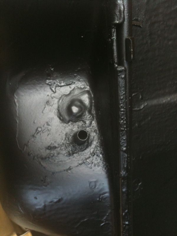

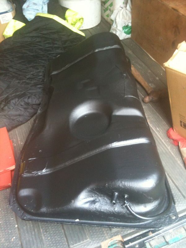

The fuel leak has been sorted, petrol tank was taken to a local radiator repair place who removed my return pipe (Which is where it was leaking from) and also pressure tested it and gave it a coat of stone guard paint. This has been refitted along with a new low pressure glass inline filter.
http://img.photobucket.com/albums/v3...a/IMG_1087.jpg
Return pipe was at the top in this pic
http://img.photobucket.com/albums/v3...a/IMG_1088.jpg
Freshly painted and repaired tank ready for fitting

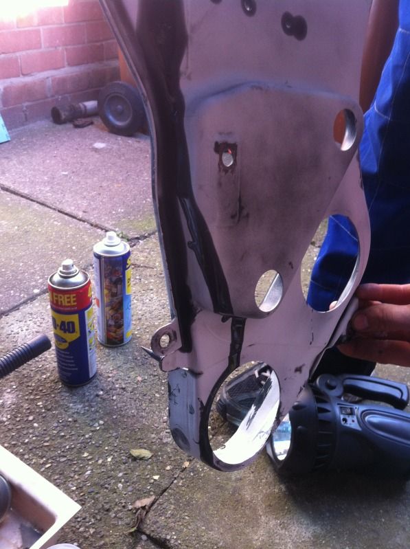

Since this got refitted I pretty much gave up on the nova and it sat unloved! But yesterday I finally got to the bottom of the oil leak. I was given a special flaw detector spray from a friend who works at ZF. It's a spray that when applied is clear, but as it dries it becomes like a white chalky like texture.
So first up the cambelt and backplate were all sripped off again and cleaned and degreased the side of the engine. Then gave the engine and backplate a generous coat of the spray and reassembled. Ran the car for about 5 mins (Which burst into life first time with a touch of choke :d) and then began the stripping process again!
Here are the results:
http://img.photobucket.com/albums/v3.../photo-1-3.jpg
http://img.photobucket.com/albums/v3.../photo-3-2.jpg
http://img.photobucket.com/albums/v3.../photo-2-3.jpg
Obvious conclusion is rocker cover gasket! Can't believe how much it's leaking. So when payday arrives I'll be getting a new gasket sorted, fit my oil cooler and new sump gasket and then fingers crossed it'll be leak free and ready for some more track action. Can't wait to get cracking on it again now seeing as I actually have an obvious problem to solve rather than guess work.

You have no idea how happy I was when you rang to tell me this was resolved, can't believe it was the freaking rocker gasket after all those seals you replaced!
When are we going to Donington then?
Cheers Iain. You don't know how happy I was! lol
As for Donnington it will be sooner rather than later, we've got to get some testing in with the Radical and Ste wants to get the teg out there again, so we will be looking at getting something booked in the near future. Just need to sort the towbar on the van too :)
Wow that spray looks handy!
Super duper dude, glad you finally got to the bottom of the issue. I recommend you only stick to decent quality rocker gaskets from here forth. I only use Elring as they supply Vauxhall, or so I'm lead to believe. You can get them at less then half the Vauxhall price from here, never had mine leak.
That sprays one of those stupidly simple, but great ideas lol

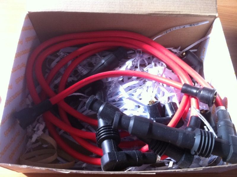

Package number 1 courtesy of - www.performanceleads.co.uk
Custom silicon ignition leads which have been made longer to suit my cav dizzy with the proper vauxhall ends. Should help it run a bit smoother as the last set had a poor connection due to wrong plug ends. Excellent service from these guys all done via phone/post, and brilliant price. Very happy with them.

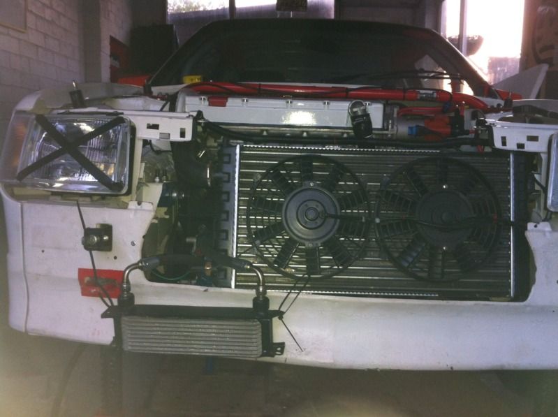

Also had a play with my oil cooler. Decided it is going to be mounted here
http://img.photobucket.com/albums/v3.../photo-2-4.jpg

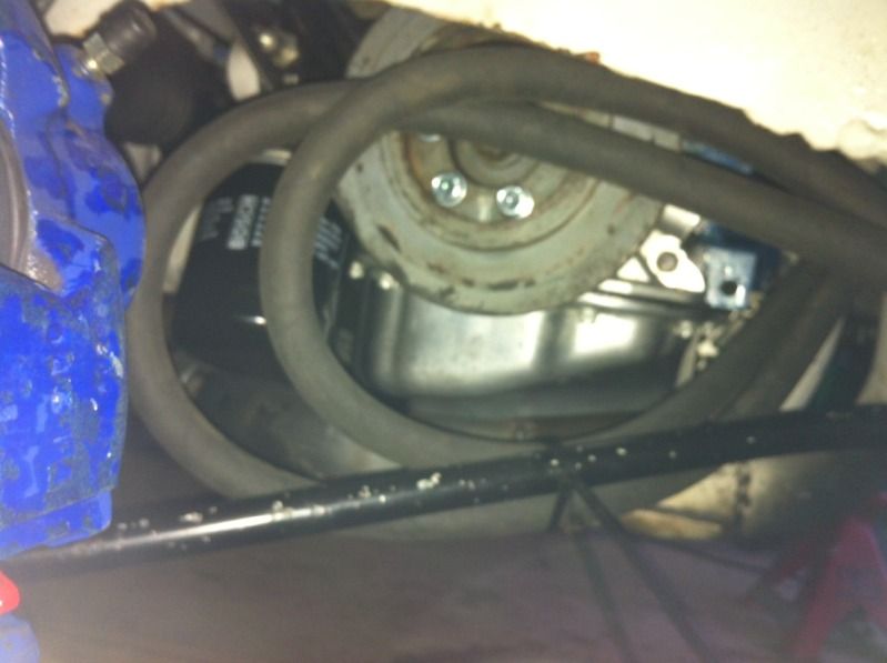

and pipes as so...
http://img.photobucket.com/albums/v3.../photo-3-3.jpg
The pipes needed shortening and some 90 degree fittings on the oil filter end, so took them to Pirtek who swaged the new ones on. So need to get this all fitted up. New rocker cover gasket has been fitted and sump gasket with correct length shorter bolts. So all starting to come together.

Nice work on the cooler, are you drilling some holes in the bumper for airflow to it?
(Hi its Iain by the way)
Hello you random profile hacking serial poster! Lol
Yes going to drill out some holes in the bumper :)
