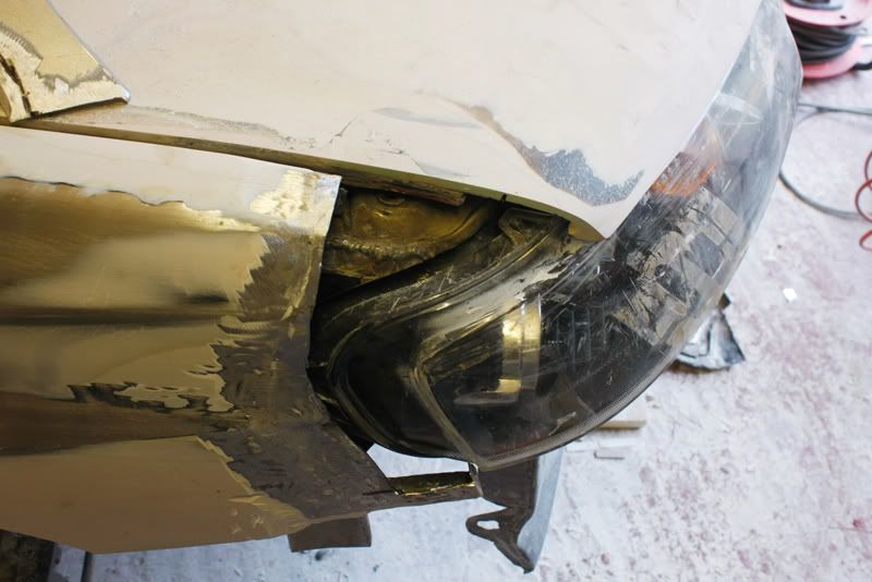

The last time a worked on the car I'd rebuilt the front ens using proper Punto slam panel and modded the wings a little. When I went back in to the garage at the start of February I took one look at the wings and decided I really wasnt happy with the welds around the lights - these parts were originally hand fettled and some of the 1st welding work I did - however after much sanding and adjusting the welds on the drivers wing cracked - I'd also without realising it applkied a fair amount of filler to even the wings and wheel flare out. I wanted shot of this and wanted to return back to as much bare metal as I could - for strength and weight and ease more than anything...
So out came the grinder...I removed the original light surrounds
http://img.photobucket.com/albums/v13/danga/bonnet4.jpg
http://img.photobucket.com/albums/v13/danga/bonnet3.jpg
I'd already acquired some original Punto surrounds from a scrapper so just needed to weld these in the old surrounds place -
http://img.photobucket.com/albums/v13/danga/bonnet5.jpg
The Punto profiles are a little shallower than the original Nova wings however I can get away with a thin skim of filler to balance them out and they fit the lights perfectly!

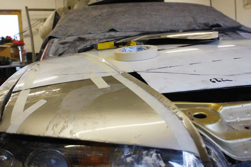

The biggest problem was the 2 swage lines on the Nova bonnet - these fade to the front of the car where as the Punto ones fade from front to rear. The solution was to extend the Nova ones into the Punto sections -
http://img.photobucket.com/albums/v13/danga/bonnet8.jpg
http://img.photobucket.com/albums/v13/danga/bonnet9.jpg
http://img.photobucket.com/albums/v1...a/bonnet10.jpg
A little tack welding later...
http://img.photobucket.com/albums/v1...a/bonnet13.jpg
http://img.photobucket.com/albums/v1...a/bonnet14.jpg
its alive!!!!!!!

this was repeated on both sides -
http://img.photobucket.com/albums/v1...a/bonnet12.jpg

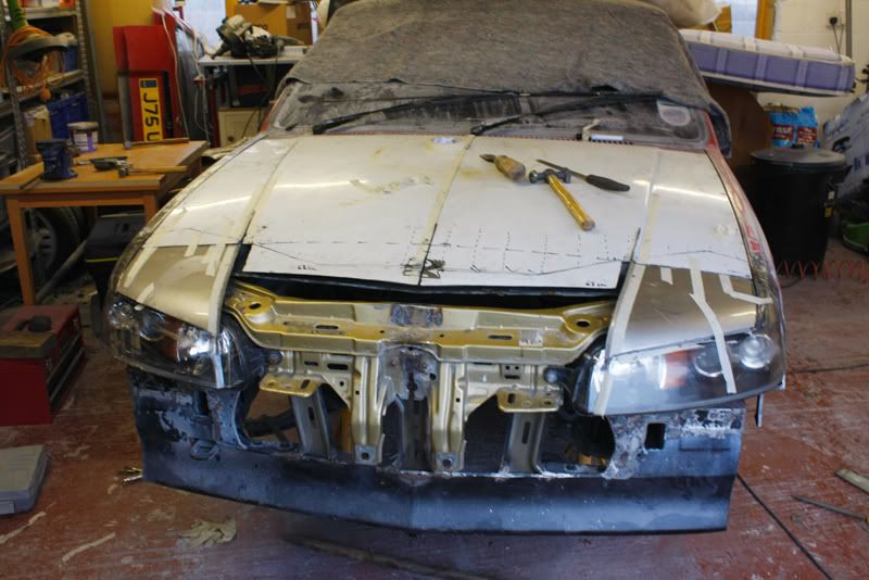

which left the big bit in the middle. The Nova bonet curves down sharply at the front so I needed to level this off a little -
http://img.photobucket.com/albums/v1...a/bonnet11.jpg

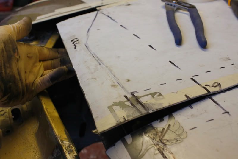

This is just the skins Im using at the moment - the under sides have been separated...
I then merged the Punto centre sections to the centre of the Nova bonnet. I had to cut about 7cm out of the Punto bonnet which is a fair bit wider...tacked them in place...
http://img.photobucket.com/albums/v1...a/bonnet17.jpg
http://img.photobucket.com/albums/v1...a/bonnet15.jpg
http://img.photobucket.com/albums/v1...a/bonnet16.jpg
The swage lines were then tacked in place
http://img.photobucket.com/albums/v1...a/bonnet18.jpg
http://img.photobucket.com/albums/v1...a/bonnet19.jpg
http://img.photobucket.com/albums/v1...a/bonnet21.jpg
The front grill area isnt straight or level yet because I need to work out the grill dimensions as well as the bit that will be folded back to seal the underside to the outer skin...

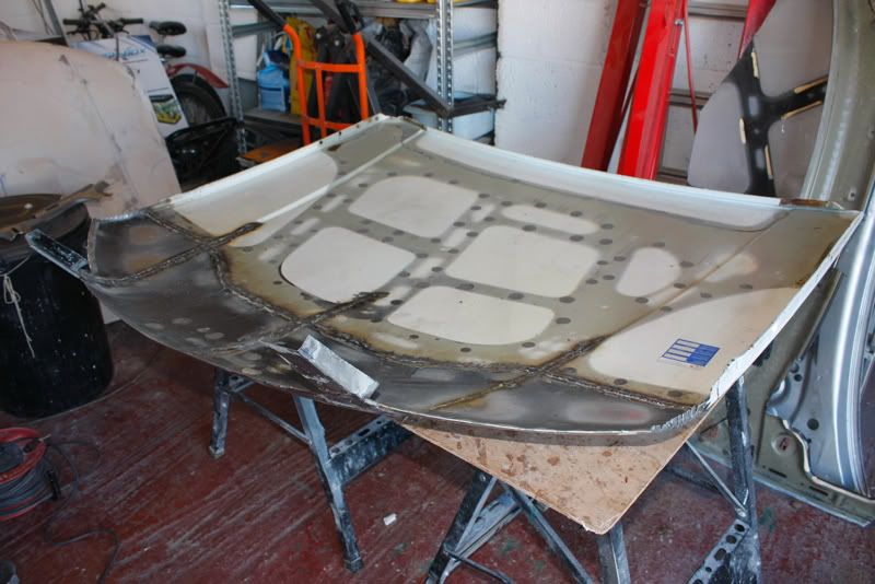

I now needed to start building a reinforcing layer to support both bonnets.
I separated the underside from the Nova bonnet leaving a single bonnet skin -
http://img.photobucket.com/albums/v1...a/bonnet31.jpg
and welded the front of the Punto underside together to match the slam panel profile -
http://img.photobucket.com/albums/v1...a/bonnet30.jpg
Before I could fit the underside properly I needed to remove some of the warping left by the welds. Bonnet skin is thin and with so much work being done it buckled in places...so out came the hammer and dollys...
Its as flat as I can be bothered with at the moment - once the understructure is secure the whole bonnet will receive a thin skim of filler the level it out - at which point I can fettle it further if necessary...
I then started working on the under side - how to join a Punto understructure to a Nova one...
http://img.photobucket.com/albums/v1...a/bonnet29.jpg
http://img.photobucket.com/albums/v1...a/bonnet28.jpg
