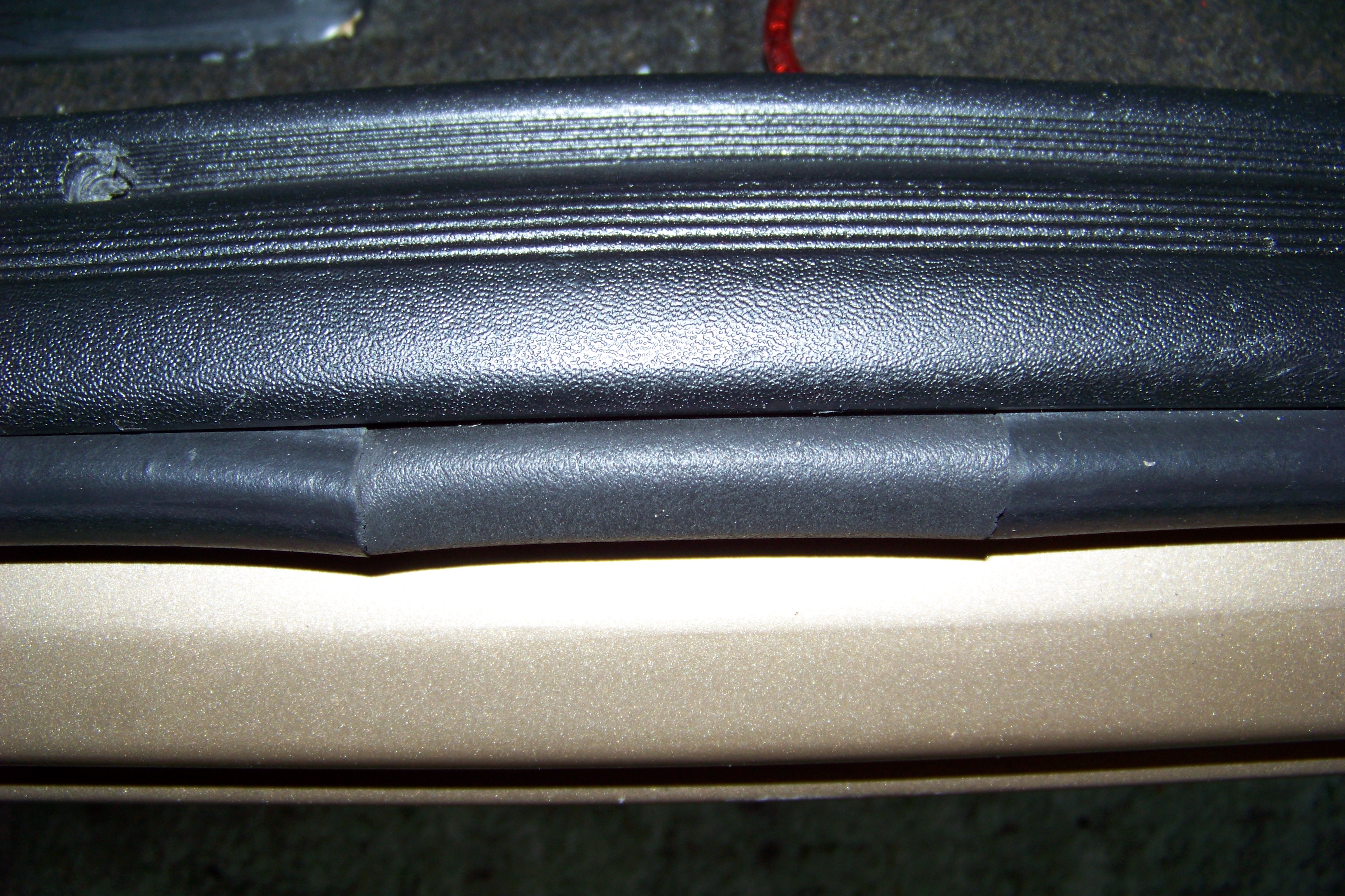

Had to go try out the rubber door seal lol Cut out the bad bit from the door and made sure the current seal was fitted properly in the correct position. I then measured up the gap that was left over and cut the new one to size and fitted it in between .
Have to say that the seal I got is a perfect fit, and near as makes no difference the same size as the original one.
Before
http://img269.imageshack.us/img269/7936/1002366z.jpg
https://images2.imgbox.com/d1/19/m7DwPAMY_o.jpg
After
http://img14.imageshack.us/img14/2169/1002367i.jpg
https://images2.imgbox.com/04/0a/QIgeSVvE_o.jpg
Once happy with the fit, I added a touch of black sealant around the lip of the rubber seal so it bonds with the existing rubber seal. Happy with the outcome and when the current stuff is completely worn out I know what to get and who to get it from :)

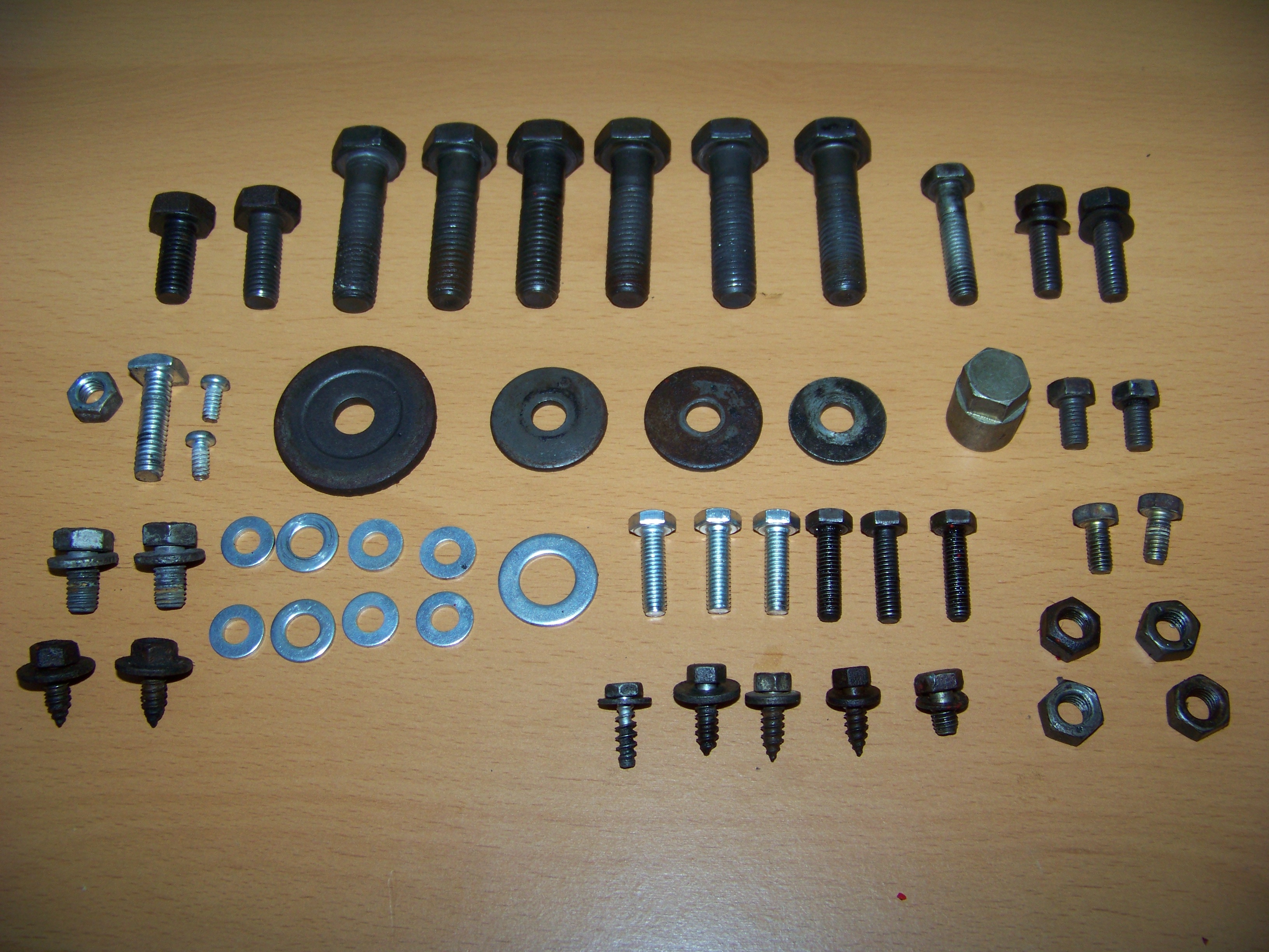

I then gathered all the nuts, bolts, washers, clamps, jubilee clips etc to send to the electro-platers. Some will be getting gold plated and others will be chrome plated. I'm also gonna enquire to see if the place can electro-plate the rocker cover in 'black chrome'... example below:
http://www.4chrome.com/Chrome4.jpg
https://images2.imgbox.com/fb/e4/CxmRf7NR_o.jpg

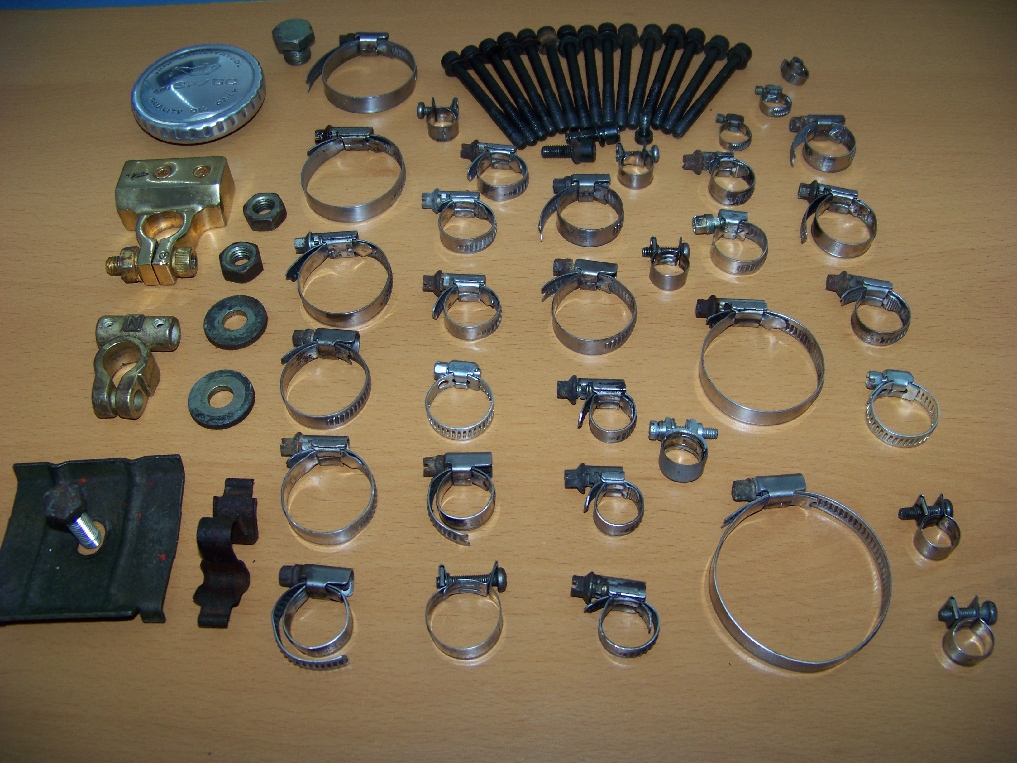

I split the bits into two groups. This lot will be gold plated ^ there will be a fair few more jubilee clips added to that lot
And these will be chrome plated (will probably add a few more bits to that group)

Some people may feel that gold plating is a bit 'tacky' but I'll only be using the gold plated items when against any black painted object i.e. rubber hoses, rocker cover etc just to accent certain areas. :)
Need to buy a few more various sized multi purpose bolts for around the bay and get them chromed up too.

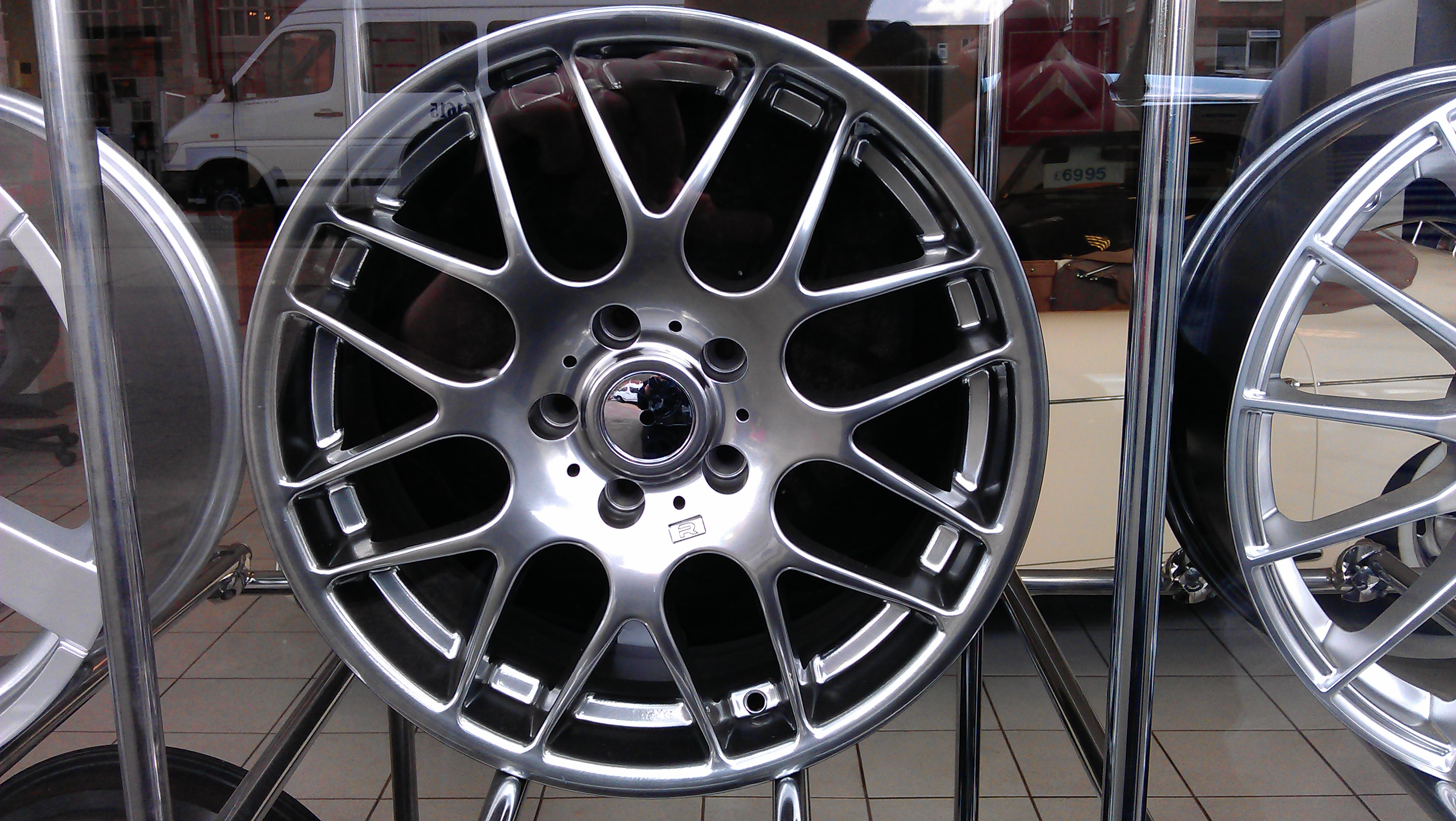

What do we think of these?
https://images2.imgbox.com/8b/88/bHh00I0x_o.jpg
http://img832.imageshack.us/img832/7740/imag0160b.jpg
[ ^ Come out really well on the HTC Sensations camera :d ]
Came across them on my travels today as we were stopped at a garage to ask a few questions as my bro's Cav has a bit of a clutch related problem. Saw them and thought 'hmmmmmmm'. Very close to BBS CH's (which I really like) and as it's proving to be a ball ache to find CH's in 16" I'm hoping that these will be ok (when I find out info on them). It's either CH style or BBS LM's but even the replicas are crazy offset :(
Off to raid the interwebz for infos.
Found a bit of info on them
MAKE: Riva
MODEL: DTM
SIZES: Available from 17" x 7J
OFFSET: 35mm/45mm
STUD/PCD: 5x120 / 4x100
An inch too big :cry

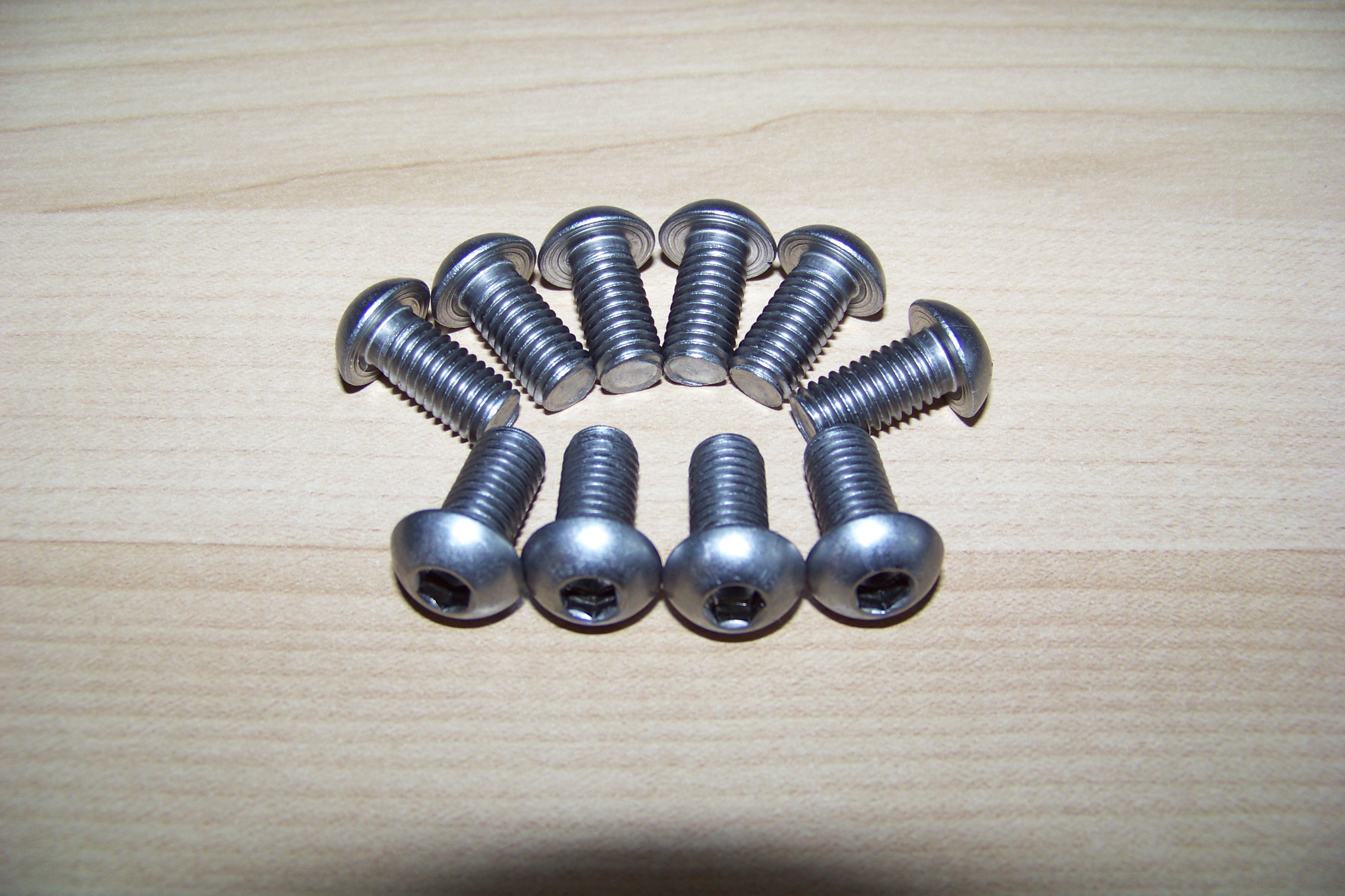

The other day as I was messing around in the bay looking at what needed to be plated and in what finish... I saw the headlamp screws looking utter sh*te and not very tight fitting. Dunno about anyone else but over the years the screws that hold the headlamps to the slam panel vary slowly got larger and so has the screw hole. I found a couple screws in the garage that do up nice and tight and fit the larger sized holes. They were some random M8 sized bolt. So I ordered a pack. Contemplated if I should go for the same type bolts as will be fitted to the rocker cover or something else. In the end, looking at the slightly worn plastic bracket on the headlamps themselves, I opted for a hex bit button head M8x16 bolt. Large enough to fit the enlarged hole in the slam panel, large enough head to hold down the headlamp and will do up nice and tight. Also got some washers too.
Button head M8's
https://images2.imgbox.com/ef/bb/dVoUVvAY_o.jpg

Finally, after realising the button head bolts I got were actually too big (measuring error, I actually needed M6's :tard:), I re-ordered another pack of button head M6's together with some spare allen key head ones in case, again M6.
http://img714.imageshack.us/img714/2398/1002384y.jpg
The M8 button heads I got will be used for something else, I'm sure there is something I can use them for :)

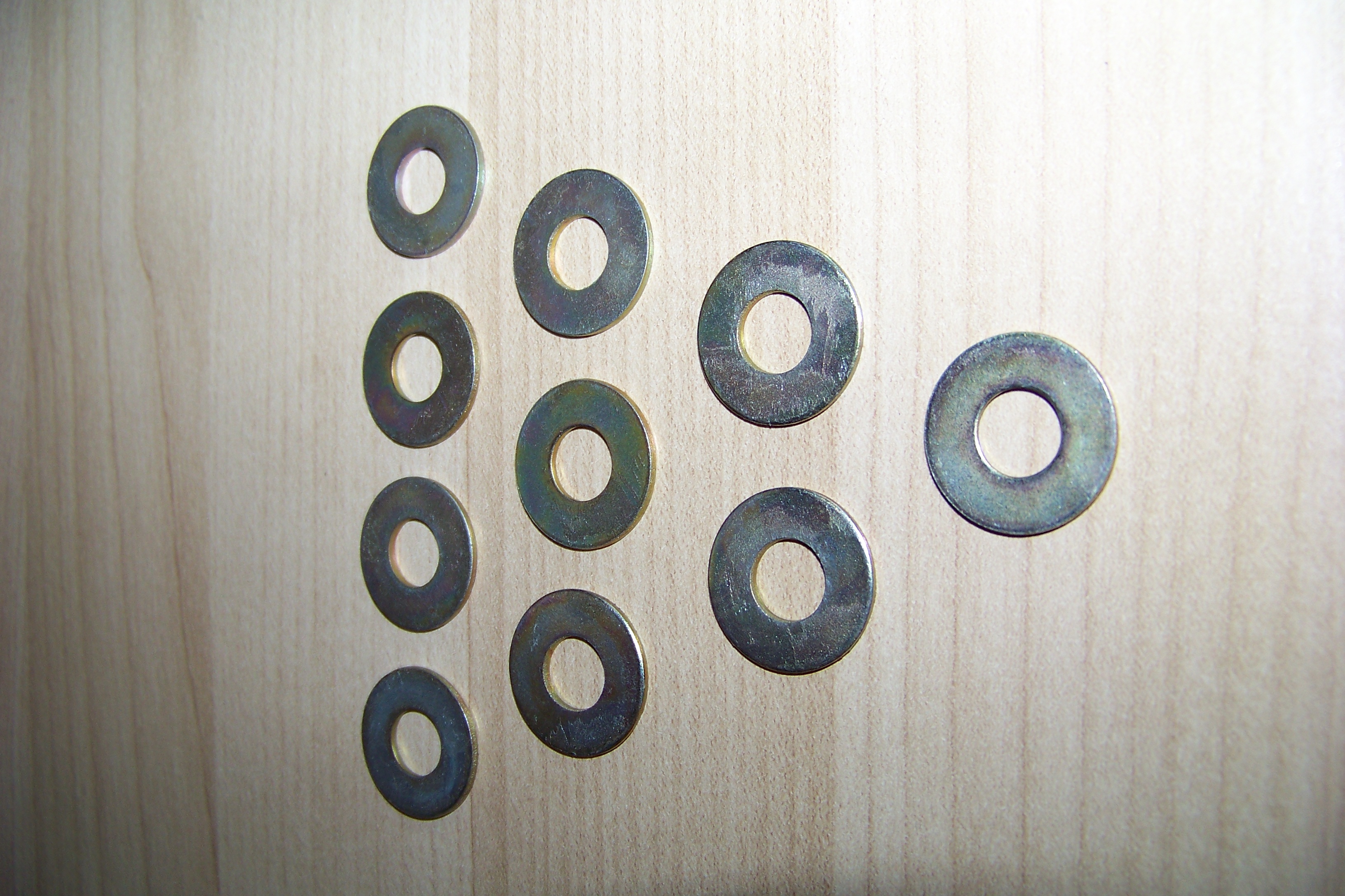

I did however received these today
http://img254.imageshack.us/img254/5604/1002386k.jpg
https://images2.imgbox.com/02/09/5OJYDPJo_o.jpg
Good condition, no bad wear, all good for the princely sum of £3.18 + postage lol
