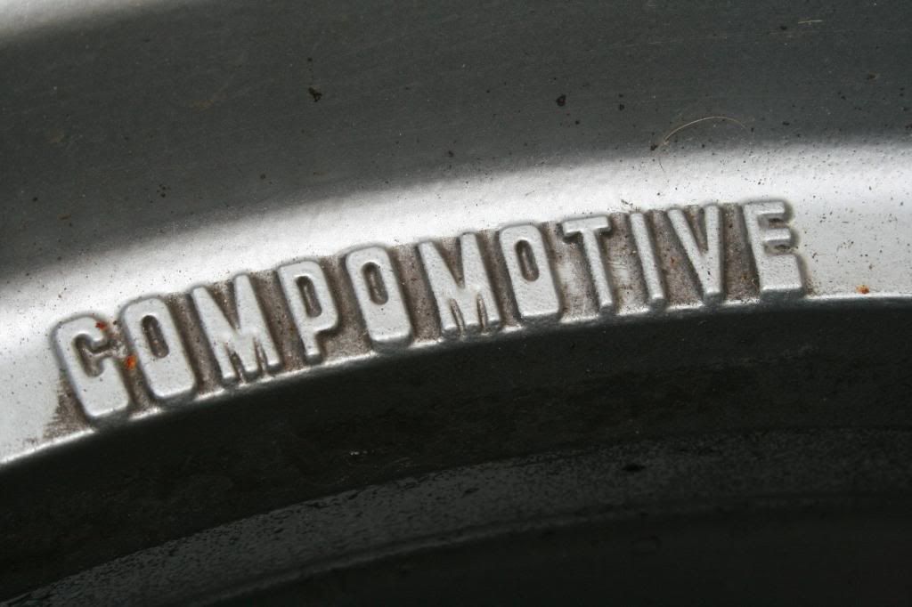

To start i collected these yesterday what a bargain!
http://i248.photobucket.com/albums/g...ndseats085.jpg
http://i248.photobucket.com/albums/g...ndseats087.jpg
http://i248.photobucket.com/albums/g...ndseats086.jpg

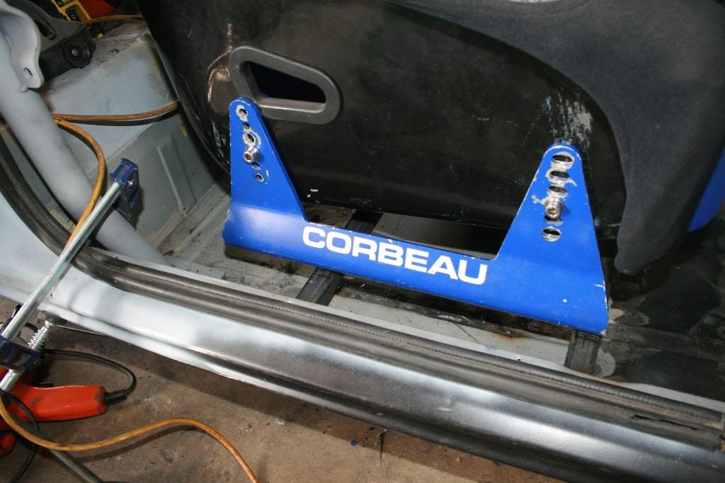

And they are a wicked size for what i want (to fit the wide arches)
http://i248.photobucket.com/albums/g...ndseats084.jpg

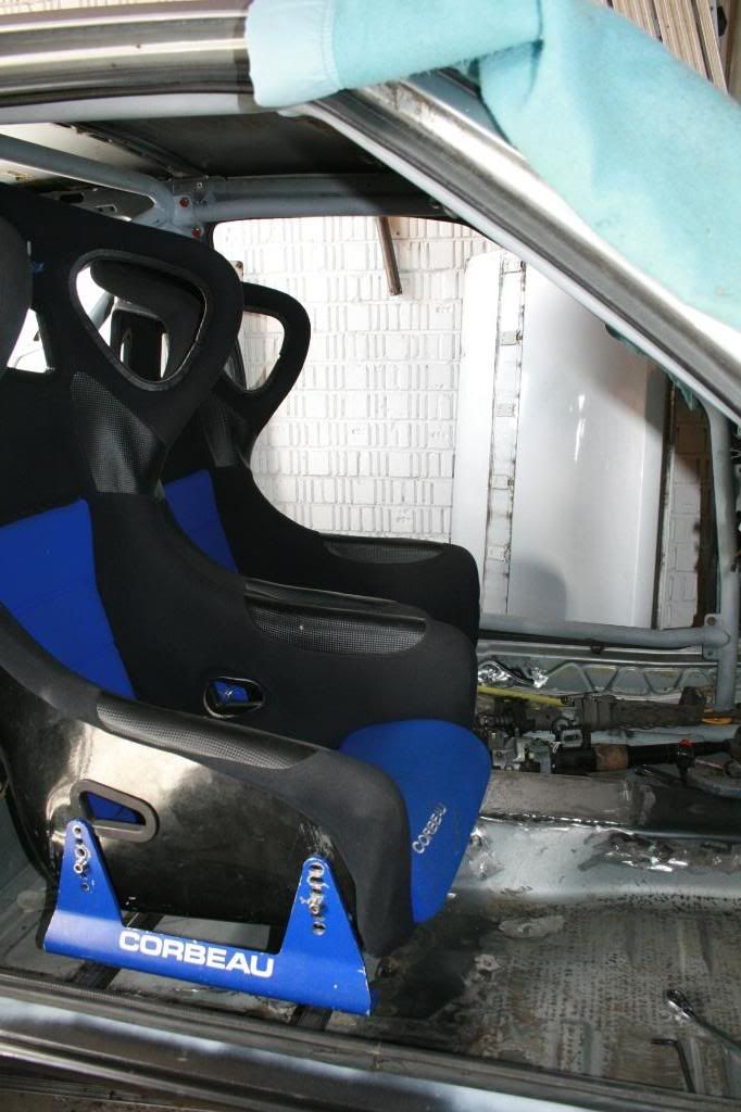

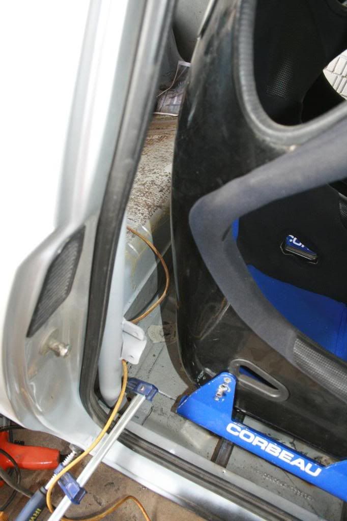

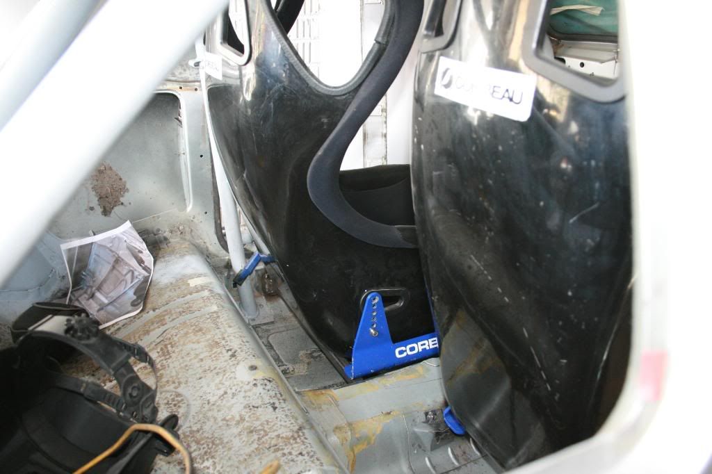

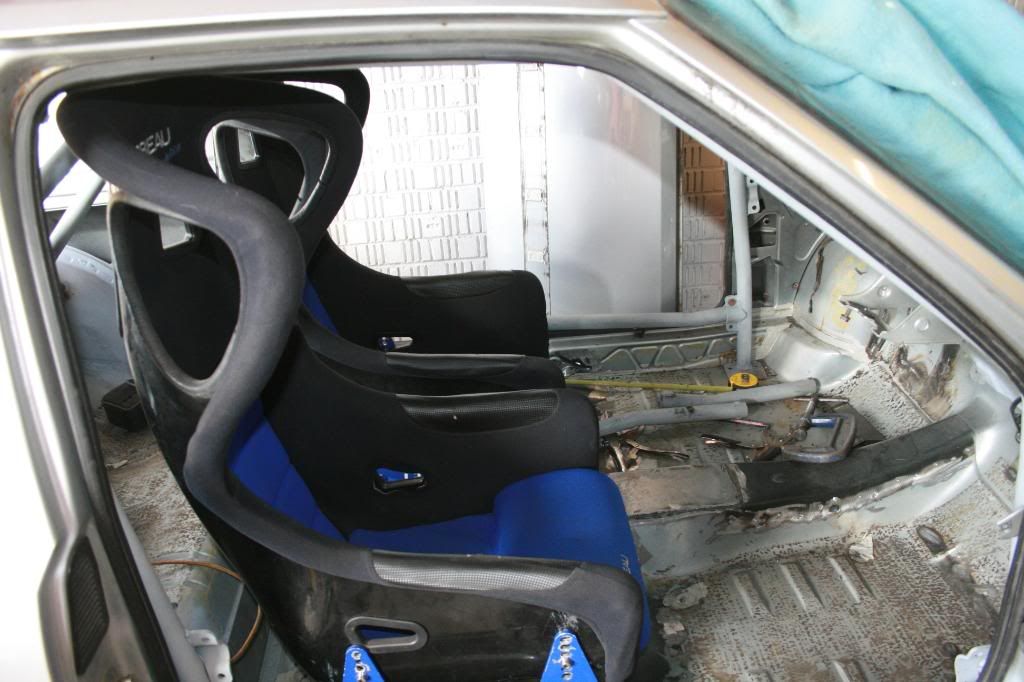

I then looked in to this seat all the way back idea - and can confirm it won't be happening atm as i can't see any real gain over the current seat position.
Moving the seat requires quite a lot more work (handbrake, and steering column etc) but it will only go back about another 2inches before it fouls he cage so isn't worth the effort imo.
Here is the seat as far back as it will go before it fouls the cage - see the top left corner
http://i248.photobucket.com/albums/g...ndseats088.jpg
all the way back on its subframes not that much room behind the seat
http://i248.photobucket.com/albums/g...ndseats089.jpg
http://i248.photobucket.com/albums/g...ndseats091.jpg
the seats are nearly level at this point
http://i248.photobucket.com/albums/g...ndseats090.jpg

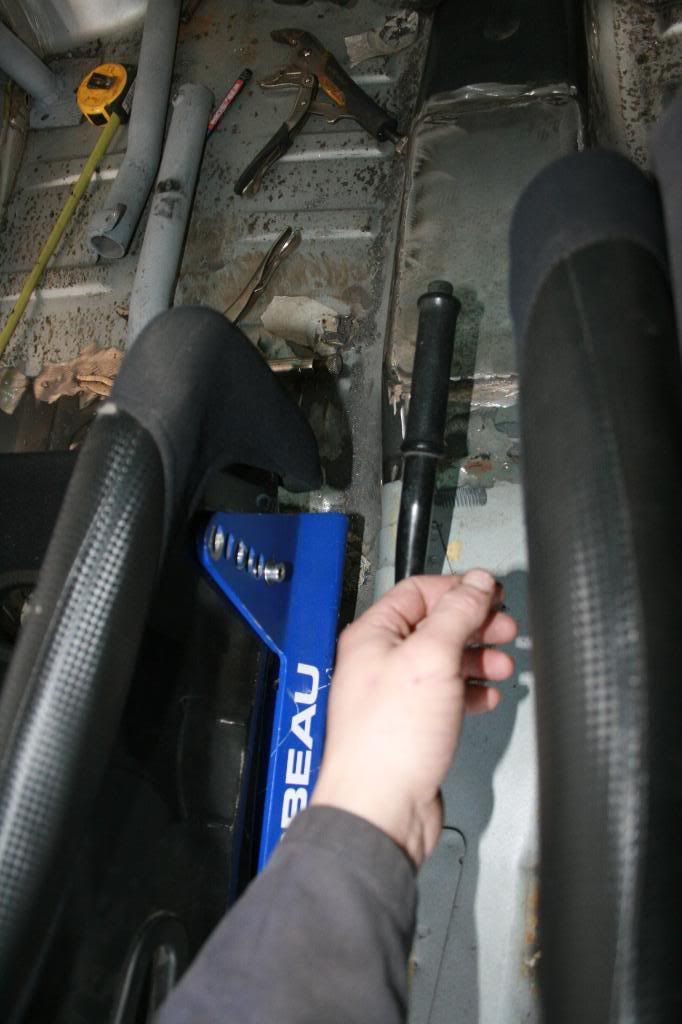

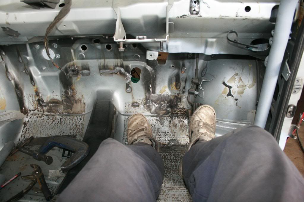

But here is the catch - i can still reach the pedals so they wouldn't need moving but i can't reach the hand brake or shifter comfortably
http://i248.photobucket.com/albums/g...ndseats092.jpg
http://i248.photobucket.com/albums/g...ndseats093.jpg
So i can't see the point in all that faf for 2 inches esp as there is no major gain other that its cool....

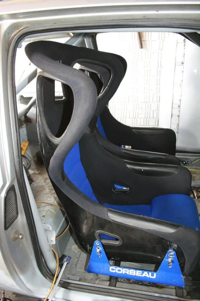

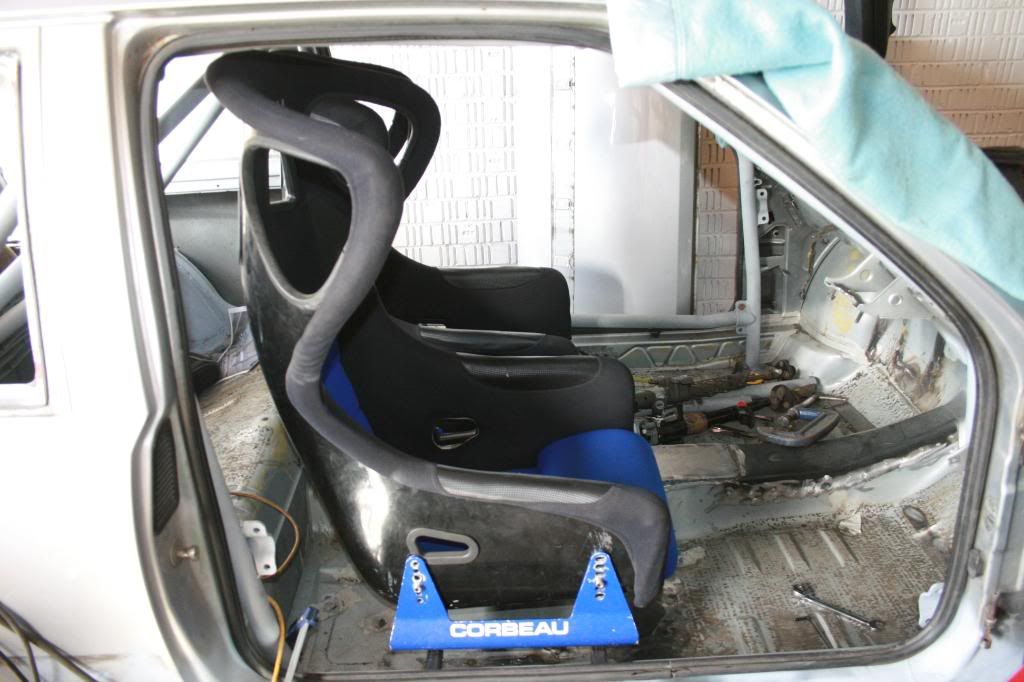

The seat sits like this in its current position
http://i248.photobucket.com/albums/g...ndseats094.jpg
http://i248.photobucket.com/albums/g...ndseats095.jpg
http://i248.photobucket.com/albums/g...ndseats096.jpg
This gives a comfortable seating position, with good sight to the off and near side (which is important to me as it will be road legal and i like to see lol) and means i don't have to alter anything!
If all that made no sense at all i'm glad as it means im not the only one who didn't understand lol.
So to summarise i don't think there is any reason to change what i already have as there is little to any gain to be had for the effort involved.

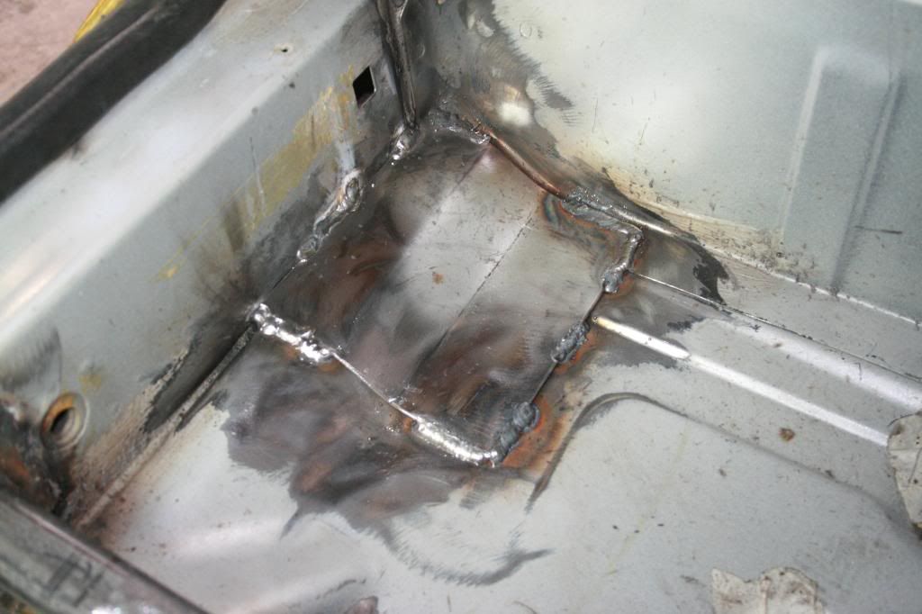

Once i had finished funking around i got on with something more productive - one for my man Oli

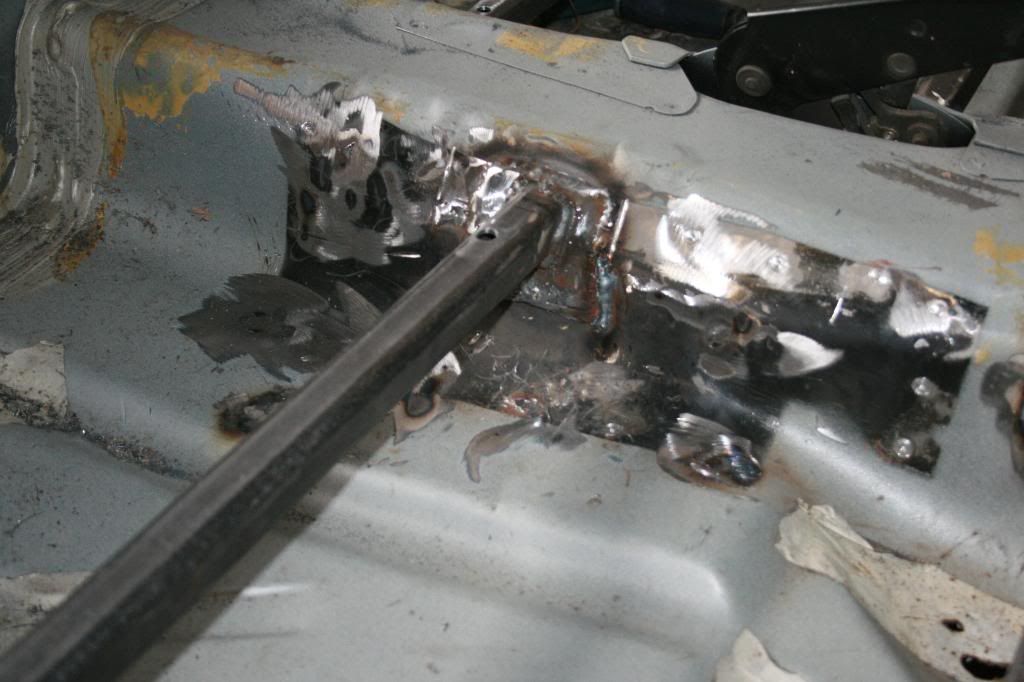

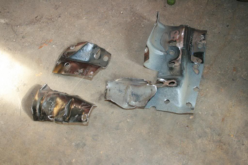

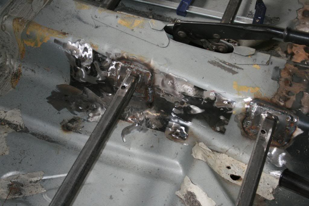

I got rid of the entire old seat mounting
http://i248.photobucket.com/albums/g...ndseats097.jpg
leaving this mmmmm weight loss :roll:
http://i248.photobucket.com/albums/g...ndseats102.jpg
http://i248.photobucket.com/albums/g...ndseats103.jpg

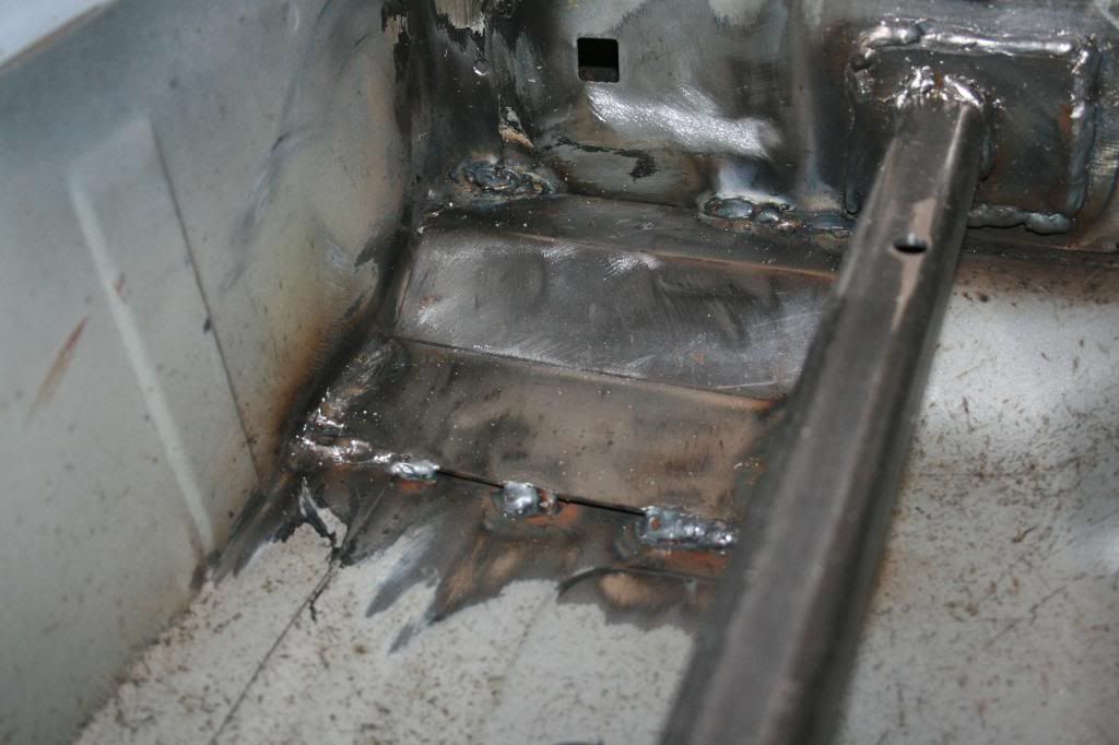

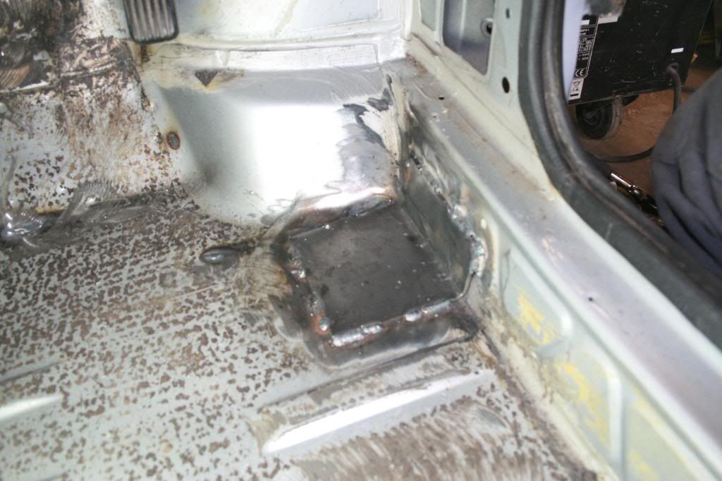

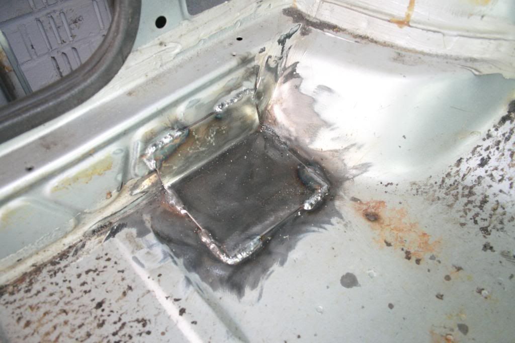

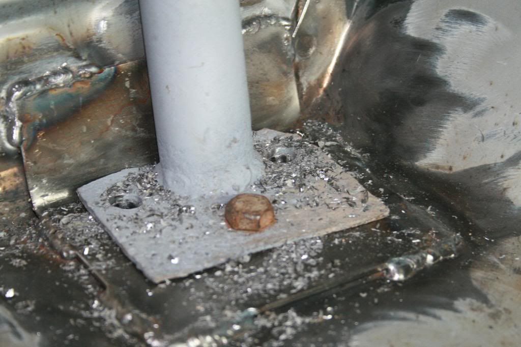

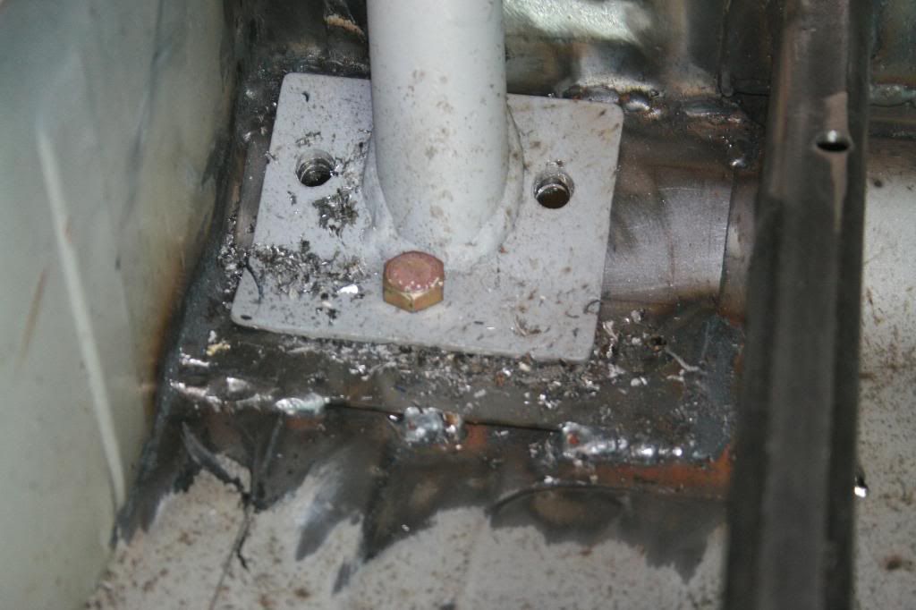

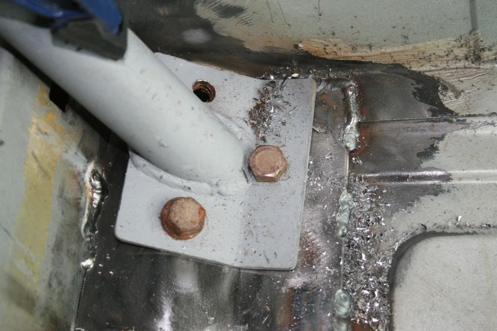

I then moved on to the cage....again. (Its almost done now thank funk)
I took the cage out of the car to weld the spreader plates in as so
http://i248.photobucket.com/albums/g...ndseats098.jpg
http://i248.photobucket.com/albums/g...ndseats099.jpg
http://i248.photobucket.com/albums/g...ndseats100.jpg
http://i248.photobucket.com/albums/g...ndseats101.jpg

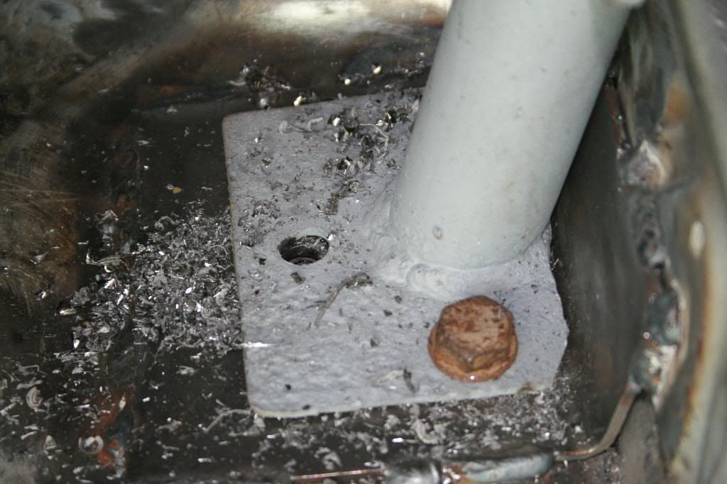

I then slipped the cage back in (yer its like that easy) to drill all the holes for the mounts and tag in points.
Swarf in your hand anyone???
http://i248.photobucket.com/albums/g...ndseats104.jpg
http://i248.photobucket.com/albums/g...ndseats105.jpg
http://i248.photobucket.com/albums/g...ndseats106.jpg
http://i248.photobucket.com/albums/g...ndseats107.jpg
