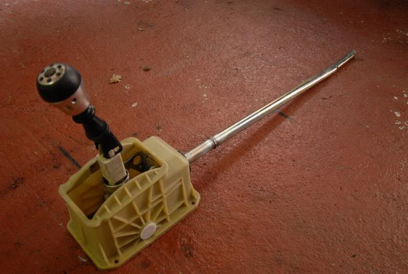

Took the internal shifter than I bought from John H, and cut the kink out by removing 3 inches, as per the guide written by Dar, however the kink wasn't as great as some I seen - but Lee had told me it needed to be straight straight
http://i136.photobucket.com/albums/q...ure/nc0662.jpg
However the other end of the shaft has a slight bend in it - is this correct? or has it been damaged previously?
http://i136.photobucket.com/albums/q...ure/nc0663.jpg
Welded back up, 3inches shorter and kinkless

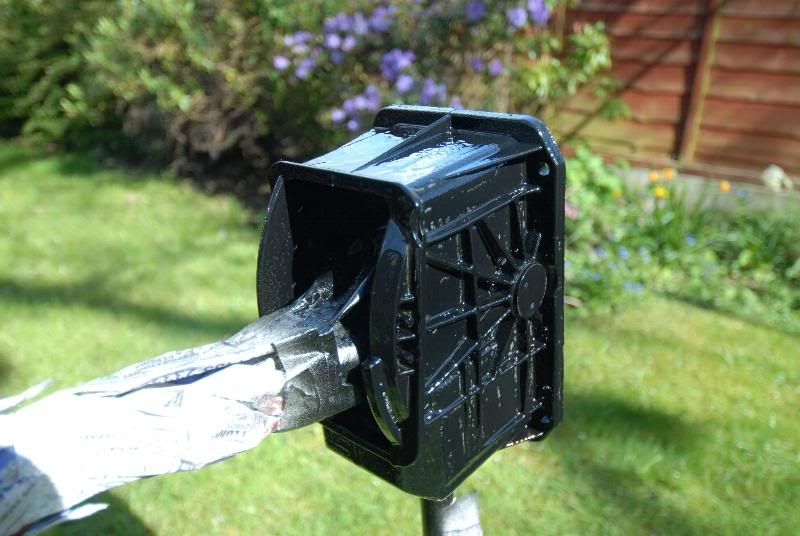

Then painted it black
http://i136.photobucket.com/albums/q...ure/nc0666.jpg
Then hated it, it looked tacky, so I soaked it in a tub of Nitromorz for 20mins, and its come out looking cleaner than ever

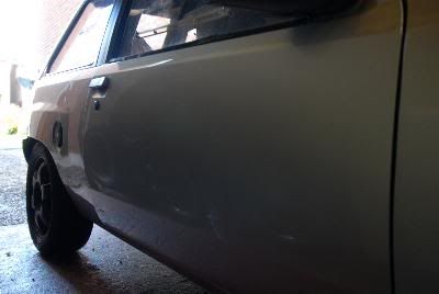

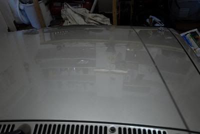

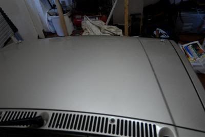

Whilst chatting to Lee at nigh 2am this morning, we got onto the subject of cleaning cars for some reason, as we're both anti cleaning lol
However, it got me feeling a bit guilty that I've not gave mine a good wash and polish in a while - so I set about doing that... my excuse is that I'm doing it for less drag and more aerodynamic in time for Combe, I think it needed it though...
Before & After
http://i136.photobucket.com/albums/q...ure/nc0669.jpg http://i136.photobucket.com/albums/q...ure/nc0670.jpg

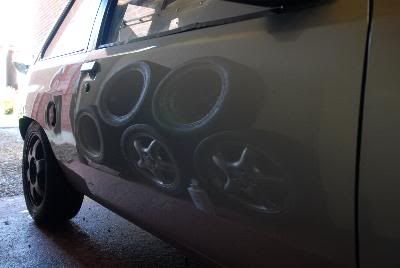

Same again
http://i136.photobucket.com/albums/q...ure/nc0671.jpg http://i136.photobucket.com/albums/q...ure/nc0672.jpg

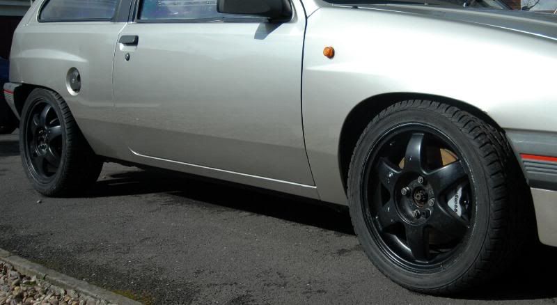

Removed all the Toyo 888s that were splattered up my wings and doors, they've not been this clean in years lol (brake cleaner is good for this, as it melts the rubber which enables you to just wipe off)
http://i136.photobucket.com/albums/q...ure/nc0673.jpg

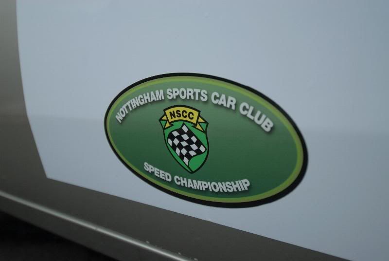

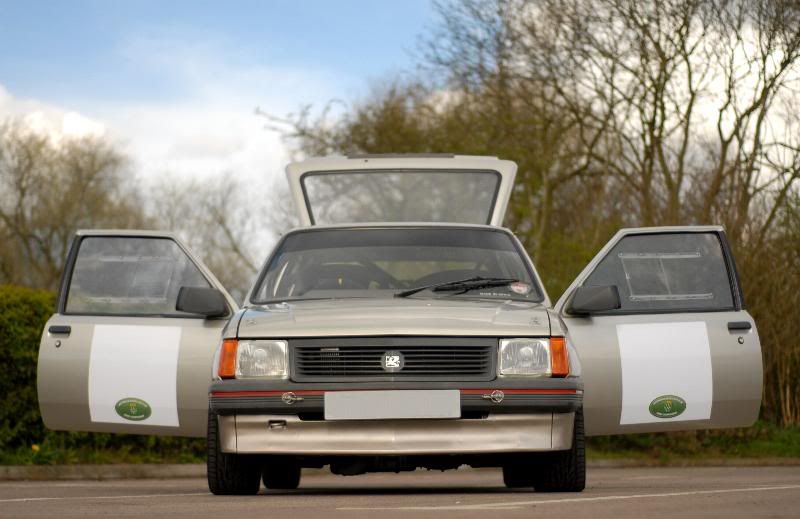

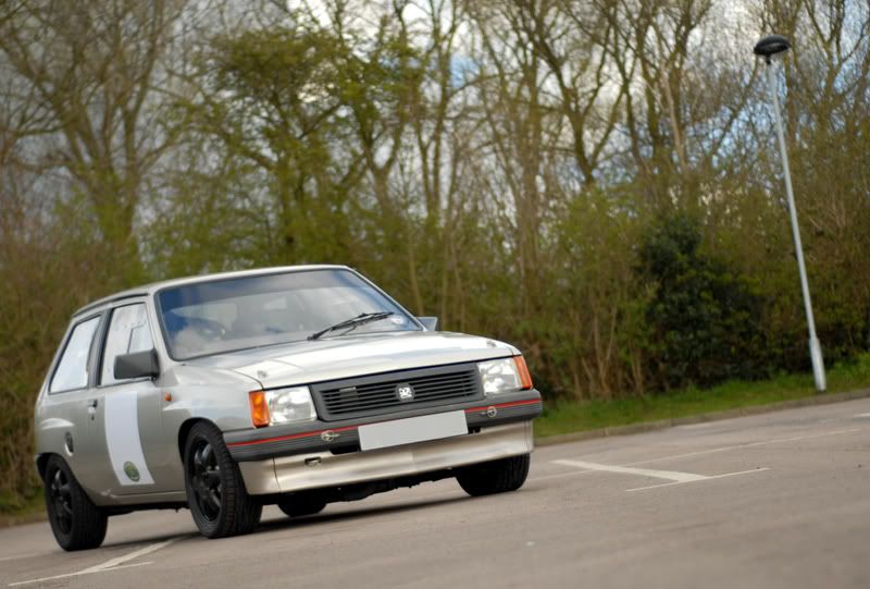

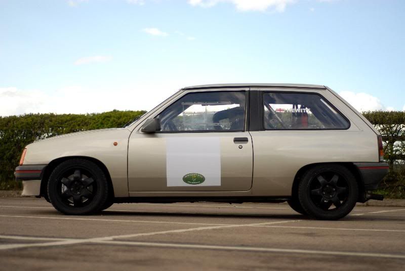

Then I fitted my FIA white square door stickers, look big - but they're the regulations of the "Blue Book", and I need them to enter stages
You have to be a part of a recognised club to get "invited" to stages, events, so I joined the NSCC, and entered their Sprint Competition
http://i136.photobucket.com/albums/q...ure/nc0675.jpg
And just because it was clean, and the stickers are new... i took some more pics, shock horror
http://i136.photobucket.com/albums/q...ure/nc0674.jpg
http://i136.photobucket.com/albums/q...ure/nc0676.jpg
http://i136.photobucket.com/albums/q...ure/nc0677.jpg
It's getting there... slowly but surely!
