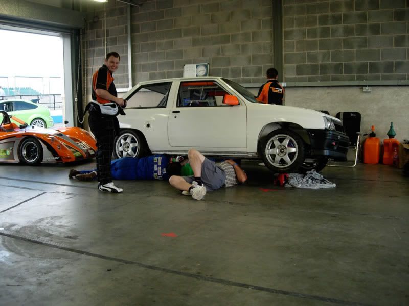

Also noticed a slight fuel leak from the blanked off return pipe on the tank, so nipped up the jubilee clip and gave it a wipe down and was all good. So out it went again this time with my dad driving. He really enjoyed it :)
Came back in and noticed my oil leaks seemed to be pretty bad! from the head down the block was lathered in oil. Tom Reid had a look over it with me and suggested I open up the the catch tank as it was restricting the breather system. So next on the list of project cure oil leaks is a new breather system.
http://img.photobucket.com/albums/v3...a/DSCN2765.jpg
