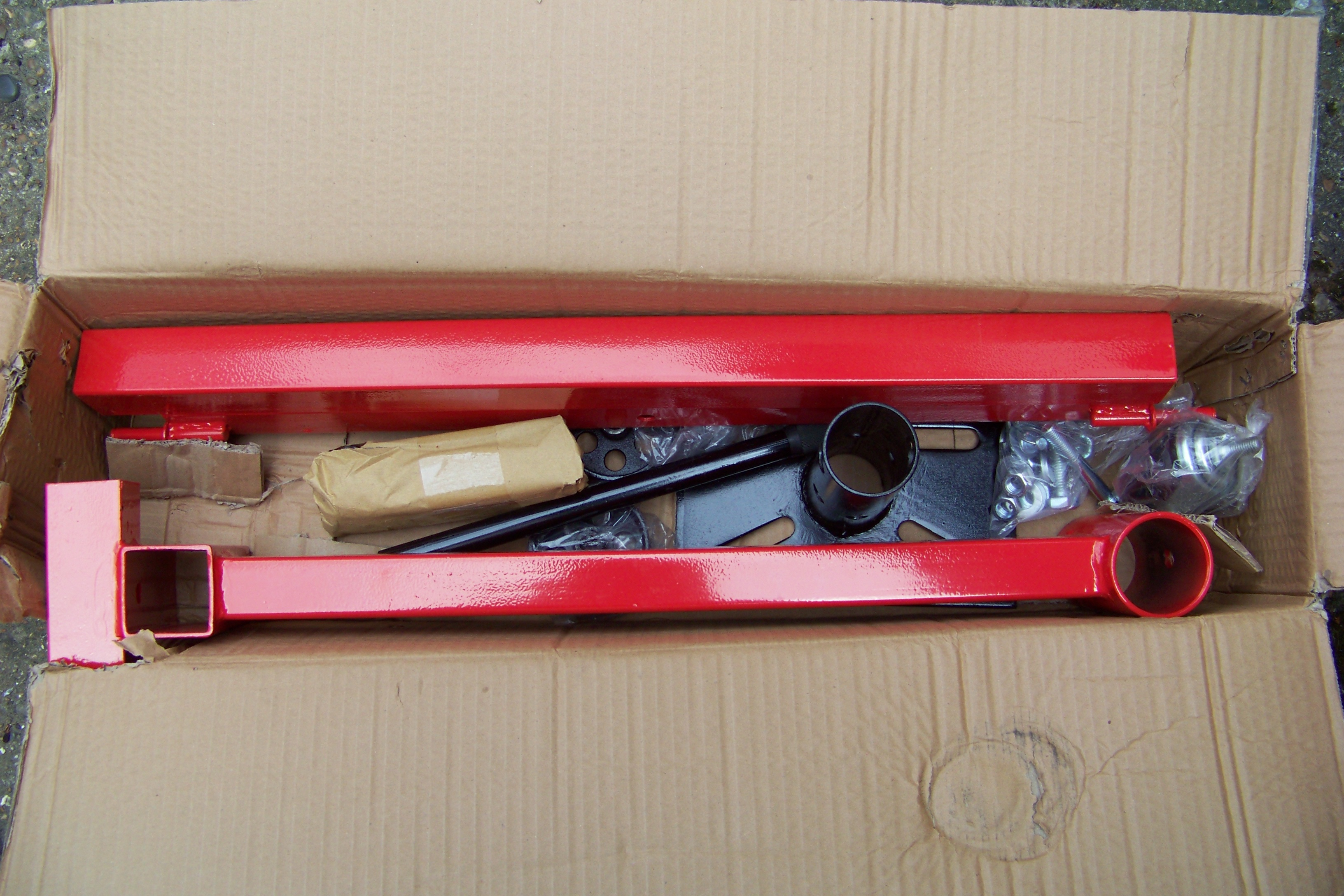

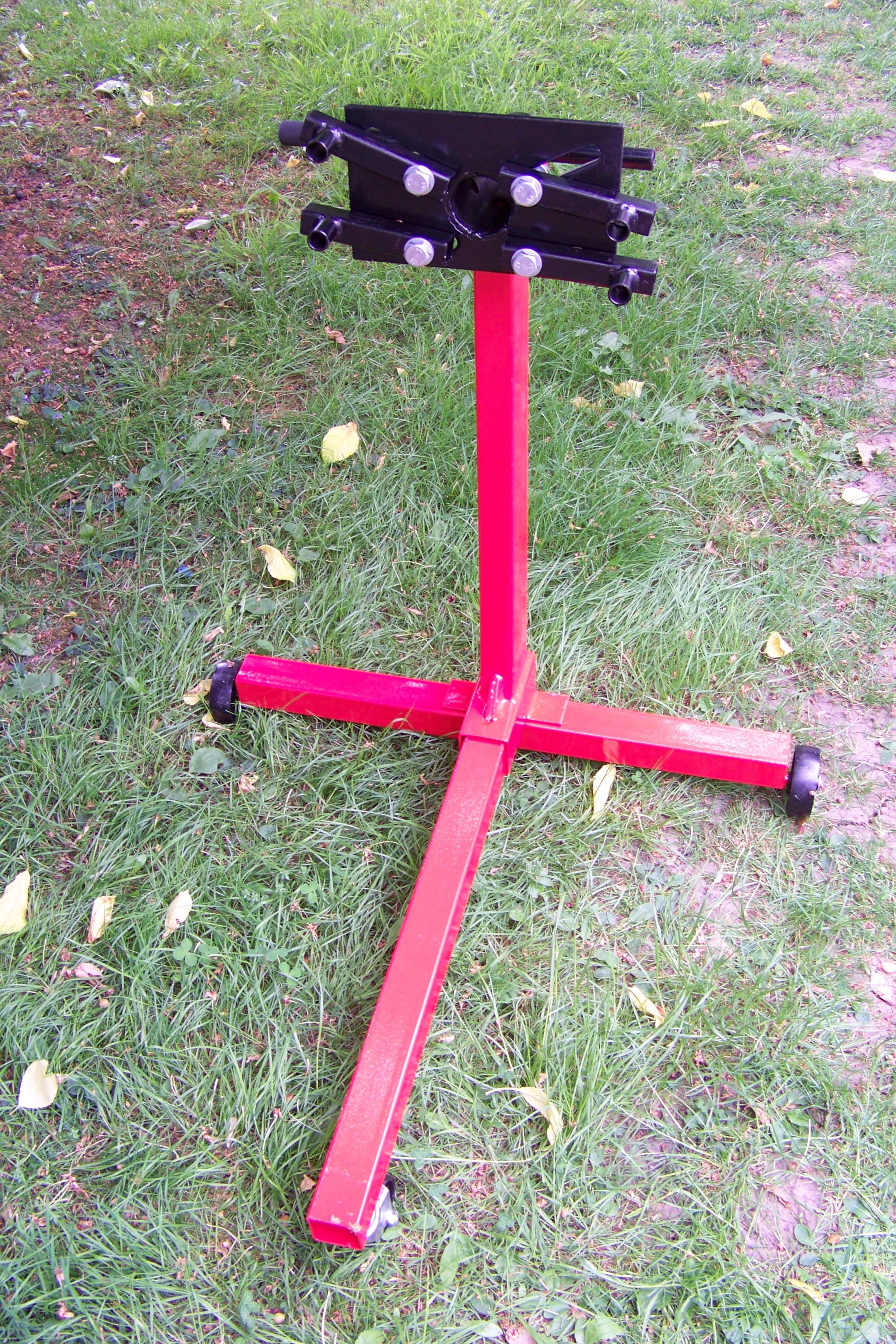

Weather has been on and off today but as there was a dry spell I assembled the engine stand.
https://images2.imgbox.com/d8/aa/AThvP7gO_o.jpg
https://images2.imgbox.com/fa/4d/jfGhzaSb_o.jpg

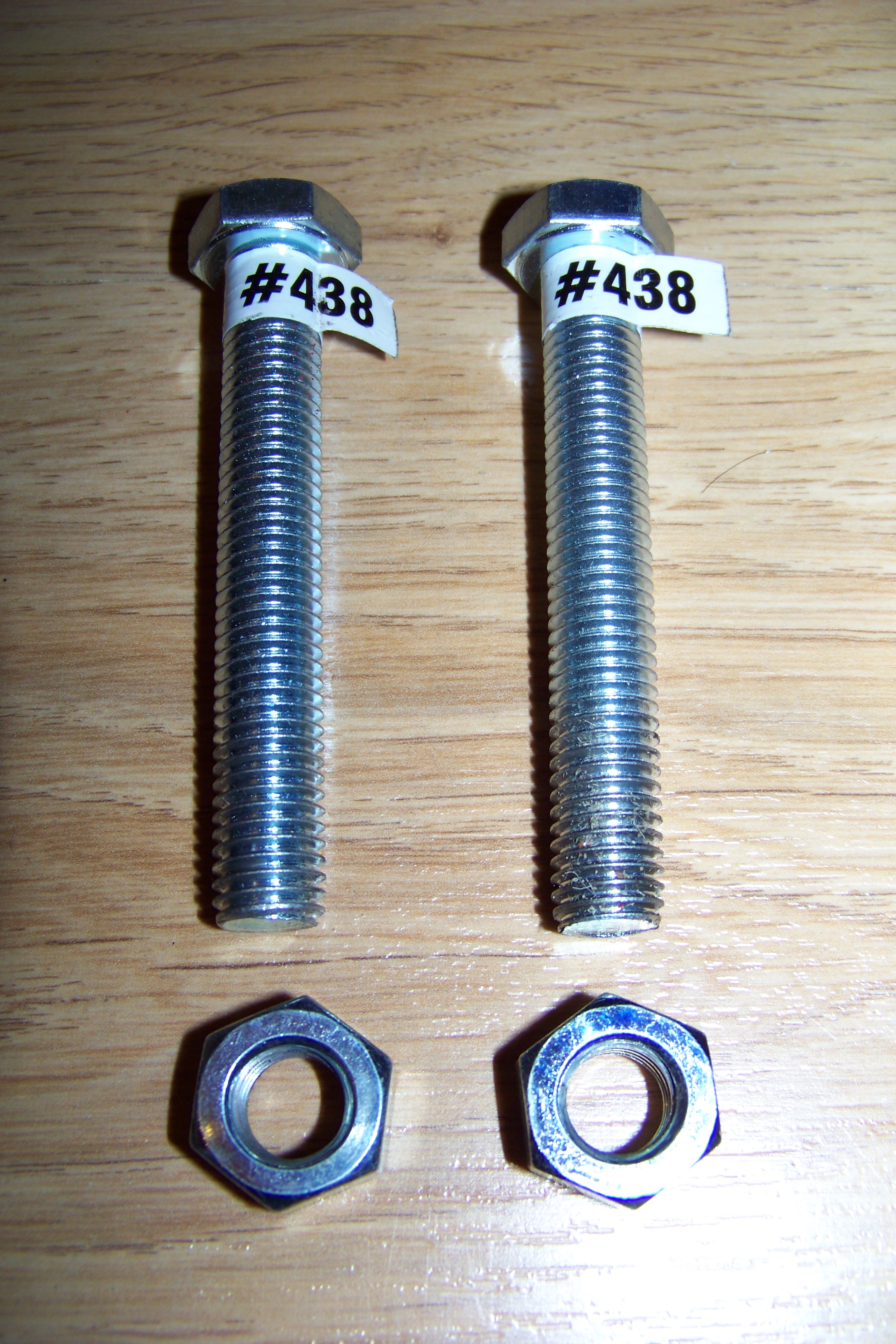

Lots of little chores today meant I was pulled away from working some more on the project. I did however get a the bolts needed to get the engine on the stand. There's me thinking that the bolts that hold the gearbox to the block will be fine... wrong! Too short!
Popped over to the nearest hardware store and got these, some long M12 bolts x2 and x4 M12 nuts:
https://images2.imgbox.com/b8/76/Aa3xTNkV_o.jpg
Together with the gearbox mount bolts, I've secured the swivel head of the engine stand to the block. Tomorrow I'll be getting a hand at lifting the LET on to the stand so the work can commence.

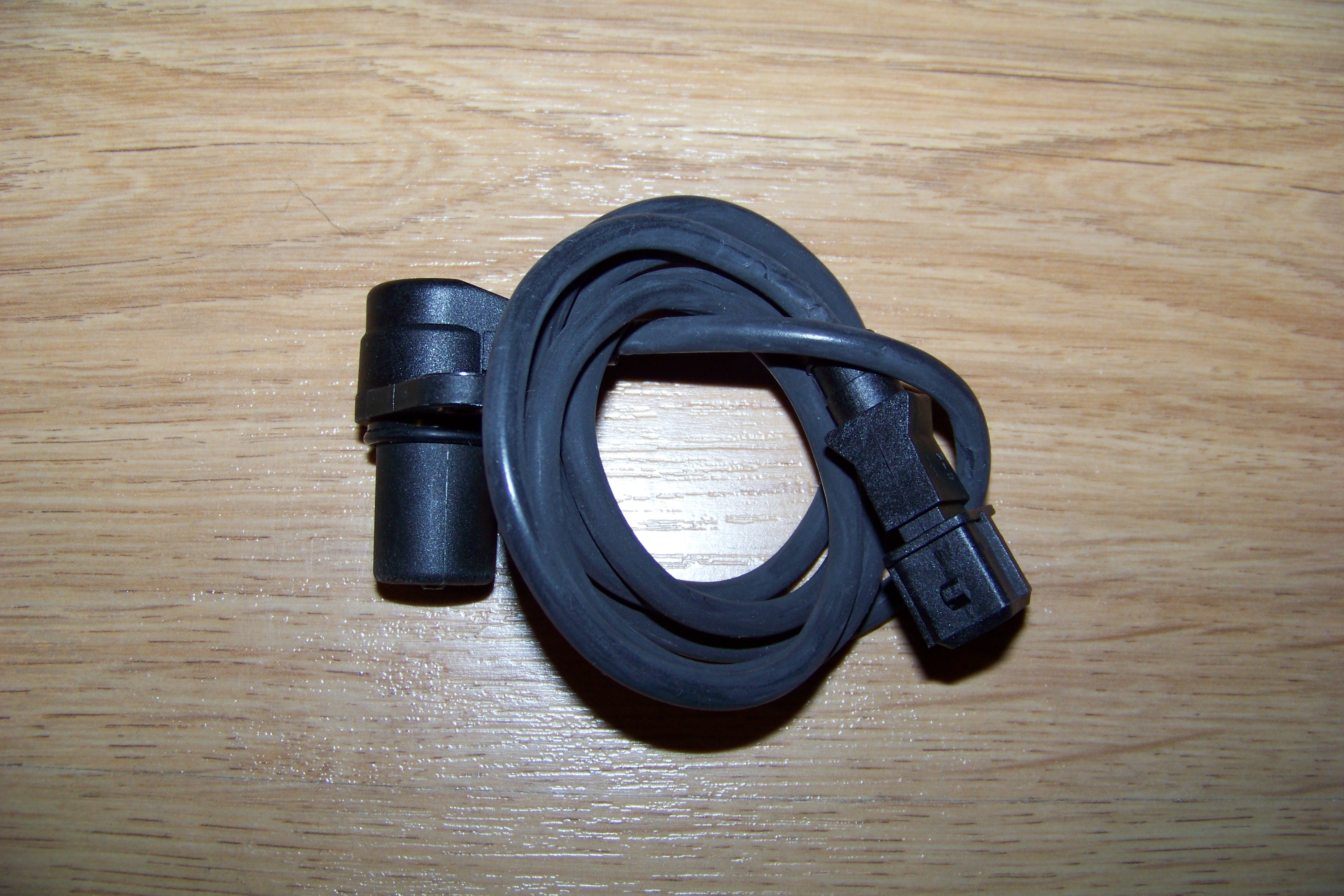

Got a few bits from Le Courier today who kindly brought me the bits I got from AutoVaux:
Crank sensor:
https://images2.imgbox.com/8c/bd/6caJg4Va_o.jpg

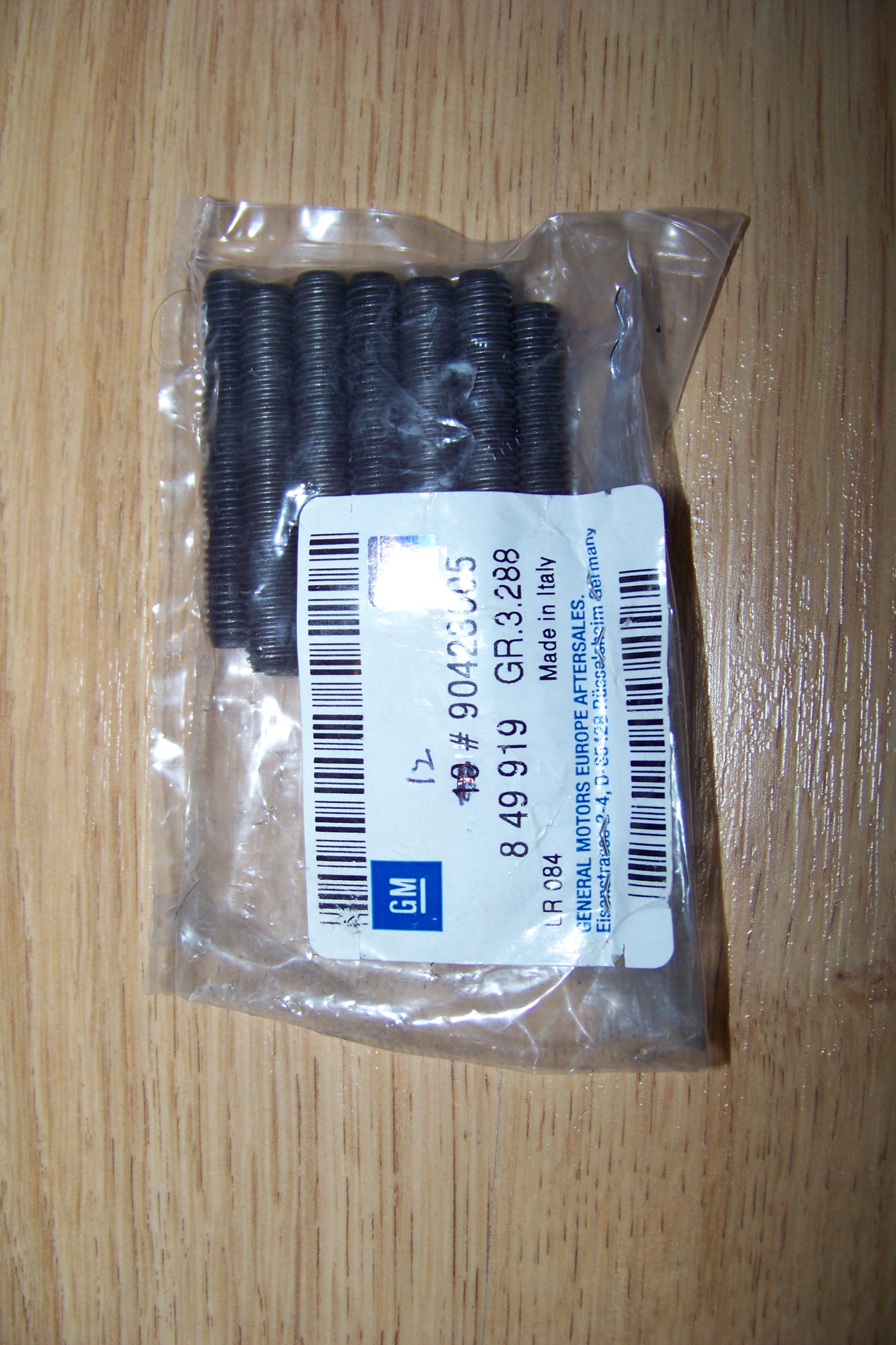

And these bad boys which I've searched high and low after finding out Vaux don't do them anymore:
12x brand new exhaust studs
https://images2.imgbox.com/48/f6/bkL9DV2Z_o.jpg

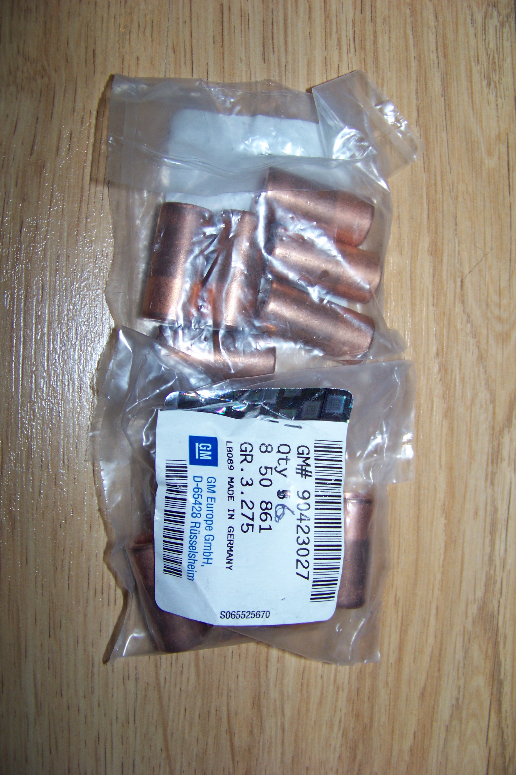

12x brand new copper exhaust manifold nuts
https://images2.imgbox.com/f2/46/MyiZA268_o.jpg

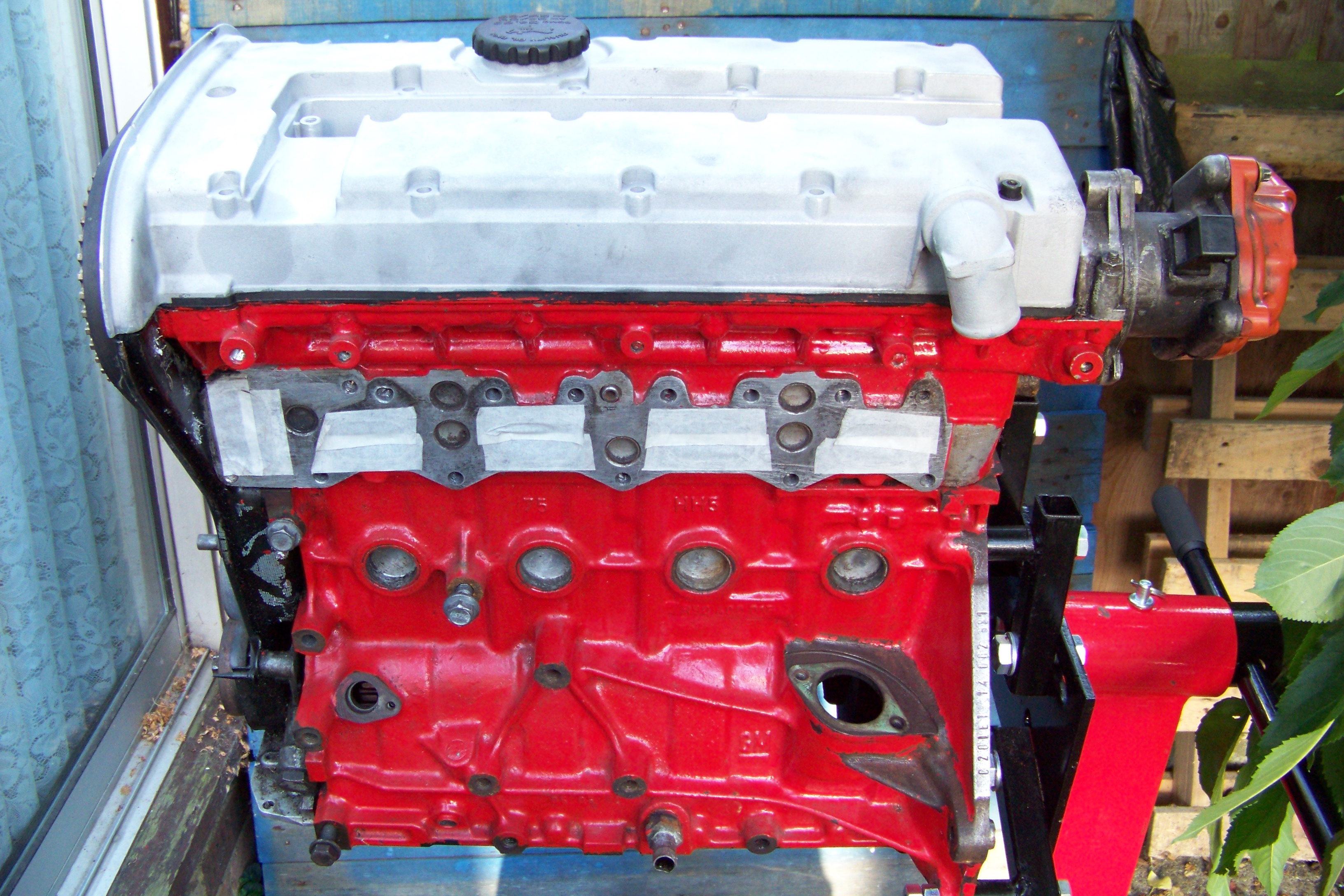

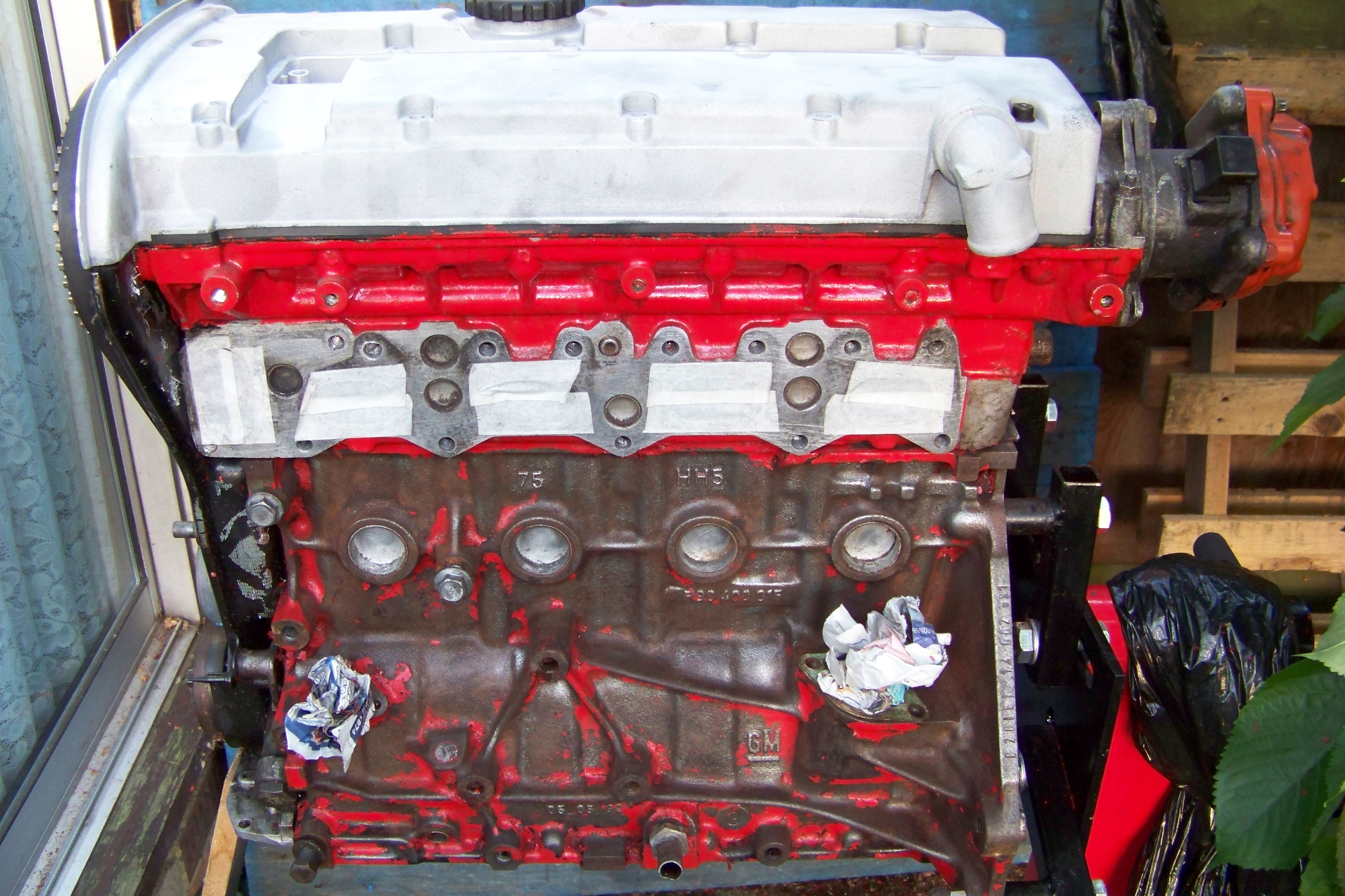

After going for a jog in the morning then dropping by to get my mobile upgrade :d I got home and together with my uncle and bro we lifted the LET by hand on to the engine stand.
https://images2.imgbox.com/8c/12/6XAQSA0b_o.jpg
http://img14.imageshack.us/img14/9476/1002346v.jpg
After a bit of a rest and some food lol I started applying some nitromoors to the block, first front then back. Left it for 15 mins then re-applied some more. Left that for 30 mins and tried stripping it with a scraper... didn't exactly work very swiftly so I got out the old wire brush and drill.
After a few mins of stripping it got to this stage.
http://img11.imageshack.us/img11/475/1002347n.jpg
https://images2.imgbox.com/a1/56/GmM8XCRf_o.jpg
I was covered in sh*t and so was everywhere else, nitromoors don't half sting when it gets on your skin. I called it a day and will continue tomorrow.

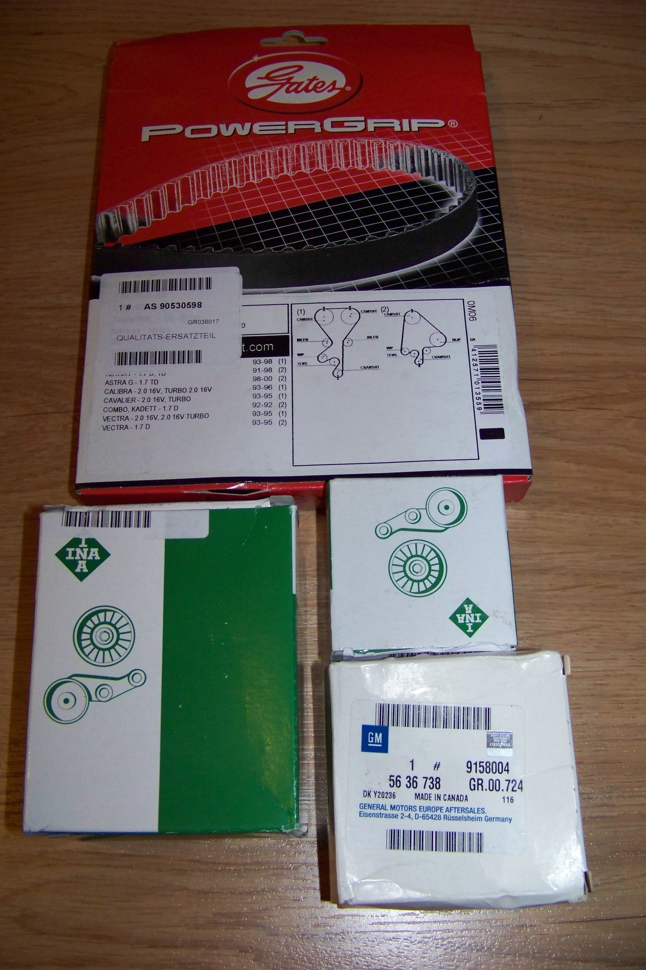

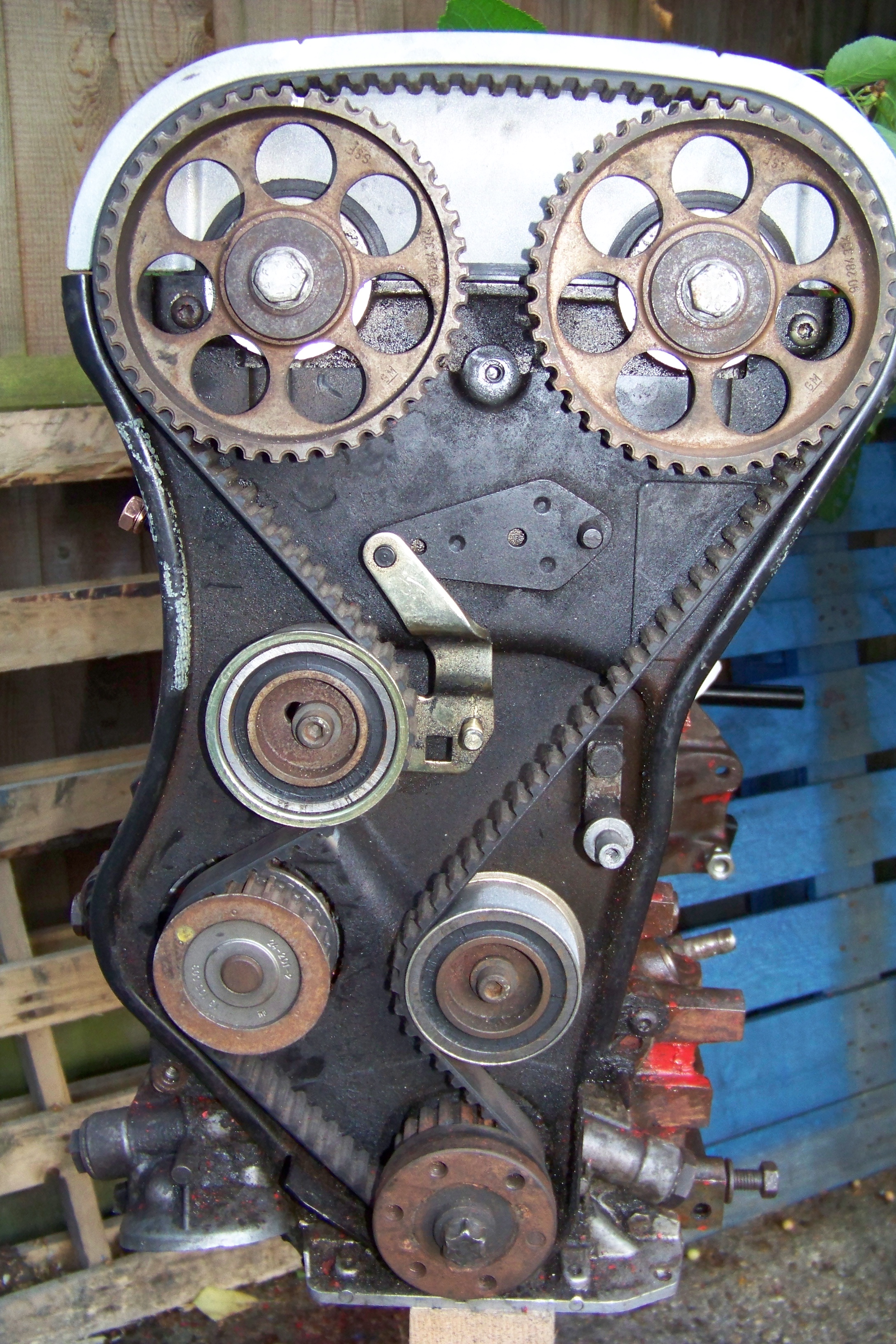

I did realise however that AutoVaux sent me the wrong timing kit so I'll need to give them a call and send it back and get the proper one.
The one they sent has two guides whereas the LET I got has one (in saying that the belt they sent had the same shaped teeth as the pulleys)
https://images2.imgbox.com/61/48/pkylCr1h_o.jpg
