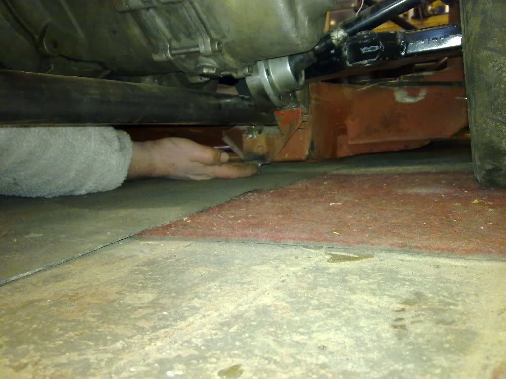

Its bloody low. You can reach over the car and touch the door on the other side. lol

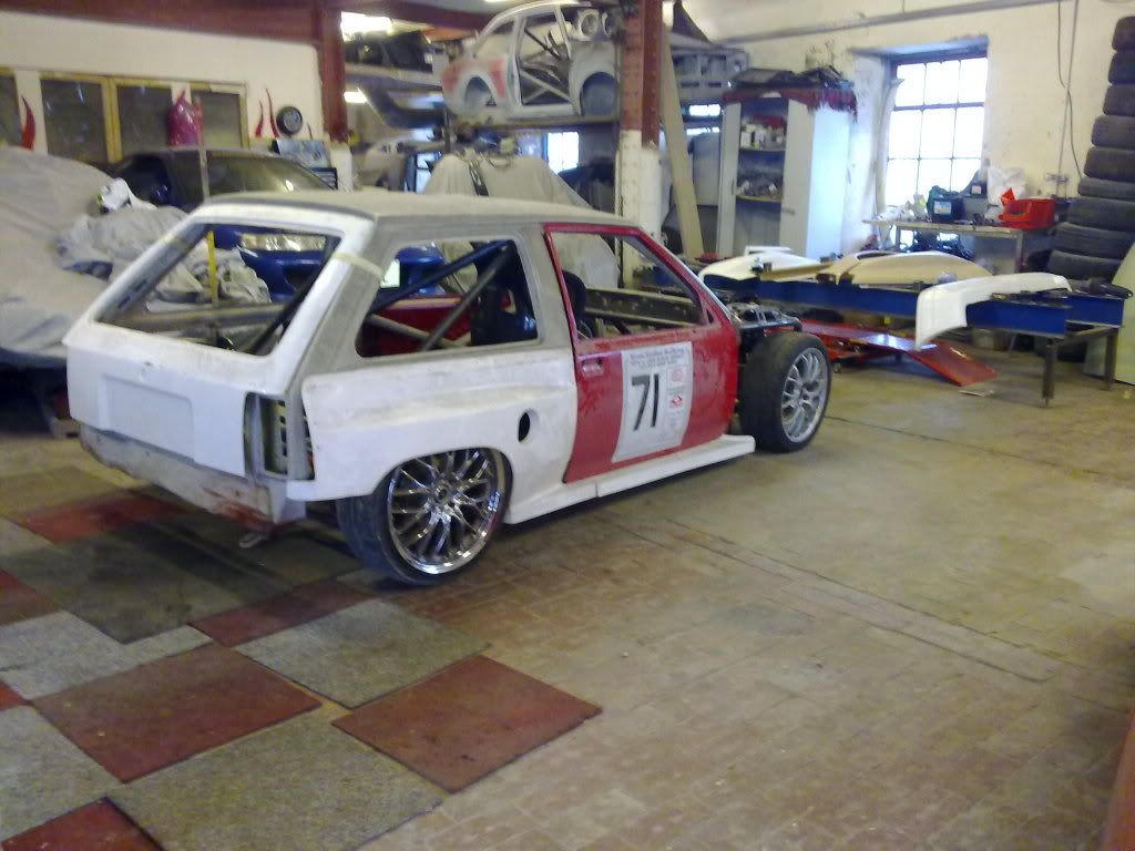

Photo time.
In no order, please excuse the wheels, the fronts are the wrong offset and the rears are bling 18's.

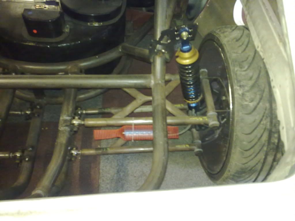

Independant rear
http://i227.photobucket.com/albums/dd315/ste_ed/17.jpg
Right side, still another tab to be cut and strut brace to be added.
http://i227.photobucket.com/albums/dd315/ste_ed/2-1.jpg
Left side
http://i227.photobucket.com/albums/dd315/ste_ed/3-1.jpg

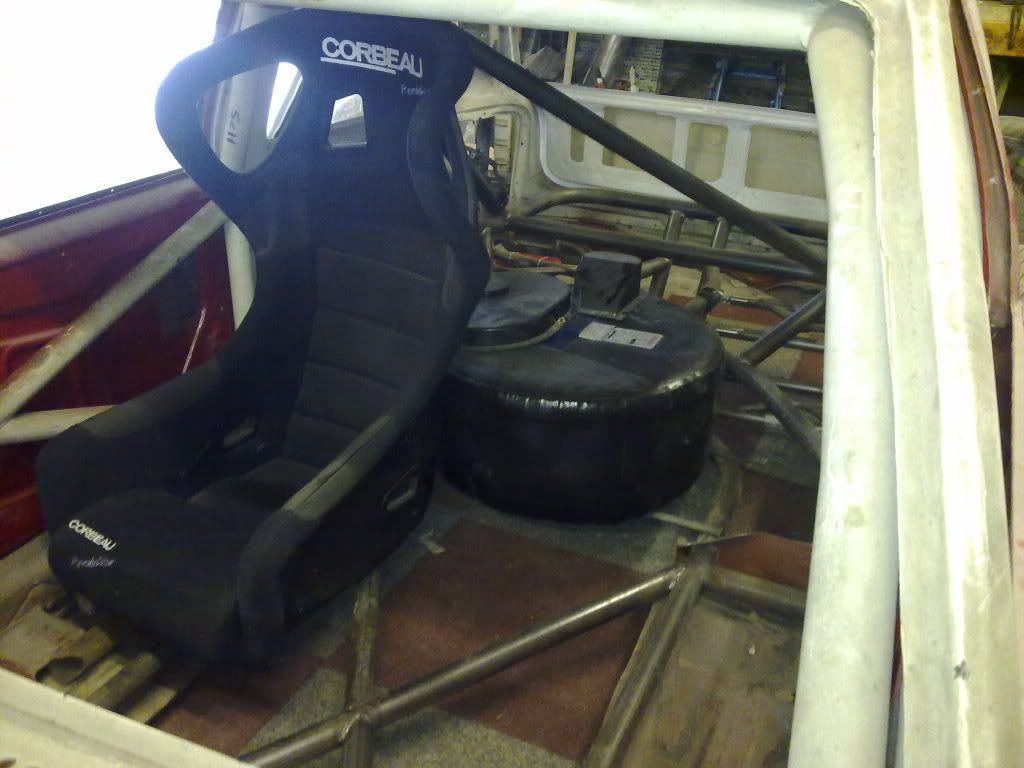

Inside, fuel tank in the centre with seat far back as possible. Flat alumiunm floor to be added.
http://i227.photobucket.com/albums/dd315/ste_ed/4-1.jpg

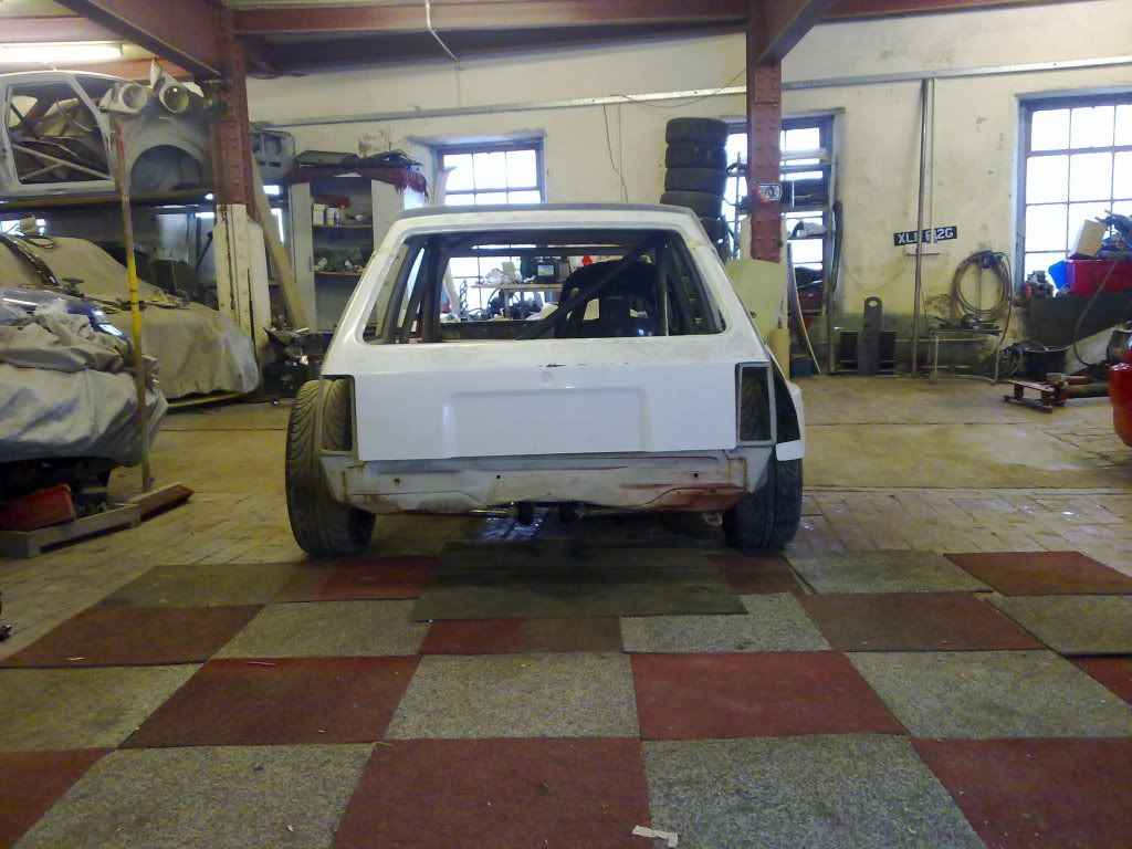

From the rear, arches are going to be made wider then moulded. PHAT
http://i227.photobucket.com/albums/dd315/ste_ed/1.jpg

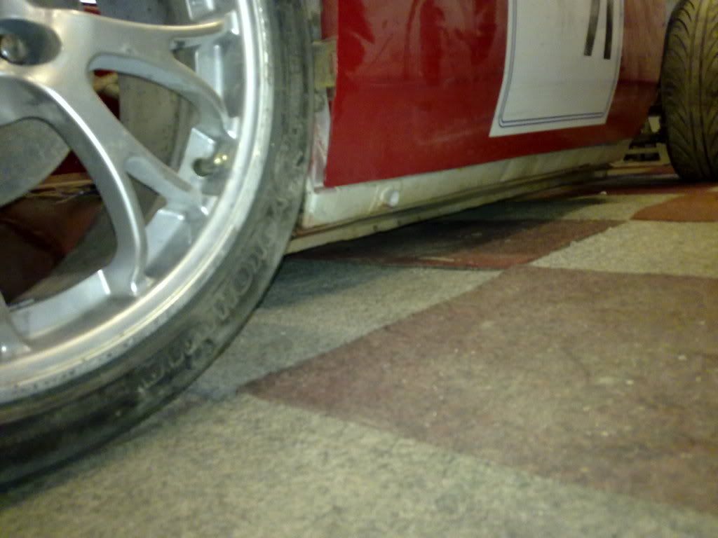

From the side
http://i227.photobucket.com/albums/dd315/ste_ed/13.jpg

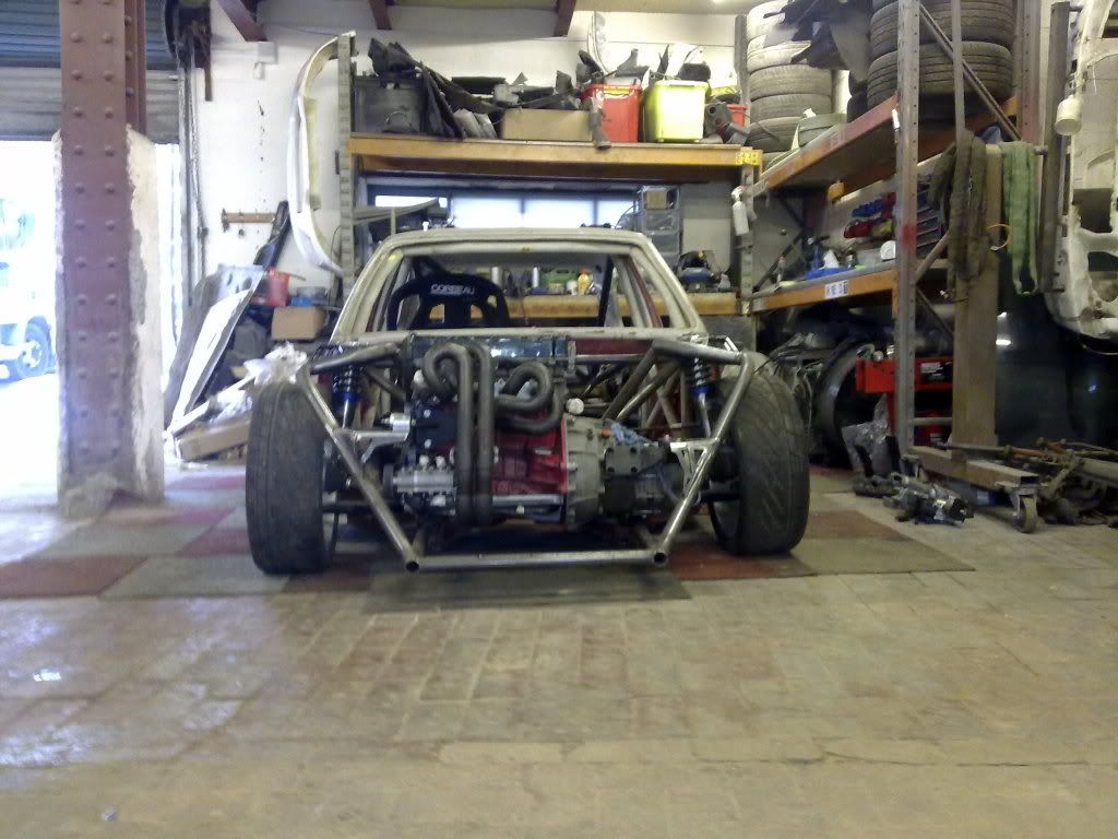

From the front
http://i227.photobucket.com/albums/dd315/ste_ed/16.jpg
http://i227.photobucket.com/albums/dd315/ste_ed/15.jpg
HOW LOW!
http://i227.photobucket.com/albums/dd315/ste_ed/5-1.jpg

This looks bloody brilliant. Loving it :) The stance on it looks ideal, what wheels are you planning on running on it then?
Keep the goodness flowing.
as above :)

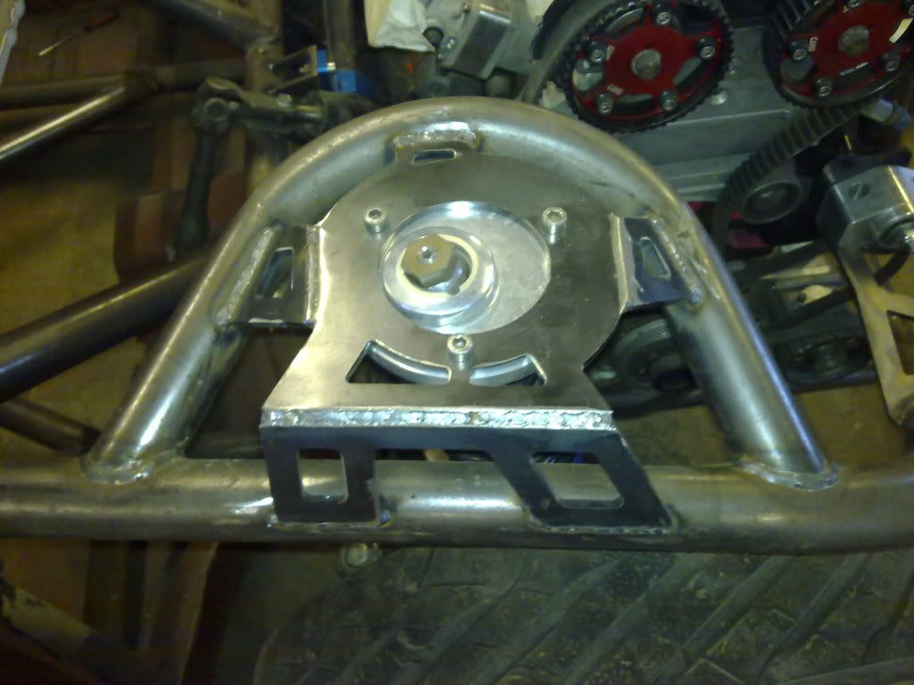

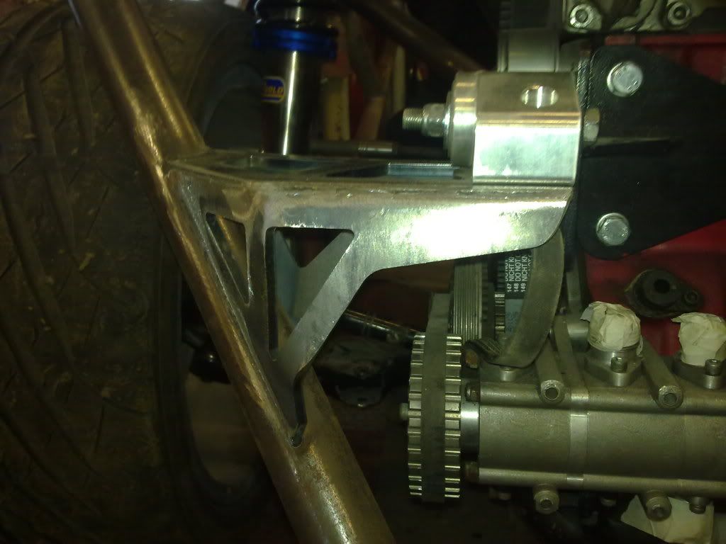

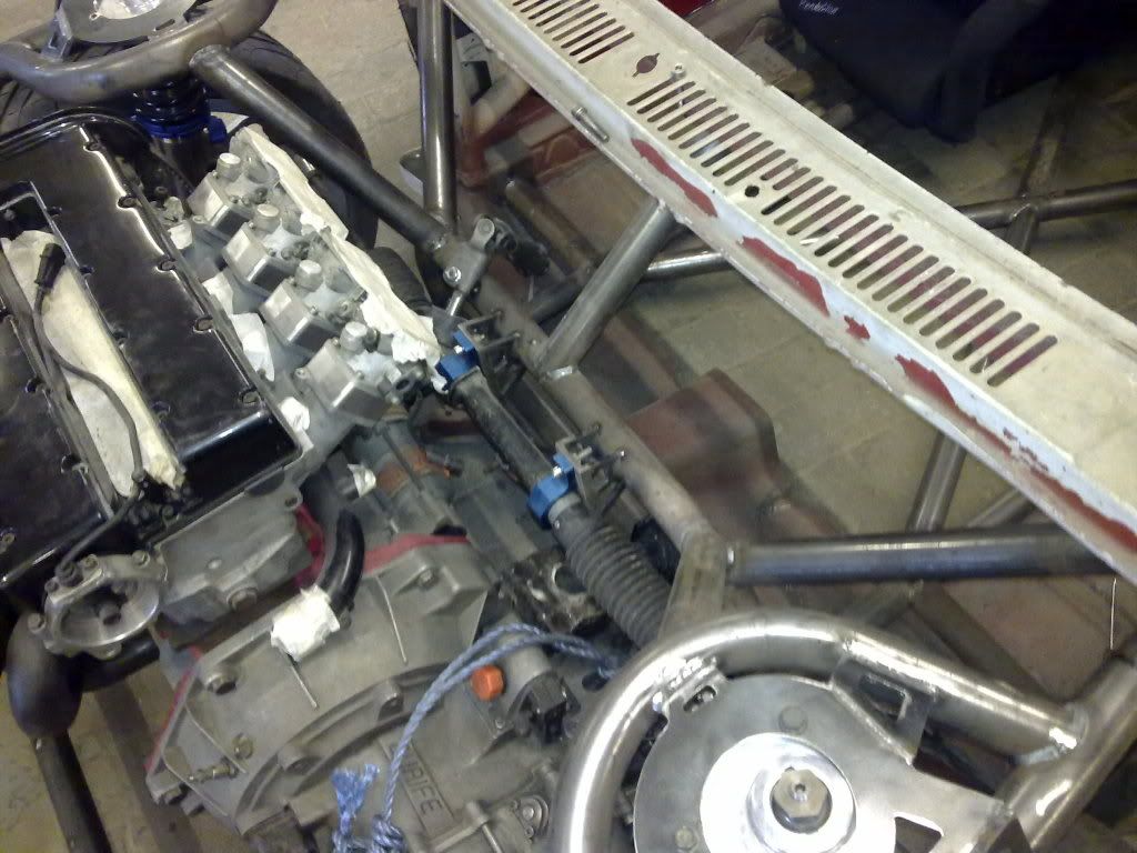

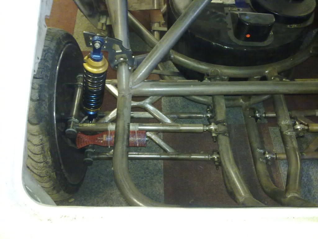

Engine mounts.
http://i227.photobucket.com/albums/dd315/ste_ed/9-2.jpg
Suspension mounts
http://i227.photobucket.com/albums/dd315/ste_ed/14.jpg
http://i227.photobucket.com/albums/dd315/ste_ed/12.jpg

Top fab work, are you worried about the angle of the drive shaft's at all, or have you figured something out to decrees it?
that thing is immence. i want
In the pictures tha shafts are not connected up.Quote:
They will sit level due to the engine not being lowered too much. Didnt want to start breaking CV's etc. It is however sat 3" further into the car so may help a little.
