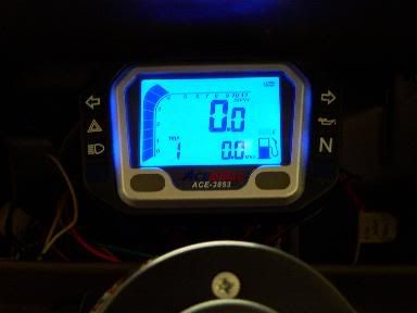

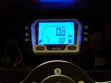

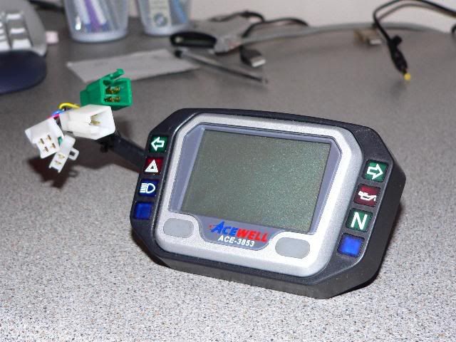

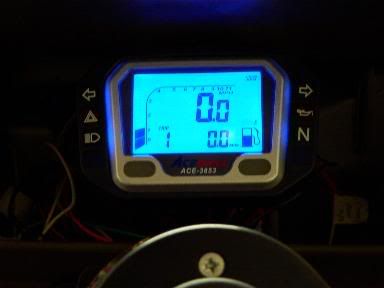

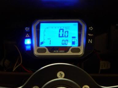

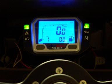

Wired in Acewell Bike Dash... after receiving electronic speedo sensor today
The dash in question
http://i136.photobucket.com/albums/q...ure/nc0476.jpg
Ignition on
http://i136.photobucket.com/albums/q...ure/nc0477.jpg

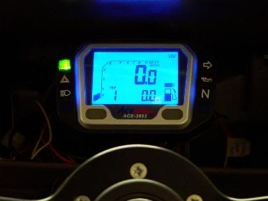

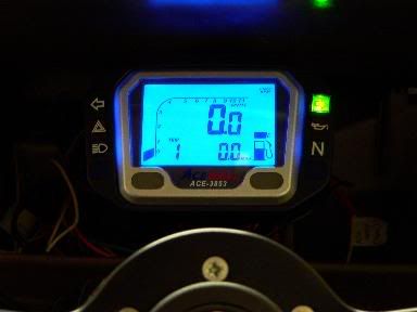

Left Indicator light
http://i136.photobucket.com/albums/q...ure/nc0478.jpg
Right Indicator light
http://i136.photobucket.com/albums/q...ure/nc0479.jpg
Hazards (altho will get actual "hazard light" wired in when i put them in properly)
http://i136.photobucket.com/albums/q...ure/nc0480.jpg
Full Beam light
http://i136.photobucket.com/albums/q...ure/nc0481.jpg
Engine ticking over
http://i136.photobucket.com/albums/q...ure/nc0482.jpg
Bruuuuuuuuum
http://i136.photobucket.com/albums/q...ure/nc0483.jpg
Just oil light to sort now, and I was going to use the neutral ("N") light, as my ECU light, but I won't have one on the MBE management, so might have that as handbrake.
Already ordered 3 seperate gauges, oil pressure, water temp and voltage, with a carbon dash pod
Think I'm going to mount it in a carbon surrounding that'll fill the gap nicely

That dash is mega cool!
Look smart Ol, what do the two buttons do?
What he said/\Quote:
Originally Posted by iainel
Cheers Scott, the buttons circulate information:
Bar Tacho
Digital Tacho
Current Speed
Top Speed
Average Speed
Shift Light
Trip Meter
Clock
Odometer
Ride Timer
Total Ride Timer

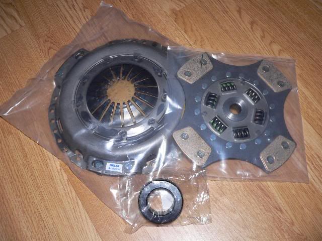

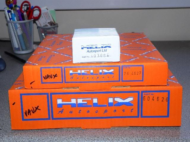

Went down to Mardi Gras Motorsport today to buy new clutch, they had it in stock on the shelf which was handy - fantastic service too
Helix boxes & part numbers should anyone else need them
http://i136.photobucket.com/albums/q...ure/nc0492.jpg
Helix Sprung 4 Paddle Friction Plate, Helix Uprated Heavy Duty Pressure Plate & CRB
http://i136.photobucket.com/albums/q...ure/nc0493.jpg
Another thing to fit before 27th lol
being sprung that clutch should be less harsh than a fixed plate?
