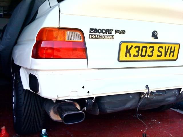

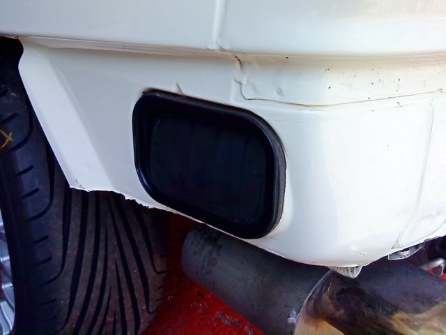

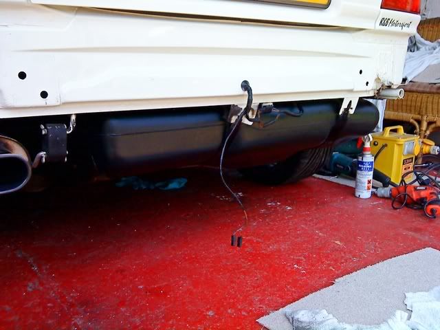

removed the rear bumper to check for rust/ clean it up/ wax oil
http://img.photobucket.com/albums/v211/dan16v/rear2.jpg
http://img.photobucket.com/albums/v211/dan16v/rear1.jpg
http://img.photobucket.com/albums/v211/dan16v/rear3.jpg

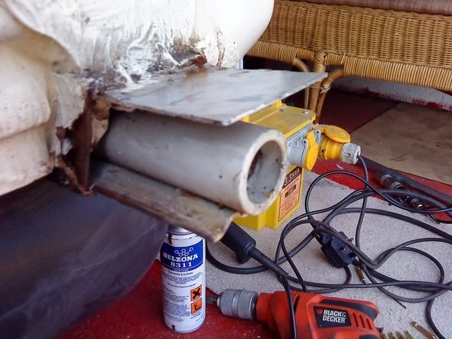

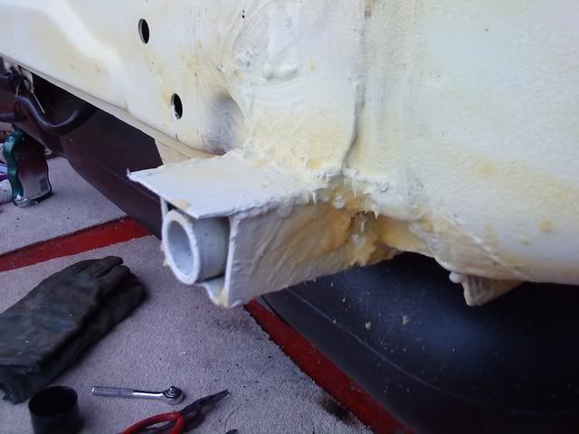

only bit found was on the towing eye which is common, so cut it out and made some plates up, then welded them on/ sealed/ painted/ wax oiled.
http://img.photobucket.com/albums/v211/dan16v/rear5.jpg
http://img.photobucket.com/albums/v211/dan16v/tow2.jpg:thumb:
