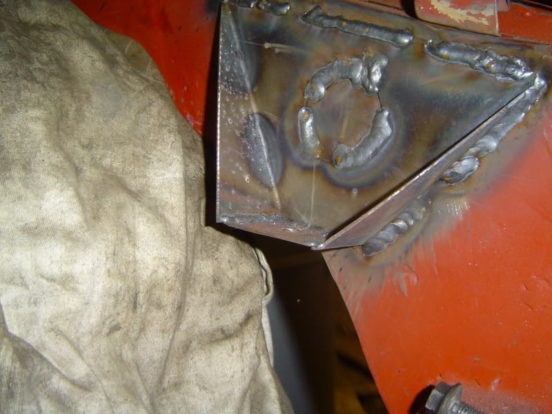

Used an astra GTE drivers side alloy mount, and then started to make the gearbox mount.
Taking the unconventional rounte....cut some steel out..
http://img.photobucket.com/albums/v1...9.jpg~original
Welded this in, and started to modify the OEM mount
http://img.photobucket.com/albums/v1...2.jpg~original
Mount sorted
