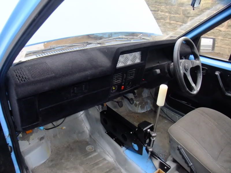

In a nutshell they had a pig of a time with the car; the shifter part of the work not really causing any problems, perhaps helped by my earlier prep work lol..?

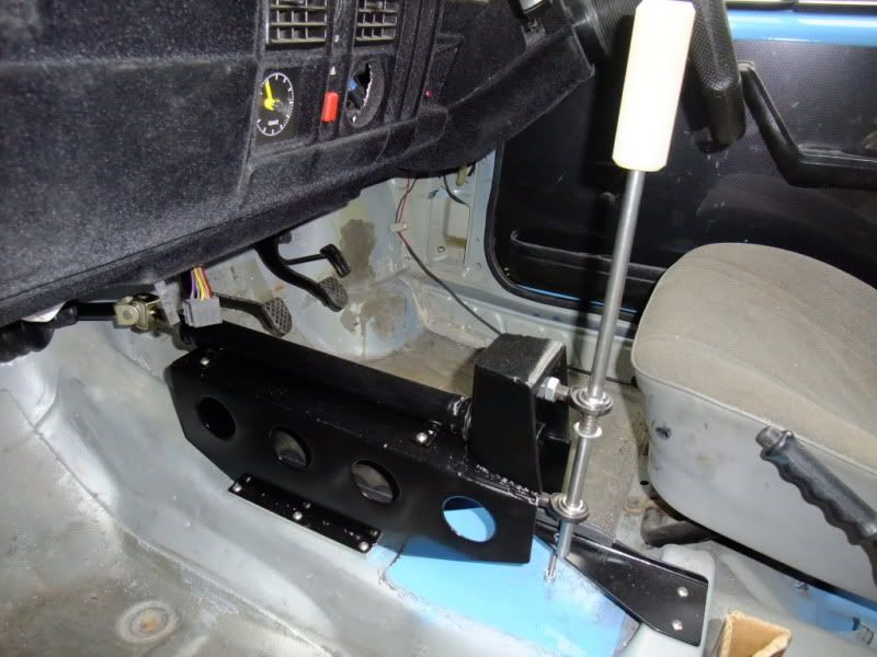

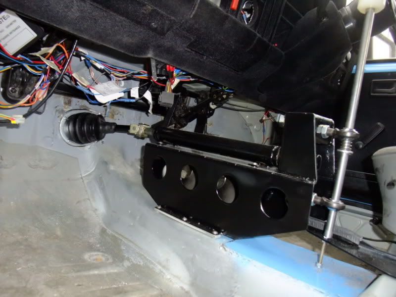

They removed the carpet support completely, nicely, painted the floor and fitted what can only be described as a pretty professional looking quaife/race carstyle shifter using the astra linkage part i supplied. And using the hole imade; as mentioned earlier and as expected – raising the floor mounting so itcleared the steering rack.

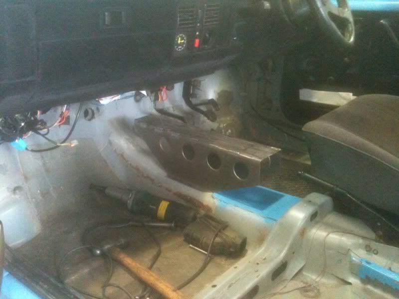

During fitting:
Cut out support, raising floor, enlarged my original hole:

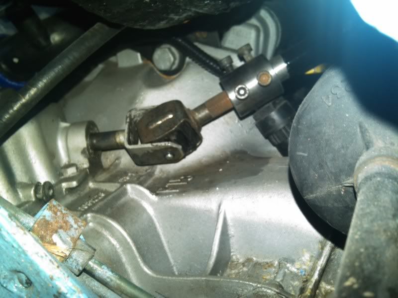

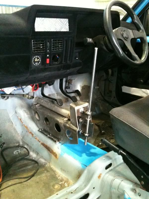

Fitted astra linkage bar, custom shifter:
http://img.photobucket.com/albums/v1...r/IMG_6460.jpg
Finished:
http://img.photobucket.com/albums/v1...1_04110010.jpg
http://img.photobucket.com/albums/v1...1_04110011.jpg
Bolted to supplied connector at selector:
http://img.photobucket.com/albums/v1...10421-2000.jpg
http://img.photobucket.com/albums/v1...1_04110009.jpg
Main thing is it works, nice and direct feeling – as it of course goes straight to the box selector itself.
Still a little to get used to it though.

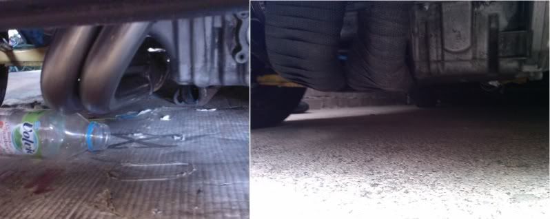

The sump first, successful with the pickup pipe (was shortened 20mm) they couldn’t work out how to avoid the top scraper baffle coming into contact with the crank counterweights. So in the end they just removed the top baffle, further modifying the other baffles so it all fit on. Seems the 1.6 sump is a very tricky to job to do to the 1.8; on top of that they did it still with engine insitu, in the ‘bay, overhead :-s
Then the manifold: basically with the new flange being fitted elsewhere, with no engine/template as a reference – it naturally got fitted a few mm ‘out’ so they needed to find those few ‘mm’ here n there; bodywork and amongst other jiggery pokery. Also took them a few attempts to get it on.
The end result though is a great deal more ground clearance. Not to mention i now have a better 4-2-1 design manifold thats 2.5” bore; they had to cone down to the 2” magnex system the car has so a bigger exhaust is on the cards one day. Also the car is now lambda-ready for mapping.

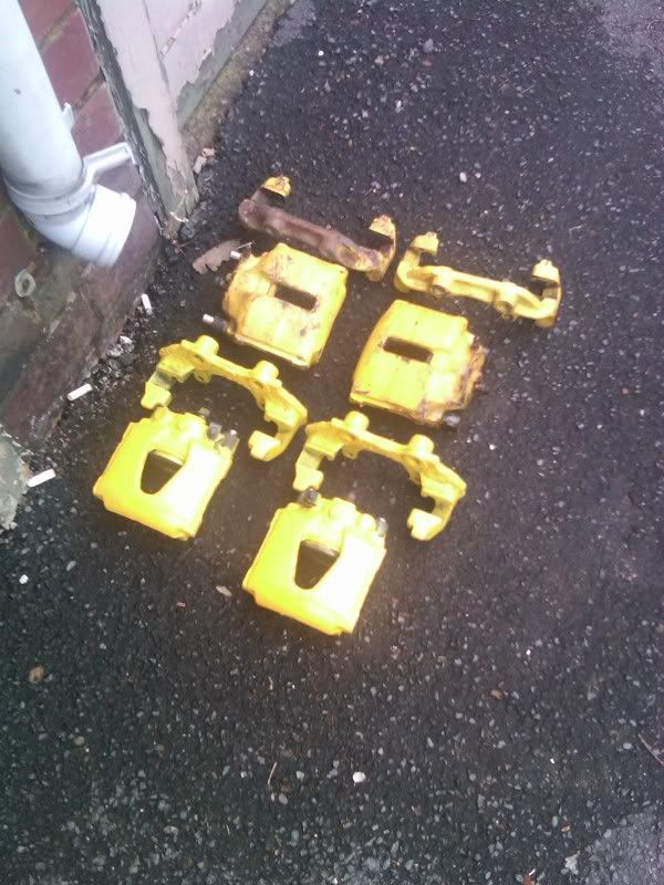

Retropower were going to MOT and TAX the car for me but the old rarely used ATE capliers on the car had seized. To keep costs down and not waste anymore of they’re time i got the car recovered back again, and after one or two hiccups (again as mentioned in technical thread of recent) with sourcing some used actual 256mm ATE callipers. Was incorrectly send smaller ones; ended up with a right plie of callipers now lol
http://img.photobucket.com/albums/v1...10507-1514.jpg
Eventually won some off ebay for £1, collected and theyre correct, in good nick; but not yellow.. yet lol. Fitted them anyway, just to be able to get the car driven round nearby, for the first time in almost a year :-s Which of course was great fun.
