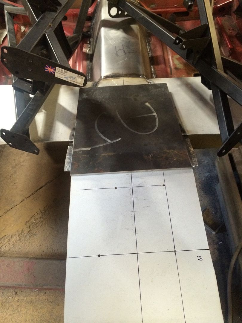

Nowt can move anyway.Class 6 novas at grassing are built the same.As long as you work off a centreline its all good.

went over to the shop today dropped some parts off, quarters and some 6mm plate to hold the diff. He's made a start with the back end, tubs and turrets will be here tomorrow hopefully so looks like it's full steam ahead.
