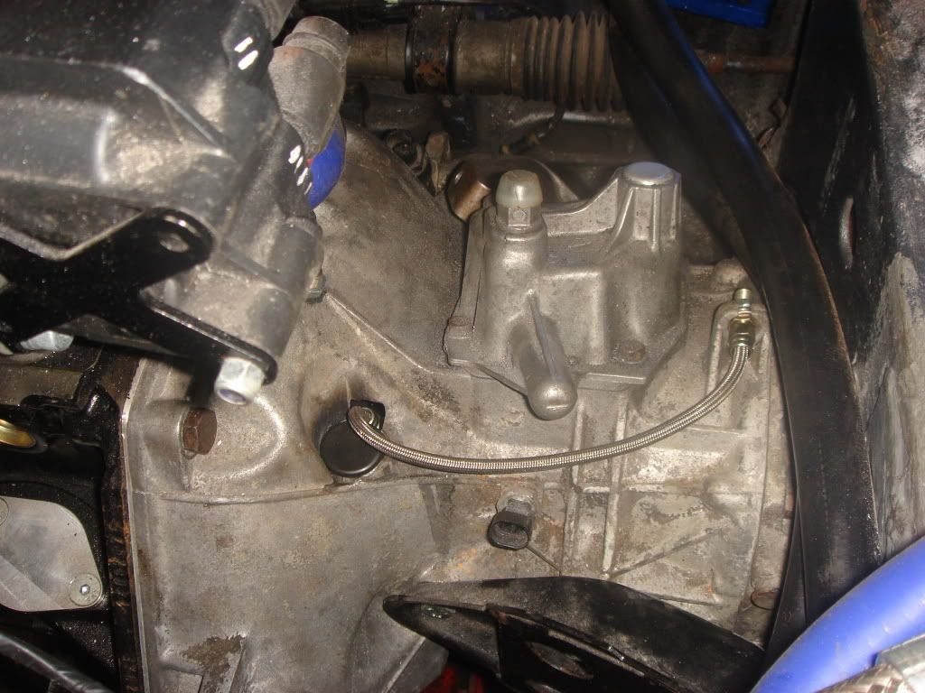

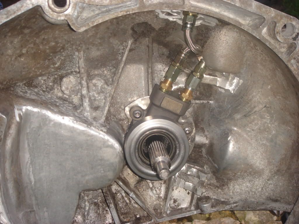

Hydraulic bearing fitted with pipes connected.
http://i761.photobucket.com/albums/x...0/DSC04045.jpg

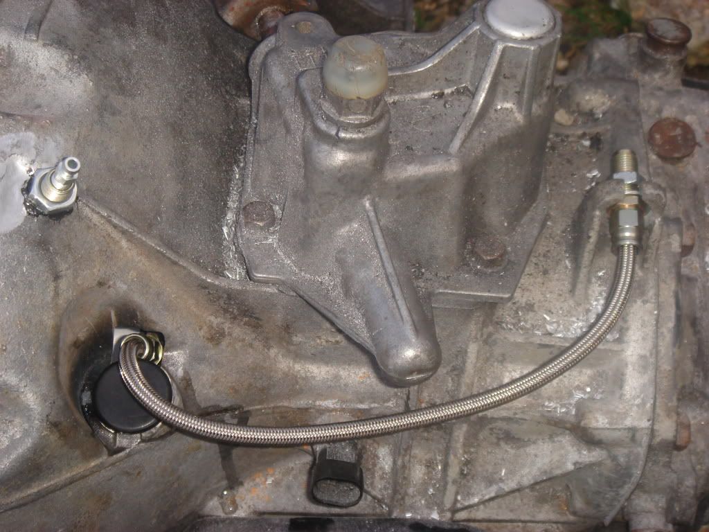

Pipes coming out of the box, utilising the old clutch cable fork as the mount and the bleed valve which sits just under the water pipes for protection.
http://i761.photobucket.com/albums/x...0/DSC04046.jpg
Finished product, engine back on its mounts
http://i761.photobucket.com/albums/x...0/DSC04050.jpg

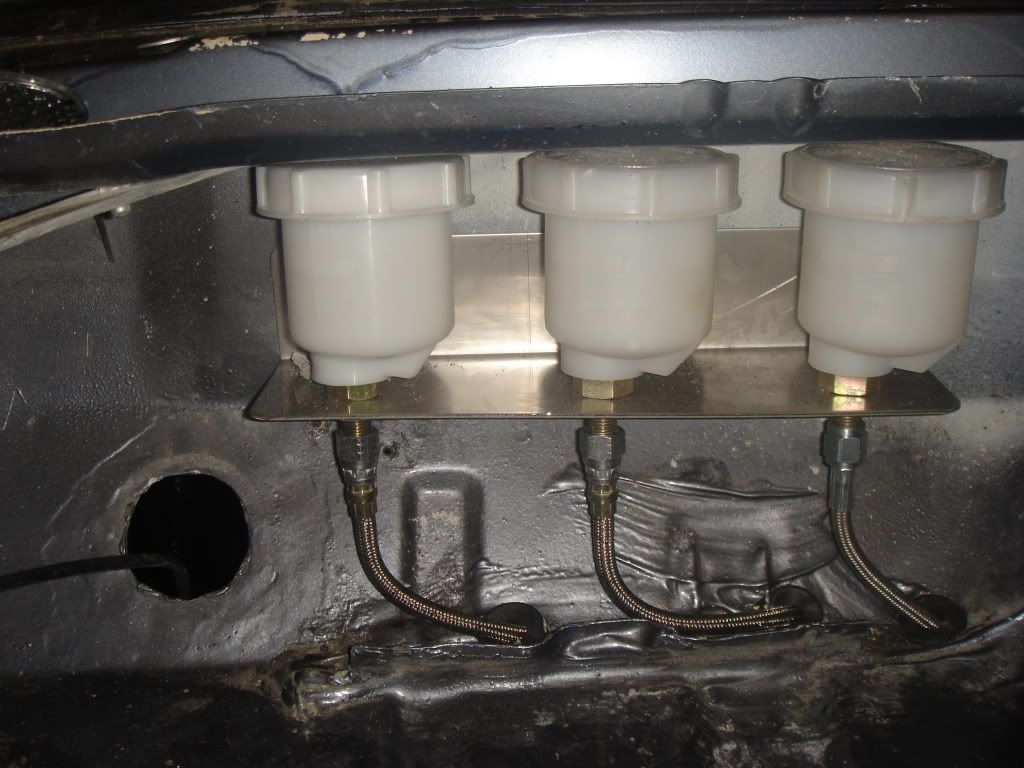

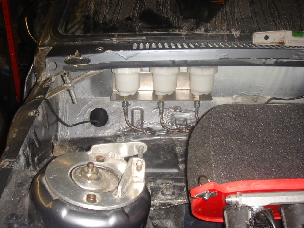

I started by fitting the three reservoirs for the pedal box.
http://i761.photobucket.com/albums/x...0/DSC04073.jpg
Where they sit

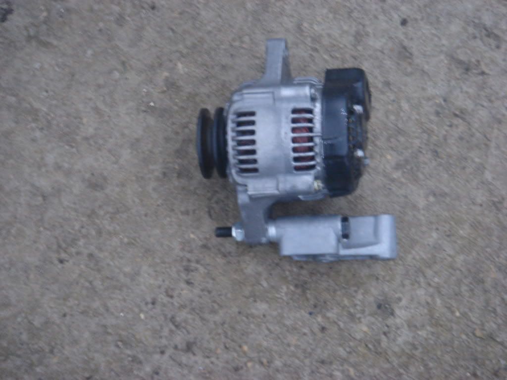

I bought a SBD little alt kit from a guy on another fourm aswell
http://i761.photobucket.com/albums/x...0/DSC04069.jpg

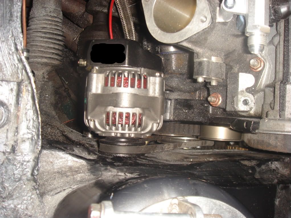

Fitted it may take som jiggling
http://i761.photobucket.com/albums/x...0/DSC04071.jpg

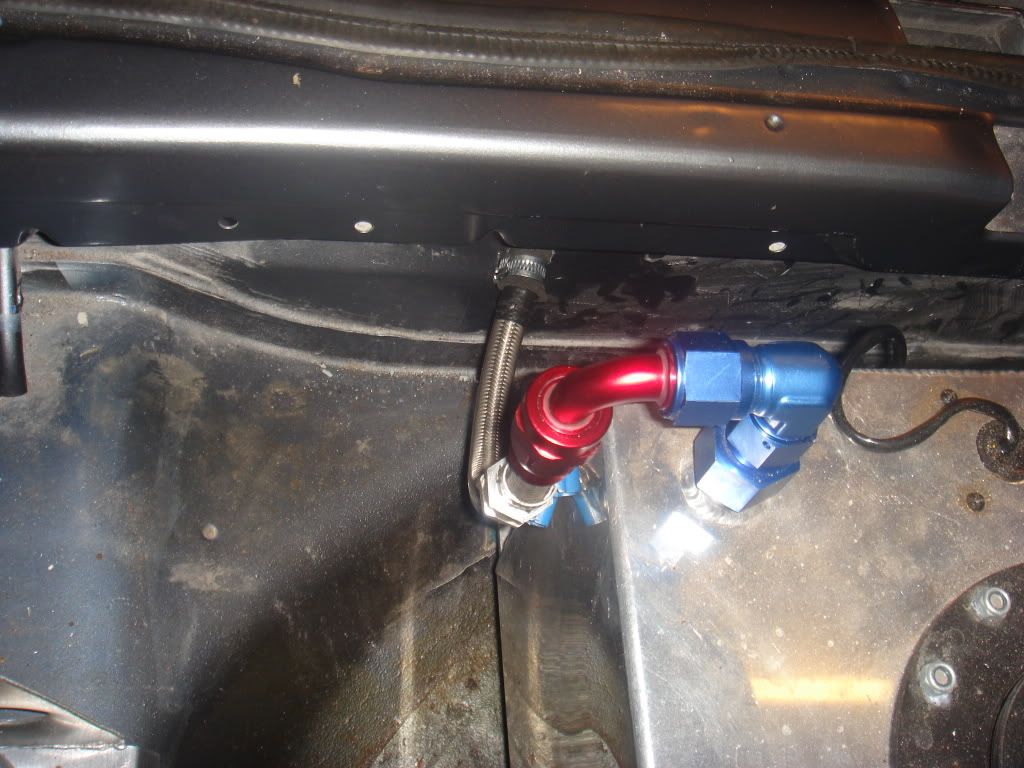

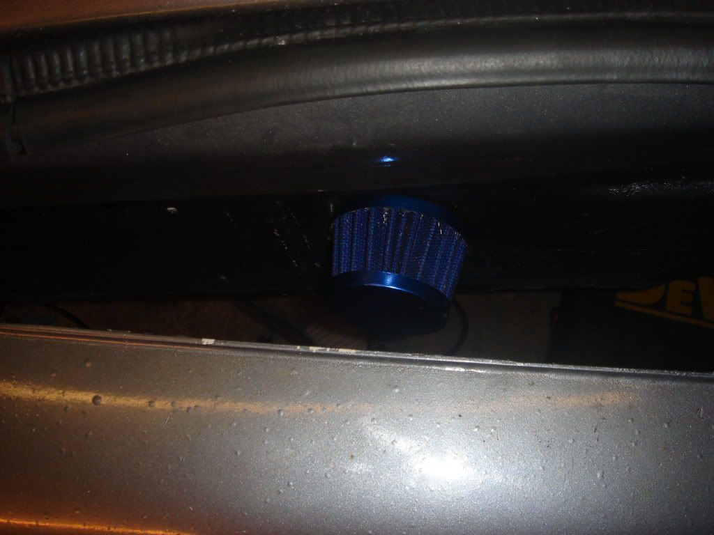

Finally i finished the breather for the fuel tank. I hid a filter behind the bumper
http://i761.photobucket.com/albums/x...0/DSC04074.jpg
Then i piped it up to the tank with a non return valve
http://i761.photobucket.com/albums/x...0/DSC04075.jpg
