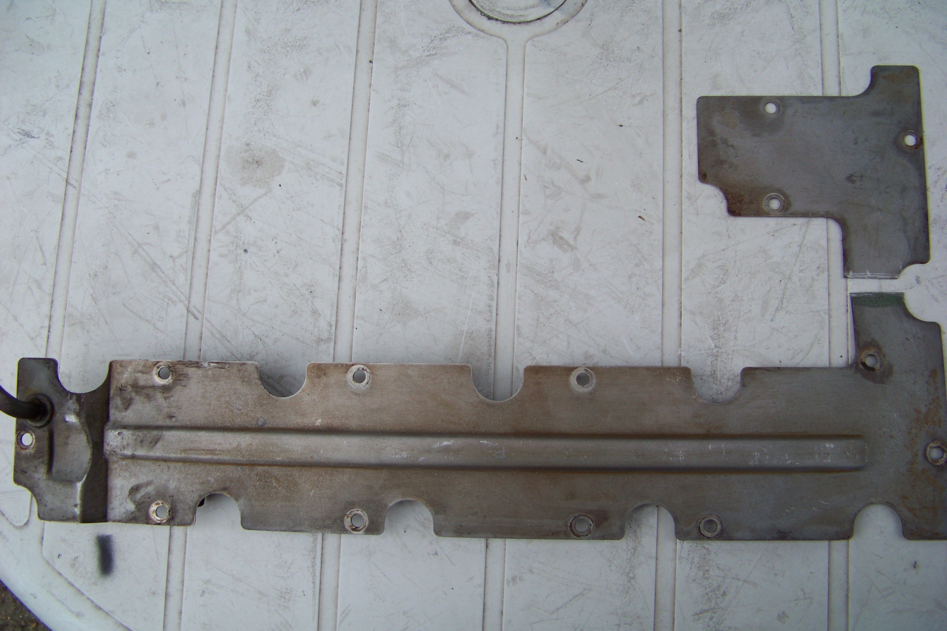

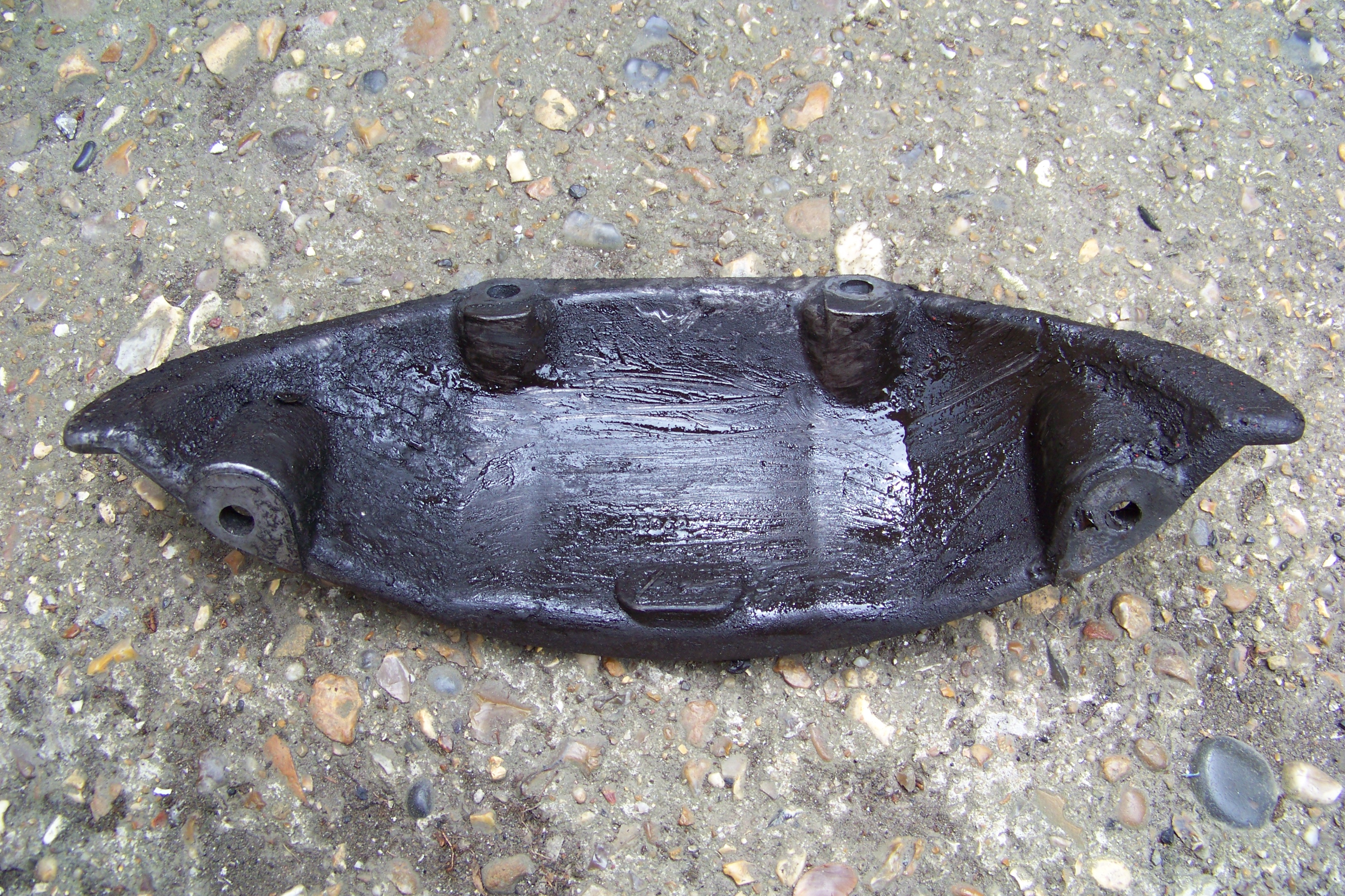

Got back home from work today and thought I'd do the breather mod.

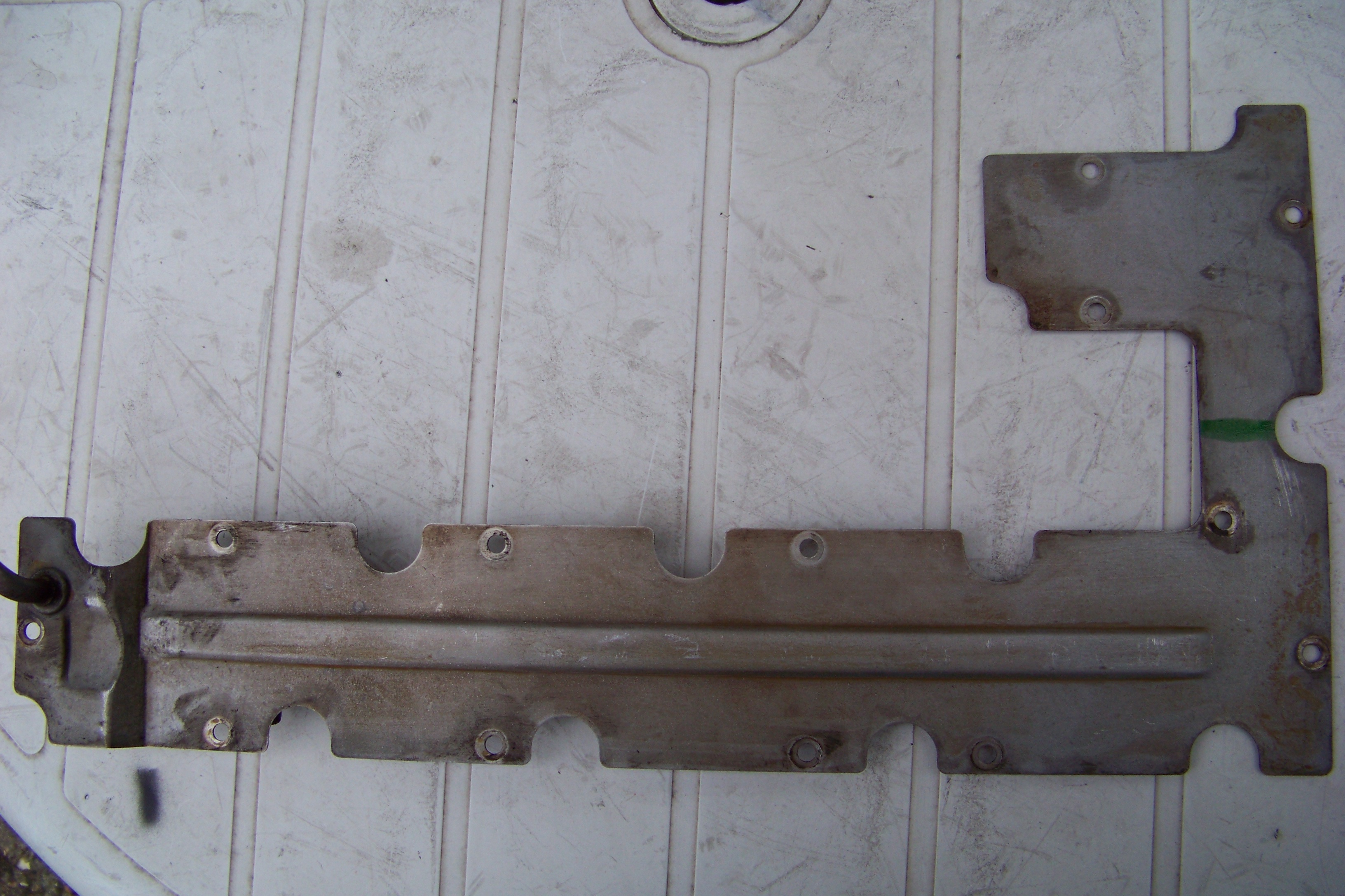

Marked where I wanted to cut the plate
https://images2.imgbox.com/72/f2/l91ylqQ2_o.jpg
Then using a small hacksaw I cut it down to size
https://images2.imgbox.com/a9/76/M21ZbK7h_o.jpg

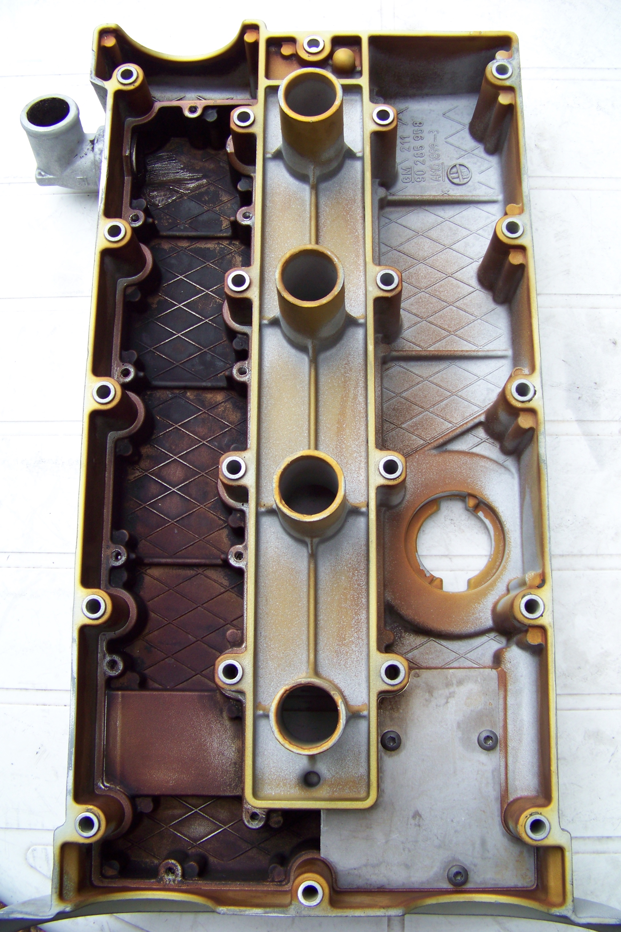

I then checked over the rocker and removed any sealant, dust, dirt left over and then re-fitted the modified plate
https://images2.imgbox.com/b2/68/ctnTRiaM_o.jpg

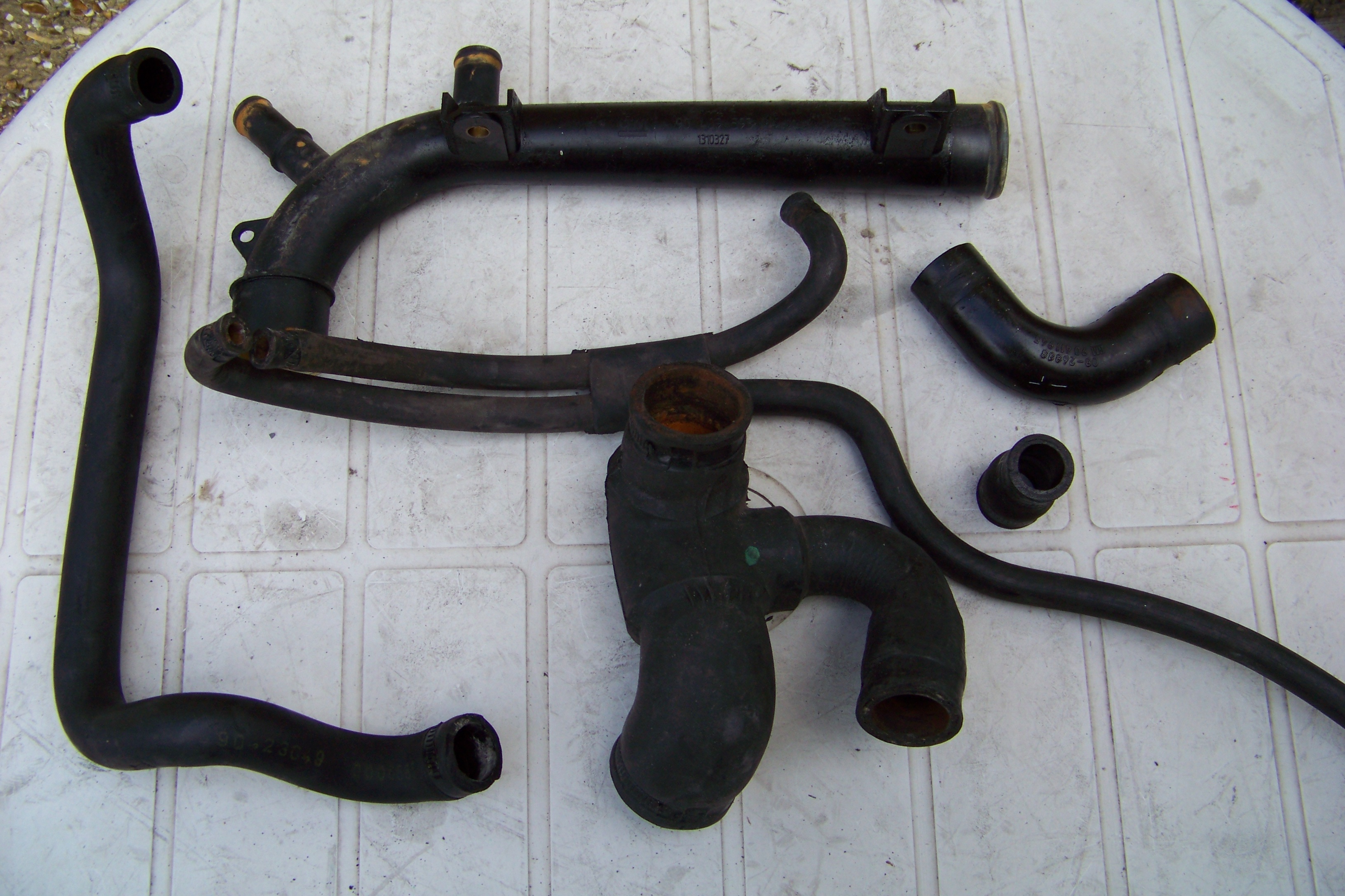

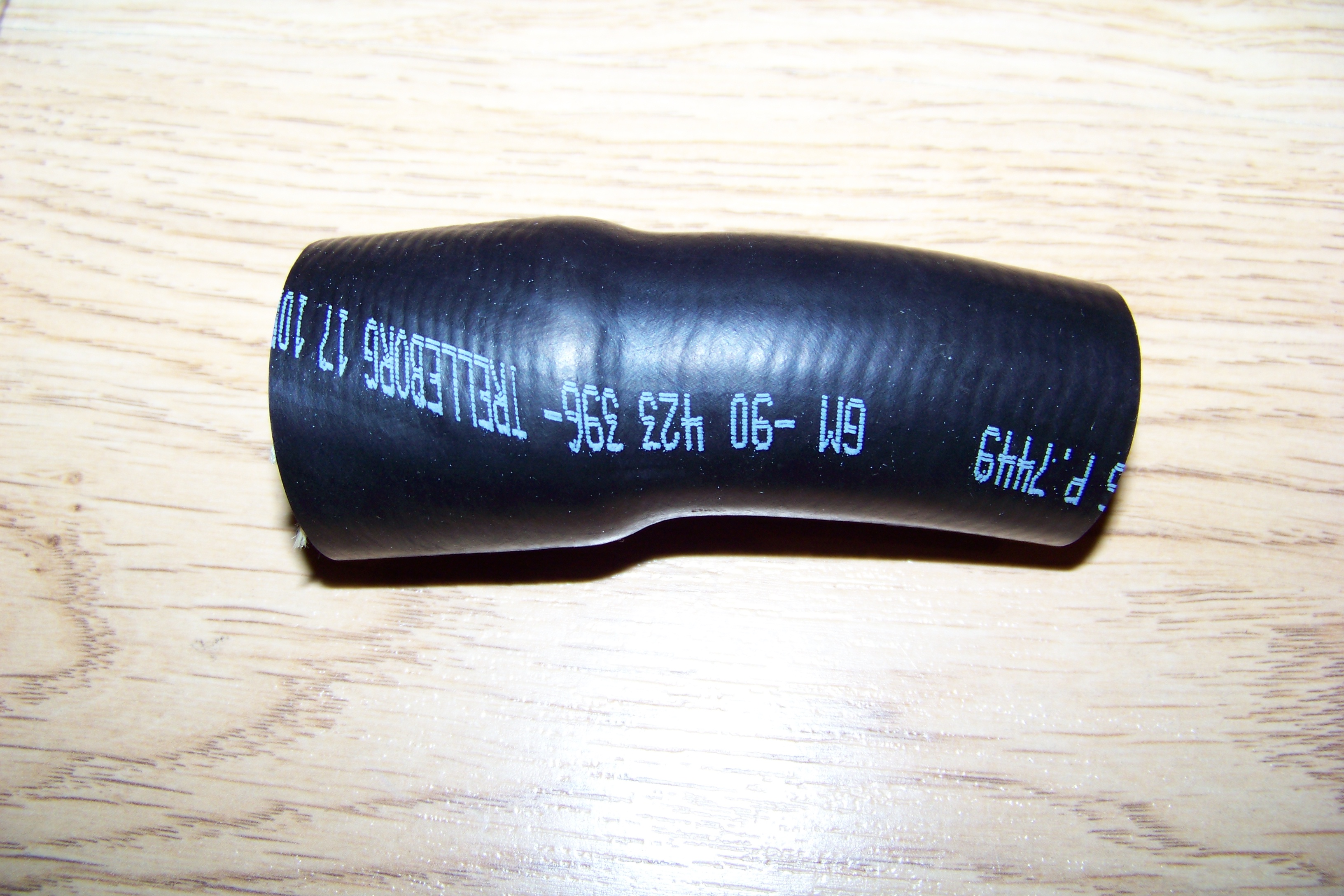

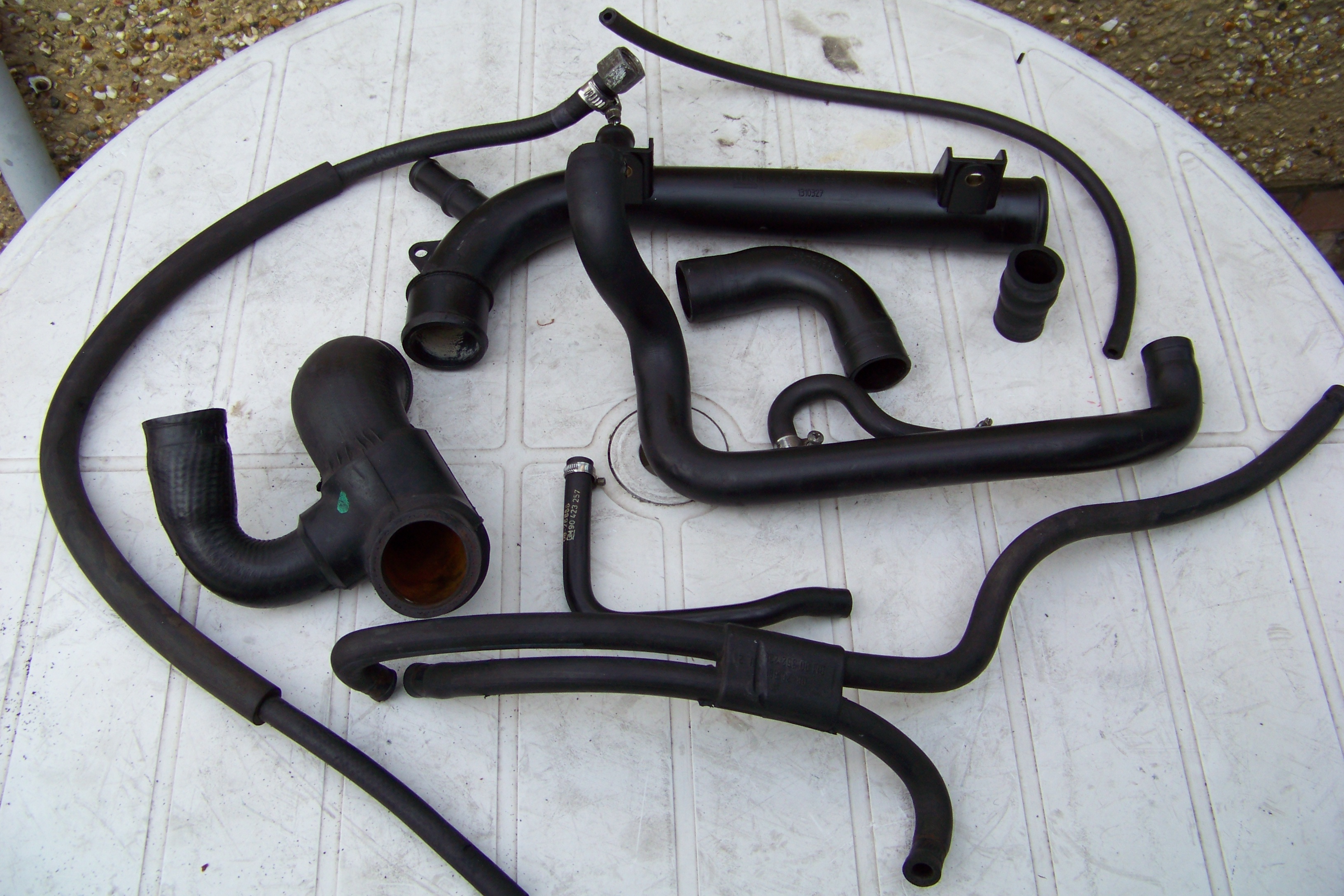

I then got the last of the hoses that needed cleaning and checking. A couple needed to be replaced but the rest needed a good clean
https://images2.imgbox.com/ac/6a/usOj0EIl_o.jpg
Gave them all a scrub with the usual detergent and hot water and got them to this stage
https://images2.imgbox.com/46/b4/YDgFOb8k_o.jpg

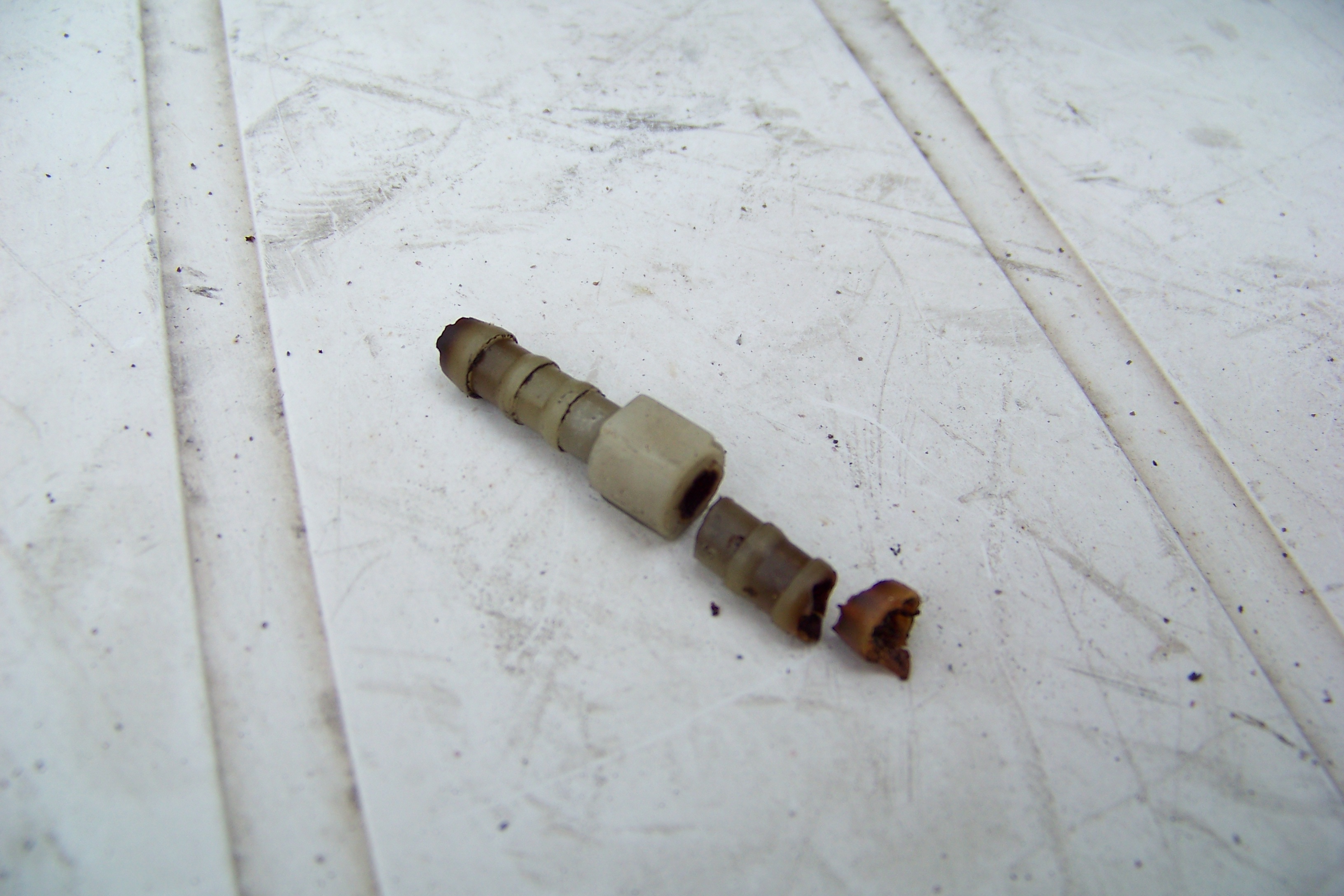

Did have a bit of a casualty so need to go buy one of these
https://images2.imgbox.com/b3/c0/CgkLPQMR_o.jpg

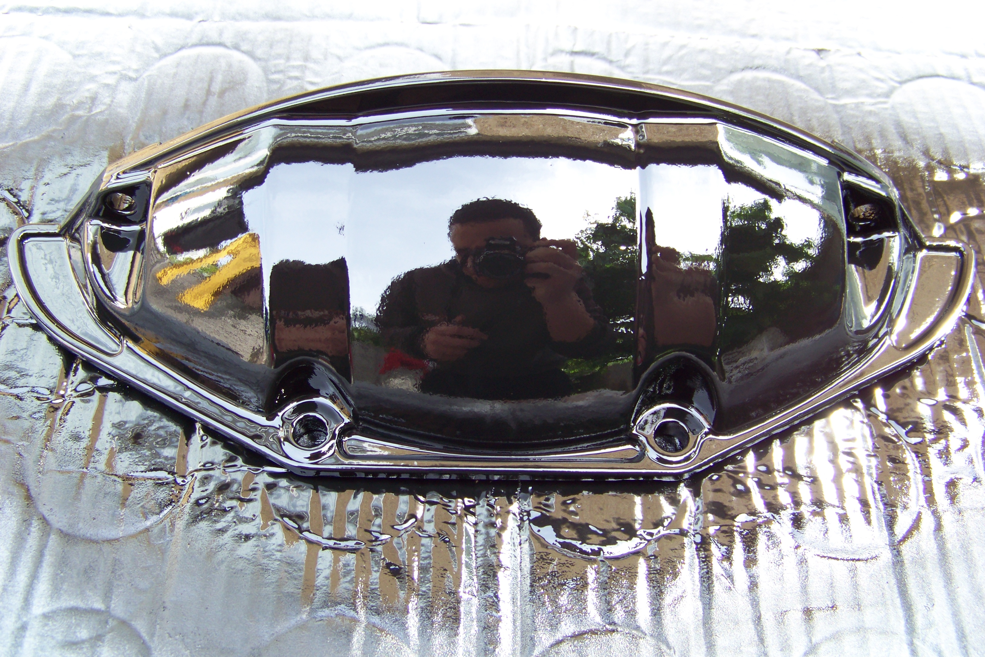

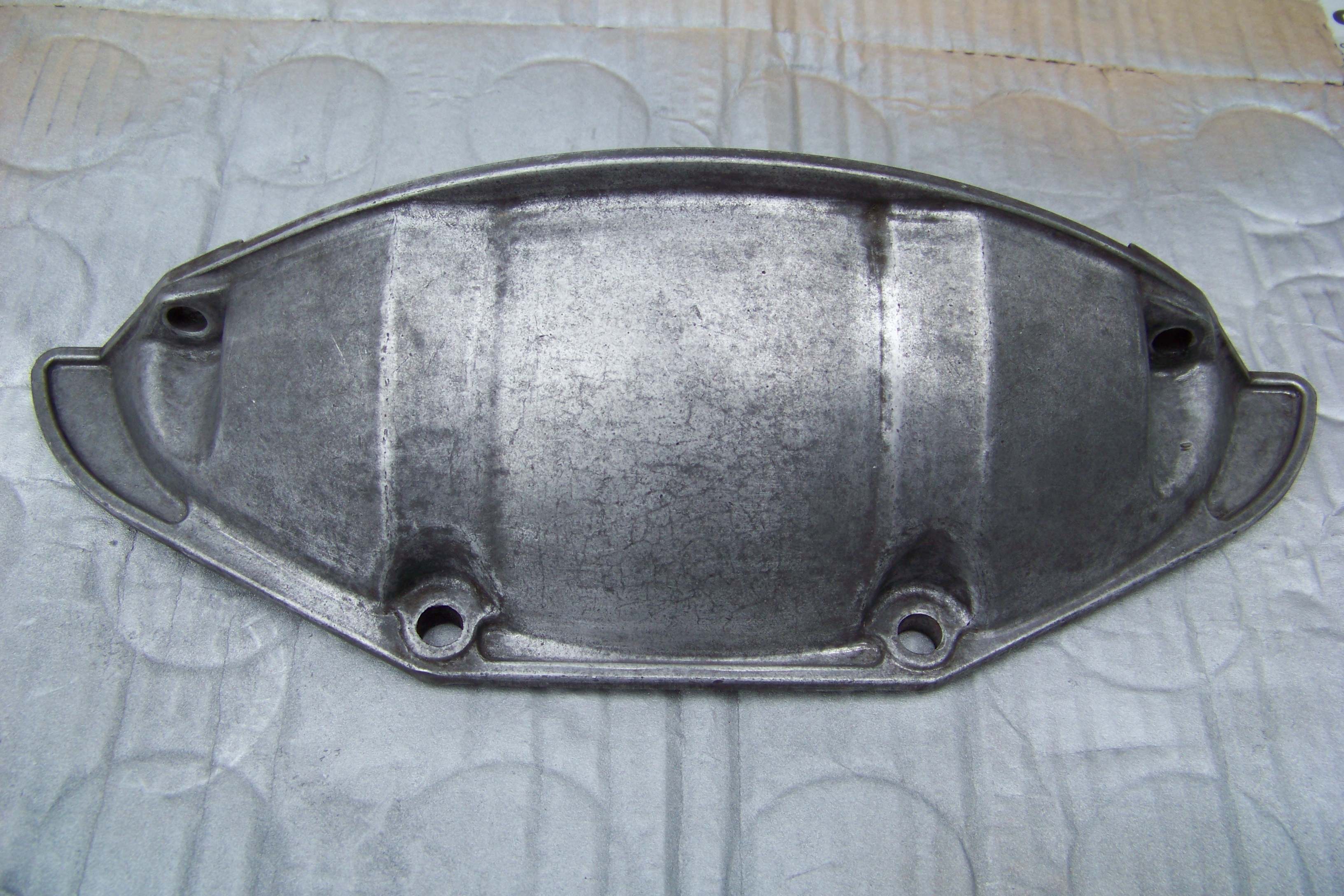

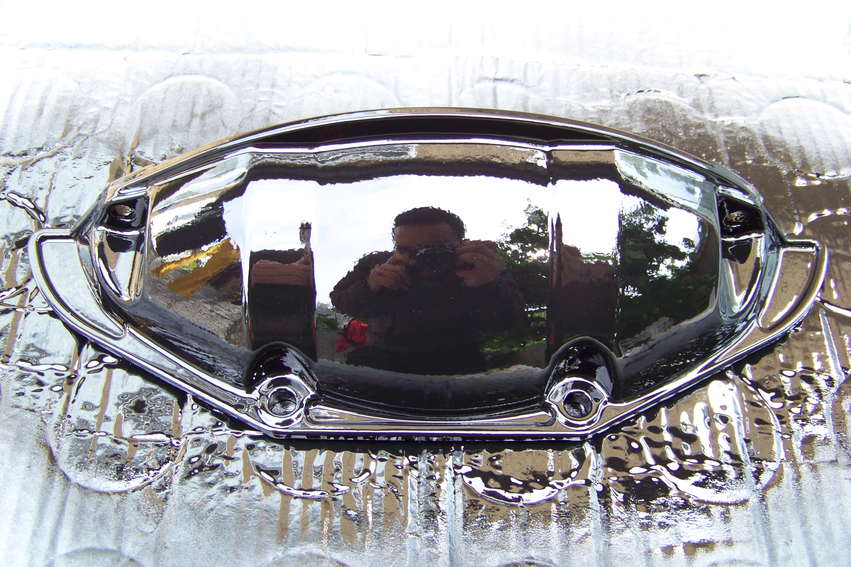

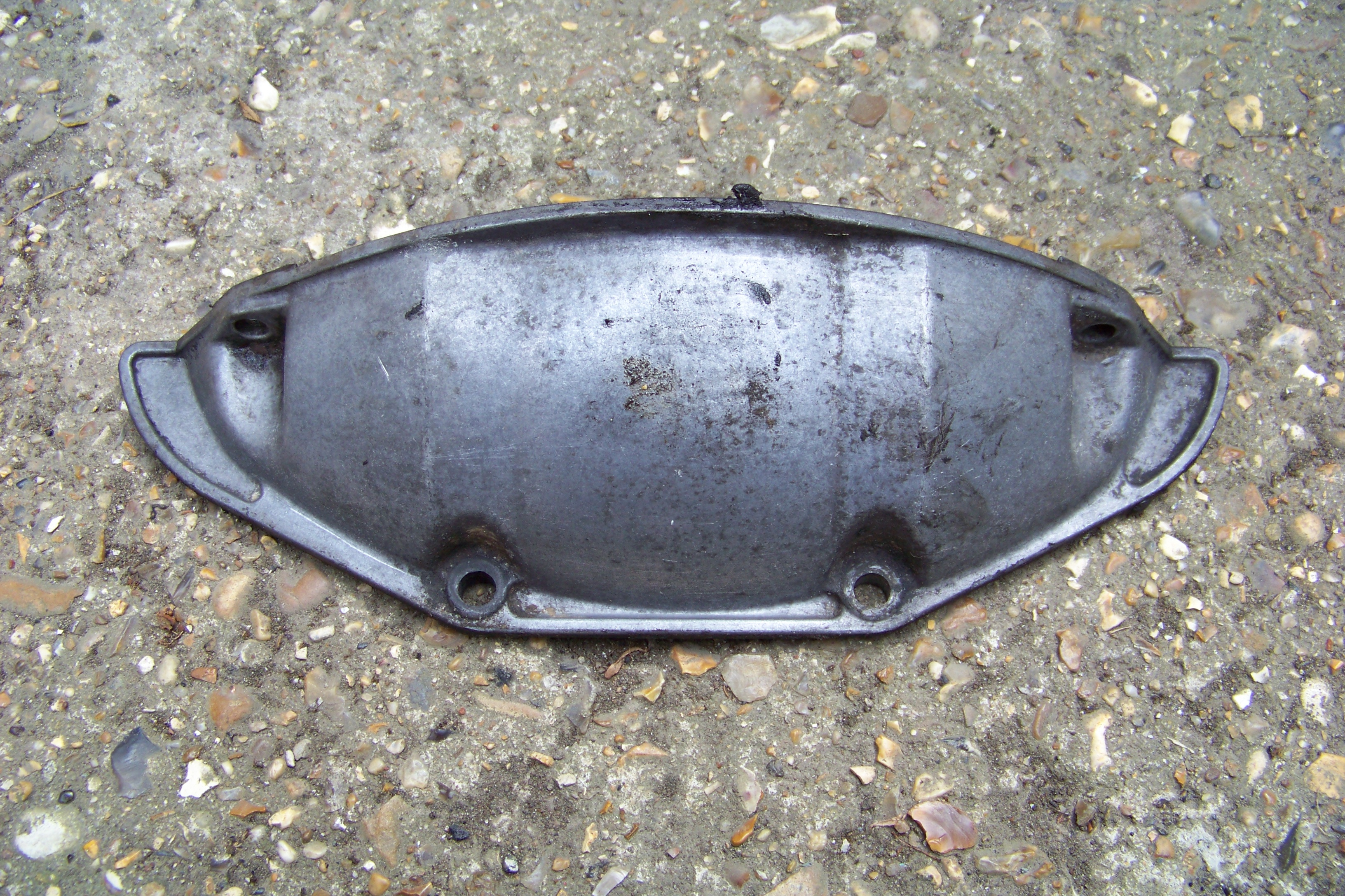

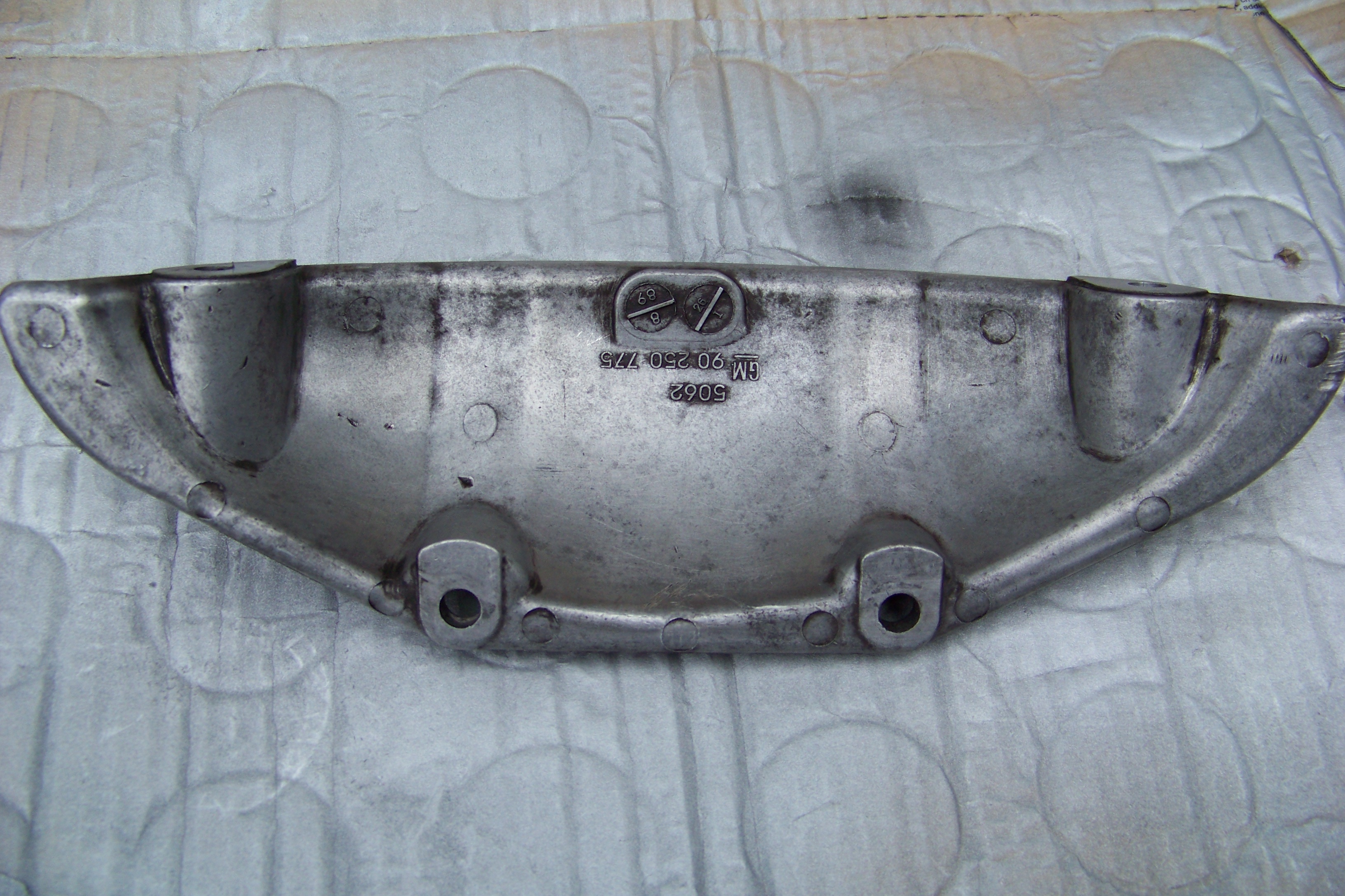

After a bit of a lay in today I got to work. I found this in the garage looking like utter crap... it was the clutch inspection plate from the gearbox. My OCD wouldn't allow this to stay like this, had to get it sorted.
https://images2.imgbox.com/f1/e3/ZsAJpqgl_o.jpg
https://images2.imgbox.com/02/a4/PW8ocIUu_o.jpg
Gave it a scrub, wash, rinse, dry and a wipe and got it like this
https://images2.imgbox.com/d5/86/ycl7lrft_o.jpg
https://images2.imgbox.com/5e/e8/SlYGp2NY_o.jpg

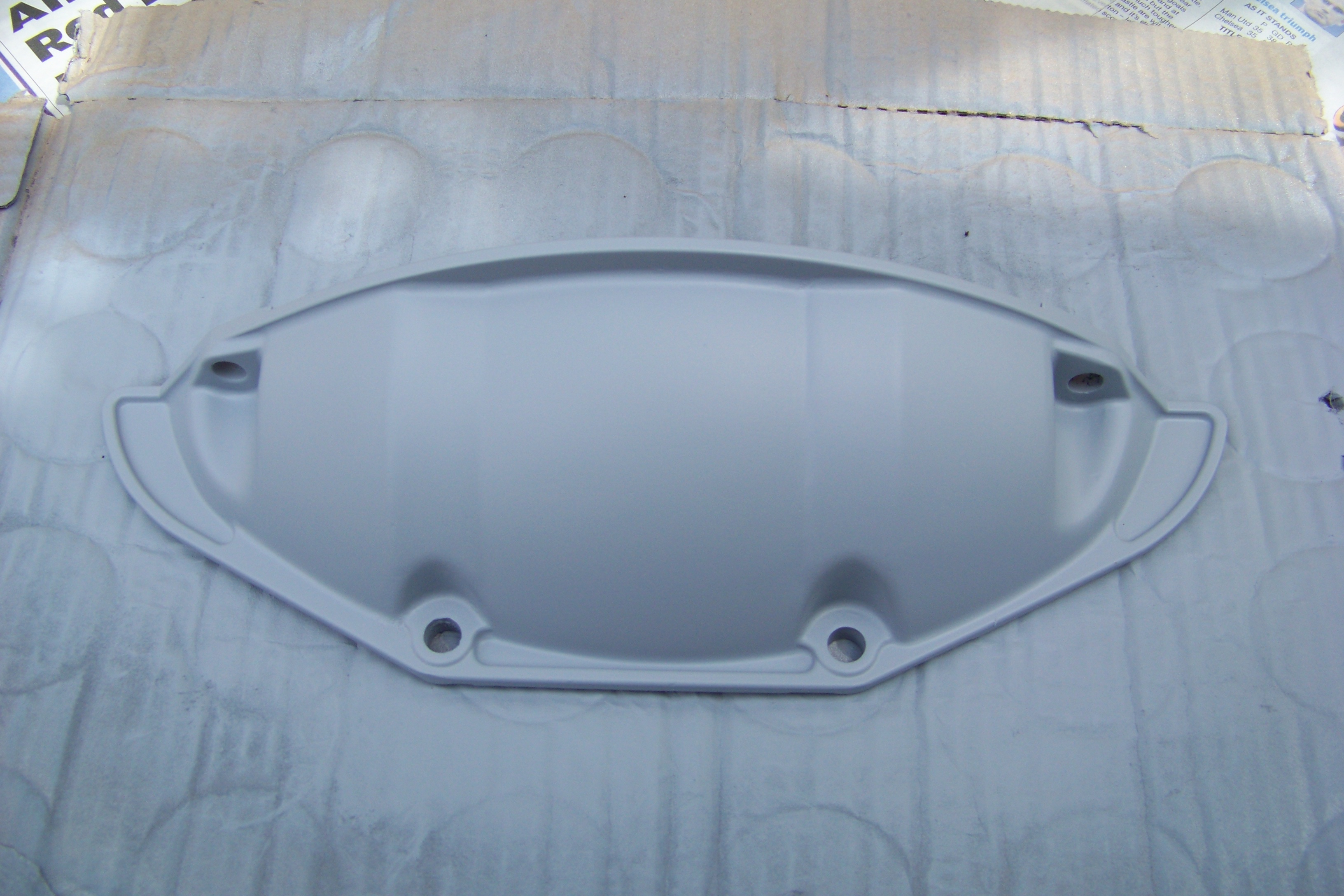

Gave it a couple coats of acid etch primer
https://images2.imgbox.com/b7/50/Us9gStVT_o.jpg

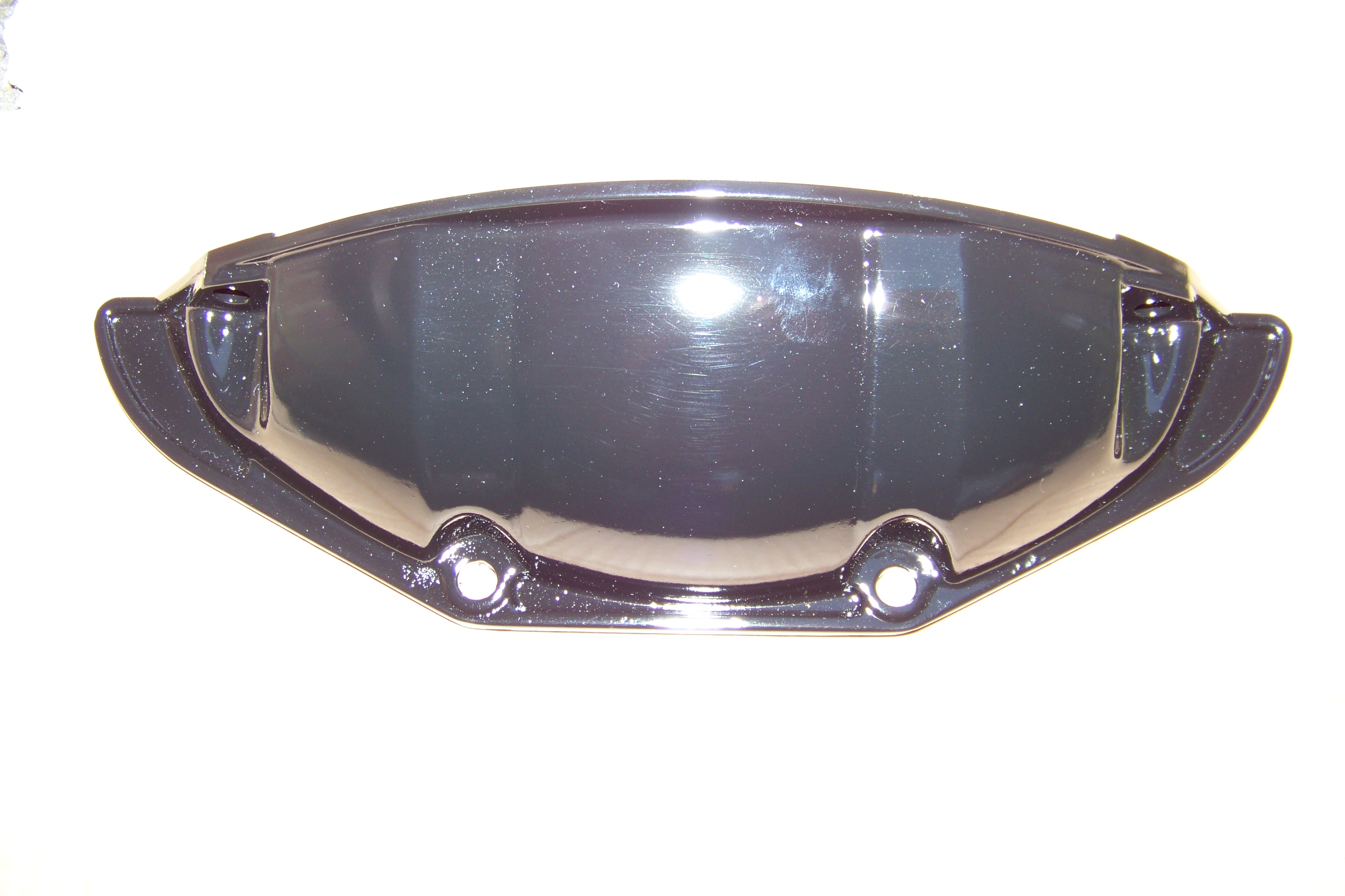

Let it dry and then gave it a rub down with 800 grit ready for some paint. gave it a few coats of black and got it to this stage.
https://images2.imgbox.com/cc/f3/64UxhAQj_o.jpg
For some reason I got a reflection of a very handsome bloke on it :d I let it dry for a bit then gave it a generous coat of oil resistant lacquer
https://images2.imgbox.com/5c/92/FR8YZnbs_o.jpg
(there's that good looking bloke again in the shot ) I left it in view of sunlight to aid drying then put it in the garage to properly dry.

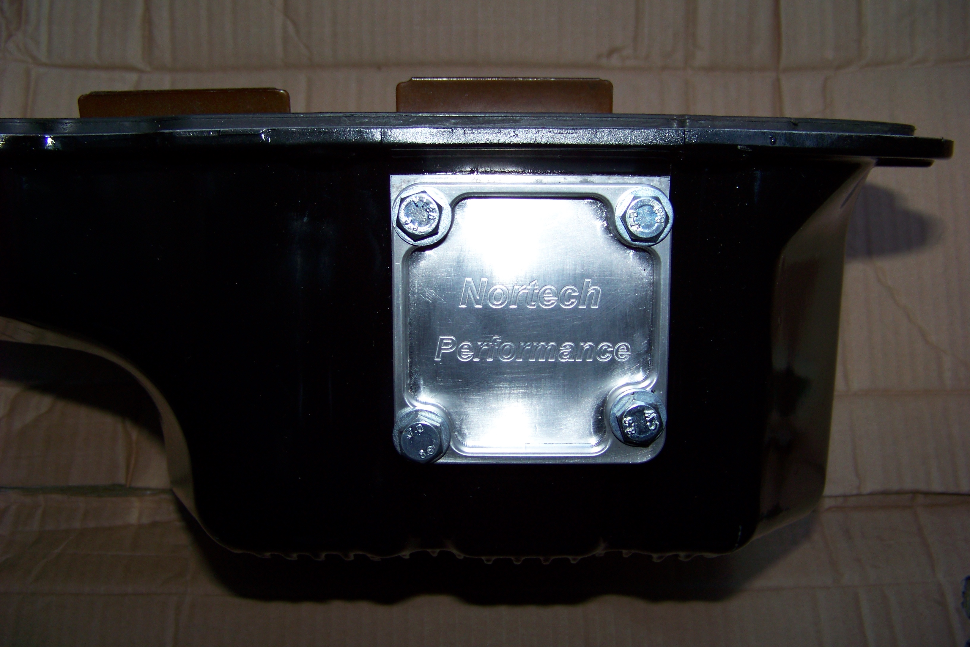

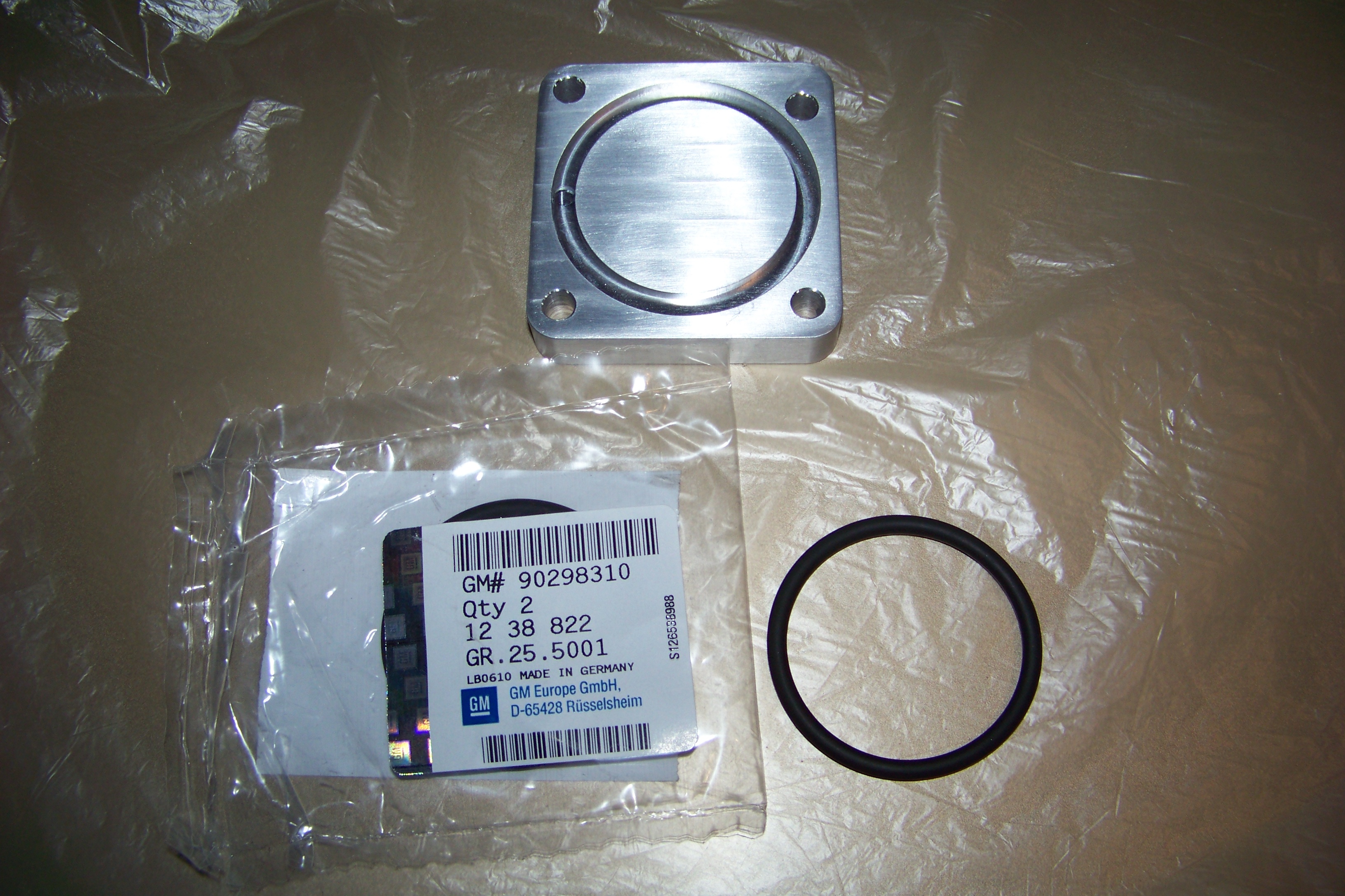

Finally I can fit the oil level blanking plate seeing as I've now got the o-ring seal for the sump
https://images2.imgbox.com/07/f9/lCt431eo_o.jpg
Fitted that to the sump and also made sure the sump baffle was the right one
https://images2.imgbox.com/9a/d4/wKd9UNX2_o.jpg

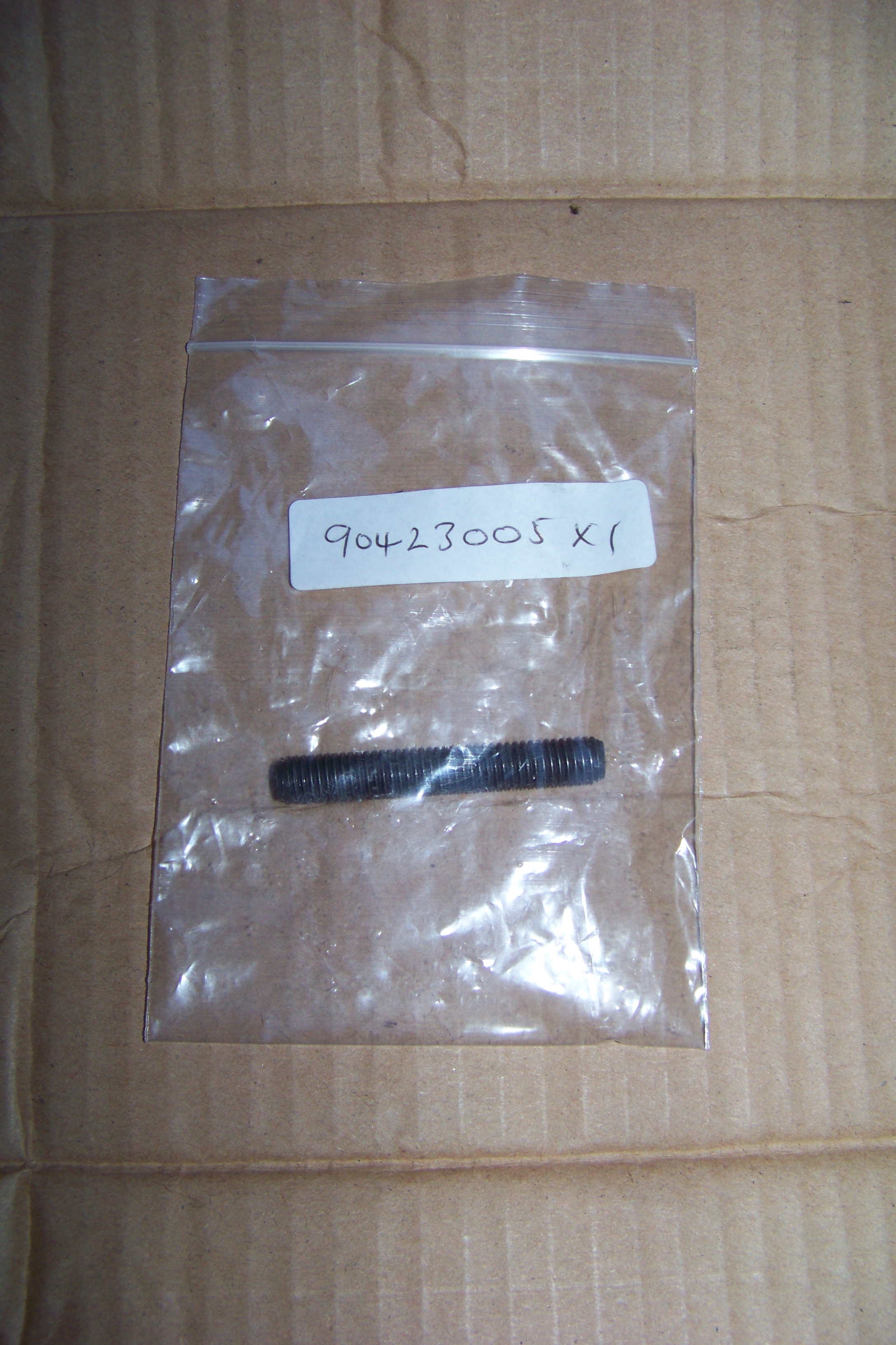

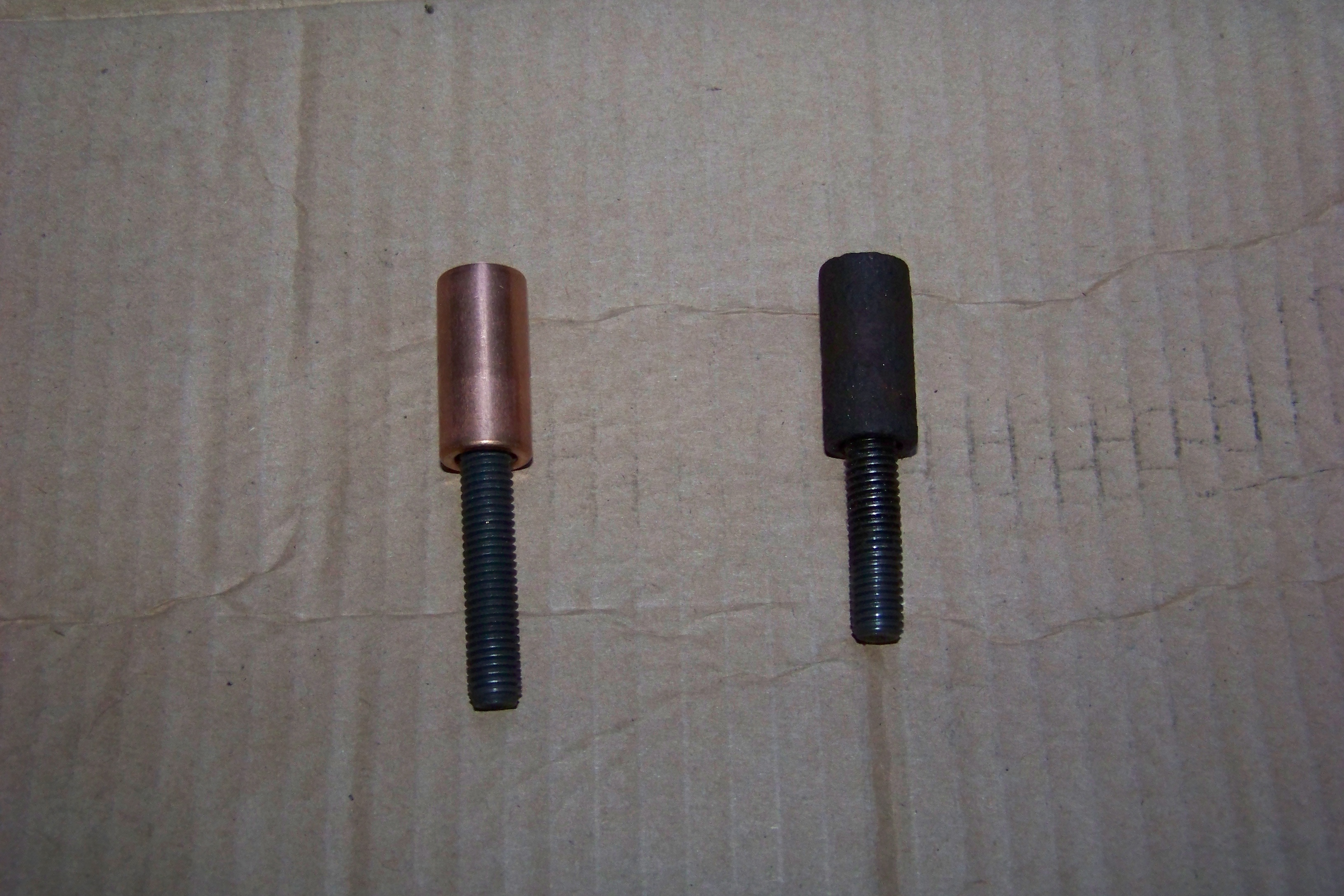

I also found these in one of the boxes that came with the engine
https://images2.imgbox.com/c8/a8/VSLIXHHt_o.jpg
https://images2.imgbox.com/a5/44/g1ZGGV7t_o
https://images2.imgbox.com/a5/44/g1ZGGV7t_o.jpg
https://images2.imgbox.com/3c/b8/Ao4NljVY_o.jpg
(new exhaust stud on the left and old crusty one on the right). Unfortunately, whoever had the engine before me only bought one of these bits and they are all as bad as the one pictured next to it. Hope AutoVaux can get some for me when I call them tomorrow.

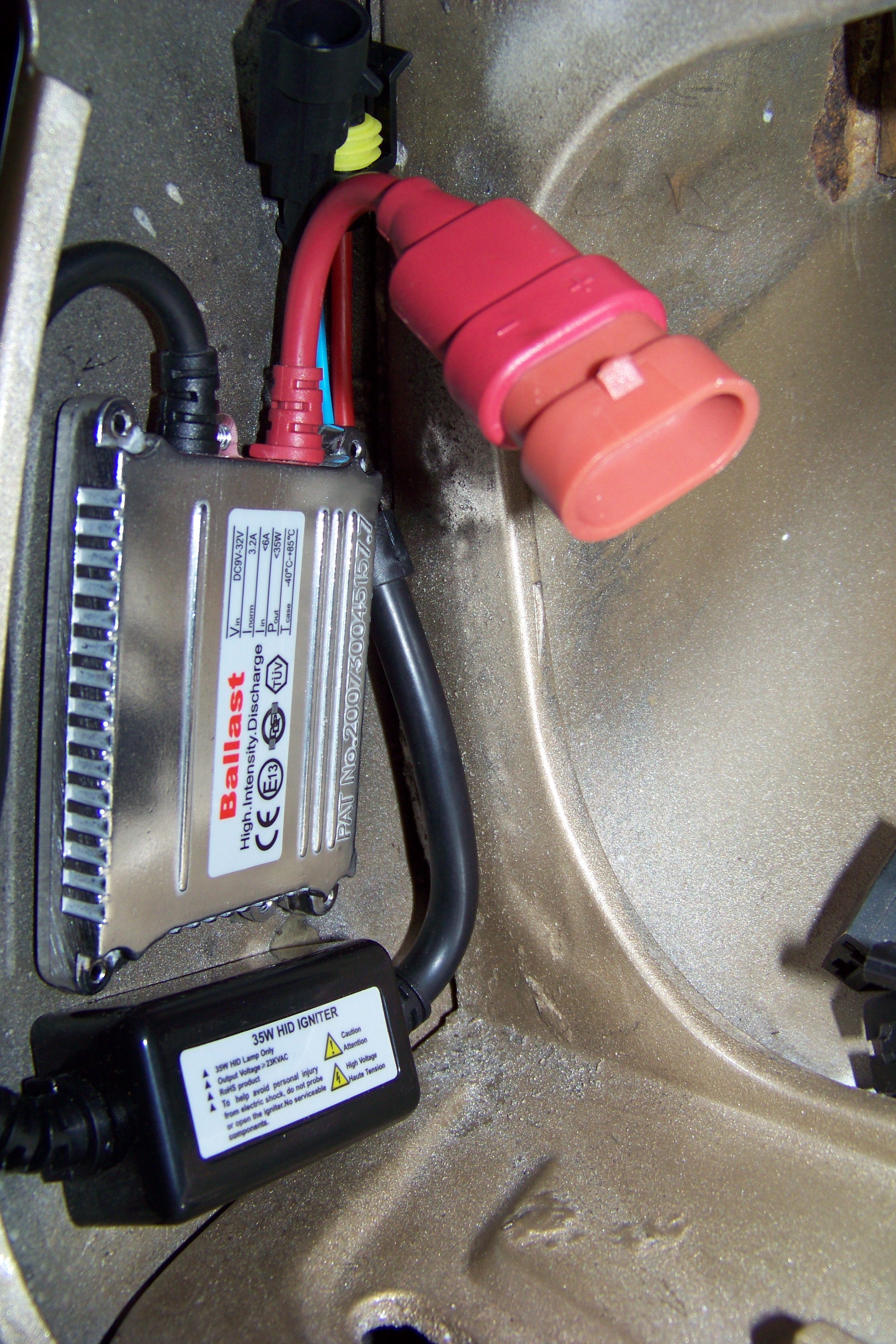

So I had dinner and went to the garage with the HID kit. I spent quite a bit of time scoping out hidden areas large enough to keep the ballast, igniter and wiring hidden from view.
The way the kits are wired is that they only make do with one of the bulb plugs (3 Pin) and that's just used as a signal to switch it on. So one side will have slightly more wiring than the other. I picked the driver side headlamp area to hold all the extra stuff as there's much more room.
Here's where I fixed the hardware (please excuse the dust, grease and dirt; really does need a good clean in there):
https://images2.imgbox.com/a9/95/6CLvG3Kp_o.jpg
Switch - located on the underside of the slam panel just behind the driver side headlamp.
https://images2.imgbox.com/66/eb/r83GkyK7_o.jpg
Ballast and igniter (both sides) - have been situated on the inner wing directly besides the headlamp (Nova's have loads of room there ).
The wiring for the other headlamp runs from the switch to the other side. I ran this up next to the wiring that runs under the slam panel. Everything is hidden from view as I clipped the cable under the slam panel as opposed to on top where it normally would be.

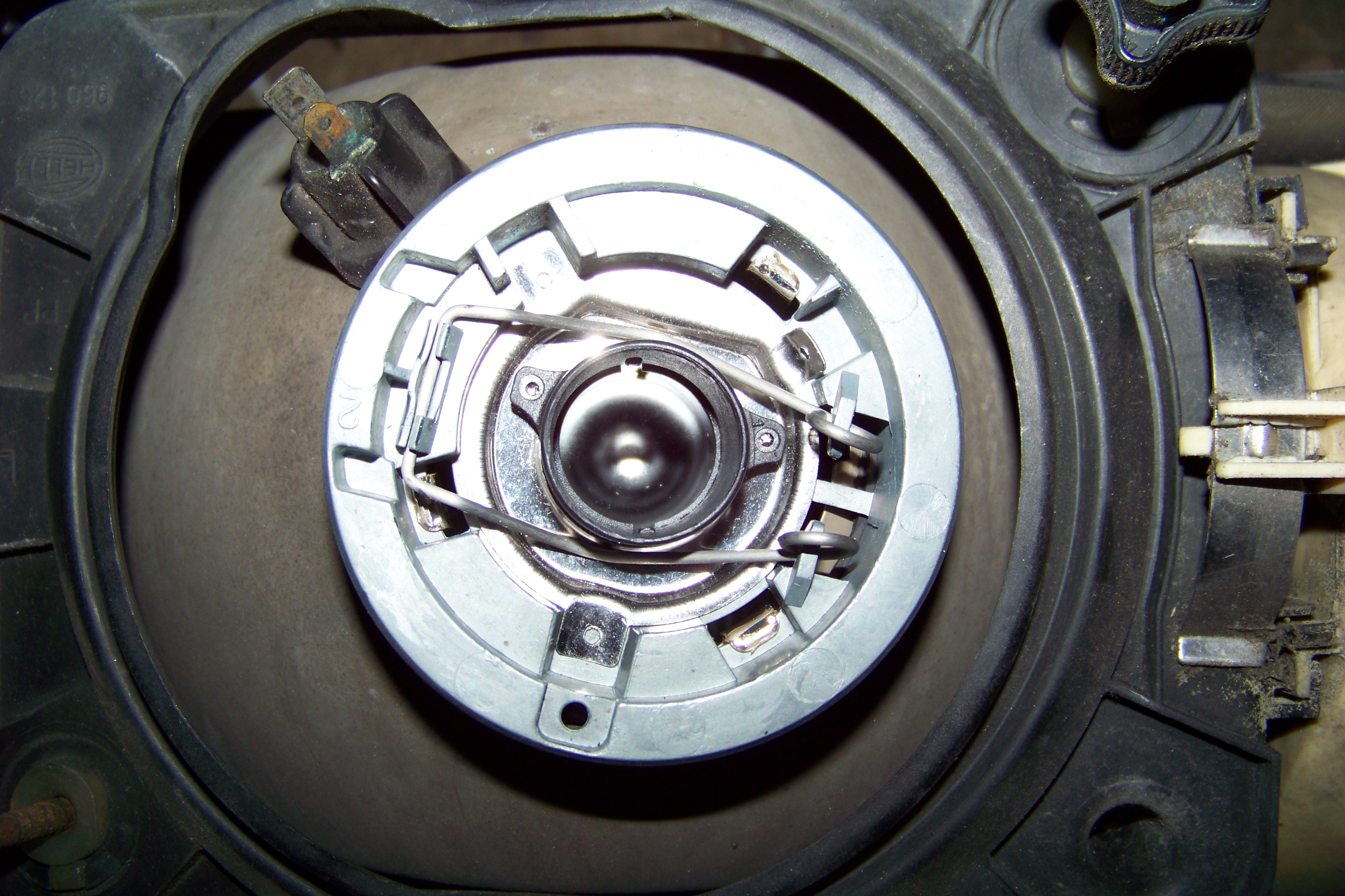

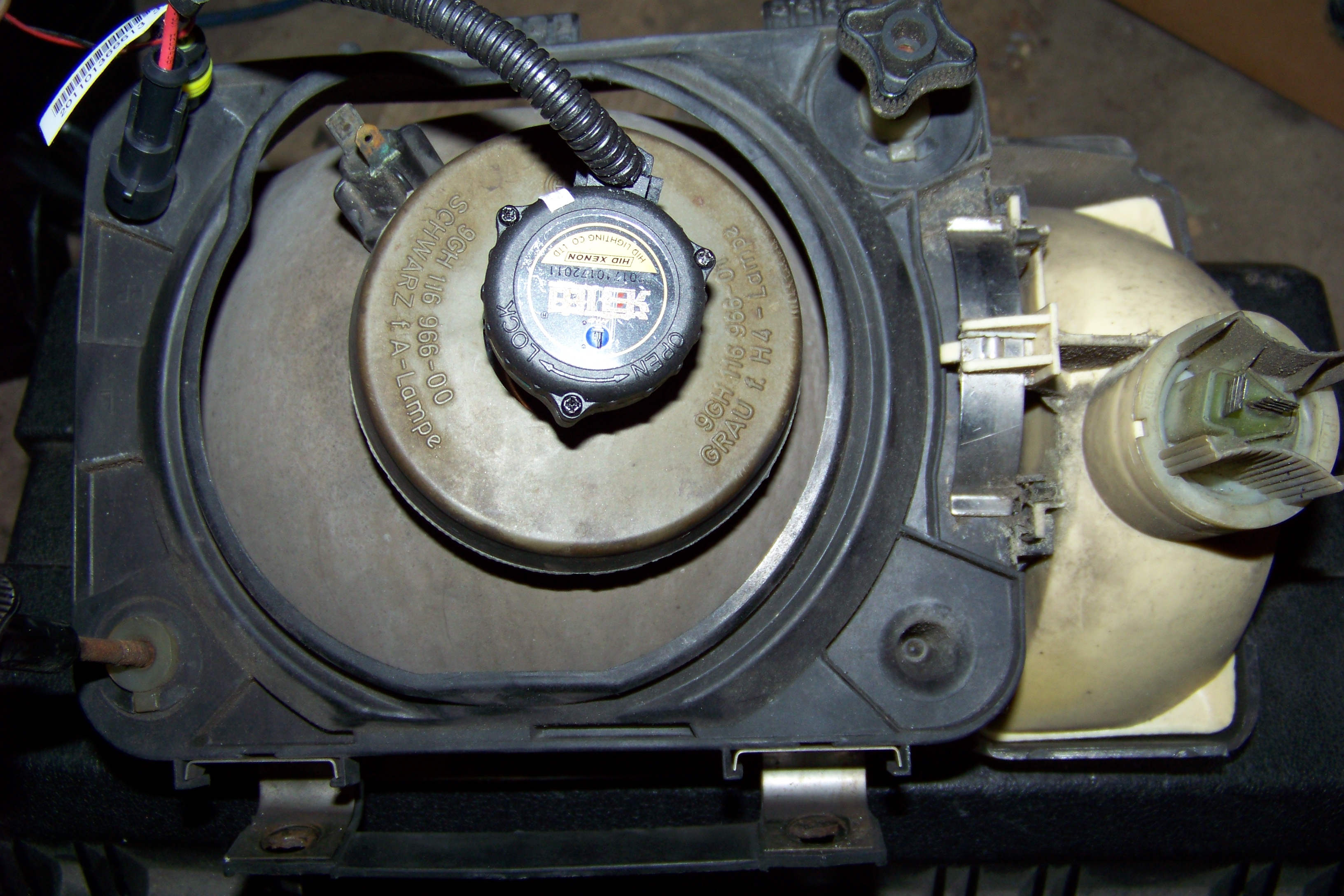

Removed the old bulb which was a Philips 60w/55w brillaint white 4500k halogen (actually a good bulb), then fitted the shield in place. The HID burner then slots and locks into the shield.
https://images2.imgbox.com/79/dd/61LHRlWJ_o.jpg
The rubber cover fitted back.
https://images2.imgbox.com/9e/8a/xAbu5Kgz_o.jpg
