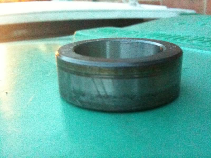

Got the oil pump crank seal out last night again :roll:
Also pulled out the thrust ring aswell, and by the looks of the condition of it, it could well be contributing to my oil leak problems!!
You can see it has worn a groove in the front edge where the seal sits, so I thought I might be able to get away with turning it around, but it's not in the best condition on the back edge and there's also a few scratches and grooves from screwdrivers and picks being used to remove the seals!
So a new one will be on order today with a new seal and fingers crossed it will seal as this will be third time lucky lol

That doesn't look at all good Ian as you know it should be nice and smooth. Shame I can't make 27th June with the GTE, as I said in my txt bit of a logistical nightmare for me, but I will pop down after work to give you some moral support.
