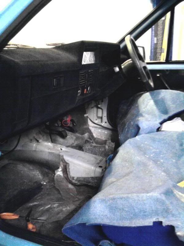

Made a start on the floor/body modification.

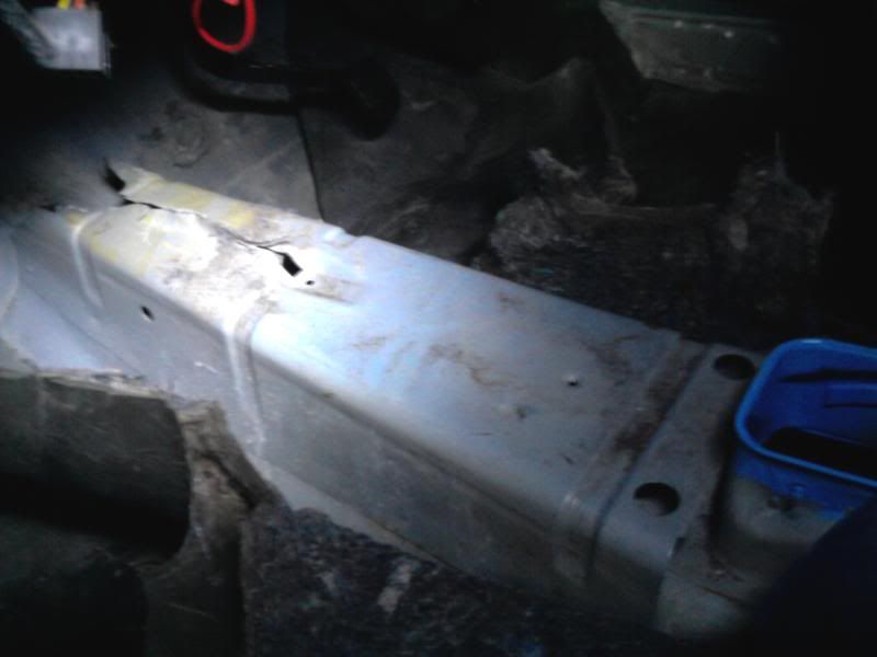

http://img.photobucket.com/albums/v1.../Photo0494.jpg
http://img.photobucket.com/albums/v1.../Photo0498.jpg

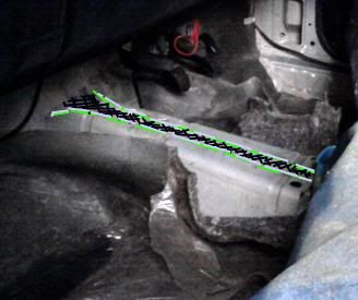

Im cutting what will end up being, a neat narrow gap through the carpet-support bit that widens out a bit at the top where then the usual elongated hole in floor as per instructions..
http://img.photobucket.com/albums/v1...r/intshmod.jpg

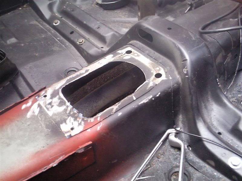

How do you remove the gear shifter surround bit that the old shifter bolted to; just grind away or does it have x4 spot welds that need drilling out..? -or both..? like in this pic from ad's thread..
http://img.photobucket.com/albums/v1...r/027ecdd9.jpg

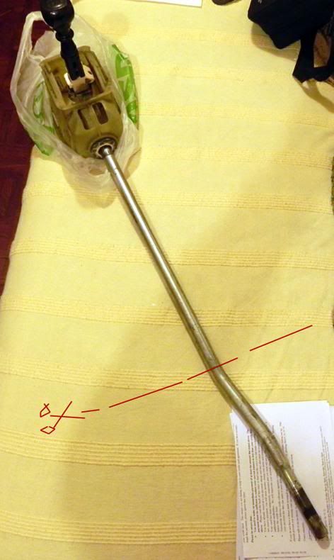

Finally; here is my cav shifter and where i shall make the cut; to get rid of the kink (?)
http://img.photobucket.com/albums/v1.../cavsshift.jpg
At this stage; with me being clueless with not seeing the astra mk1 item yet il then hold fire and see what might be possible. If i stick with the 'S' nova-linakge ill then also need to shorten this cav shifter it by a further 3 inches is it, with another cut..?

Dave, its held with spot welds.
Basically, you need the make the shifter completely straight.
Be aware tho, that the shifter in your pic wont fit a nova linkage, because its got the wrong type of fitting on the end. The nova one has a clamp fitting on the shifter, the clamp bit is on the linkage itself on a cav so the shifter is just a solid rod at the end.
Get a cav (i belive there the same?), or a corsa gear linkage end and you can replace the crappy standard bush that nova linkages suffer from, and new bushs for the corsa bit are about £7 for the pair iirc.
ah cooly; will be drilling them out tommorow then, wicked..
thanks ad - yeah i noticed the ends are different; as said that'll only be an issue if i dont use the astra mk1 bit and keep the nova 'S' linkage..
