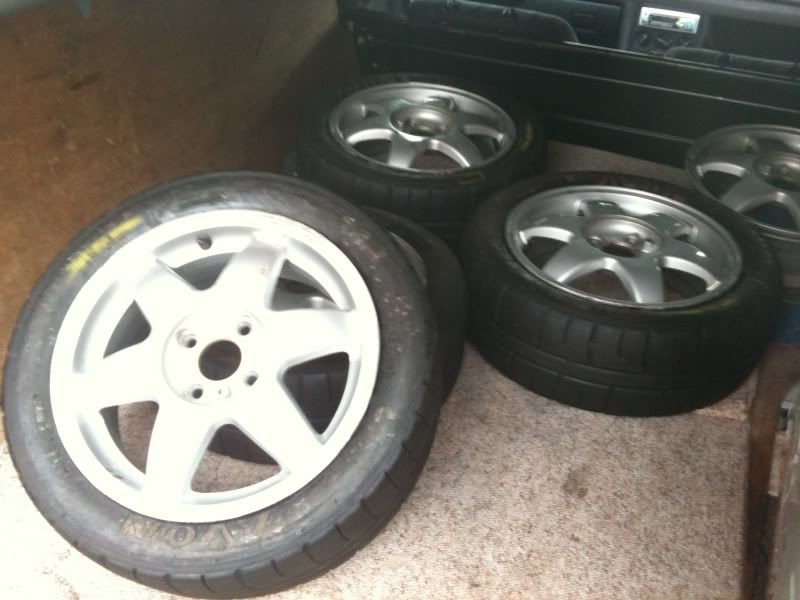

Got my Avon Slicks fitted on rims and balanced up by my tyre man
http://img.photobucket.com/albums/v3...va/photo-8.jpg

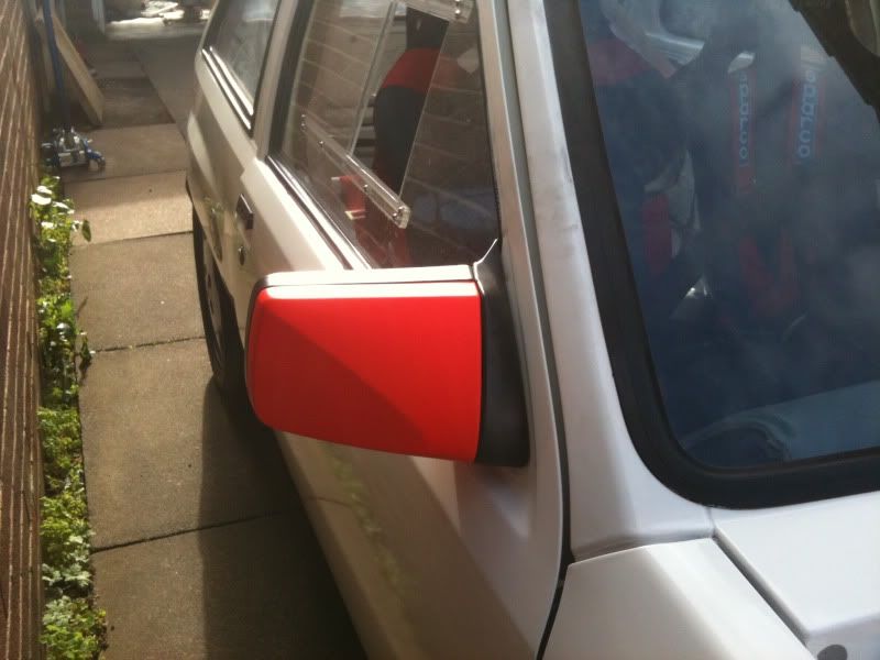

Iain gave my mirrors a tidy up & another lick of day-glo orange
(even though it looks pink in the pic!)
http://img.photobucket.com/albums/v3...a/photo3-2.jpg

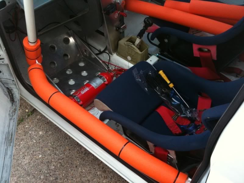

Rollcage padding fitted
http://img.photobucket.com/albums/v3...a/photo4-1.jpg
http://img.photobucket.com/albums/v3...ova/photo5.jpg

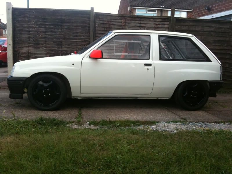

Set the ride height on the coilovers
http://img.photobucket.com/albums/v3...ova/photo6.jpg

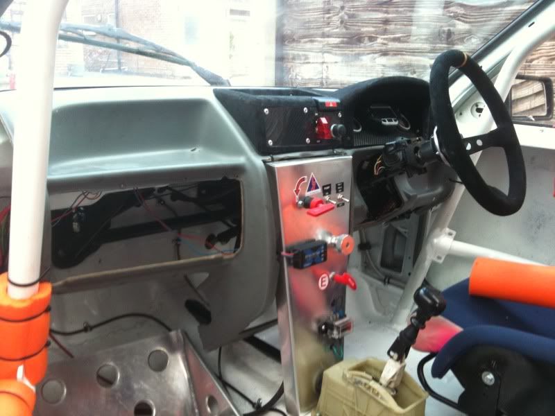

Only other problem I had was that when the fans kick in or are turned on it causes my digital dash to freak out and all the lights start flashing and the rev counter reads like 12 grand on tick over! :confused: Soon as the fans go off it goes back to normal, so the stumped on that one!

Digidash weird-ness will be an earth problem somewhere.
