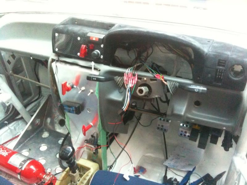

Also started on getting all the wires where they need to be and mounting switches etc. on the centre console and dash.

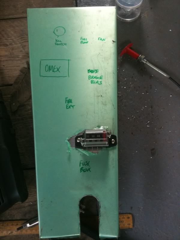

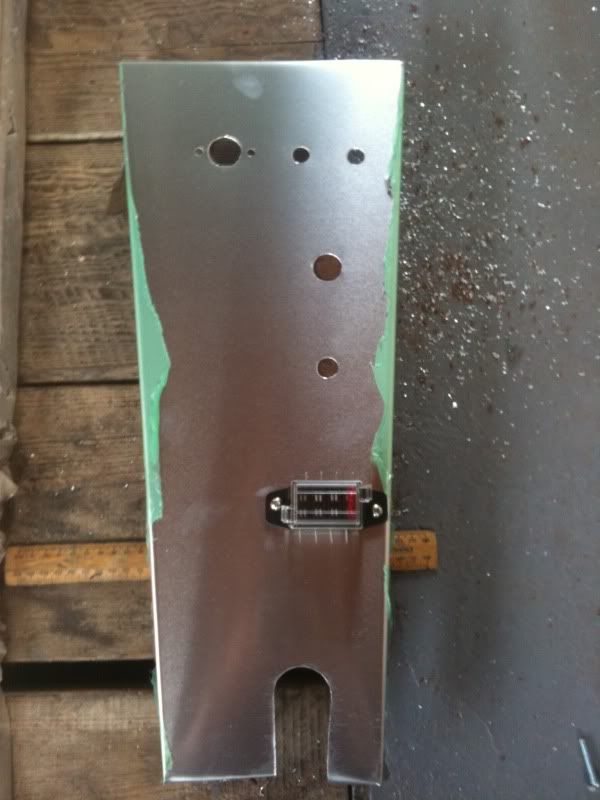

Centre console out and roughly marked up where I wanted stuff.
http://img.photobucket.com/albums/v3...ova/photo4.jpg
All drilled out and external fusebox for fuel pump mounted. (Thanks for the fusebox Alan :thumb: )

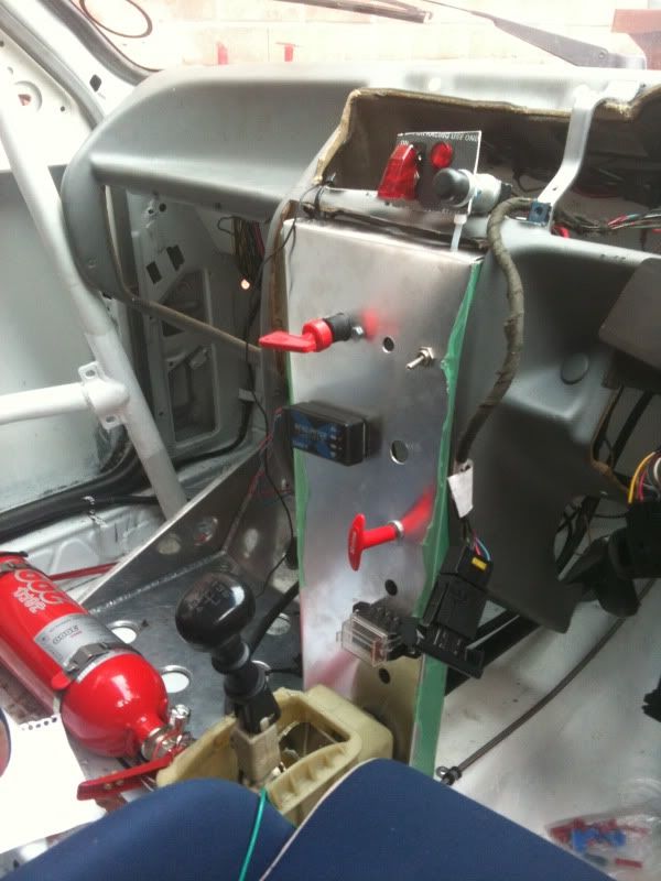

In the car
http://img.photobucket.com/albums/v3...ova/photo2.jpg
http://img.photobucket.com/albums/v3...ova/photo3.jpg

What are all those horrible bullet connectors doing, rip them out immediately and do some proper solder and heat shrink connections.
Enough of my rant, tidy update so keep at it.

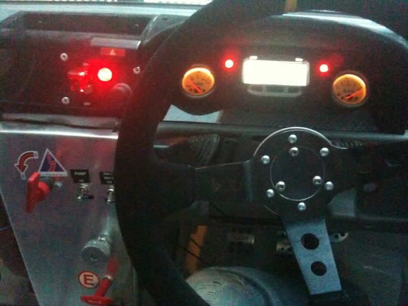

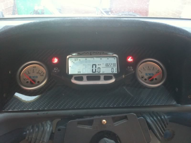

Also got all the wiring finished off and tidied up, along with the guages fitted and all mounted nicely
http://img.photobucket.com/albums/v3...a/photo2-1.jpg
And with the wheel on
http://img.photobucket.com/albums/v3...a/photo3-1.jpg
Only problem I have is that the petrol gauge goes up to full when the ignition is turned on, but there is no petrol in the tank. Does this mean I have put the wires onto the sender unit the wrong way around, or would it be a faulty sender??
Looking motorsport now!
That dash looks quality now Ian!
Thought you took my old fuel sender unit to fix your faulty one? Or is that reading with my new one fitted?
