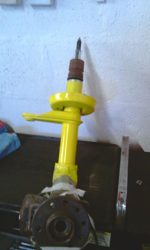

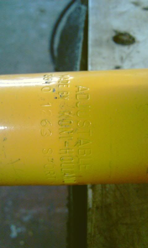

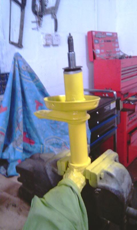

dug my konis out and painted the struts up
http://img.photobucket.com/albums/v6...g?t=1292441169

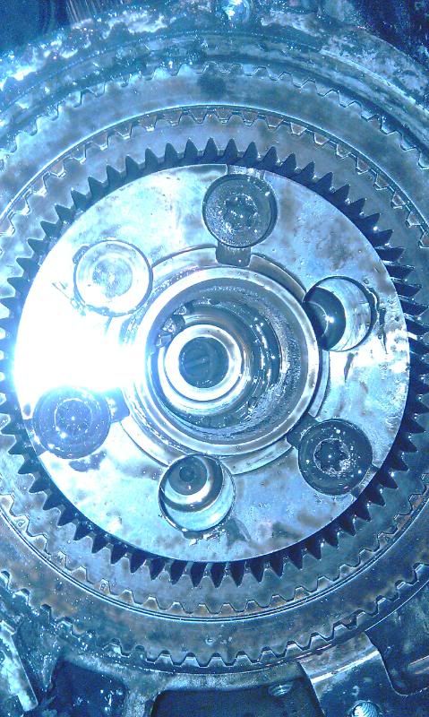

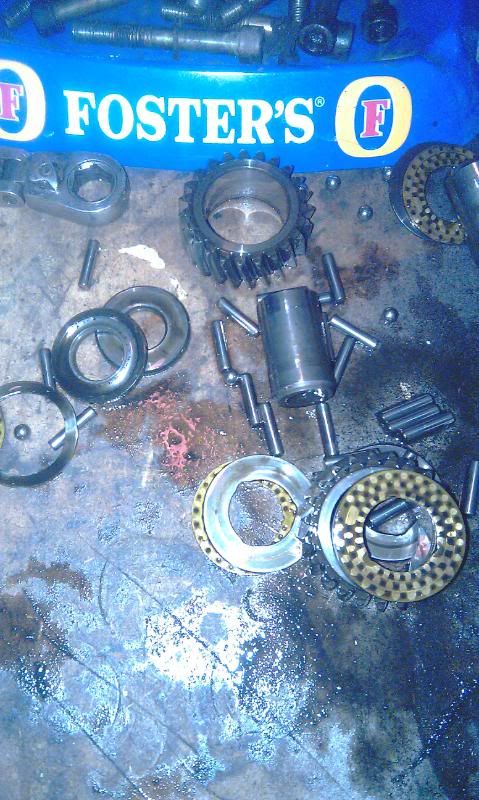

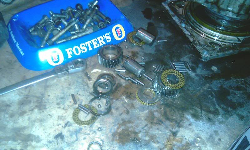

also sinse i got it my locked transfer box has had a whine so decided that while its out i will pull it apart check it over and send the locking rings to a mate of mine thats going to copy them and water jet cut me some out of ardox which is one of the strongest forms of mild steel comercialy available for the the nova
problem is when i took it apart i discovered why its been whining!
the tit i got the car of instead of locking it properly with locking rings hes just packed it out with clutch rings which has caused it to over heat and the bearings discintergrate so when i opend it up it all fell to bits in my hand
thanks mate what a tit

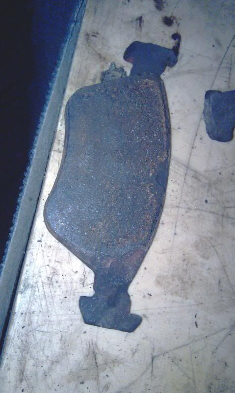

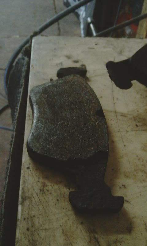

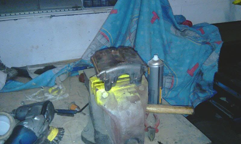

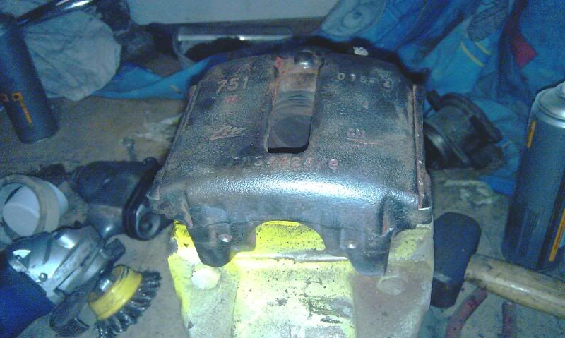

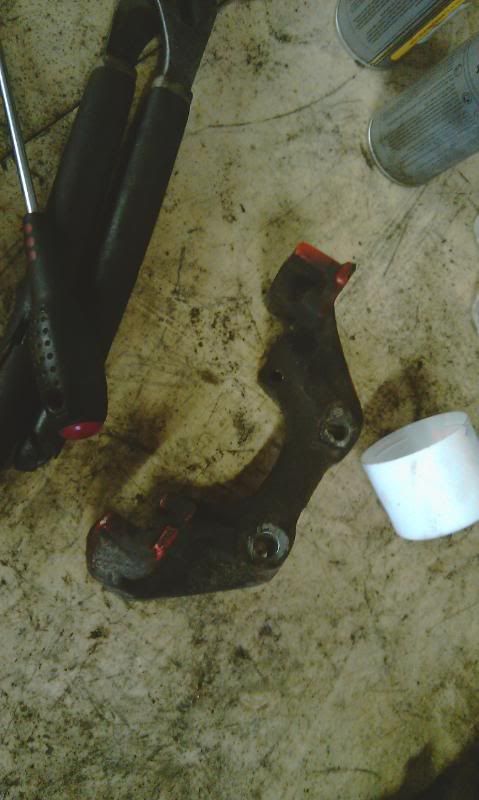

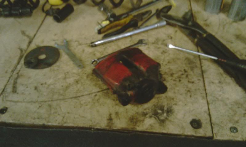

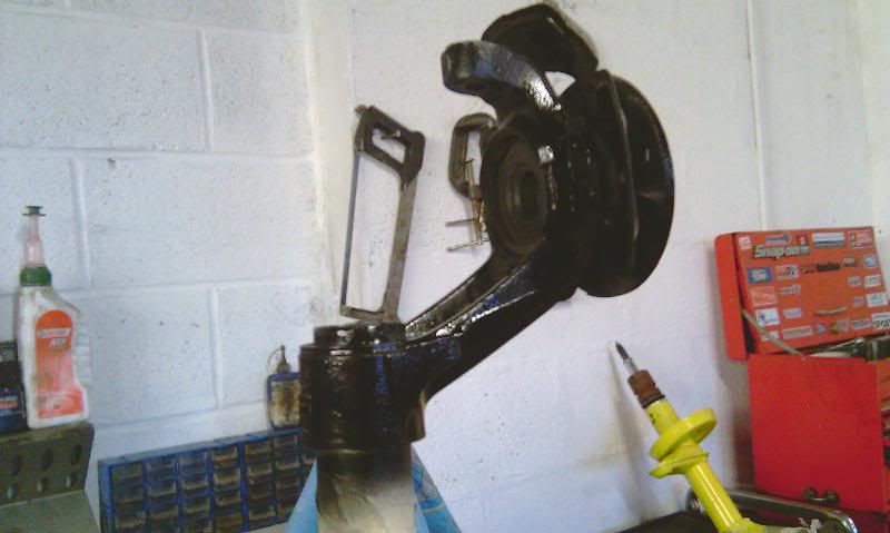

started striping and cleaning the front brakes
http://img.photobucket.com/albums/v6...g?t=1292441502

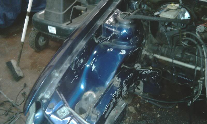

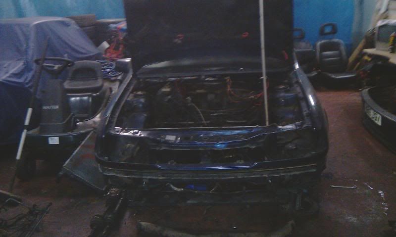

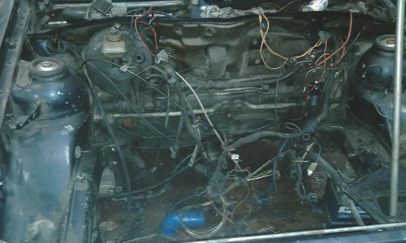

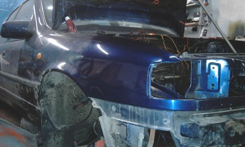

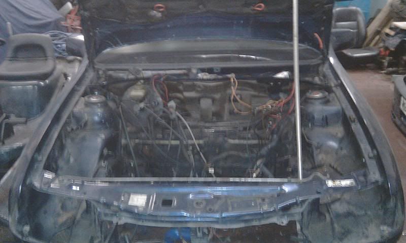

also made a start on cleaning the bay up
the dust on the wing! wiped abit i cant belive its still blue lol
bay starting to look cleaner it will get repainted any way
