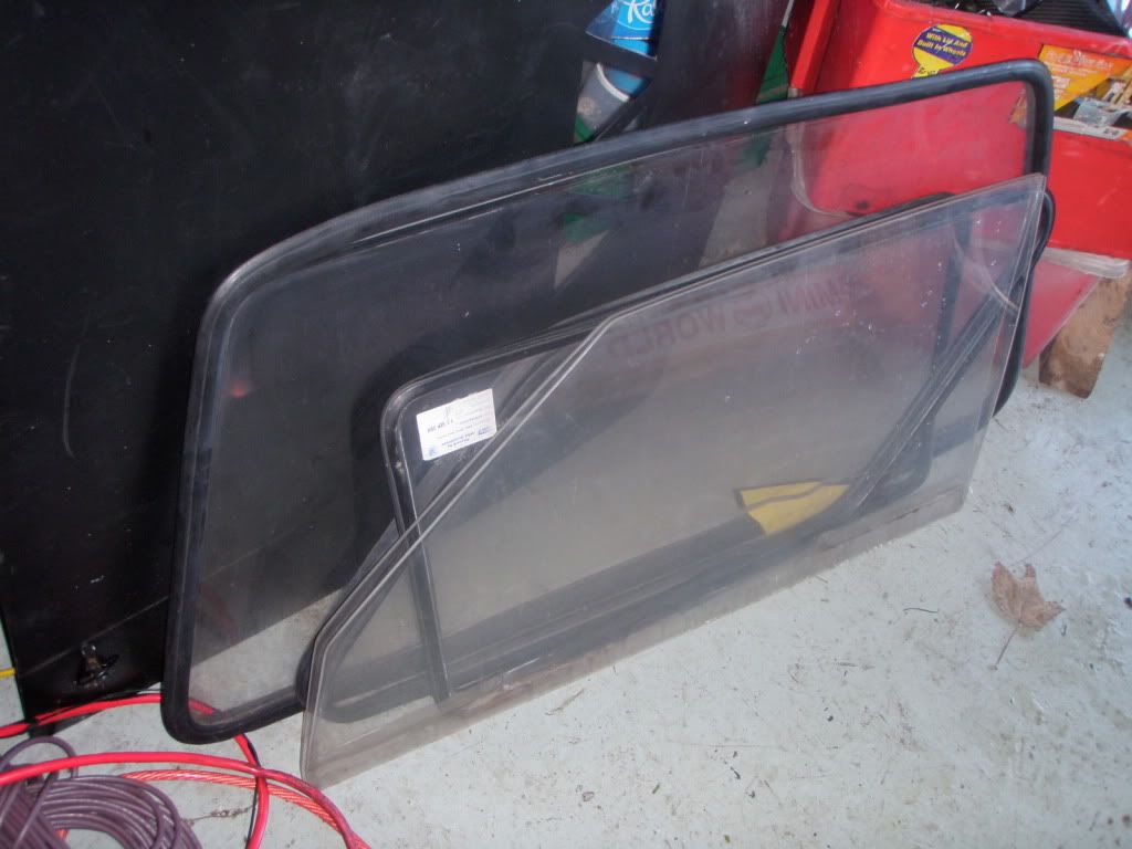

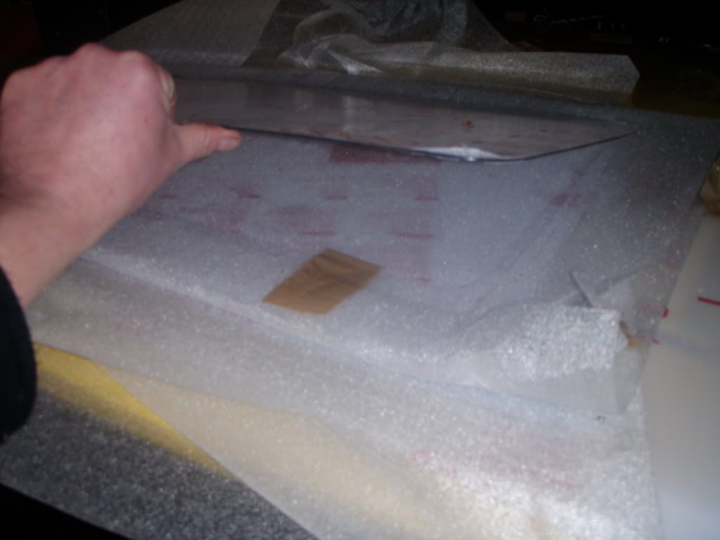

And for the ongoing weight saving efforts, ditching the 4mm thick perspex windows, along with their rubber seals;
http://i285.photobucket.com/albums/l...ort/009-17.jpg
and replacing them with bonded in 2mm polycarbonate;
http://i285.photobucket.com/albums/l...ort/008-18.jpg
Saves me 5kg.

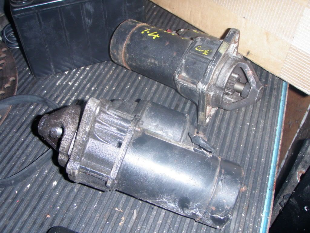

I also did some research on starter motors, and found that the lightest one available is 2.7kg (I had a couple of them);
http://i285.photobucket.com/albums/l...ort/010-18.jpg
I'm pretty certain that the starter motor on my Nova is a bigger one than this, so as soon as I get the car back from BTEC Racing I will whip out the starter and do a comparison.

would riviting not be lighting than bonding for the windows?
good find on the starter as well

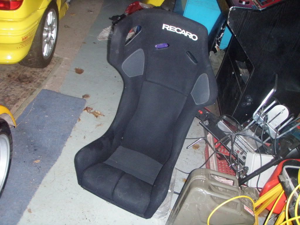

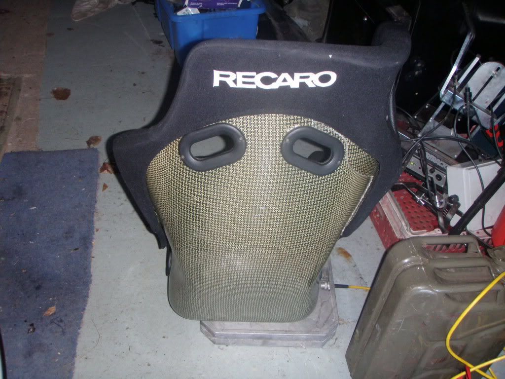

I also picked up a new seat, which will save me 3kg. I have never seen another seat like this, and have no idea of the history of it;
http://i285.photobucket.com/albums/l...ort/006-25.jpg
http://i285.photobucket.com/albums/l...ort/007-19.jpg
It's a carbon kevlar Recaro. One of the stickers on the base of it suggests that it may have been made for an AMG car...........

is the kit from a hot rod/stock car ?
Carbon Kevlar good ness :)

It probably would be a little, but I think bonding looks better, and obviously gives a better weather seal. I will consider further.Quote:
Originally Posted by burgo
:eek:Quote:
Although you've yet to weight whatever is bonding them in I assume :p
Re starter motors I did see in a mag this month, cambridge automotive do a range of lightweight aluminium starters for race use... Get your wallet to sit down though as they're for the jap market mainly so the standards ones are around £200... expect more for the race versions I assume :p
