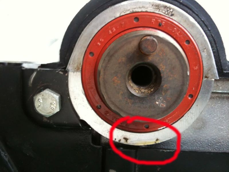

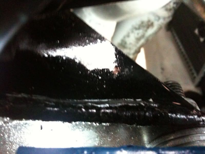

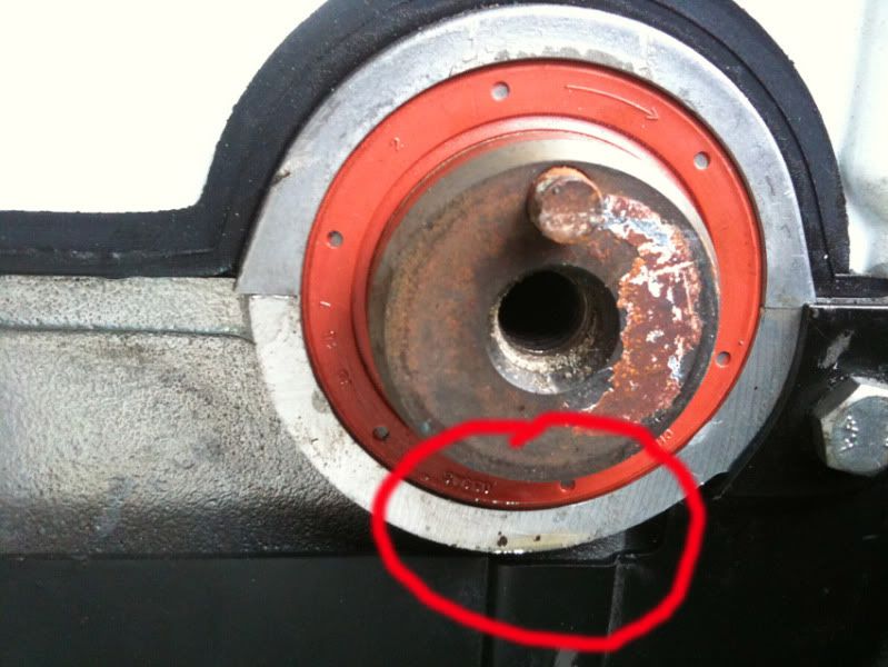

Looks like its the camshaft oil seals leaking.... On the pictures I've circled where you can see some oil that has collected on the bottom edges of the seal seats. The exahust cam looks to be the worst as I can see from the back plate that its running down the back onto the top of the engine mount. This would also make sense as to why I saw the drops of oil from the thermostat housing.
Anyways some pics...
Inlet cam oil seal
http://img.photobucket.com/albums/v3...a/inletcam.jpg
Exhaust cam oil seal
http://img.photobucket.com/albums/v3...exhaustcam.jpg
And oil that has collected on the top of engine mount
http://img.photobucket.com/albums/v3...nova/mount.jpg

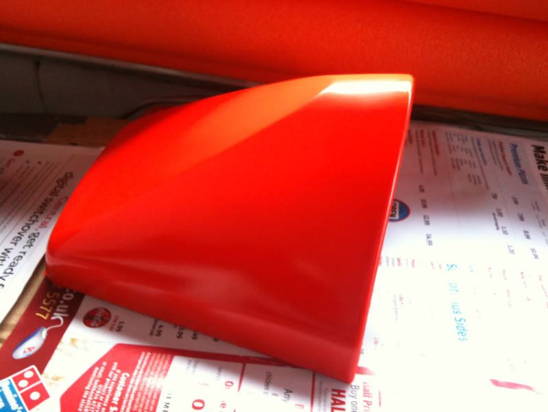

So until I get some new seals next week I left it at this point and just gave everywhere a wipe down. Next up I painted up the mirror covers from the mirrors I got from Countvaux, cheers for them James :thumb:
Nice and bright!
http://img.photobucket.com/albums/v3...ova/mirror.jpg
