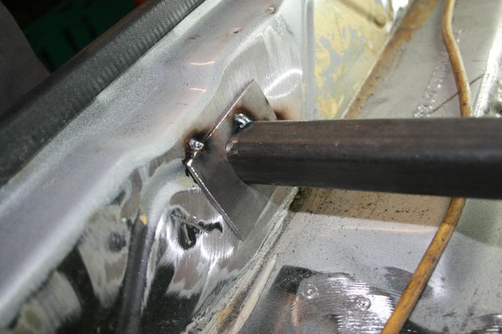

Right thought i'd update this as i haven't for ages :roll: :p

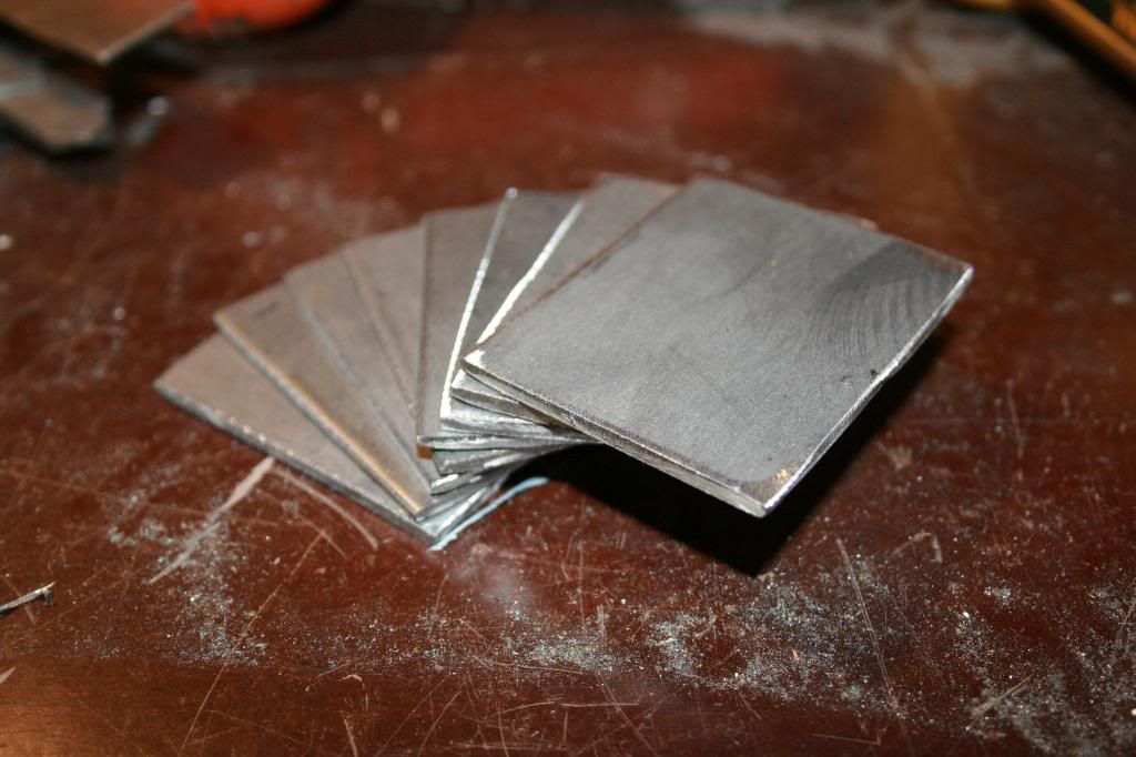

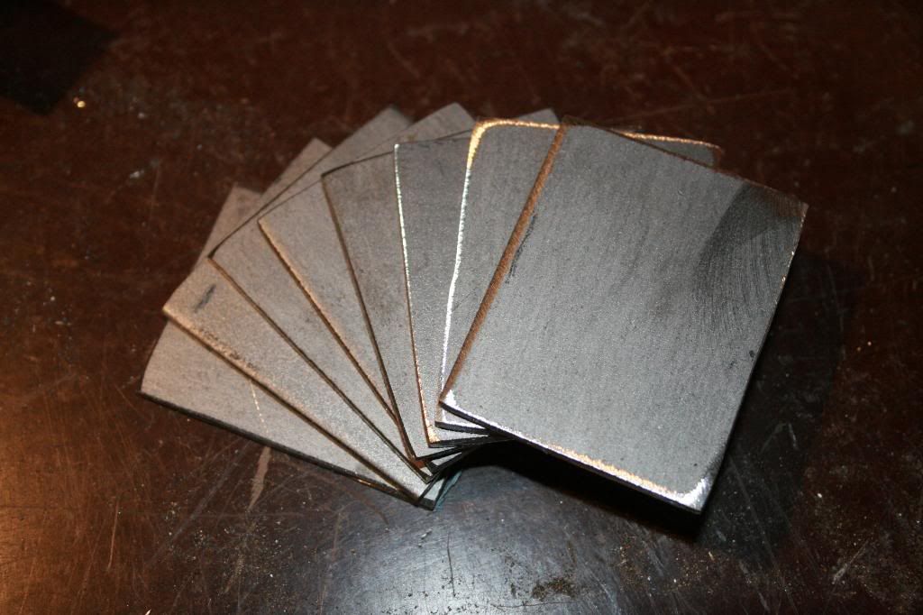

I cracked straight on with fitting the seat rails for the subframes - i started by cutting up these 50x65mm rectangles (3mm plate btw) for the ends of the seat rails

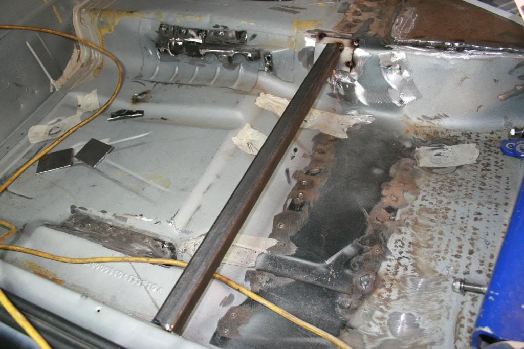

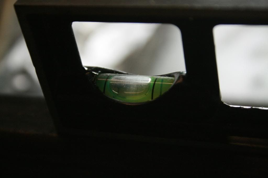

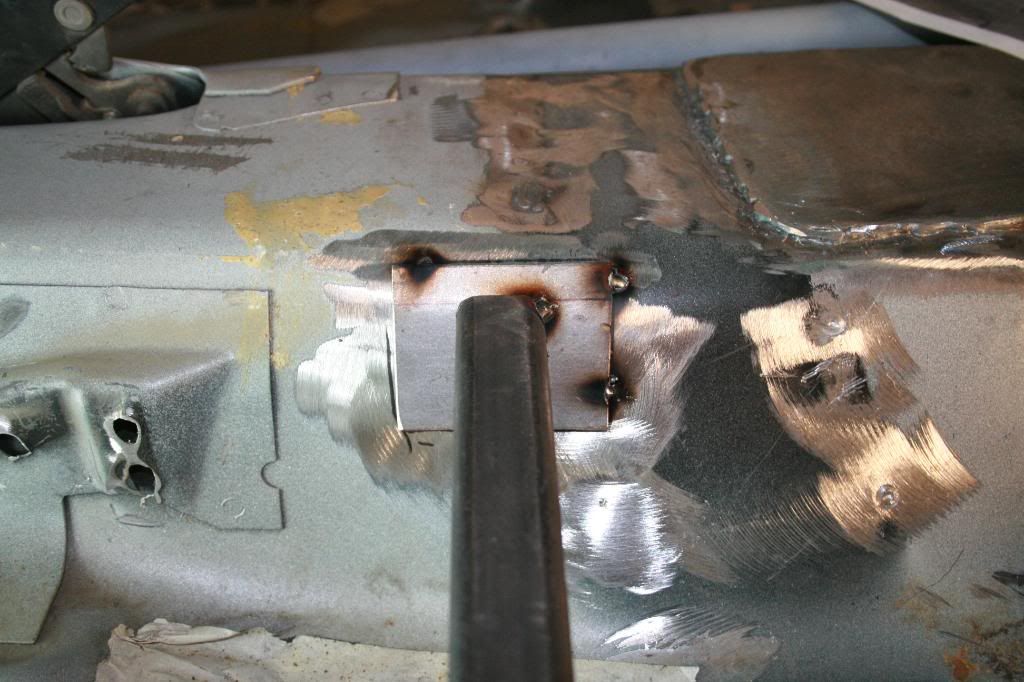

I then marked out the rough area and cleaned it up with a sanding disc. Once i was happy with the positioning i tacked them in and made some more measurements and adjustments
http://i248.photobucket.com/albums/g...ndseats044.jpg
http://i248.photobucket.com/albums/g...ndseats045.jpg
http://i248.photobucket.com/albums/g...ndseats046.jpg

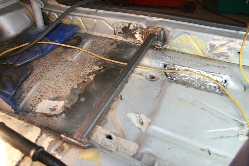

Thats good enough for me
http://i248.photobucket.com/albums/g...ndseats047.jpg

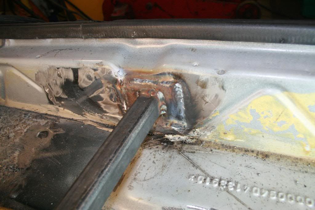

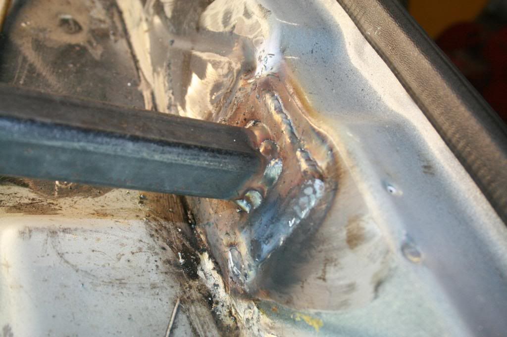

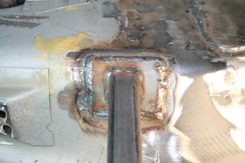

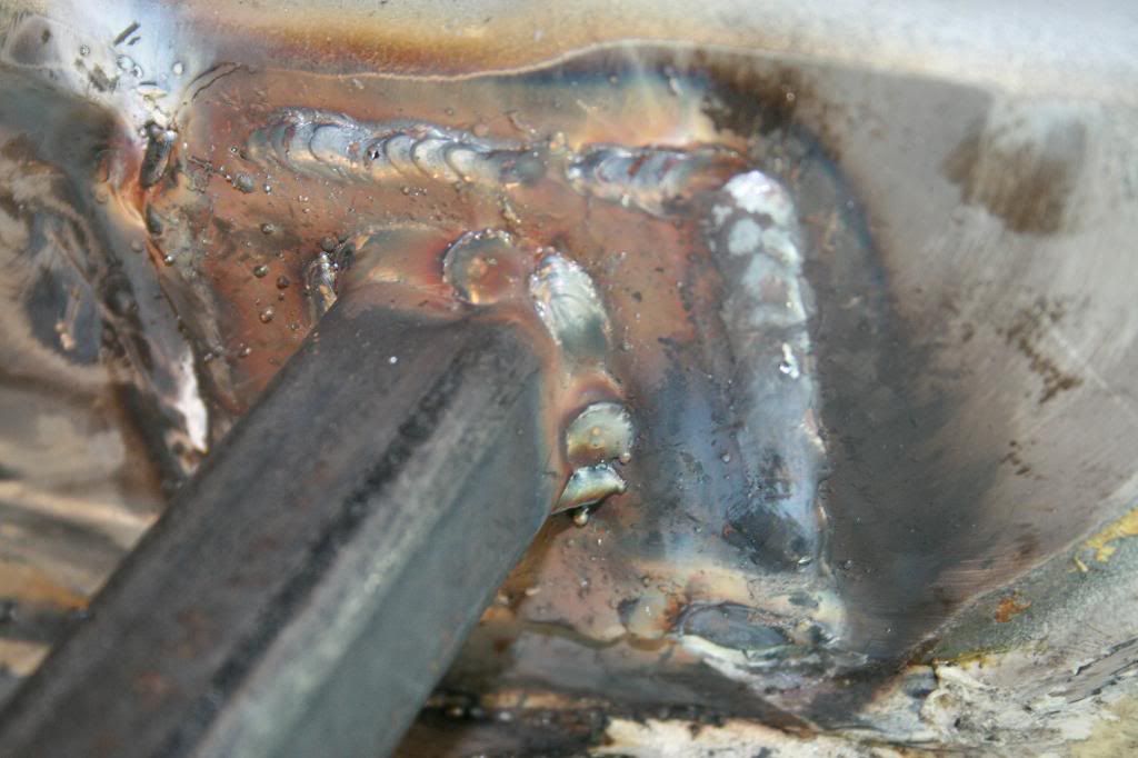

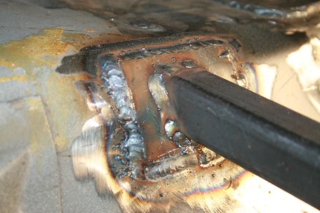

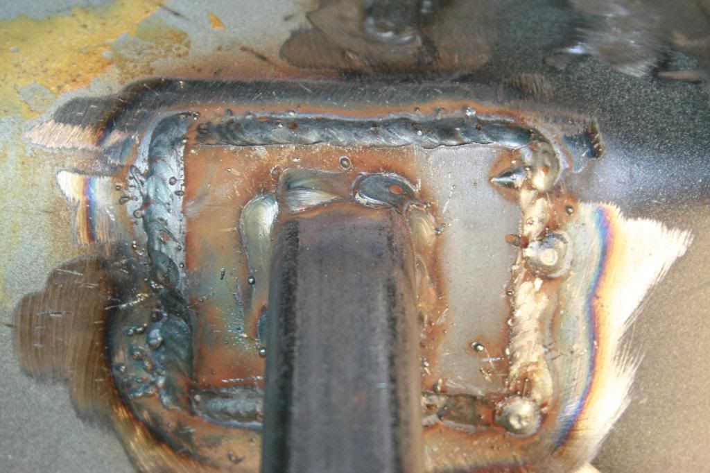

So i welded it in for good
http://i248.photobucket.com/albums/g...ndseats048.jpg
http://i248.photobucket.com/albums/g...ndseats049.jpg
http://i248.photobucket.com/albums/g...ndseats050.jpg
http://i248.photobucket.com/albums/g...ndseats051.jpg
http://i248.photobucket.com/albums/g...ndseats052.jpg
http://i248.photobucket.com/albums/g...ndseats053.jpg
http://i248.photobucket.com/albums/g...ndseats054.jpg
