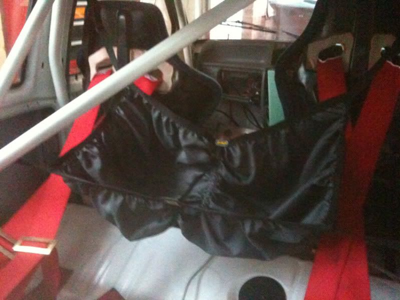

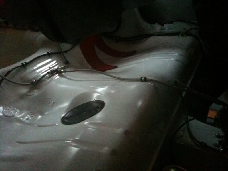

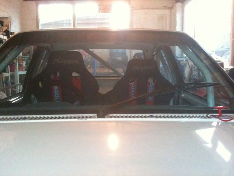

Also semi got the digi dash working with thanks to Iain and his multi meter! Cheers mate. Gave the drivers side floor and footwell a lick of fresh paint aswell the back bench area as I had a slight brake fluid leak a while back. Seats & harnesses are all back in and even put my helmet hammock in aswell which I got for Xmas 2 years ago lol
