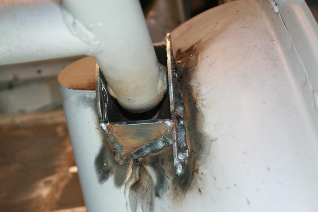

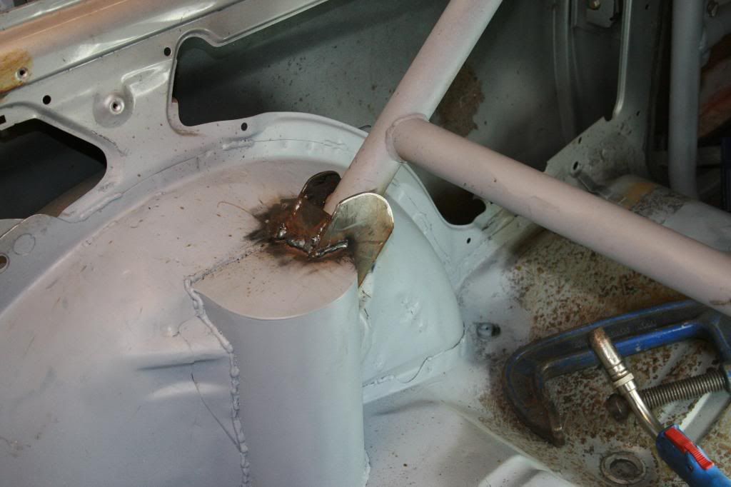

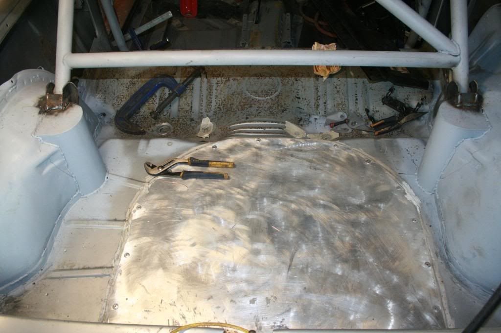

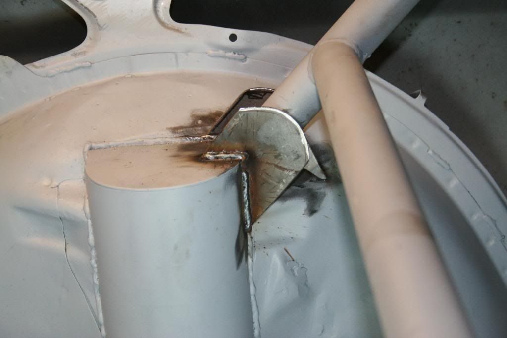

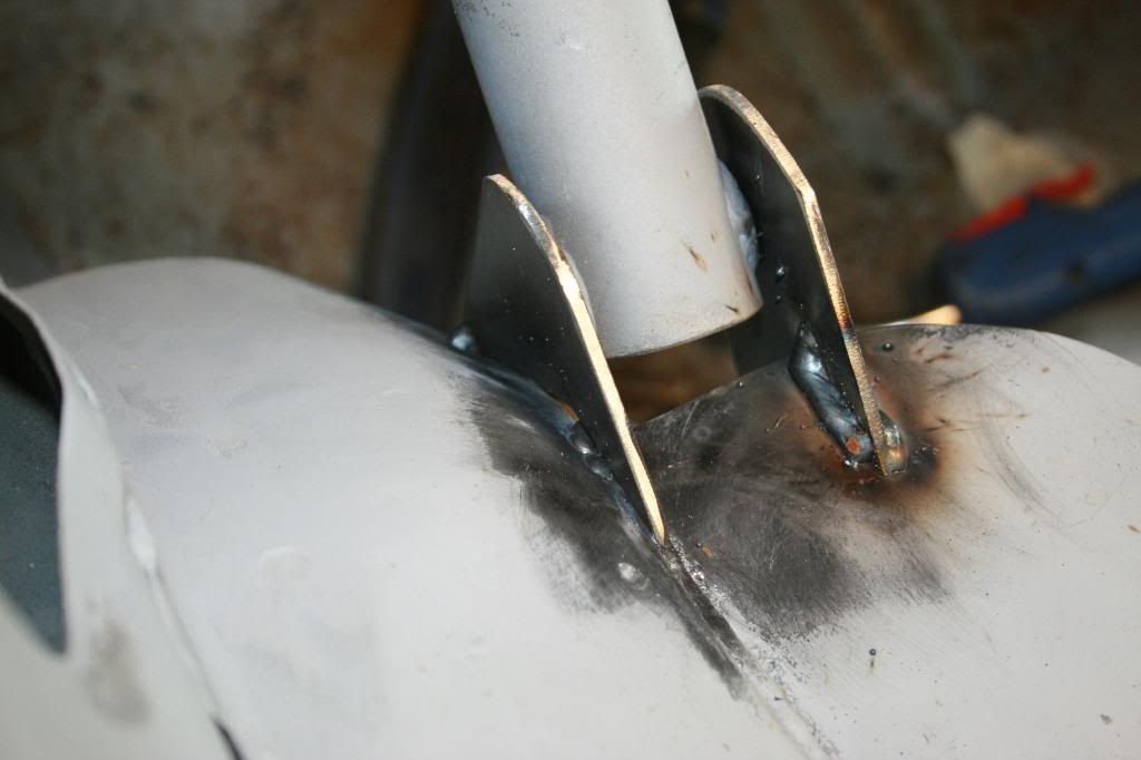

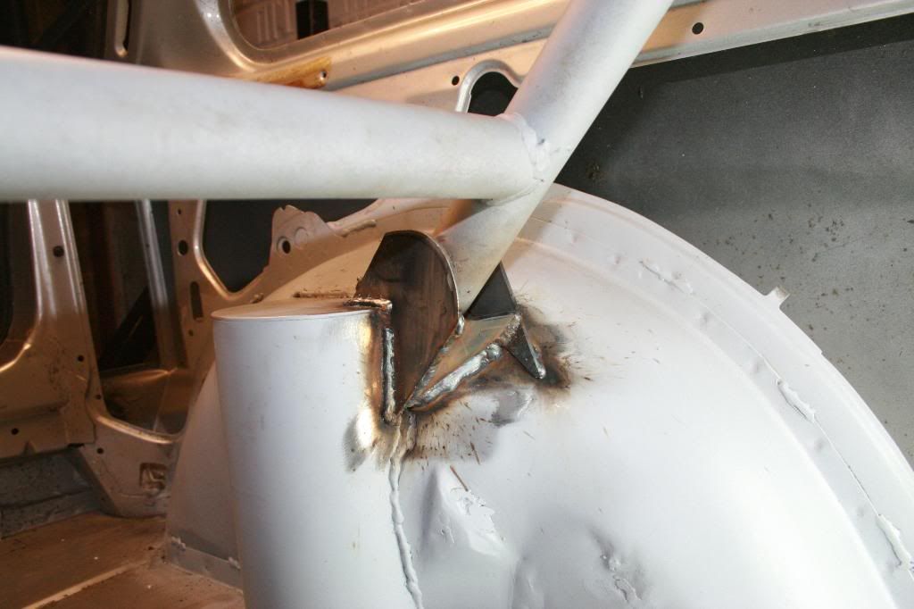

Picked up were i left off last night finishing off the N/S rear cage to turret mount
http://i248.photobucket.com/albums/g...ndseats001.jpg
http://i248.photobucket.com/albums/g...ndseats005.jpg

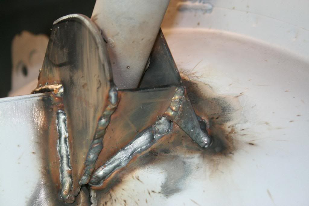

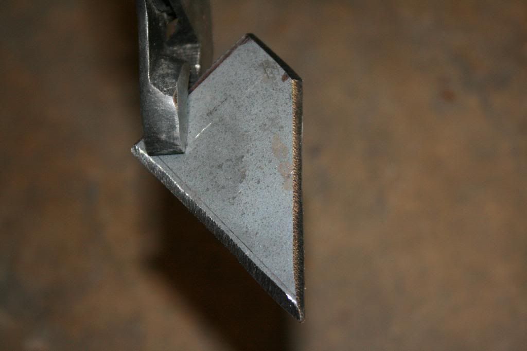

Then some strengthening again
http://i248.photobucket.com/albums/g...ndseats006.jpg
This ended up here
http://i248.photobucket.com/albums/g...ndseats008.jpg
http://i248.photobucket.com/albums/g...ndseats010.jpg

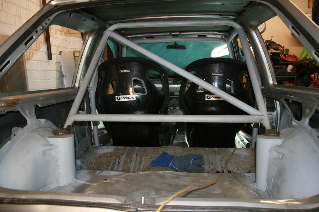

And all done - thats nearly the cage mounting finished WOOP WOOP!!!
http://i248.photobucket.com/albums/g...ndseats012.jpg
http://i248.photobucket.com/albums/g...ndseats014.jpg
http://i248.photobucket.com/albums/g...ndseats011.jpg

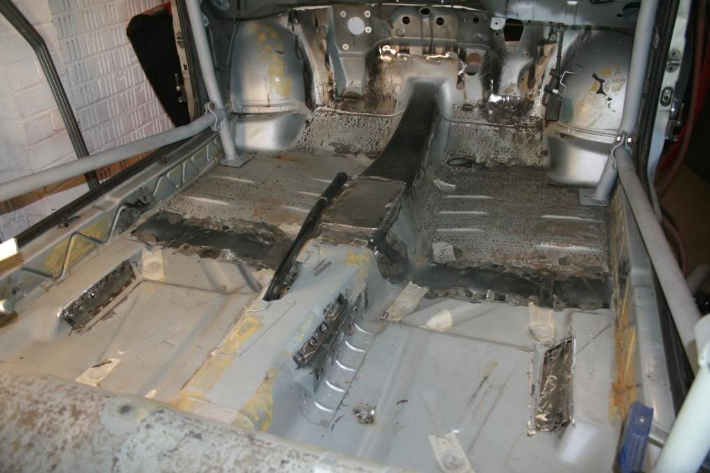

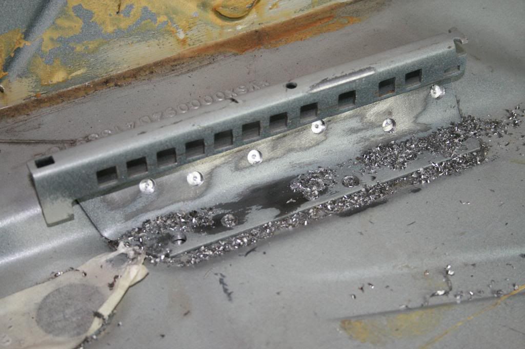

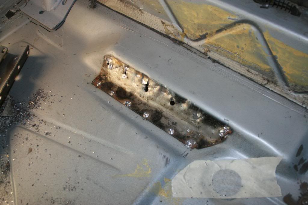

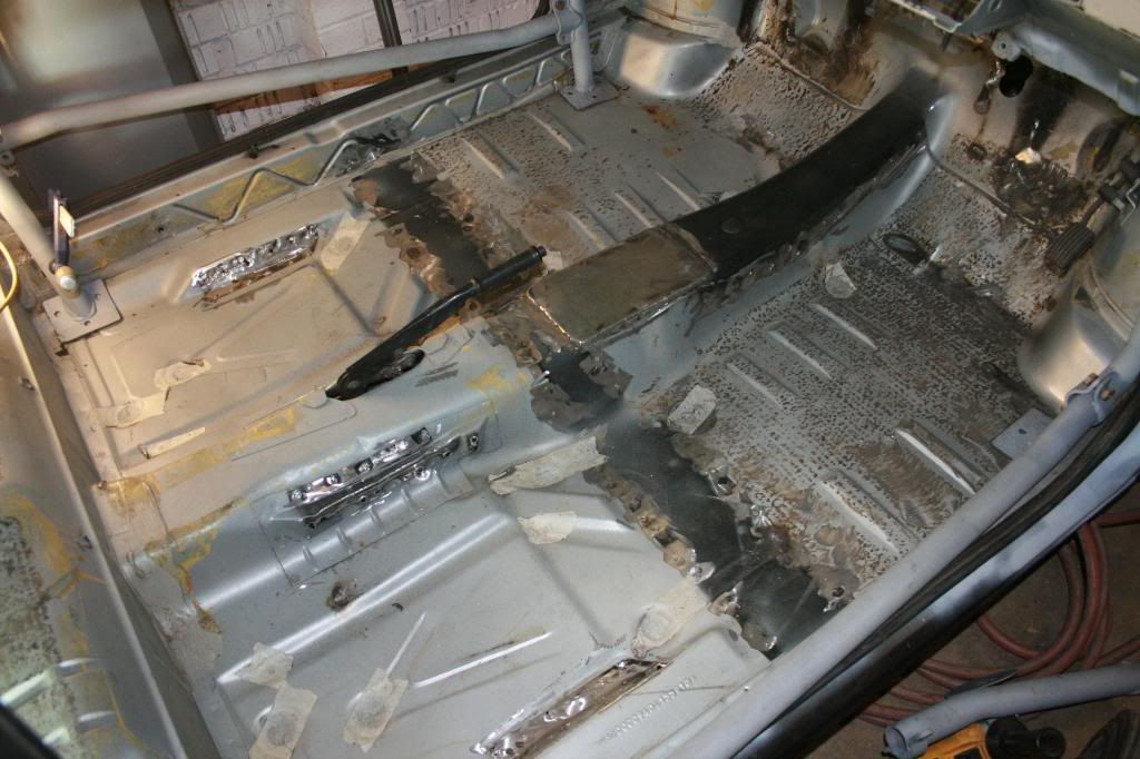

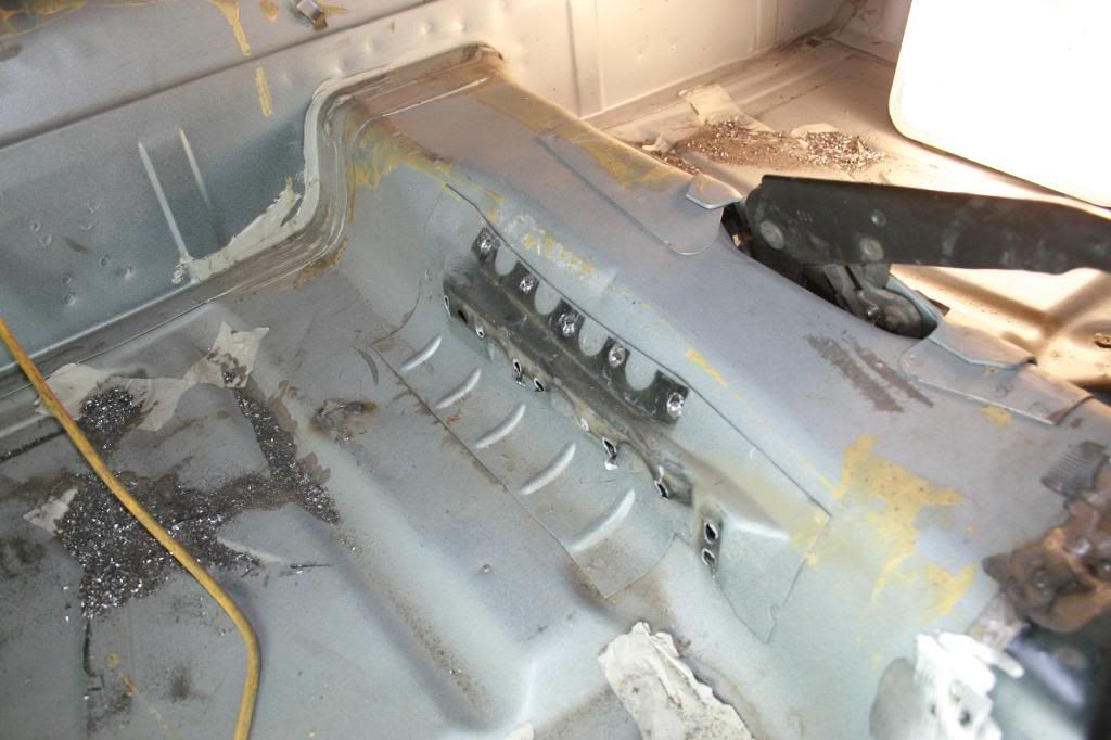

I started by doing away with the original seat mounts (yes more fecking spot welds!) but at least i'm loosing metal not adding it
http://i248.photobucket.com/albums/g...ndseats015.jpg
http://i248.photobucket.com/albums/g...ndseats016.jpg
I will say these are the worst to remove out of everything that is spot welded down in a nova imo as the metal is thick and the spot welds are unobviously positioned meaning missage is rife resulting in certain holage doh! lol
http://i248.photobucket.com/albums/g...ndseats018.jpg

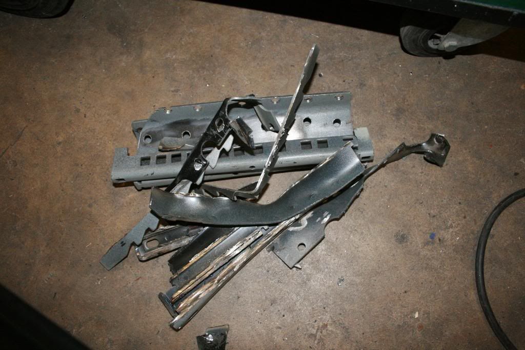

And the rest removed taking about an hour
http://i248.photobucket.com/albums/g...ndseats024.jpg
http://i248.photobucket.com/albums/g...ndseats023.jpg
this is what was removed
http://i248.photobucket.com/albums/g...ndseats027.jpg

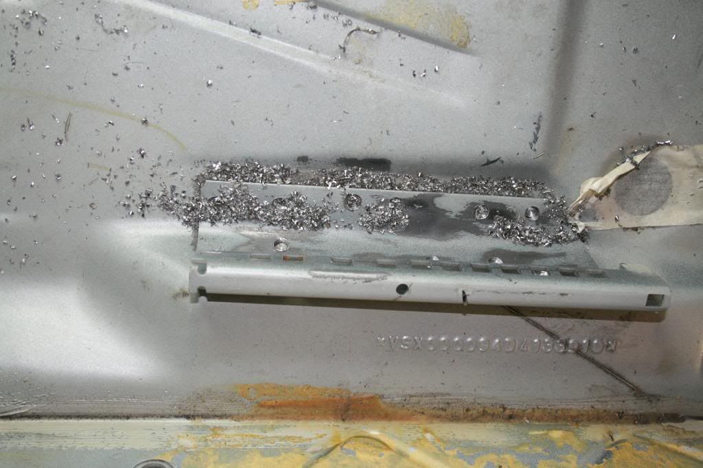

And this is the end result with all the sh!t cleaned out - much better i did hit it with the air blower after i took this shot also.
http://i248.photobucket.com/albums/g...ndseats029.jpg
http://i248.photobucket.com/albums/g...ndseats028.jpg

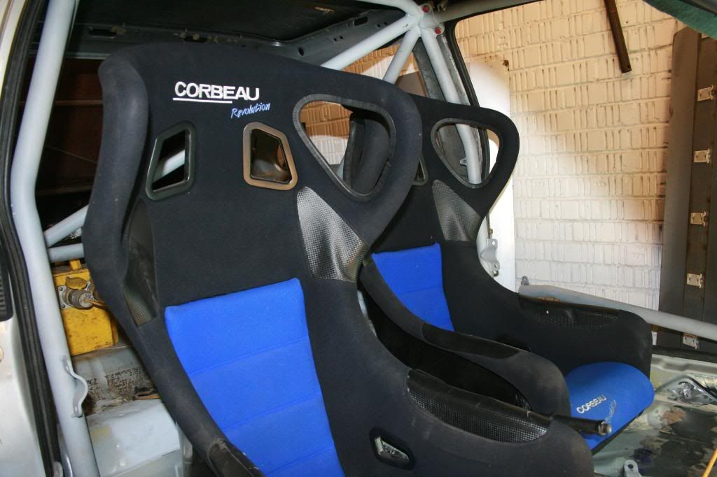

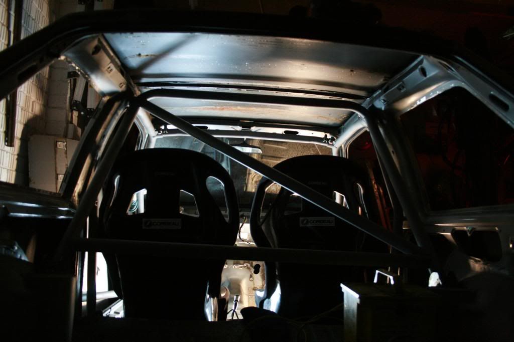

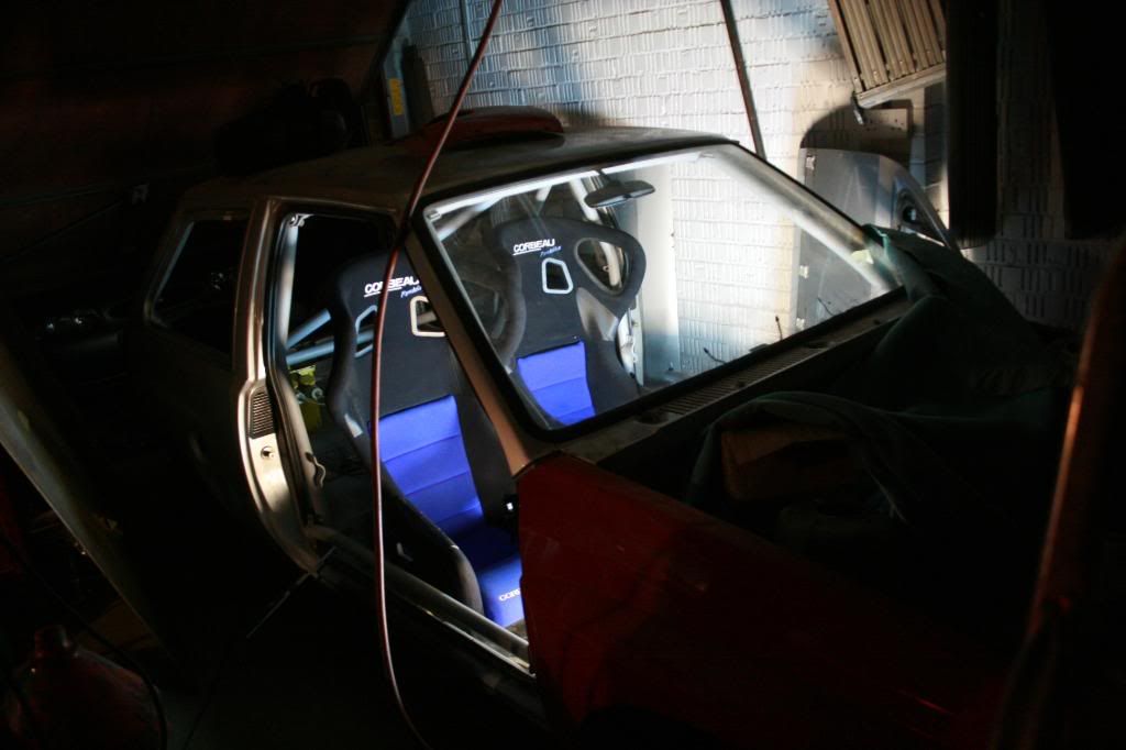

Now its all cleared out i can start positioning the seats
http://i248.photobucket.com/albums/g...ndseats030.jpg
Yer baby
http://i248.photobucket.com/albums/g...ndseats034.jpg

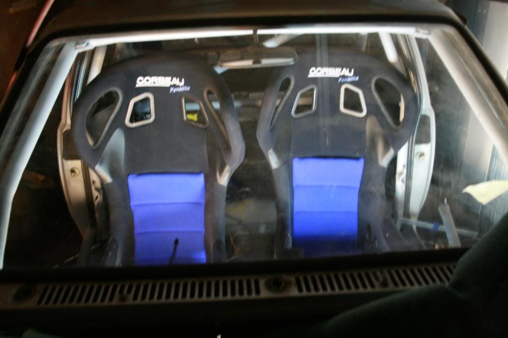

And some arty attempts just for you Olly (admittedly you do it best ;))
http://i248.photobucket.com/albums/g...ndseats035.jpg
http://i248.photobucket.com/albums/g...ndseats038.jpg
http://i248.photobucket.com/albums/g...ndseats036.jpg
http://i248.photobucket.com/albums/g...ndseats040.jpg
Proper mounting al la subframe fitment etc to follow enjoy for now :D :D
