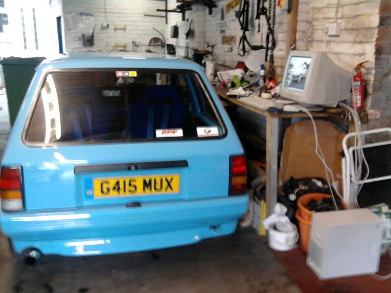

Got an old PC setup in the lockup today, played with injector mili-second values .. i think lol..
In order to get those CO's down.
http://img.photobucket.com/albums/v1.../Photo0208.jpg
I took 20% off the figures @ site 0 and 10% @ site 1, between 750rpm and 1500rpm.. :-s
Im booking it in at the same mot place for a quick emmsions check, if its any better (or lower) than last time but not quite enough then back to the pc and lower them a bit more. I doubt ill have got the car good enough 1st time but if i have: theyll carry out the mot retest. But most likely try again friday. If no difference, the sod it i give up lol.
