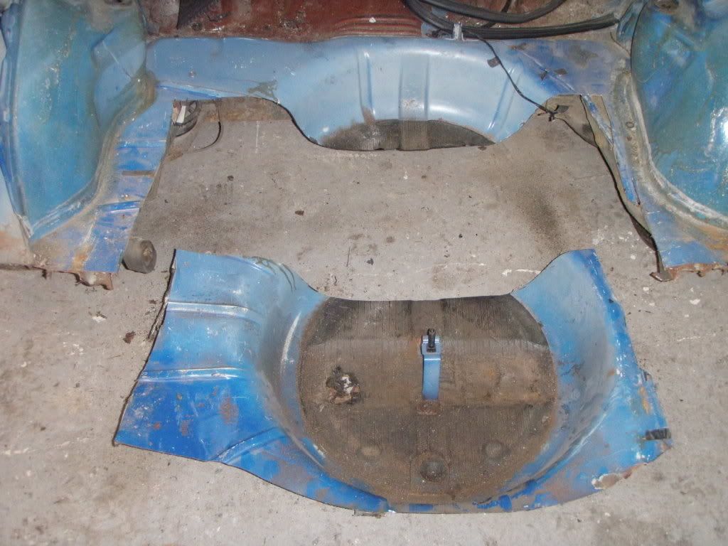

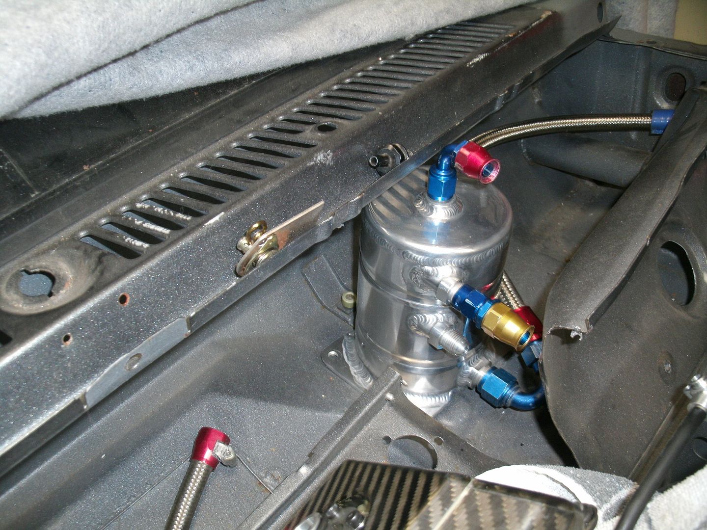

i thought this car isn't allowed to be modified between the wheel centres??? surely that chopped bit of firewall breaks your rules, no? also, whats your oil catch tank (I assume that's what it is, on the bulkhead) taken from?

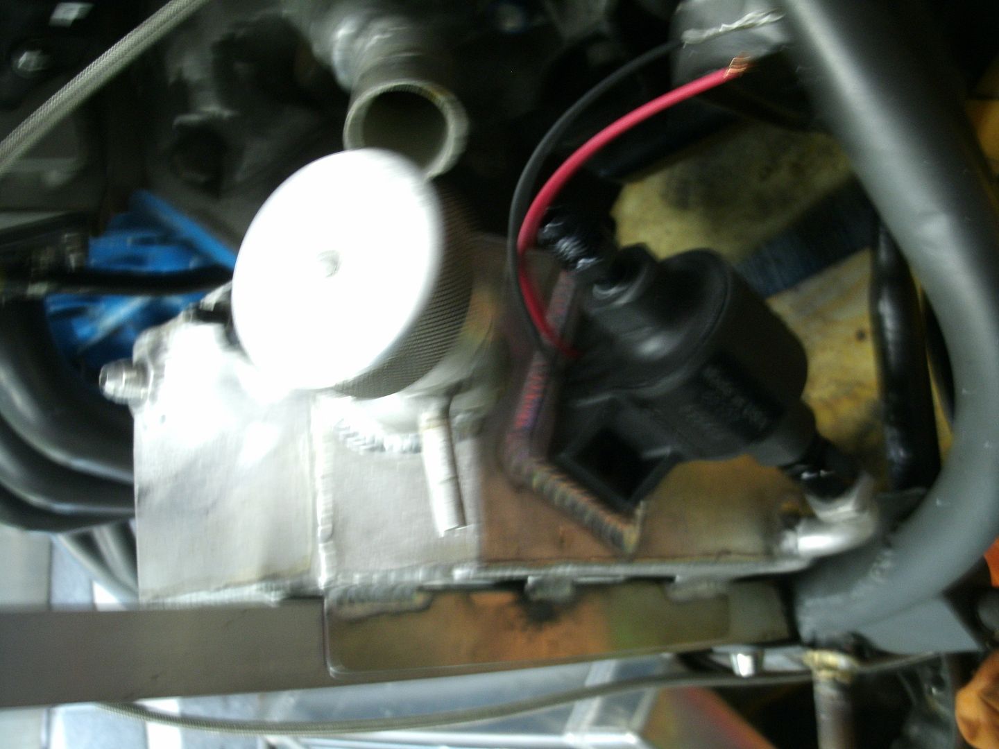

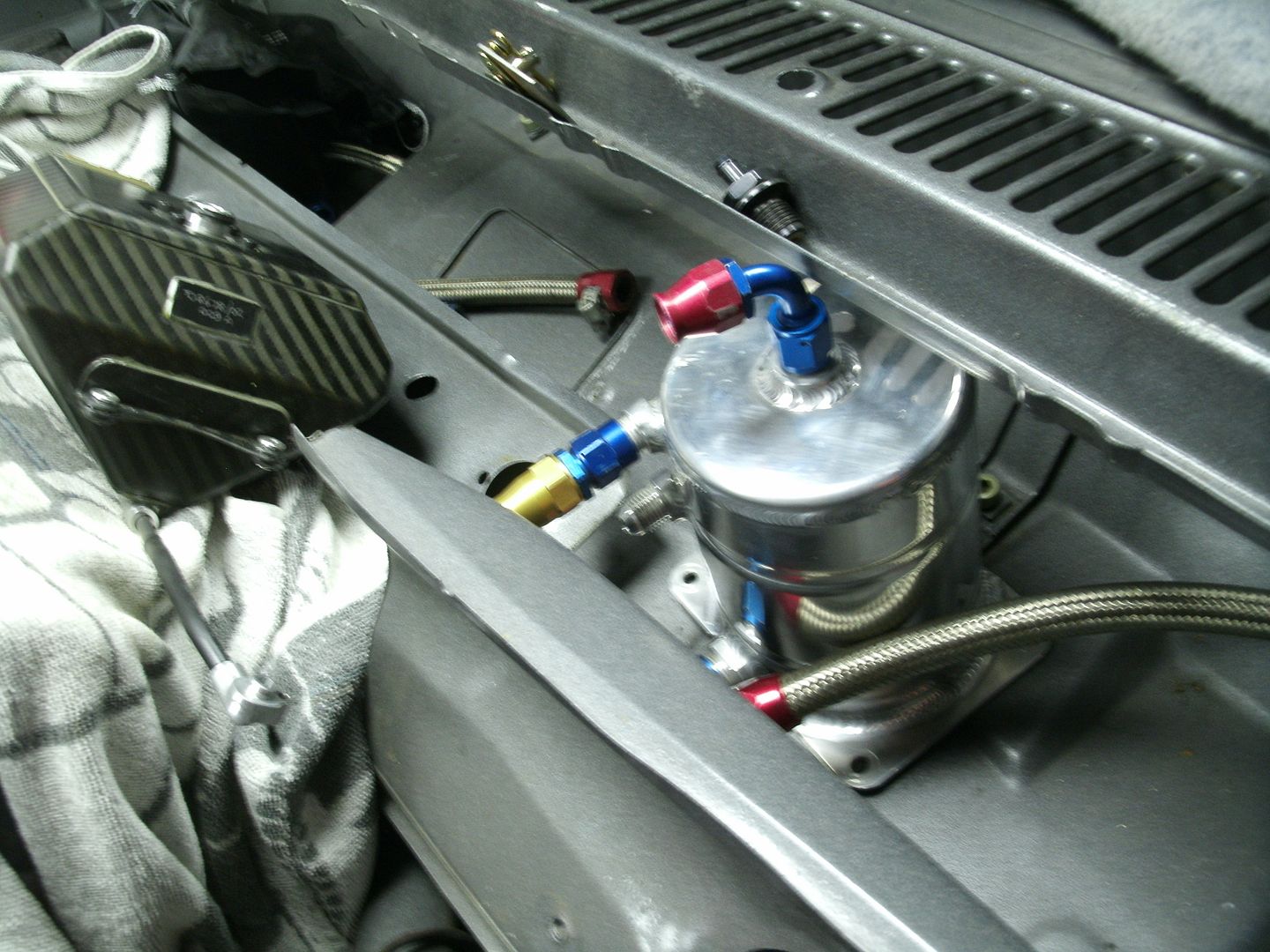

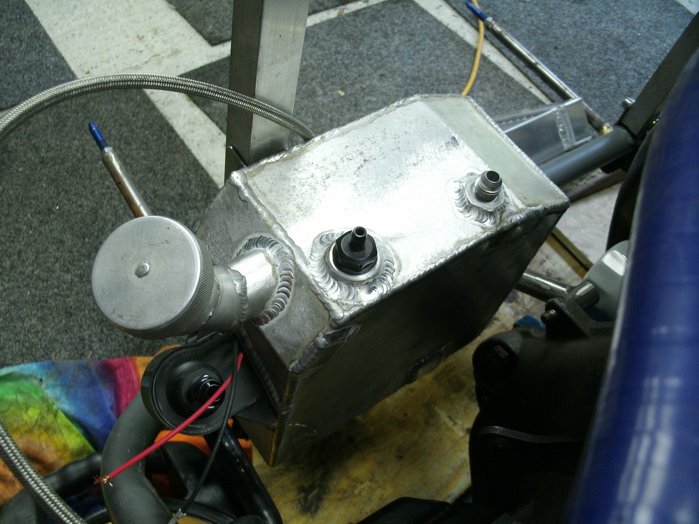

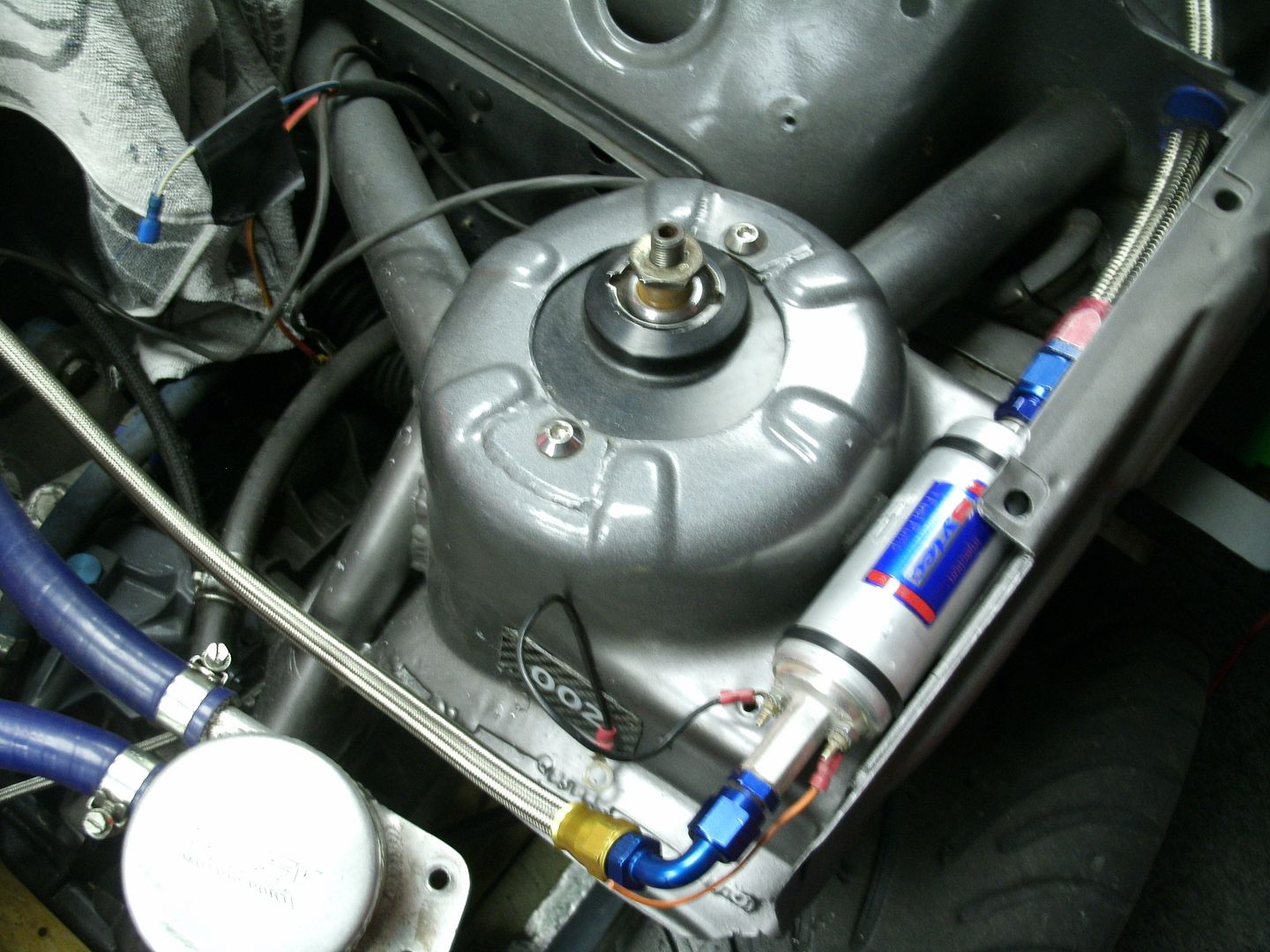

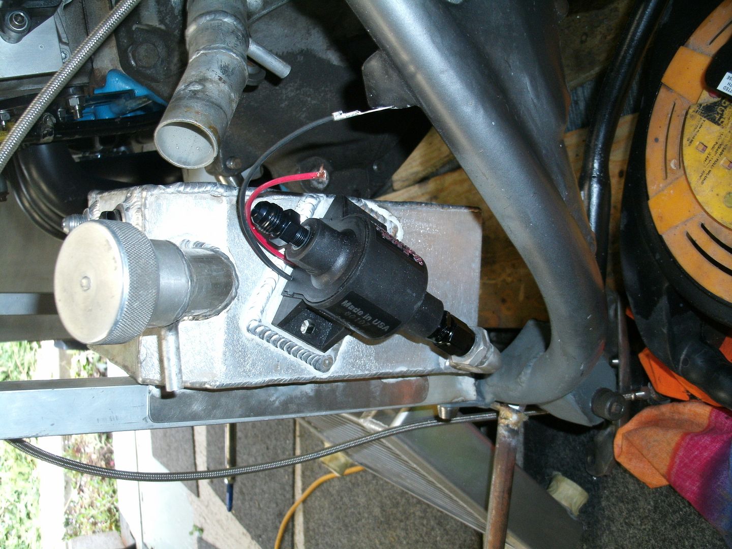

A little more playing about with the fuel system.
A new swirl pot (the 3rd one, and I am now happy with it), plus the high pressure fuel pump is now fitted and piped up.
The fuel tank has now been modified and I shall be collecting it from my welder on Monday, so I will post up pictures of it then. He's ex-Prodrive, so it should be good :)
http://i285.photobucket.com/albums/l...psgbhrvimu.jpg
http://i285.photobucket.com/albums/l...psg6l6frjv.jpg
http://i285.photobucket.com/albums/l...ps7sadhy8v.jpg
http://i285.photobucket.com/albums/l...pstmzodvie.jpg
Does it run two pumps?
Looking good Colin ,I like the lightweight pump fixings

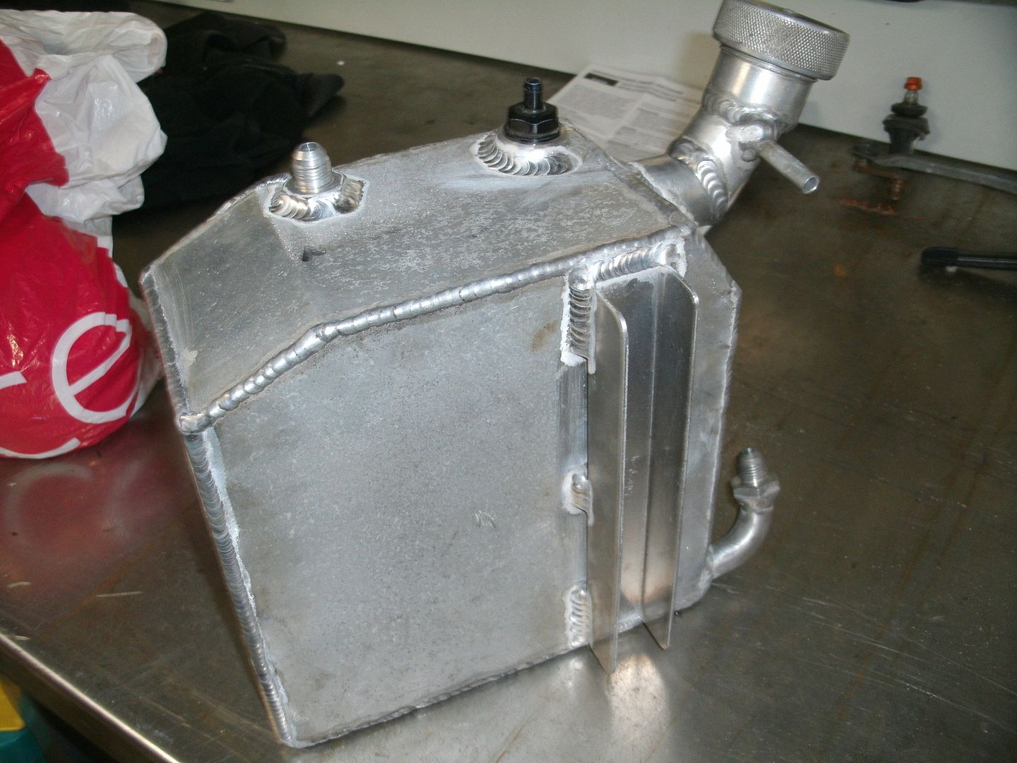

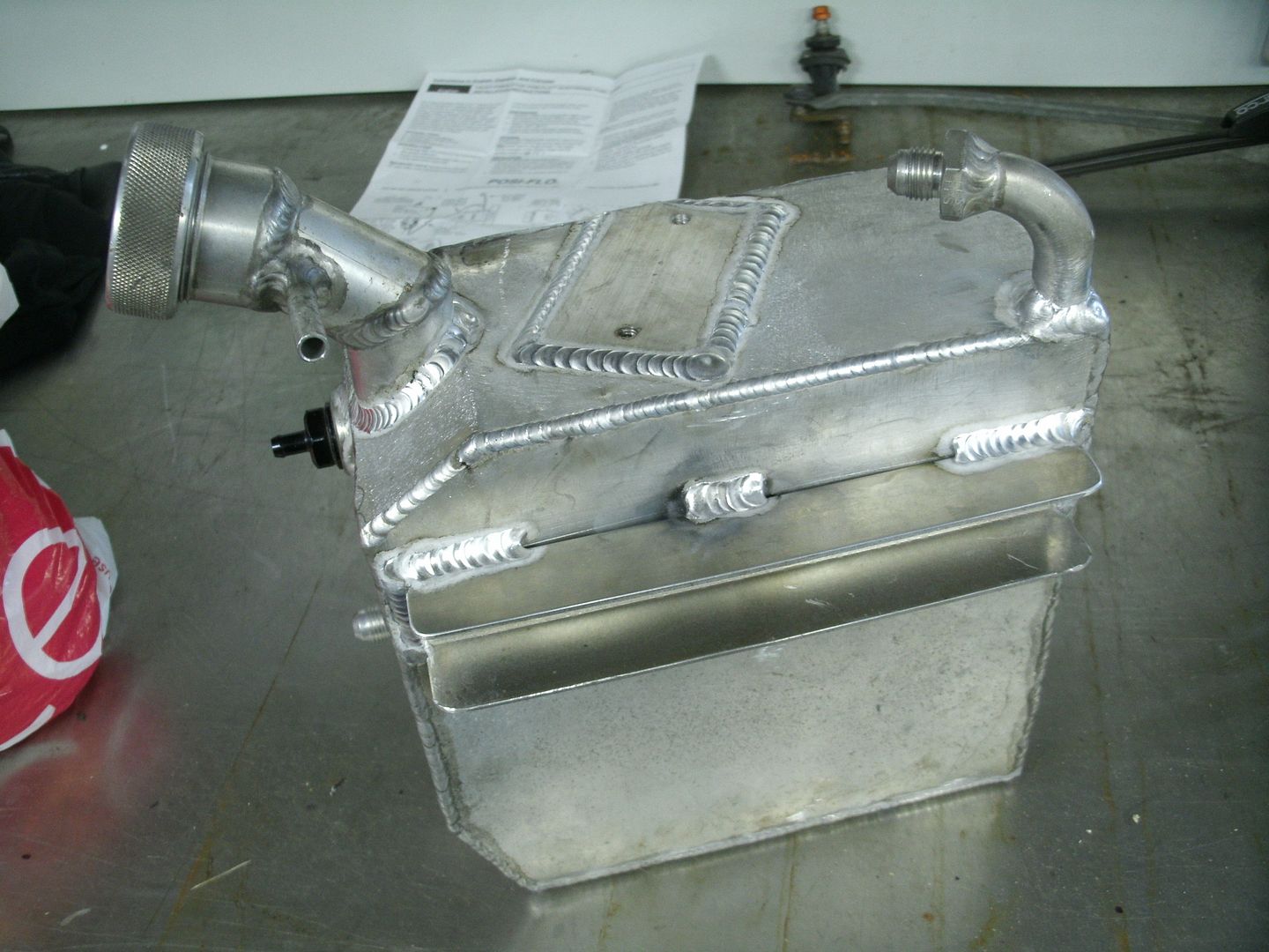

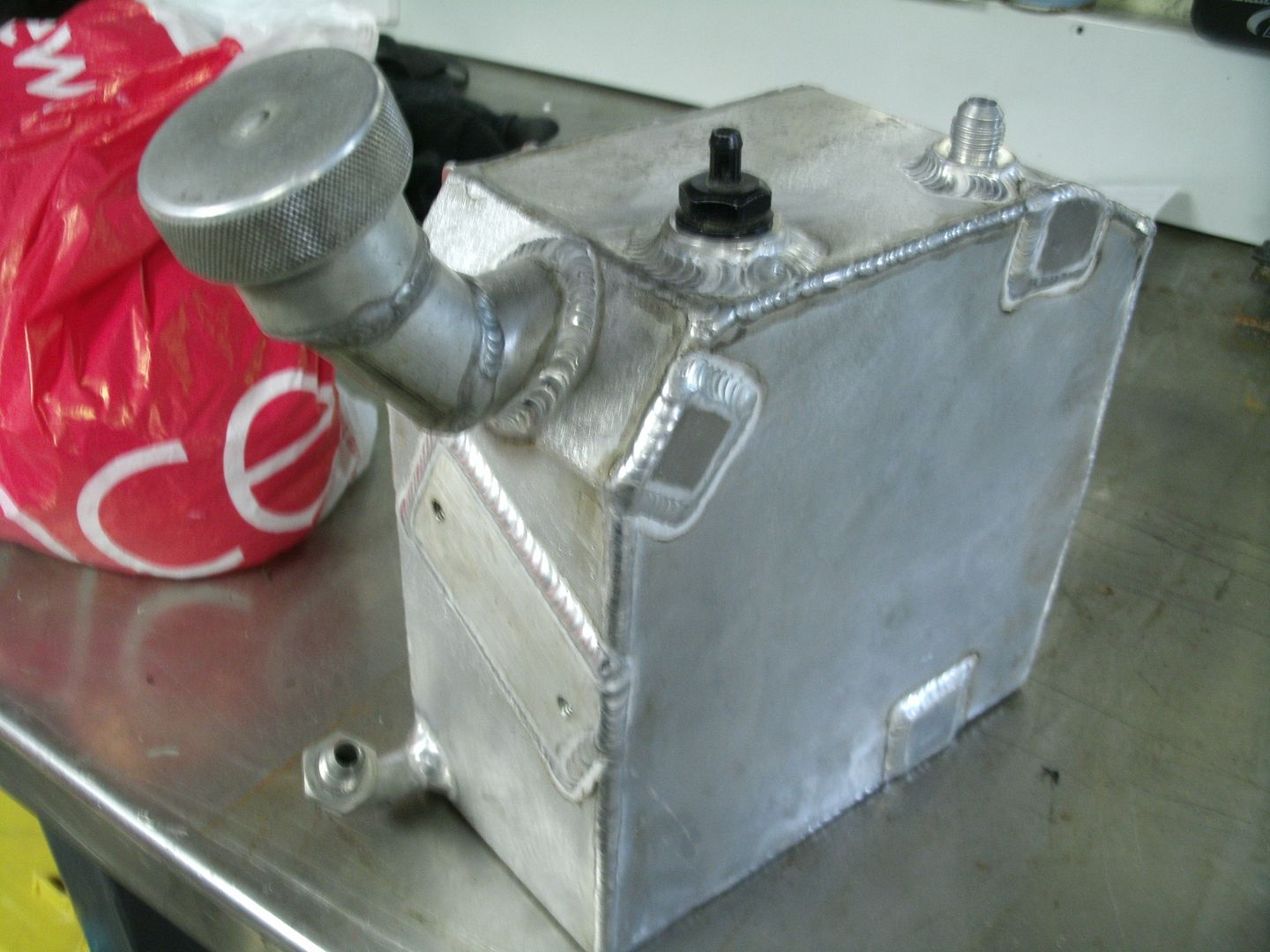

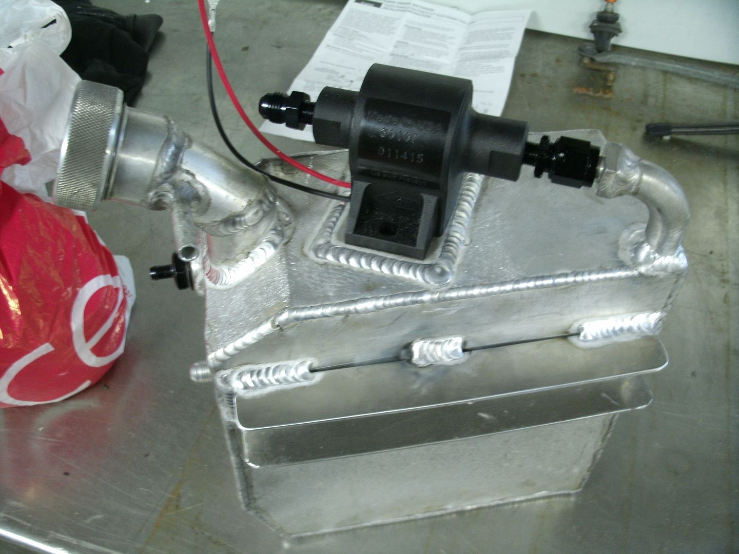

The modified fuel tank came home with me today, I'm really pleased with it, exactly what I asked for and fits perfectly;
http://i285.photobucket.com/albums/l...psxfmluoom.jpg
http://i285.photobucket.com/albums/l...psvcf1gdbu.jpg
http://i285.photobucket.com/albums/l...psddyfhwnz.jpg
http://i285.photobucket.com/albums/l...psnpn34cue.jpg
http://i285.photobucket.com/albums/l...psh0hw0dv3.jpg
http://i285.photobucket.com/albums/l...psuth41y84.jpg
http://i285.photobucket.com/albums/l...psg5fcuago.jpg
http://i285.photobucket.com/albums/l...psqq7bnwqg.jpg
Some nice fab work on the tank Colin, you must be very happy with it.

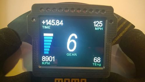

I am still waiting for the MBE new dash display system to be ready - SBD promised I would have it for the end of April, but there have been delays in production of it (it's a new design of LCD display). Stupidly I sold all the instrumentation I raced with previously so I could afford to buy this new display, and didn't have a contingency plan for delays.
Patience is a virtue ;)
Very true, and this is what I'm waiting for;

Looks good colin, welding looks awesome
Are you putting any form if isolation between mounts and the tank?

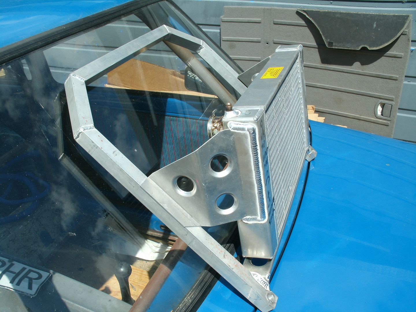

My Nova is currently away for a while, with a friend who is doing some work on it for me. The wiring loom is now all done, hoorah.

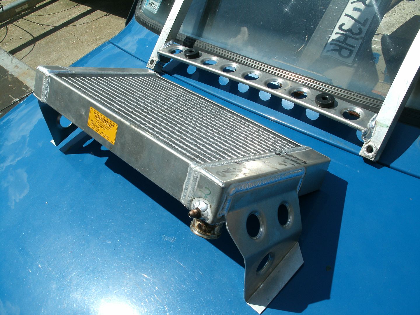

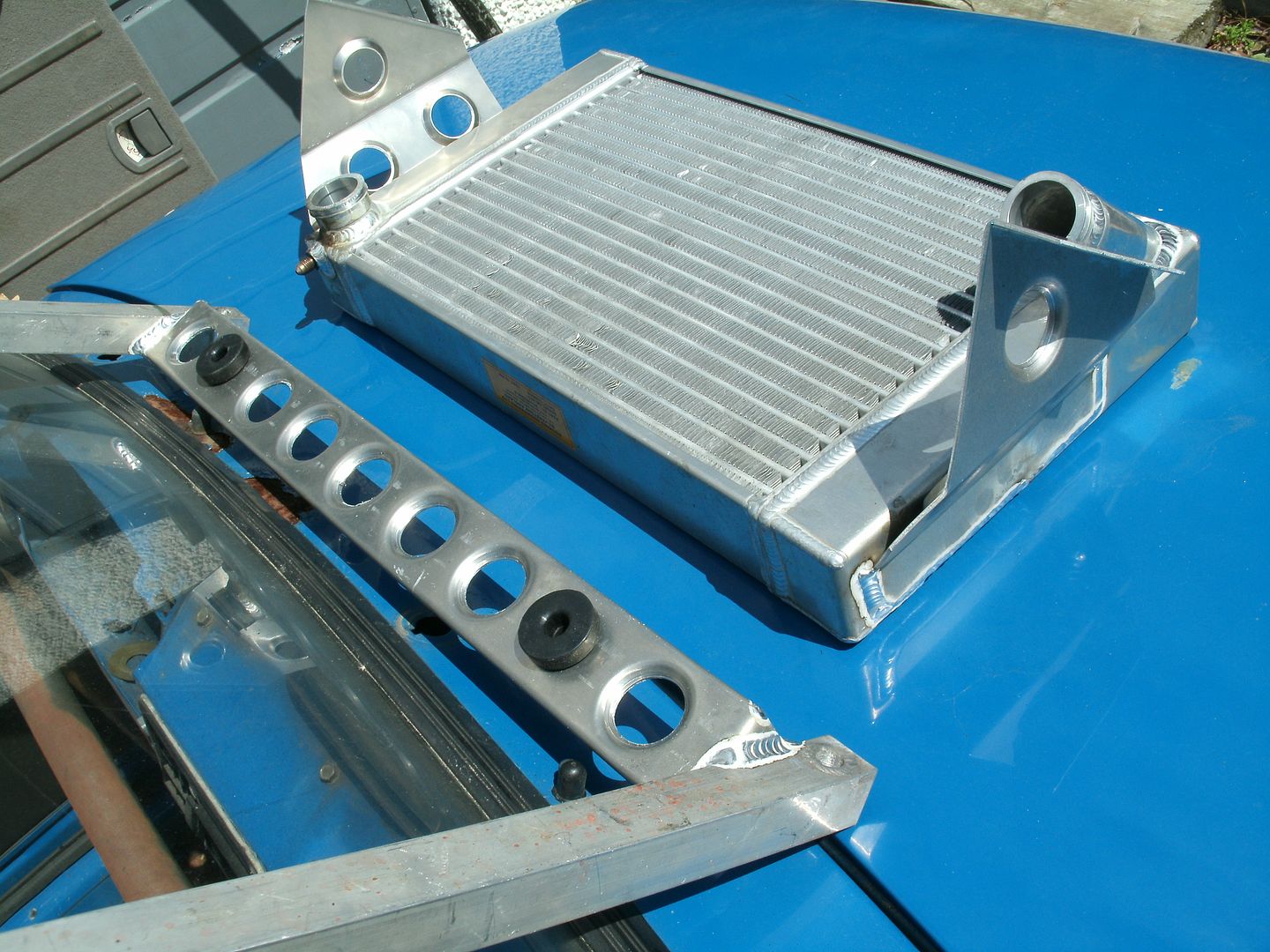

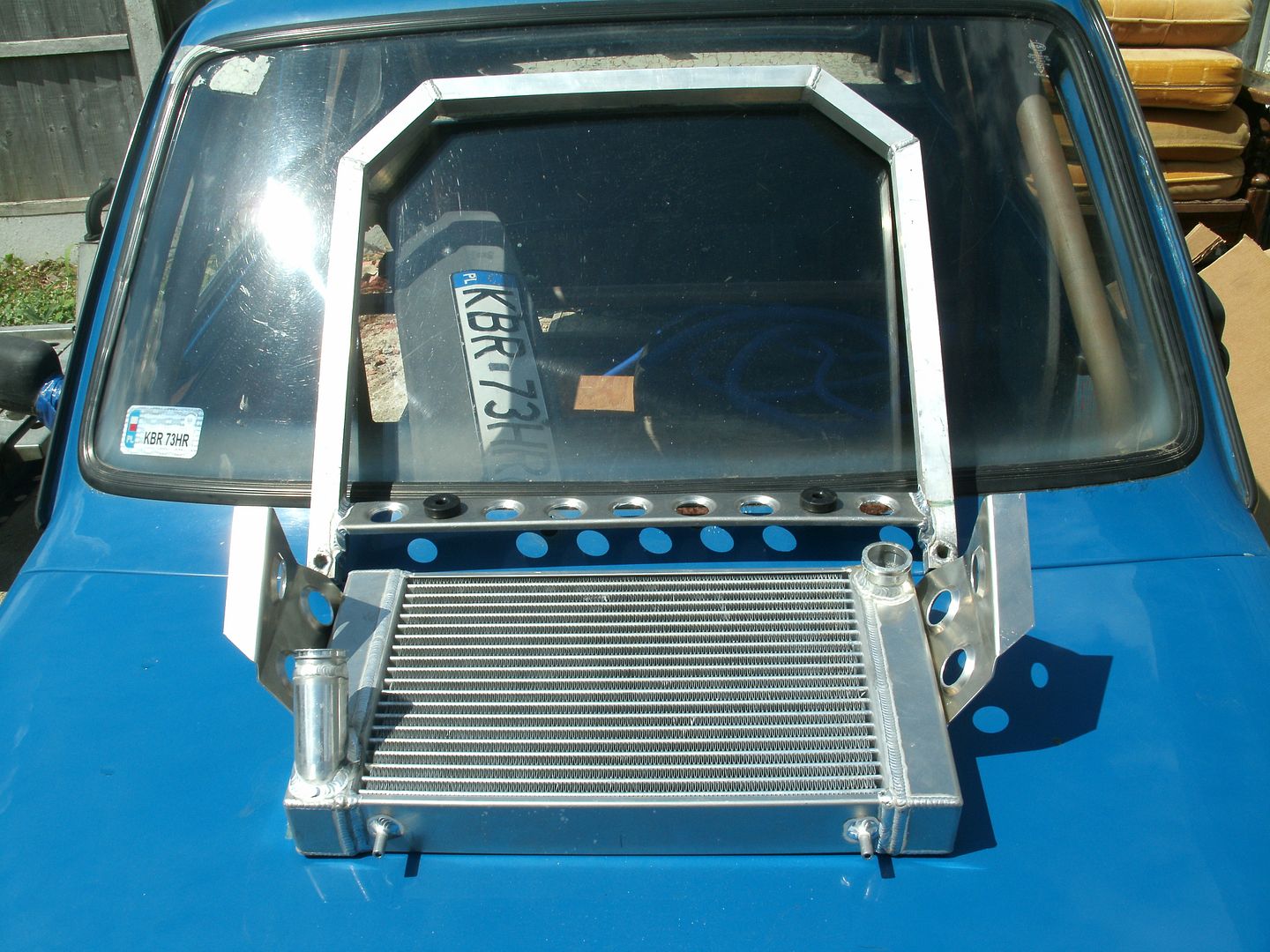

And another friend has just finished doing modifications to the radiator and mountings for it;
http://i285.photobucket.com/albums/l...ps4gn31geq.jpg
http://i285.photobucket.com/albums/l...pst6abv49o.jpg
http://i285.photobucket.com/albums/l...psakaiesqv.jpg
http://i285.photobucket.com/albums/l...ps3ugopomf.jpg
http://i285.photobucket.com/albums/l...psnghosnh7.jpg
Not surprisingly, I am delighted with how this has turned out!
Looks very nice Colin
Oooo very tastey!
Looks very good but the alloy sections welded on the ends of the inlet and outlet look to have quite sharp edges which may damage your hoses if clamped onto....

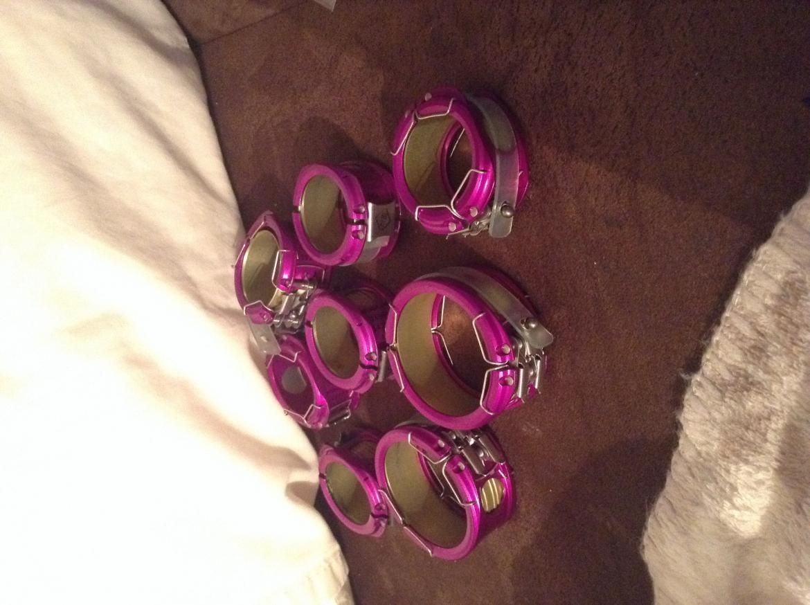

I'm ahead of you there Ben.........they are welded on ferrules on the ends of the pipes, ready to accept Wiggins connectors;
http://i285.photobucket.com/albums/l...psgskiyfhg.jpg
All coolant pipework will be done in solid alloy pipe with these connectors. No more silicone hose and jubilee clips I hope!

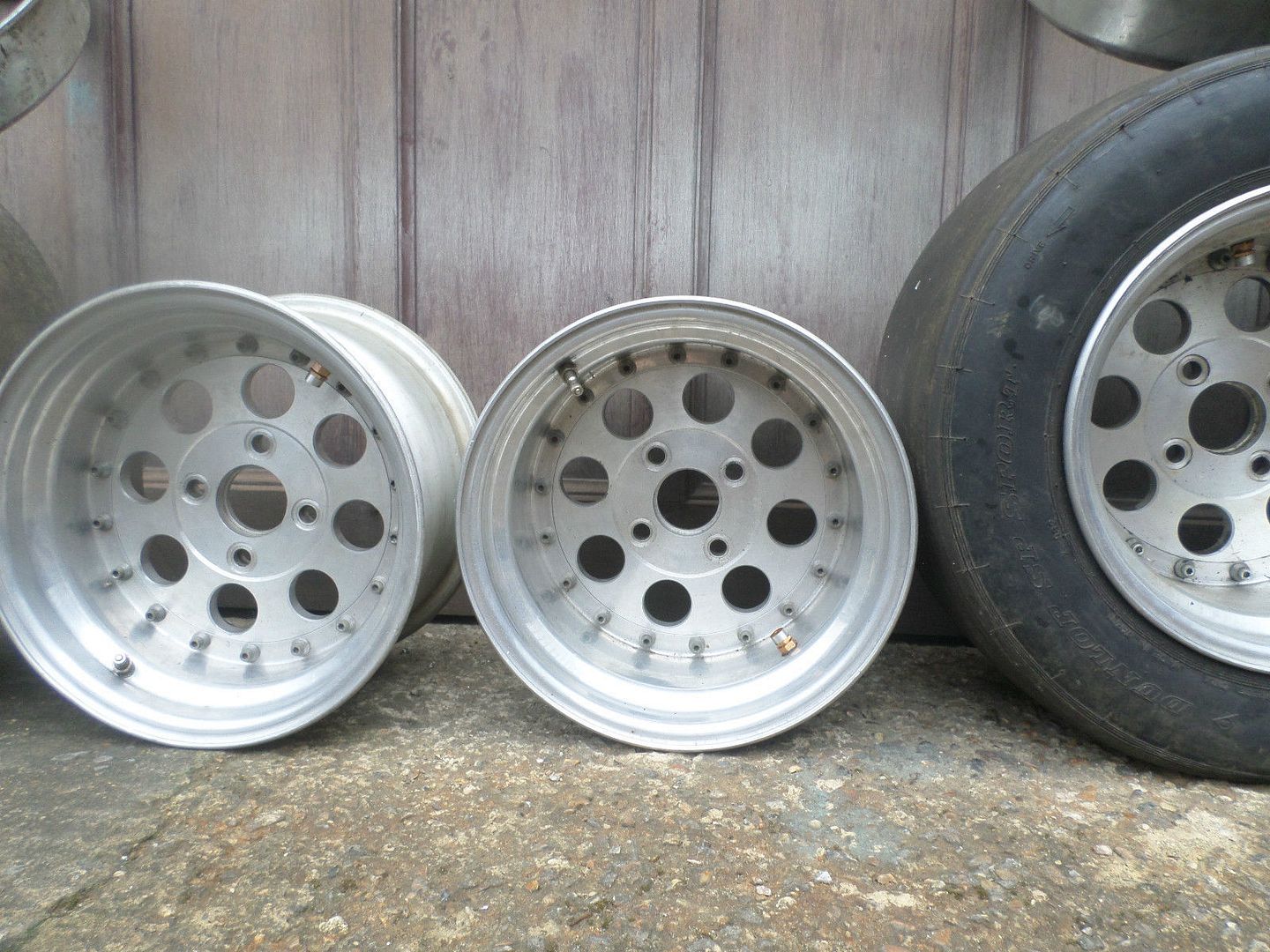

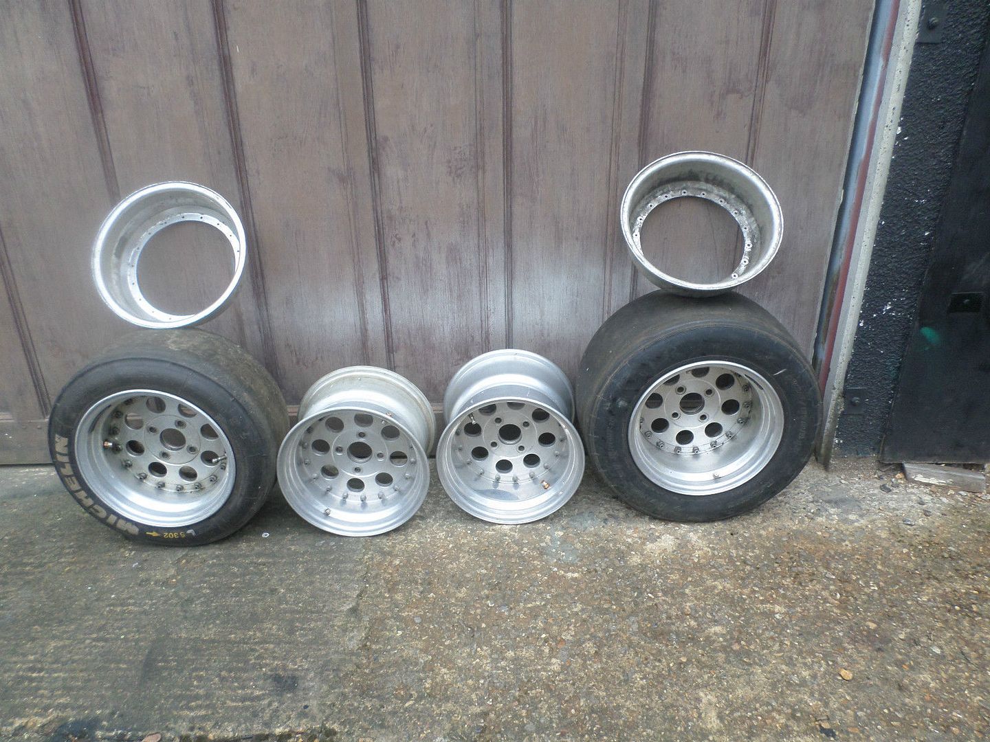

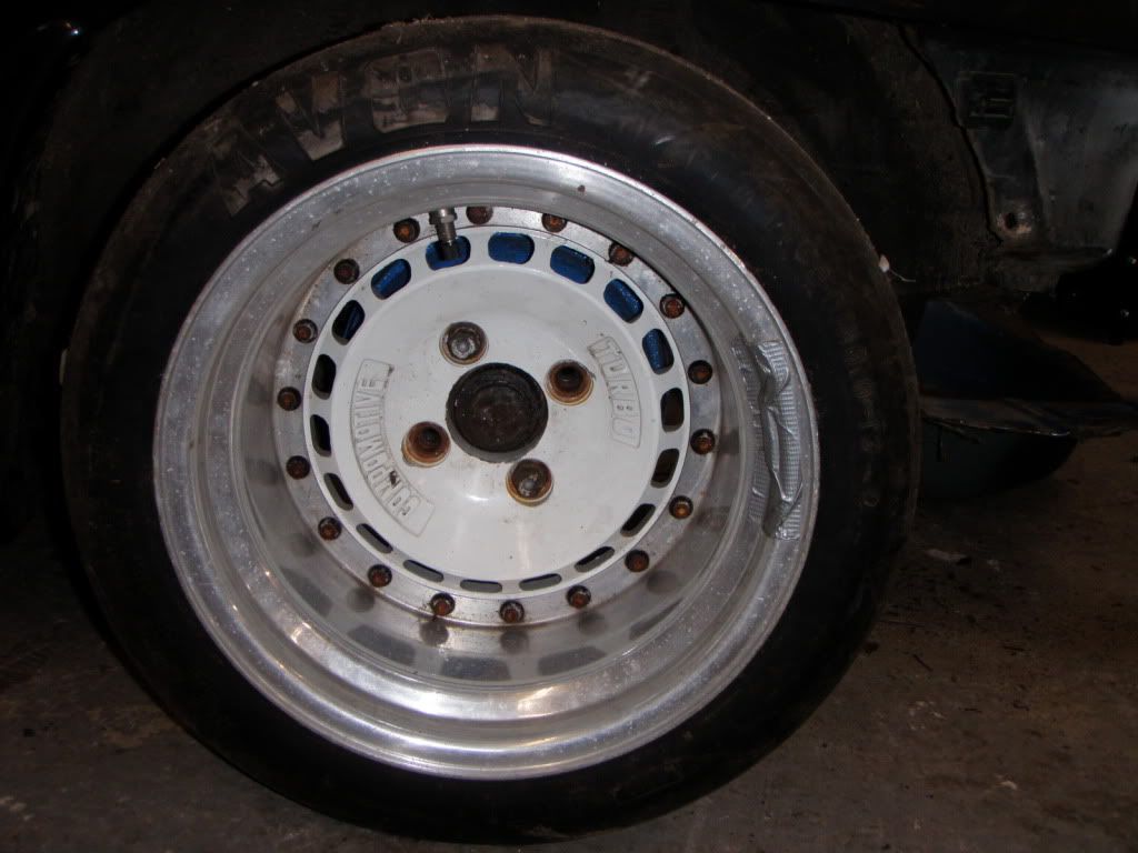

Noting much to update, apart from the acquisition of some split rim wheels.
I have absolutely no idea whether they will fit (in terms of width), but I couldn't resist them as they are a lookalike of the Speedline wheel found on one of my favourite cars, the Lancia 037;
http://i285.photobucket.com/albums/l...psv9xqklzw.jpg
http://i285.photobucket.com/albums/l...psi4bc9f3z.jpg
They were originally made for a racing Imp;
http://i285.photobucket.com/albums/l...psctvabrsz.jpg
They are very cool.
That IMP is very cool

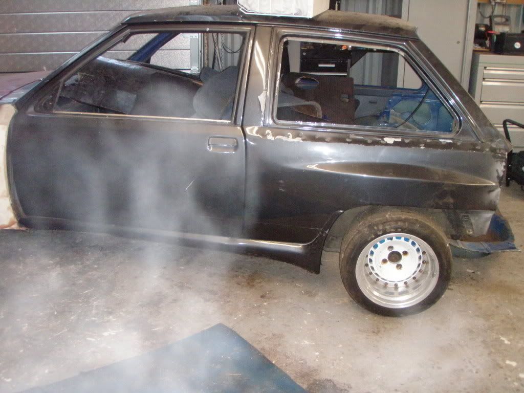

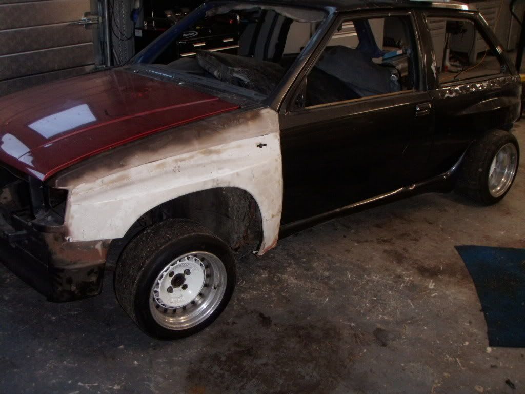

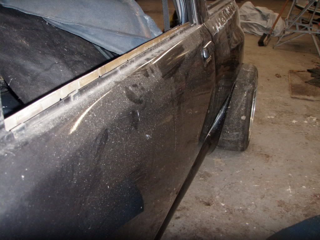

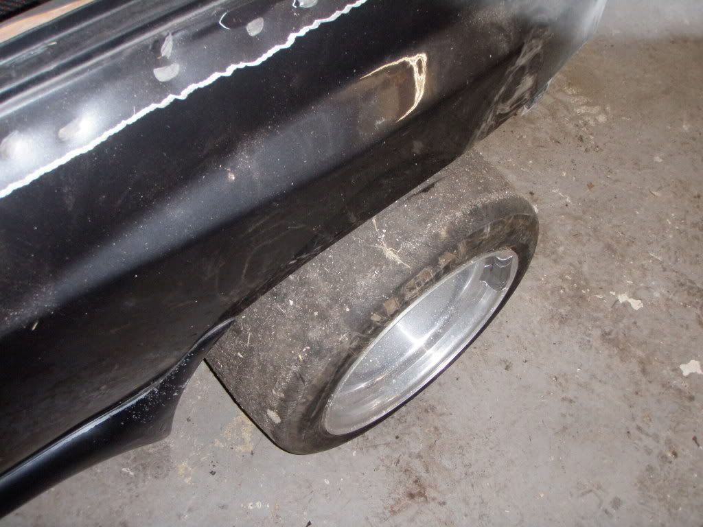

Trial fitted the rear wheels today on a spare Nova race shell (wide-arched) that I have, and it's clear they are going to be too wide. I thought they would be at 8" and with a lot of offset;
http://i285.photobucket.com/albums/l...pscbehlspz.jpg
http://i285.photobucket.com/albums/l...psitia64pg.jpg
http://i285.photobucket.com/albums/l...ps9xwpbxjt.jpg
Can you not just go extra wide arches? Red shell looks cool.
Ah ok and i always keep my eyes open on what you're selling.
Colin are you sure that the arches on Graham's car are proper wide arches ,I seem to remember them not being as wide as my standard wide arch kit
Can't you get yours measured ,it would give you a better idea on wether they will fit ,from the pics I think it will be tight tbh
I wondered where Graham's Nova had gone.. now I know... His "wide body" isn't as wide as some of the rally-x kits, and no where near as wide as I'm planning for one of my future projects.
The wheels - did they come from Col Rooney?
