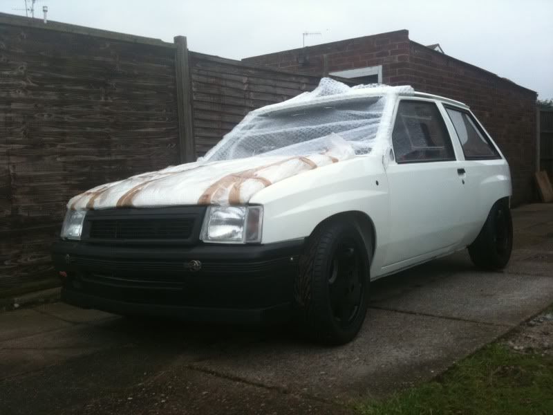

Car ready and waiting for a trailer ride

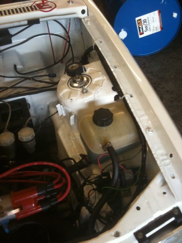

Got all the coil wiring sorted thanks to the pics from corsakid. Had a spark straight away. So much appreciated mate :d

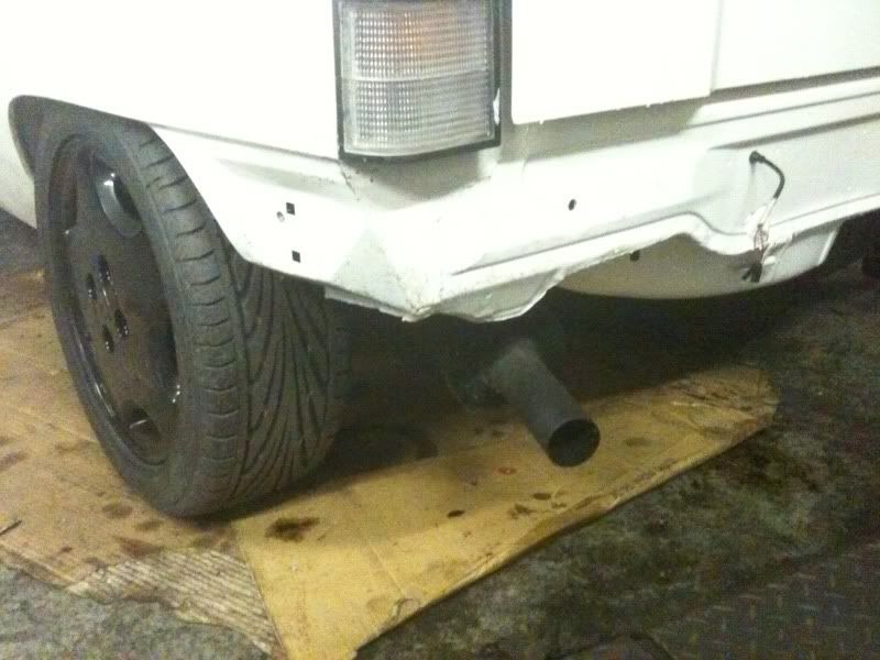

Got the exhaust system on

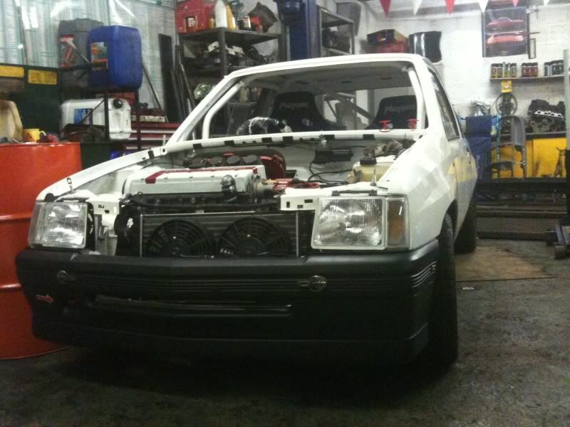

Added a fan switch into the rad aswell as the manual switch I already have

Got the carbs all fastened on and connected up with throttle cable and fuel line & air filter etc...
http://img.photobucket.com/albums/v3...a/IMG_0844.jpg
Got the coolant system filled up, and engine filled with oil
http://img.photobucket.com/albums/v3...a/IMG_0834.jpg
Then we bit the bullet and went for a start-up! was pretty nervous but went well really, got oil pressure whilst cranking, and as soon as the fuel made its way to the carbs it burst into life, how happy am I about that! :d

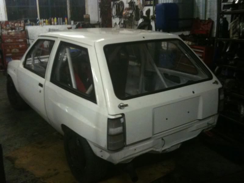

Couple of pic of how the car looks at the mo
http://img.photobucket.com/albums/v3...a/IMG_0843.jpg
http://img.photobucket.com/albums/v3...a/IMG_0842.jpg
