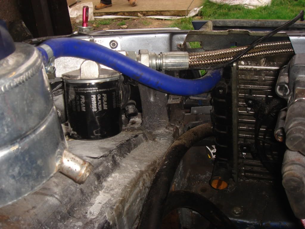

Got the remote oil filter mounted a while ago.
http://i761.photobucket.com/albums/x...0/DSC04006.jpg
Easy filter change aswell.

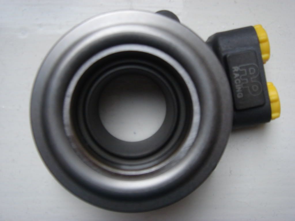

I also started with fitting the hydraulic bearing from AP. fresh out the box
http://i761.photobucket.com/albums/x...aringfront.jpg

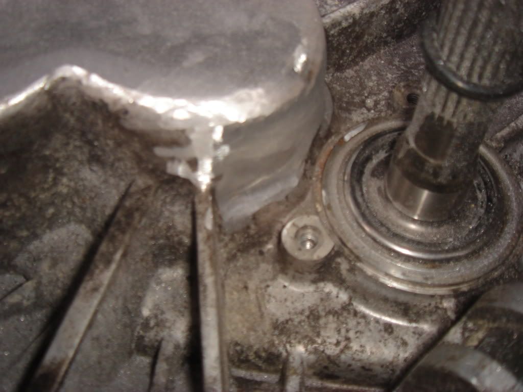

We trial fitted it in the box but it was catching the casing so I have to file some of the casting away
http://i761.photobucket.com/albums/x...0/DSC03999.jpg

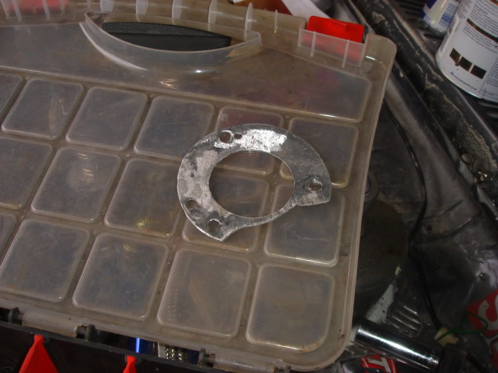

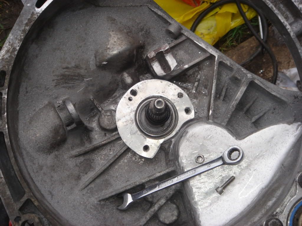

Also cause the bearing is for a saab box fitment we could only get one of the holes lined up, so we made a plate from 1.6mm alloy plate.
http://i761.photobucket.com/albums/x...0/DSC04000.jpg

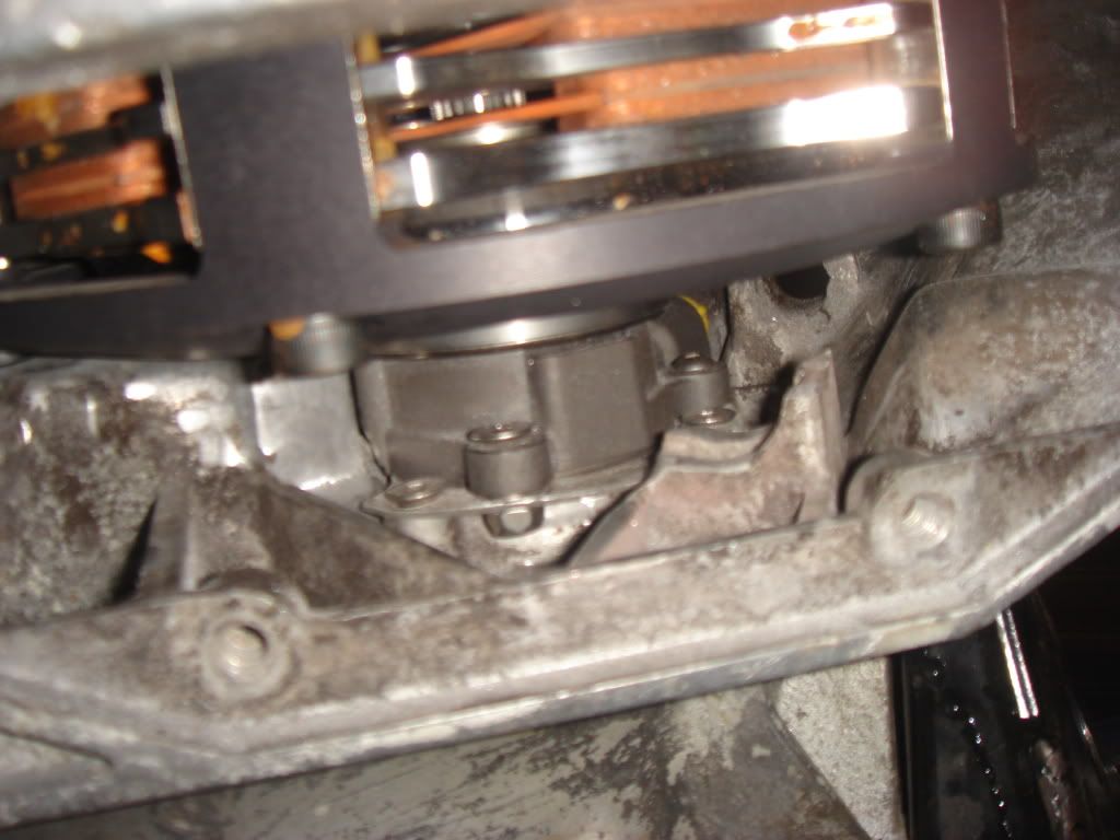

Fitted in the box
http://i761.photobucket.com/albums/x...0/DSC04002.jpg
we found the easiest way to fit the two items together first then to fix it to the box, the only real issue that i came across was on one of the bolt holes i could only fit an M5 bolt not M6 :(
http://i761.photobucket.com/albums/x...0/DSC04003.jpg

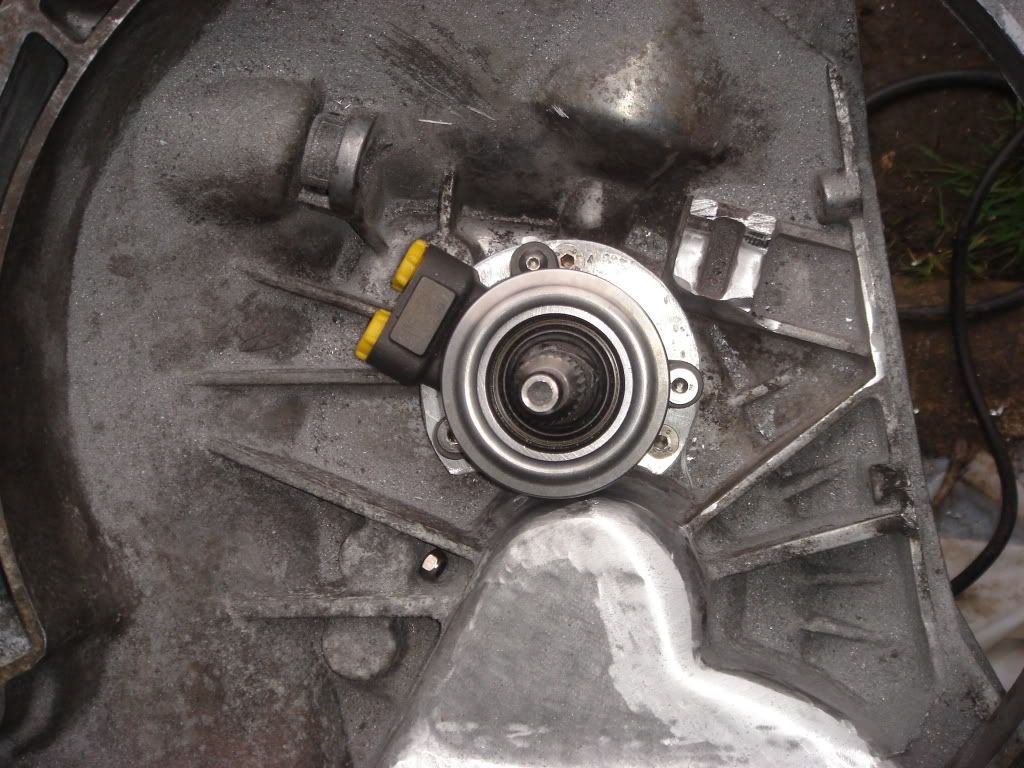

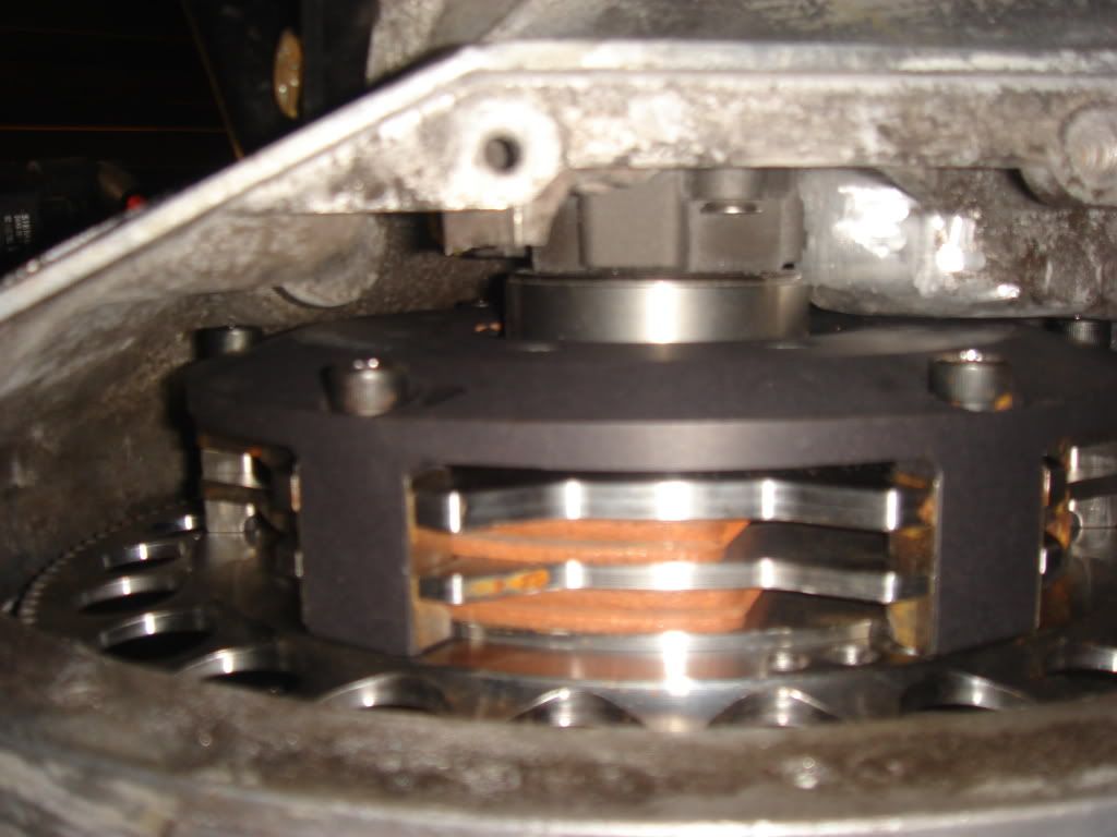

We refitted the box and found we have a success. the bearing sits away freely and the clutch doesnt catch

http://i761.photobucket.com/albums/x...0/DSC04012.jpg
I just need to remove the box and tidy the area i have filed down, also make a slight channel cause the bolts that hold the clutch on are close to the casing.
Also get a input shaft seal to suit and it offically hyraulic clutch.
