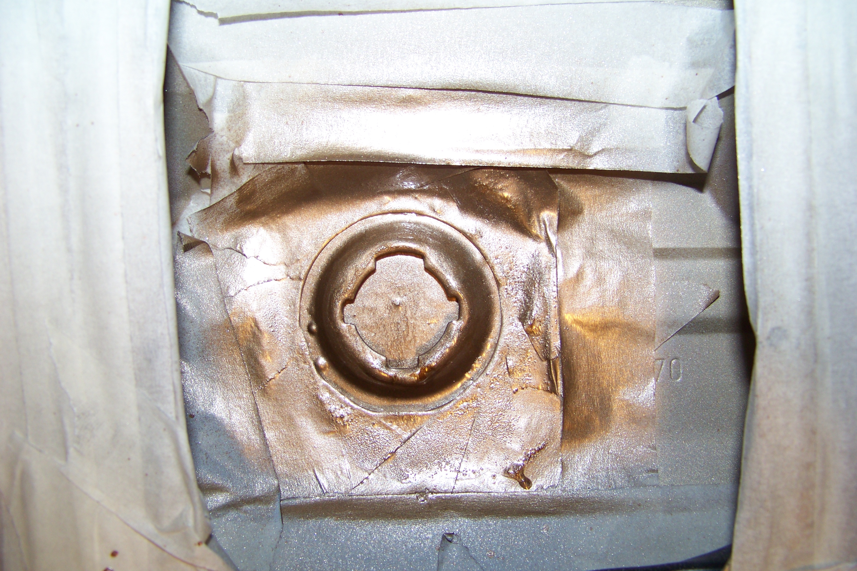

Day off today, so after many hours of running around tryna get stuff sorted I had a couple free hours to try get some work done. I thought I'd crack on with the boot lid ex-lock hole. It needed to be sorted to protect it against rust and as far as the boot goes everything is order so I can just get that out the way.

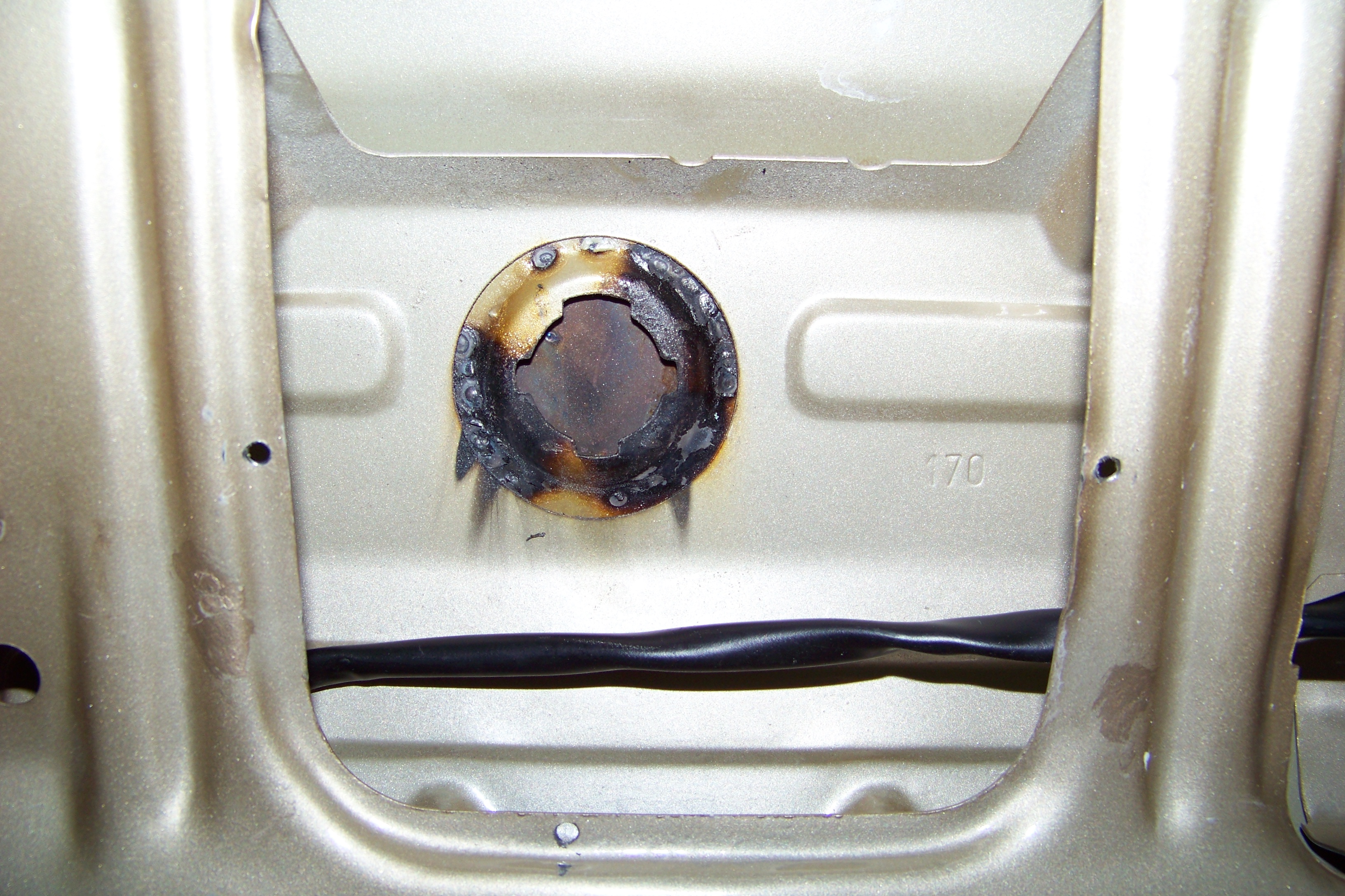

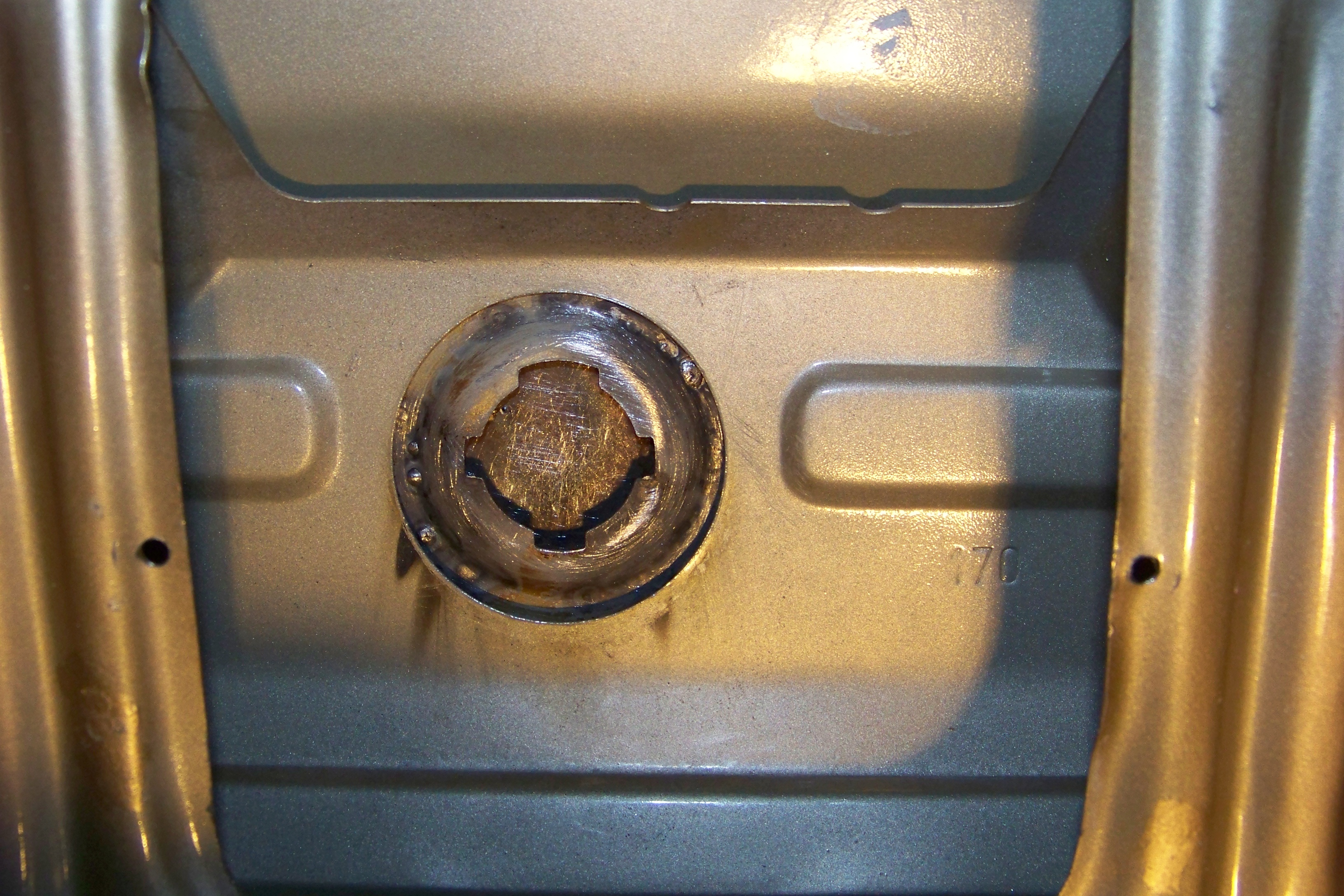

I removed the boot popper out the way (which works absolute wonders) and got to the offending bit. Here's what it looked like:
https://images2.imgbox.com/aa/b7/7paErnZg_o.jpg

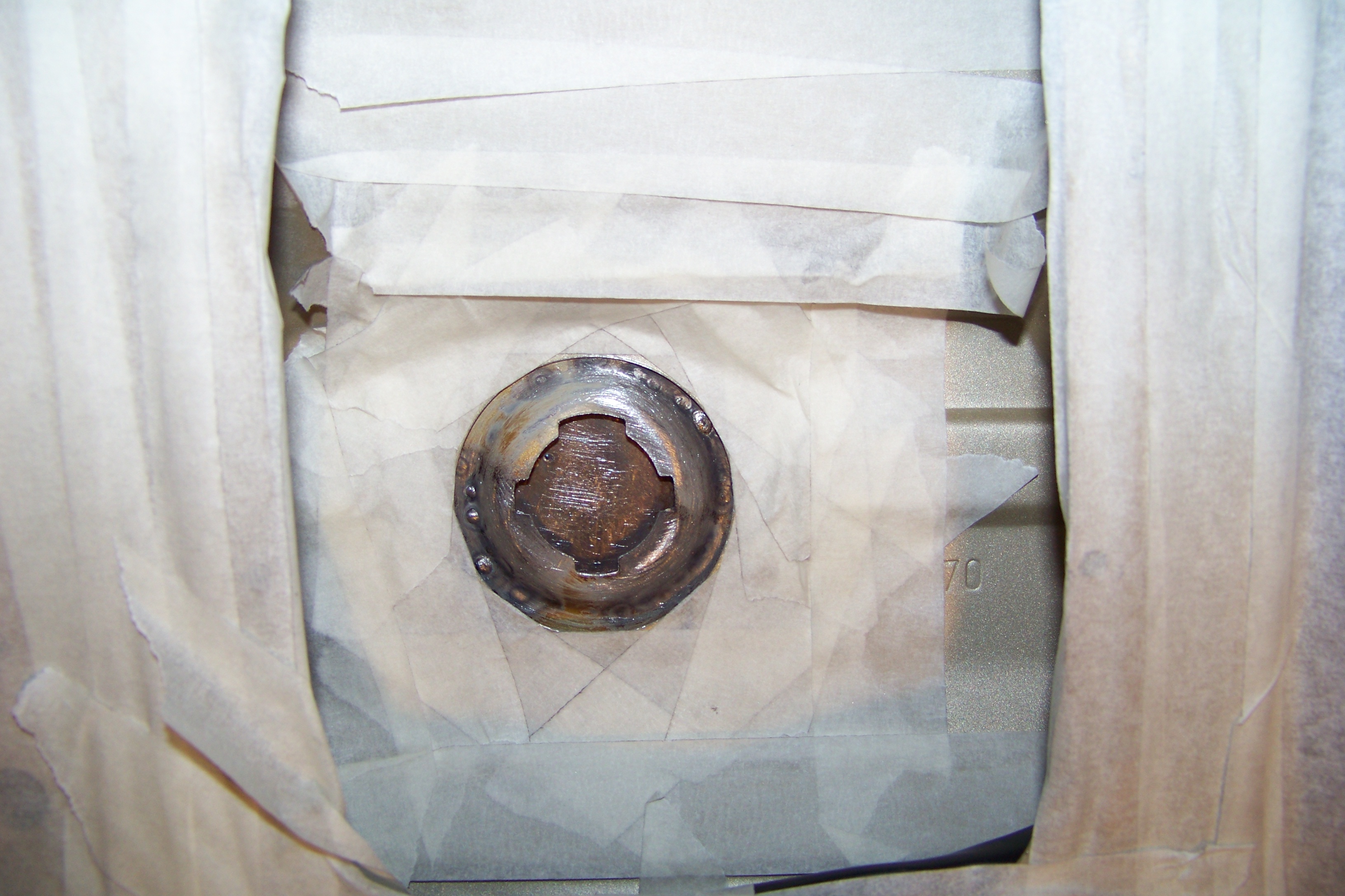

Some rubbing down with emery cloth to get the flakey stuff off got it to this point (was tough rubbing down the bit in the middle, ended up with grazed fingers )
https://images2.imgbox.com/61/4d/T28STaev_o.jpg
Masked up the local area
https://images2.imgbox.com/9b/dc/lhroe4mk_o.jpg

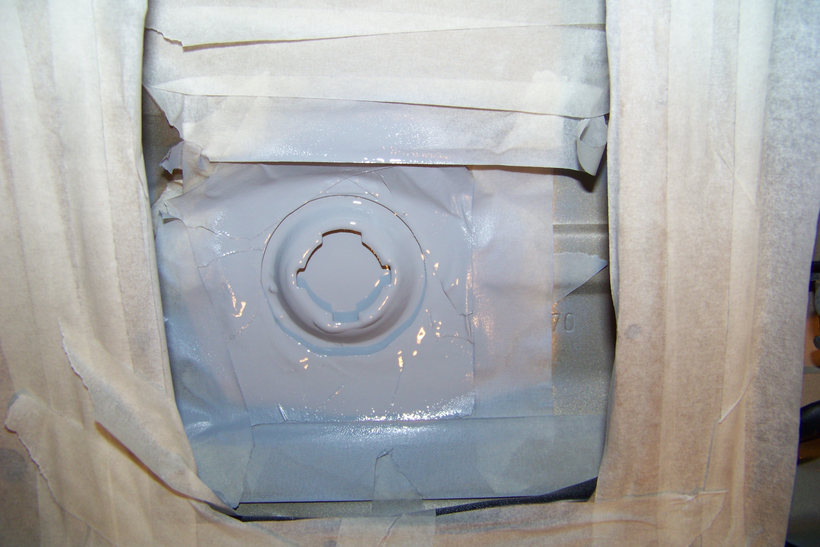

Blew away all the dust and debris from the rubbing down, gave it a wipe with solvents and proceeded to give it a couple coats of etch primer. (A bit runny oops!)
https://images2.imgbox.com/f7/94/KD0Uvt8o_o.jpg
I then raided the paints cupboard and found some gold hammerite. I have no idea how long it's been there for but I thought I'd use it... wasn't the best idea as it looked a bit weird when spraying! Very runny, the colour wasn't very consistent. I shook the can for what seemed like ages but no change, the nozzle must have been semi-blocked as it was spitting a lot too. Could've been the fact that the garage was also cold or just all those things combining together to make a rubbish coat. Luckily it's in a position that will not be seen at all so I gave it a extra coat and left it to dry. Not the best finish I know but not too bothered about it tbh:
https://images2.imgbox.com/78/fa/lsWmmSdx_o.jpg

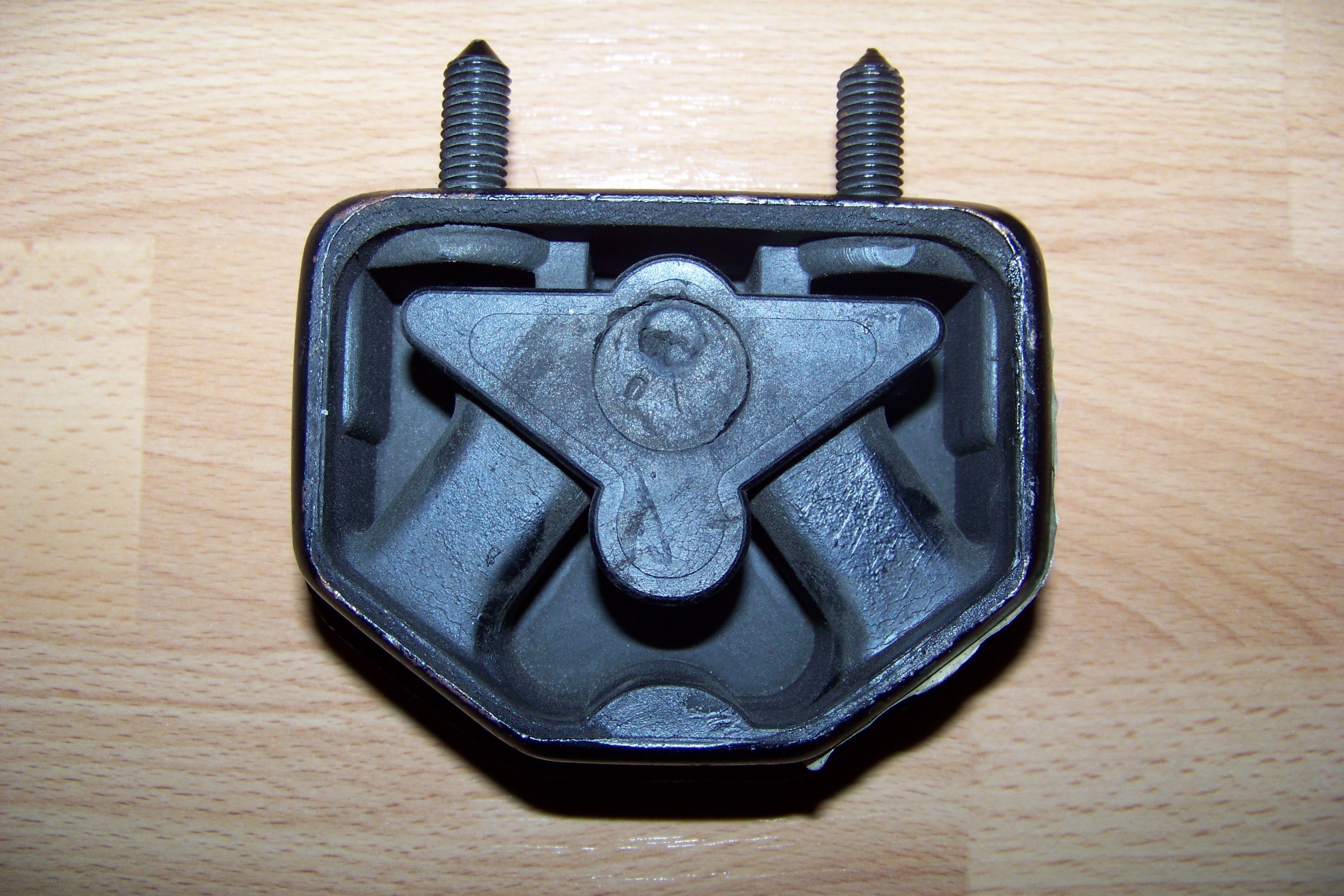

Had a day off yesterday so managed to fit in a bit of time to go look for a engine mount. Took the advise of a few people on here and popped into EuroCarParts. Finally they had a part which they actually did... O/S engine mount for £10.44 - Quality looks good can't complain to be honest.
https://images2.imgbox.com/1c/84/YDfJAa9Z_o.jpg

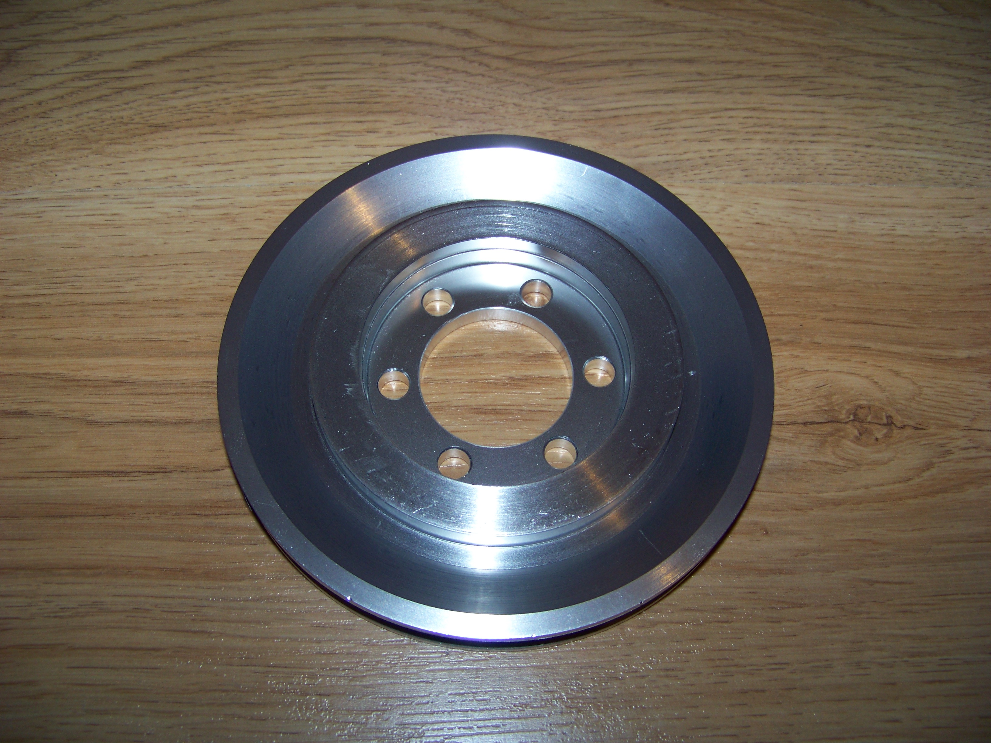

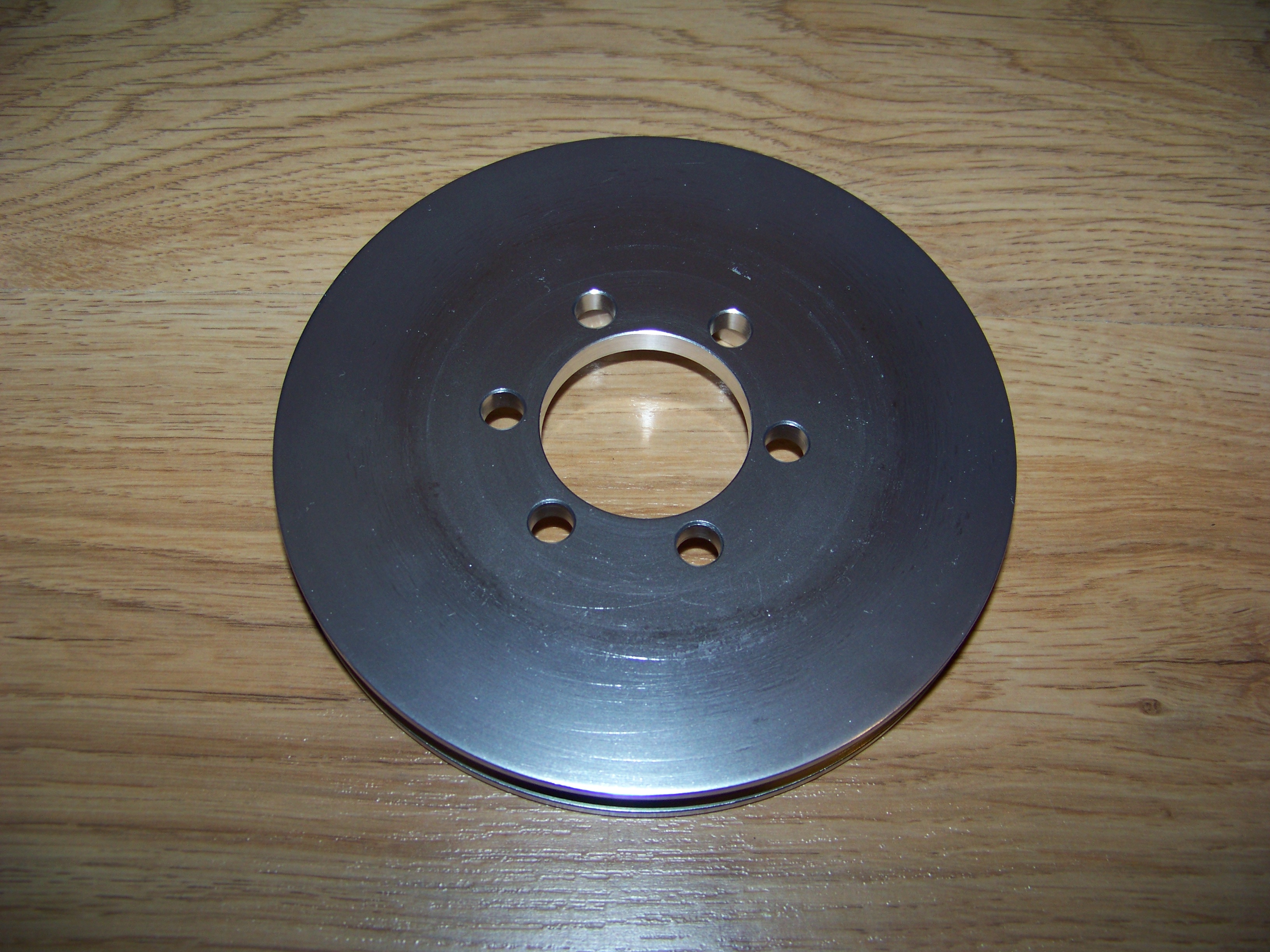

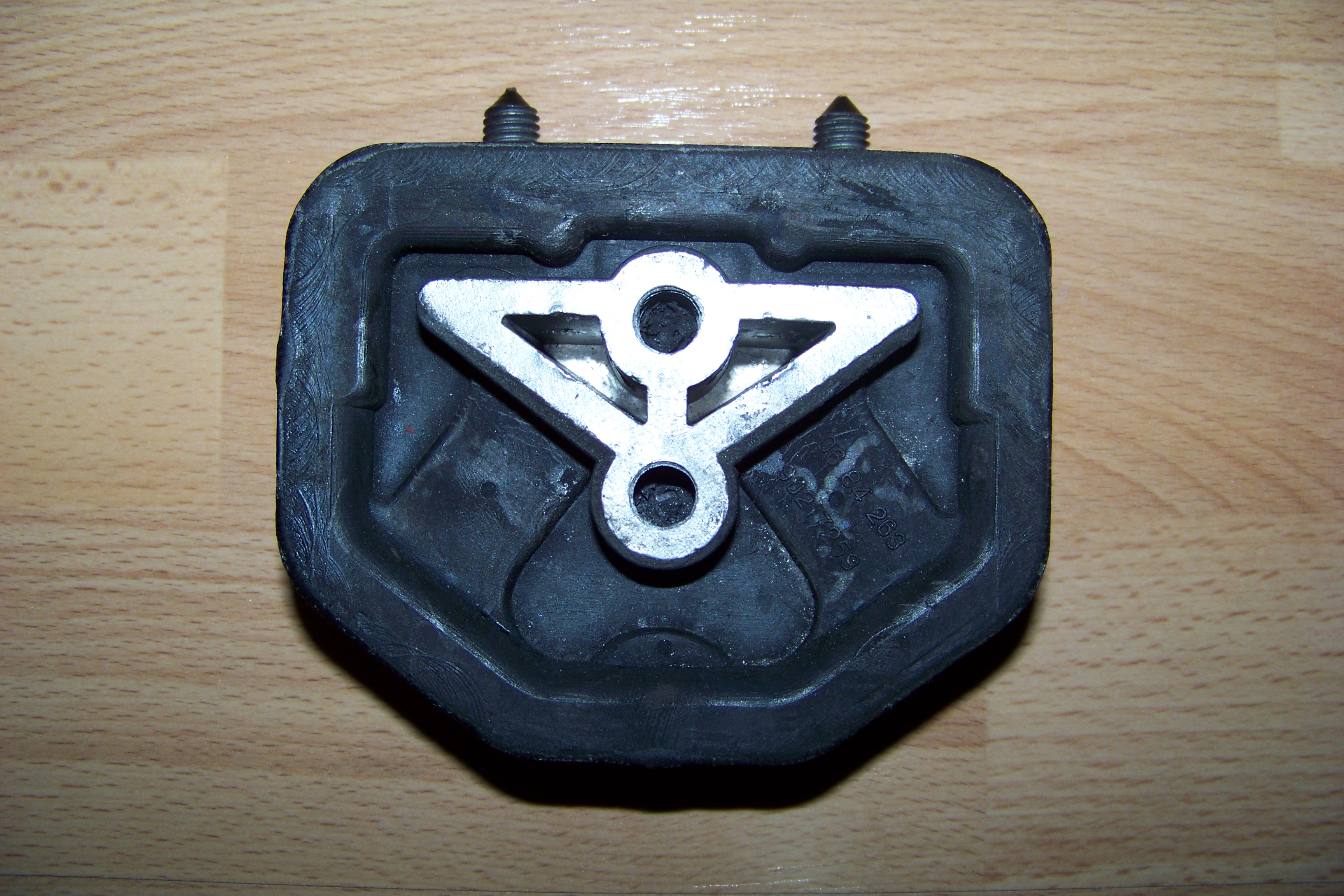

Another part added to the parts bin. I bought it on Thursday night, off eBay, and it arrived Saturday morning. At first it didn't occur to me what it was as the box was light, but when I opened the box I saw this
https://images2.imgbox.com/b7/8c/1HeQOSFX_o.jpg
https://images2.imgbox.com/cd/4b/FmhICzqx_o.jpg
