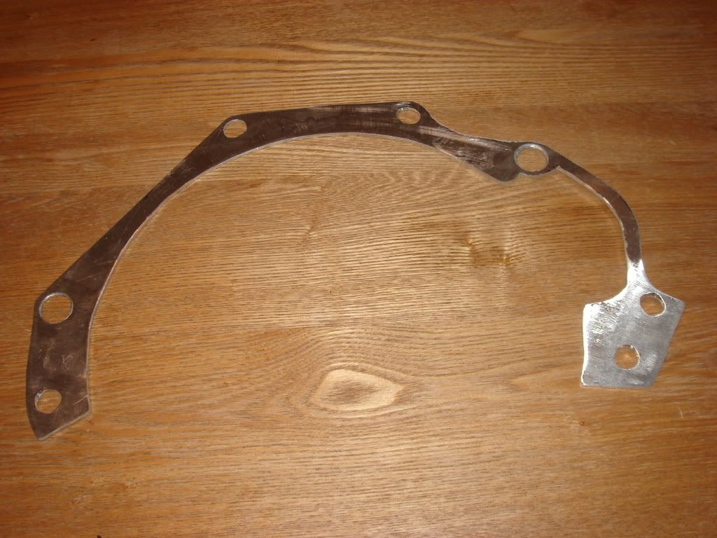

Well we decided to play nice tonight seeing as there was some sun. We made this alloy spacer to see if it would come out ok.
This was the end result.
http://i761.photobucket.com/albums/x...0/DSC03843.jpg
Not bad really as we knocked it up quickly and came out better than expected
Cheers
I got the spacer trial fitted last night and it seems to be a winner all the holes line up correctly the sits nice and the spacer doesn’t protrude the casing either inside or outside of the box so you cant even tell its there. I did some proper measuring as well seeing as I treated myself to a new vernier (B&Q tape measures aint all they used to be), I found that the input shaft does slide all the way through the collar of the rear clutch plate but only just. and I have a clearance of 0.9mm from the box to the clutch face im going to clean the box face back with the power file a touch more just to get at least 1mm's clearance.
And it leaves 45mm to fit the hydraulic bearing in place just got to do the PCD of the F20's turret mounts to see which bearing is the correct fit.
Cheers Gareth.
Lucky sod! though i would want least 2mm clearance, just encase there was for some reason any movement/wobble, not that there should, just i wouldn't want something to move slightly and it end in tears etc..
I know you mean Scott I can probs get that much with a skim off the box lol
