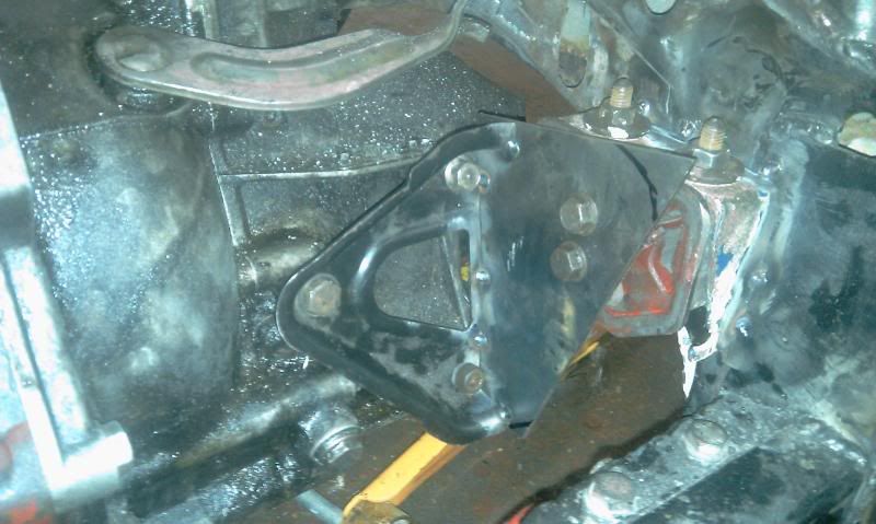

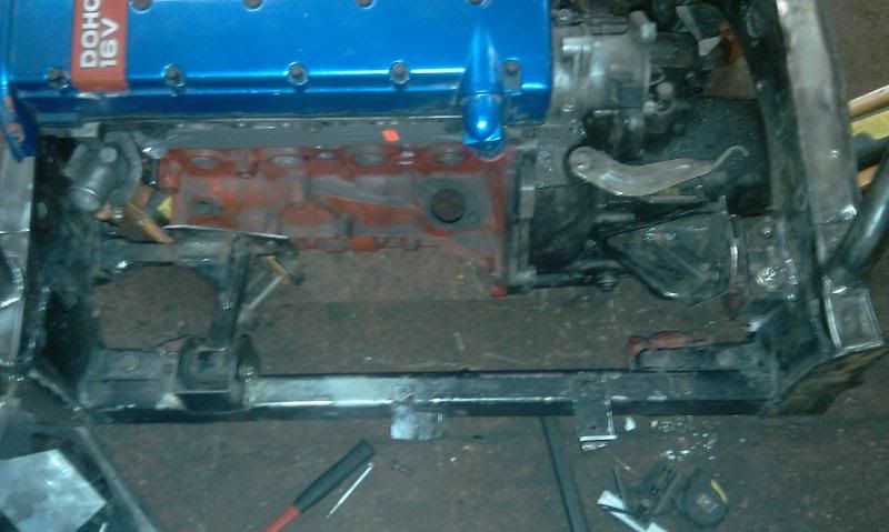

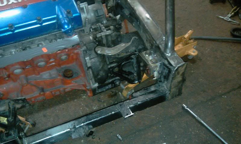

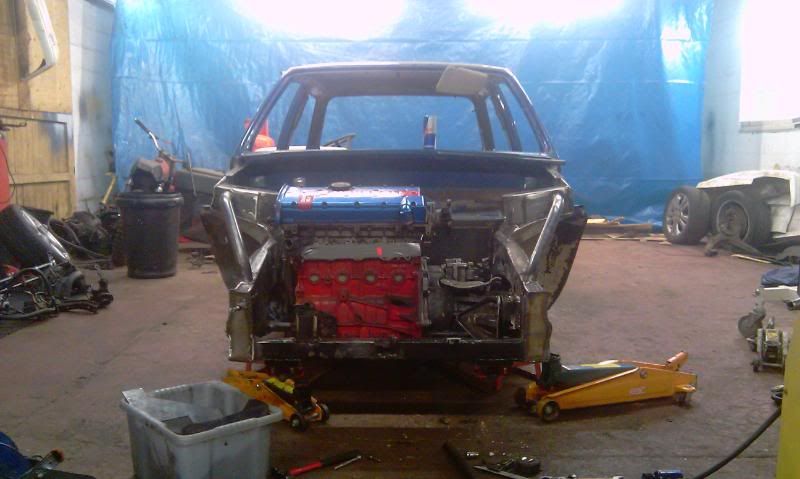

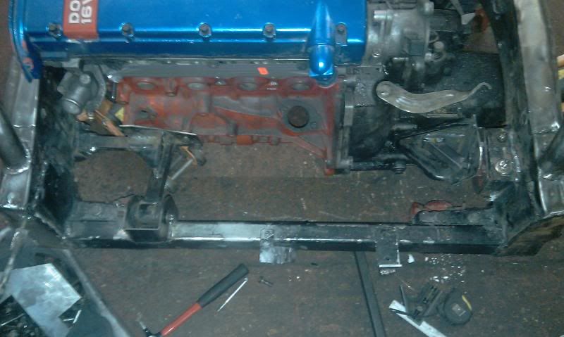

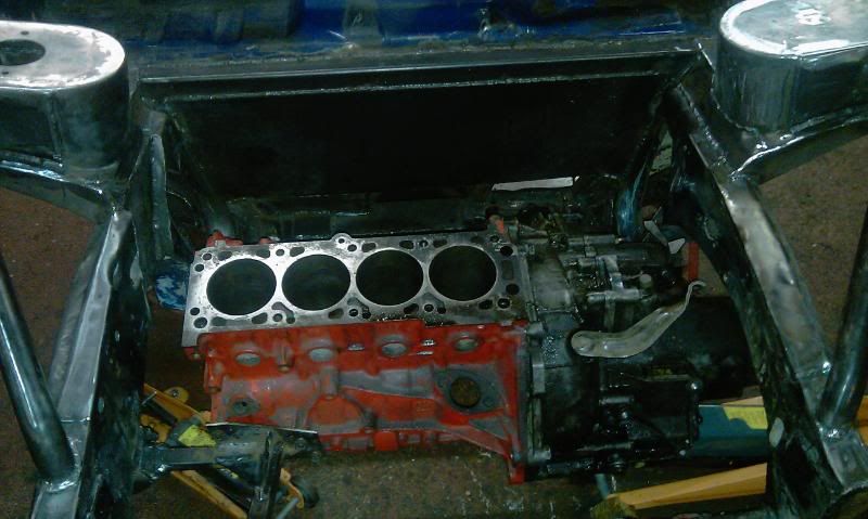

finished the mounts the other week but just remembered i never posted the pics lol so this will bring you up to date
block in place as you can see if you look at the pic you can see the block is perfectly inline and level with the chassis legs
http://img.photobucket.com/albums/v6...g?t=1288877752

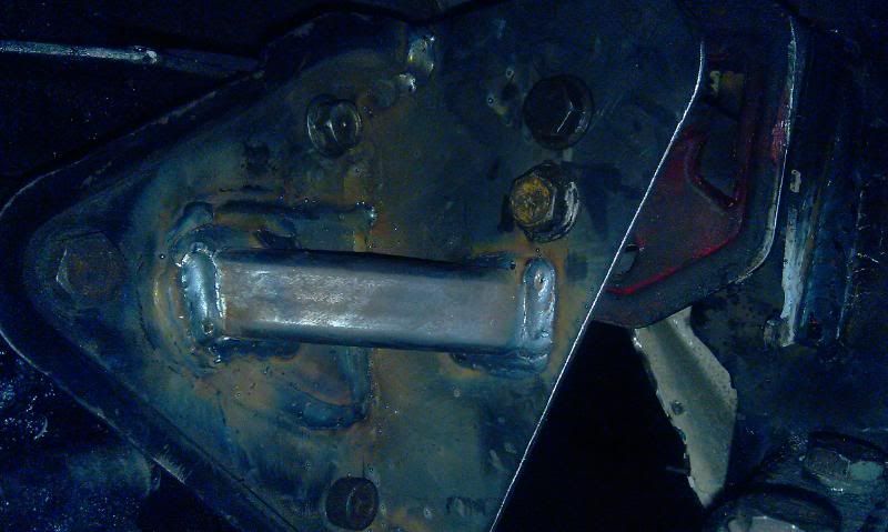

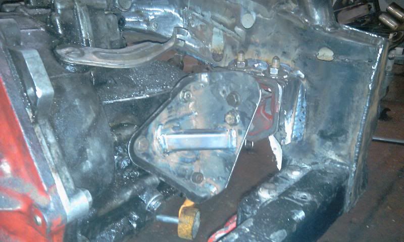

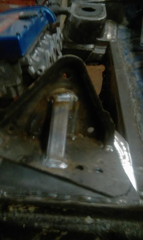

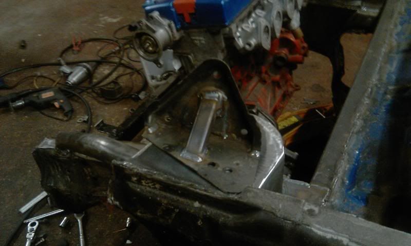

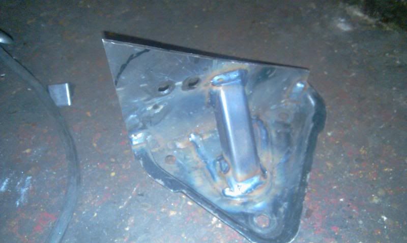

new f28 mount tacked up and in place

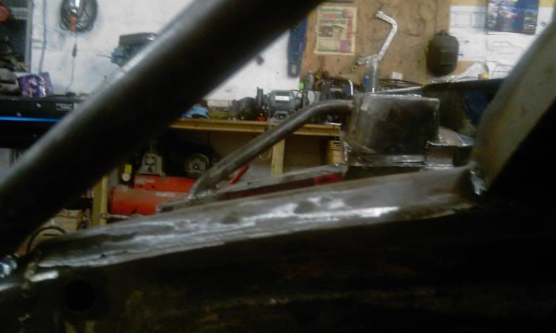

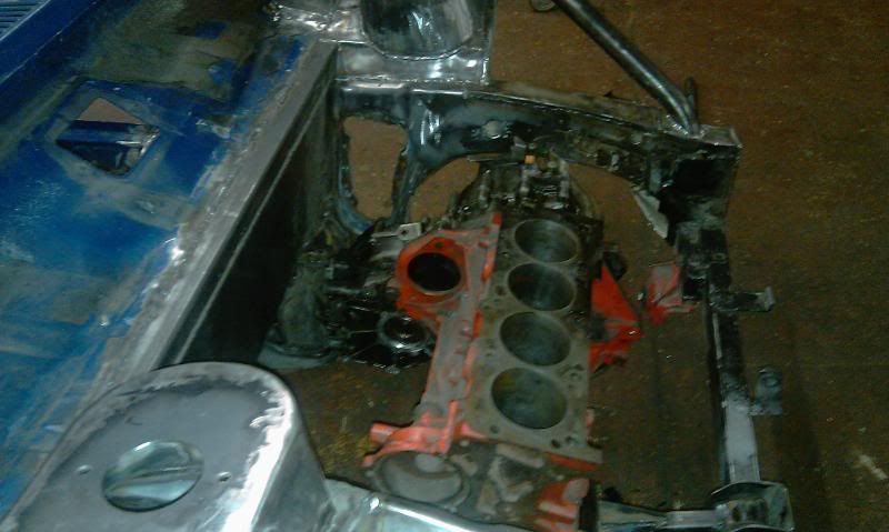

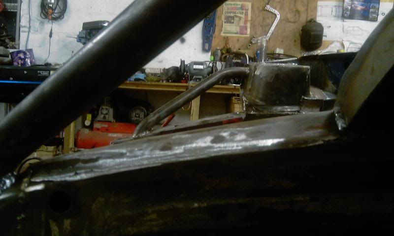

http://img.photobucket.com/albums/v6...g?t=1288877933
and thats up to date mounts done just got a staibaliser rod to sort out for the back of the head to the top of the bulk head to sort and thats the mounts done
