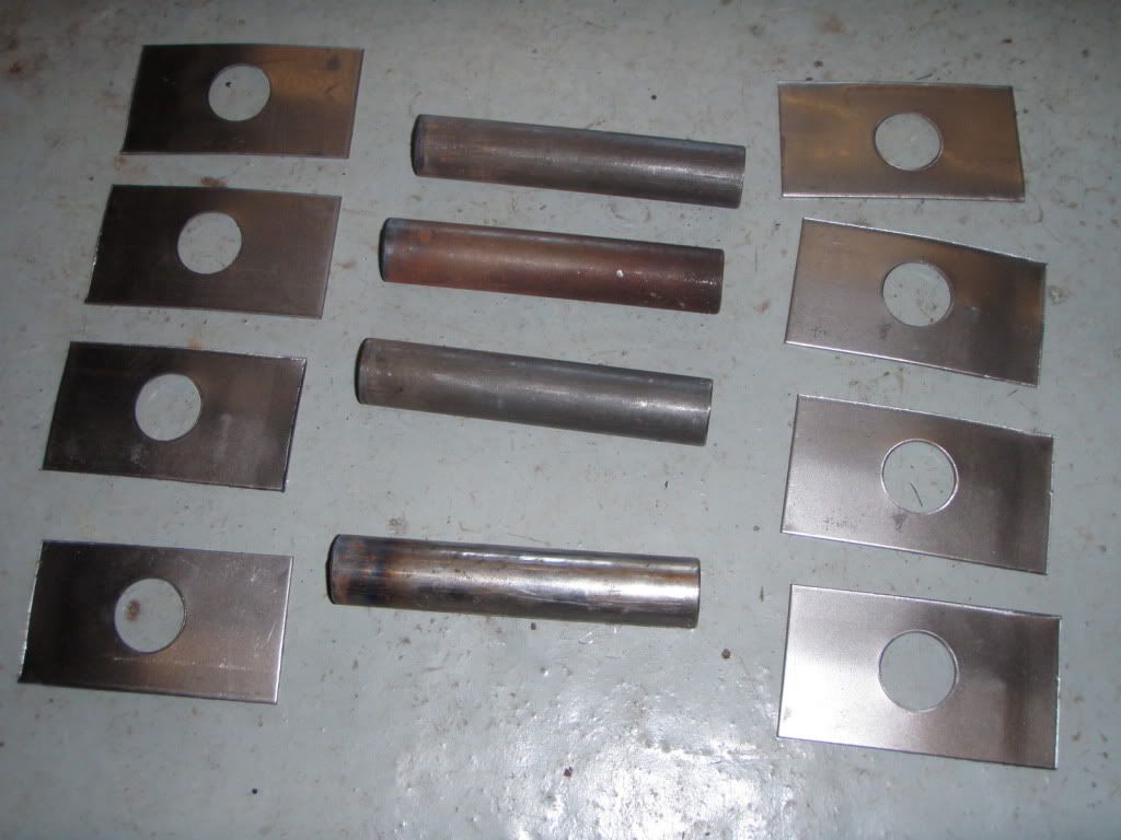

If anyone fancies fitting a set of tubes into their sills, I have a complete set of tubes (20mm diameter) together with the strengthening plates for sale;
http://i285.photobucket.com/albums/l...ort/002-27.jpg
The tubes are already capped off at one end so no need to worry about water/dirt ingress into the car.
