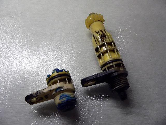

oh - had to lose speedo aswell, so will be looking how other plate diff users have made a speedo up, due to not having a an open cog in the speedo drive hole! any idas?

Magnetic pickup sensor and wheel mounted on the cv joint could work for speedo.
Thats what Will F and Dan use/used iirc.
Needs an expensive elec speedo cash tho.

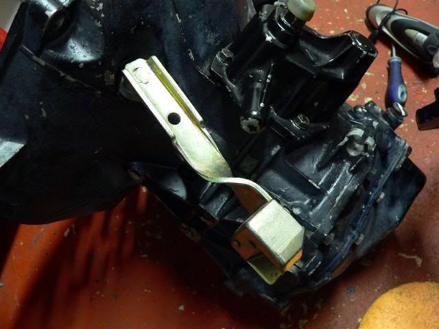

beefed up clutch arm
http://i136.photobucket.com/albums/q...ure/nc0458.jpg

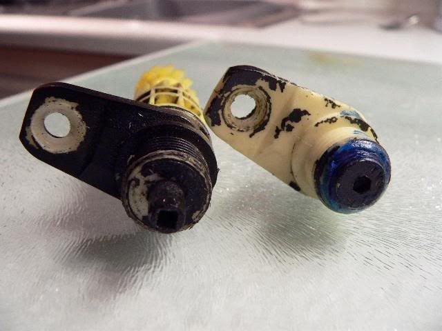

Speedo drive cut and sealed due to plate diff
http://i136.photobucket.com/albums/q...ure/nc0459.jpg
http://i136.photobucket.com/albums/q...ure/nc0460.jpg

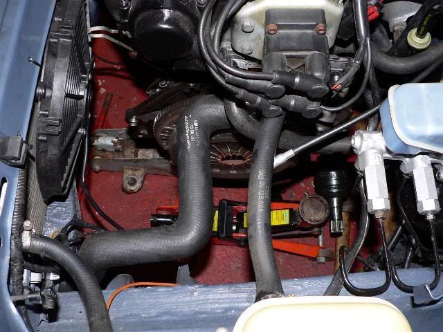

Box out, waiting for new one on
http://i136.photobucket.com/albums/q...ure/nc0457.jpg

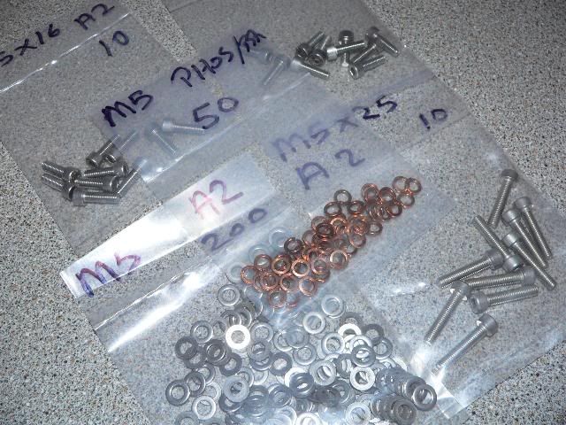

Got nuts and bolts today for throttlebody setup
http://i136.photobucket.com/albums/q...ure/nc0452.jpg

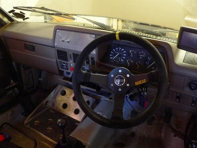

Made a little plate over stereo hole for fuel pump switches, and others that I might use in the future (possibly fan etc)
http://i136.photobucket.com/albums/q...ure/nc0453.jpg

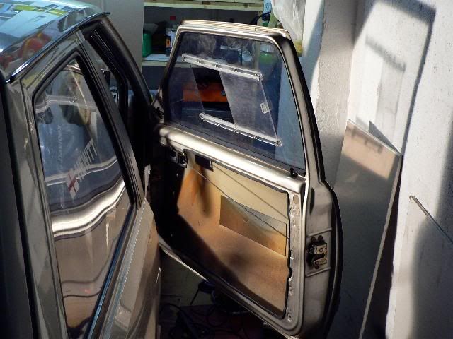

Stripped down the polycarbs and gave them a clean up due to them being weathered etc... on with fitting them, and gutting out the door innards
http://i136.photobucket.com/albums/q...ure/nc0454.jpg
Put rubber edging around (cheers for the link Dar) to save any mishaps on sharp edges
http://i136.photobucket.com/albums/q...ure/nc0456.jpg

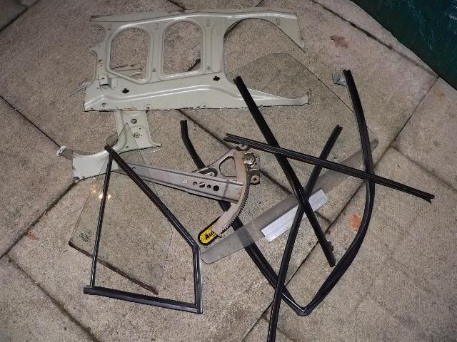

Here is one doors worth of junk
http://i136.photobucket.com/albums/q...ure/nc0455.jpg
The weight of both front glass windows, glass quarter windows, rubbers, winder mechanisms and excess metal that was removed was 11.7kgs
The weight of 2x front polycarbs with sliders, and rubbers is 3.4kgs
Saving 8.3kgs just from the fronts alone
Plus the rear quarters glass was 4.3kgs, polycarbs were 1.7kgs pair
Plus rear window glas was 4.6kgs, polycarb equivilant was 1.9kgs
For those interested lol total weight saving from glass to polycarbs and gutting front door innards is: 13.6kgs total.

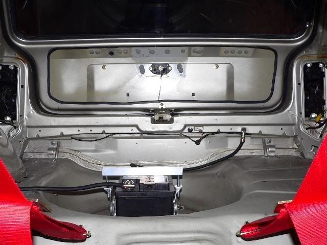

Gut out the tailgate same as I did the doors, and ran edging strip around
http://i136.photobucket.com/albums/q...ure/nc0461.jpg

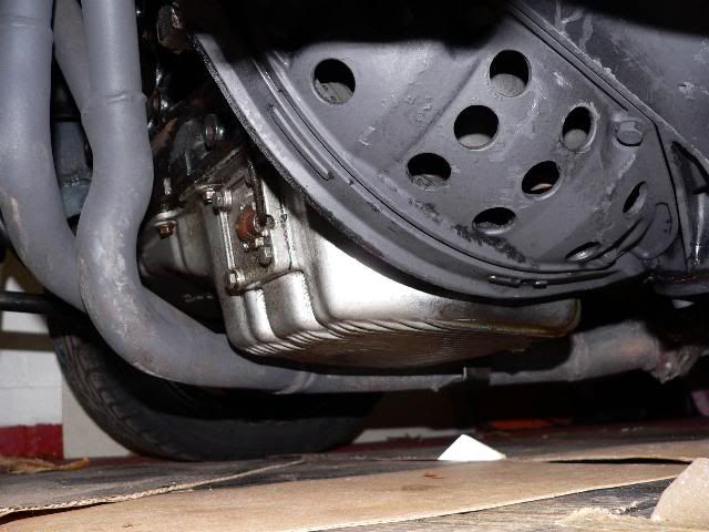

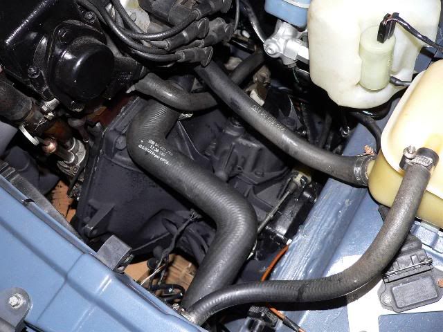

Pics of the new gearbox in situ
http://i136.photobucket.com/albums/q...ure/nc0463.jpg
Got a very very slight gearbox oil leak from the passenger driveshaft (probably seal), about a teaspoons worth over 2 nights, nothing drastic!
http://i136.photobucket.com/albums/q...ure/nc0464.jpg

Just need to find a new way of holding the polycarbs "up" in the door, as they rattle loose and slide down over a while

Ol you see where the rubber runs along the bottom of the window,on the lip of the glass opening,could you not get some sort of a strip of alloy, or maybe a "U" shape channel alloy and fix it upside down to the window and the alloy then mounts onto to that lip of the opening, it's hard to explain how i mean, i just have an idea as we have this alloy split battern stuff at work and think it would work a treat!Quote:

Check my WIP Olly, theres a beter way to fit the front polys, theres also a part number and supplier for the rubber you need too.
EDIT.. Erm, I would change your clutch inspection plate before going to donny. One trip in the gravel and the your clutch is gonna get lunched!
Hes been told;) and actually has the rubber already. Can you remember the exact ammount to cut off? Or even better the height the window needs to be?Quote:

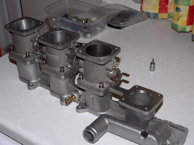

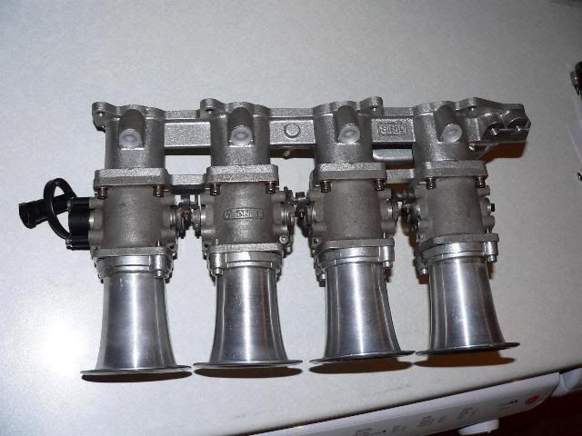

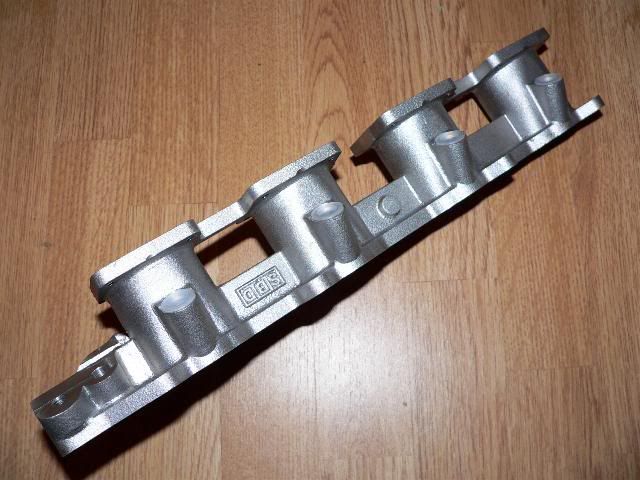

Got my new manifold from the chap I bought the TB's from
http://i136.photobucket.com/albums/q...ure/nc0465.jpg

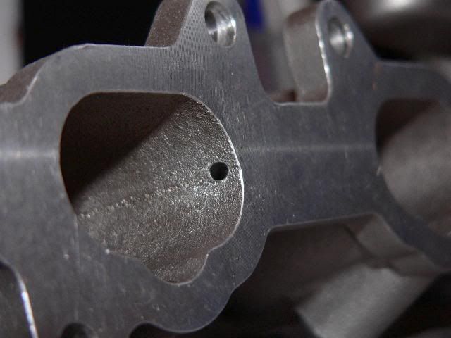

Took it straight around to Wilcox Competition Engines to have servo return drilled and tapped into it, and 2x 1/8th holes drilled in diagonally to create airways between cylinders 2 and 3 to prevent pulsating
http://i136.photobucket.com/albums/q...ure/nc0467.jpg

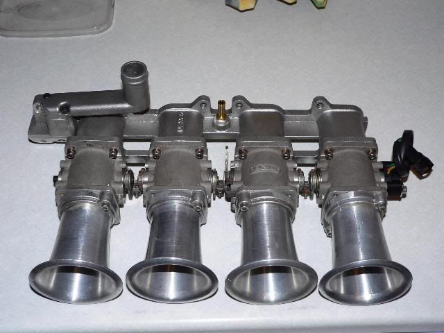

Building bodies onto manifold
http://i136.photobucket.com/albums/q...ure/nc0468.jpg

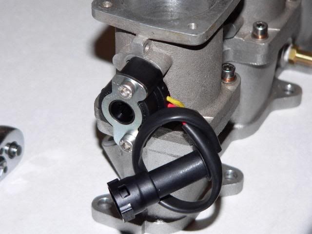

TPS added
http://i136.photobucket.com/albums/q...ure/nc0469.jpg

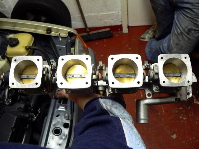

All on, with 90mm trumpets, still awaiting backing plate and filter
http://i136.photobucket.com/albums/q...ure/nc0470.jpg
Top side (using current injectors, so they're not on yet, as i'll swap them over)
http://i136.photobucket.com/albums/q...ure/nc0471.jpg
Gave them a blasting with brake cleaner, all cleaned up now
http://i136.photobucket.com/albums/q...ure/nc0473.jpg

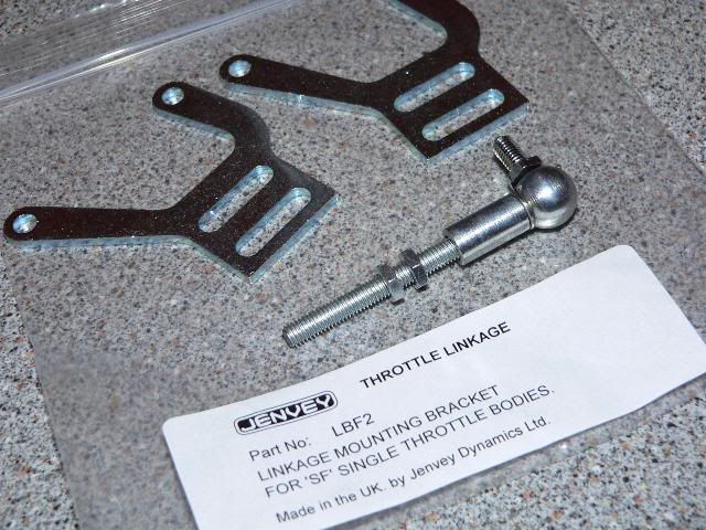

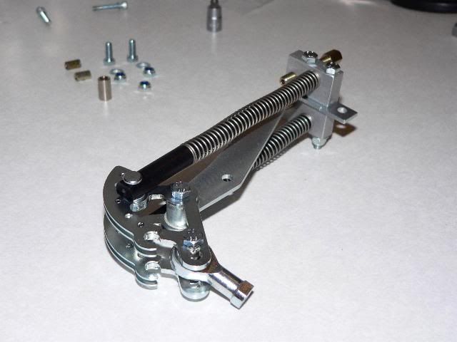

Got this rather expensive Jenvey throttle linkage in with the sale so thought it'd be best to make use of it, took ages to build up - bloody fiddly thing!
http://i136.photobucket.com/albums/q...ure/nc0472.jpg
Ordered my underslung linkage mount too, so the throttle linkage won't be seen at all, just the way I like it
http://i136.photobucket.com/albums/q...ure/nc0474.jpg

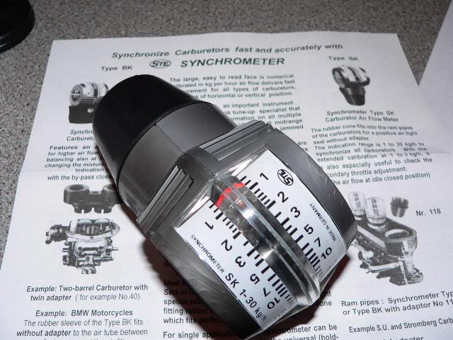

My synchrometer arrived ready for installation
http://i136.photobucket.com/albums/q...ure/nc0475.jpg

Ol the underslung linkages are a **** to put together, lol so many small bits. and the bracket had me miffed for a bit, i recon although its alot for what it is its worth it.
