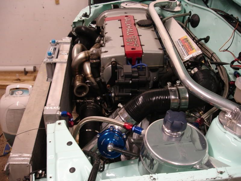

hi matt how much did it set you back to have the bottom end bored out mate

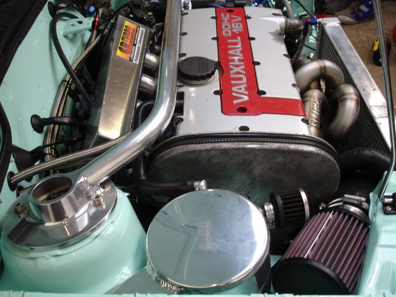

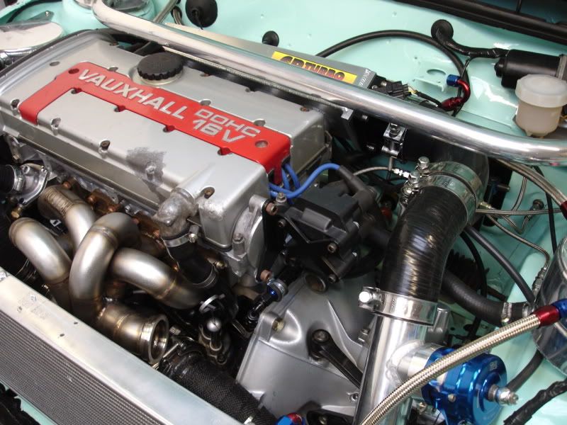

I've a feeling that inlet is going to get sucked inwards.
Which inlet? Air filter to turbo or the plenium?Quote:
hello, i cant remember exactly but i think it was roughly 200 to have the block skimmed, bored and honed and the crank polished and balancedQuote:
Originally Posted by hartley
if you mean the silicone hose to the turbo then i think they will be fine as there 4 ply and tough as hellQuote:

havnt updated in a while but this is how it stands at the moment, need to get some better pics up of progress etc

Looks mighty impressive!
as it got boost?
Schweeeeeeet :d
When was this last taxed on the road then?
Christ an update!........... Looks epic mate. :)
That is looking good.
awesome car

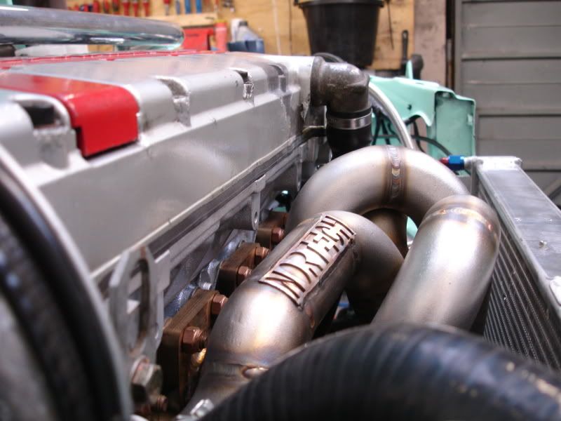

manifold is very close to the rad, are you doing something about that or leaving it as it is?

mieran, rad aint as close as it looks in that pic so should be ok id say

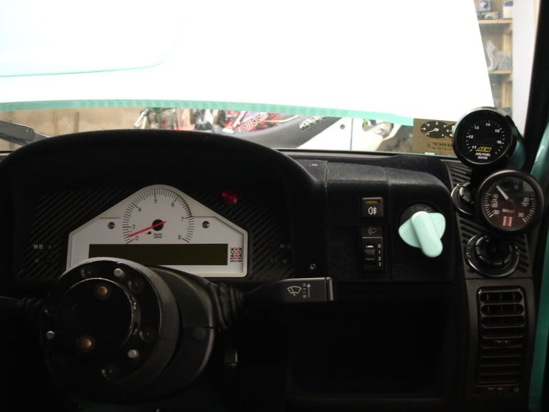

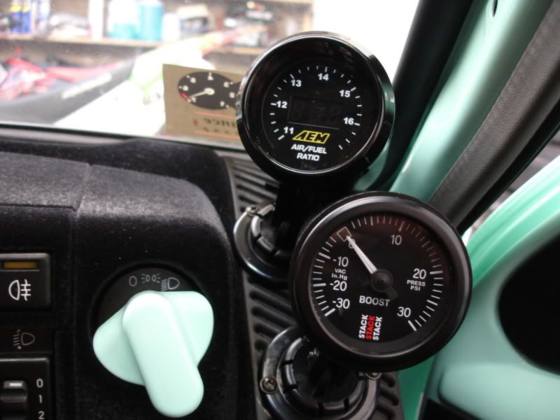

got the gauges mounted and wired in etc, didnt want to go screwing gauge holders onto the flock so this was the only other place, i think they look ok
http://i127.photobucket.com/albums/p...w172/017-5.jpg
http://i127.photobucket.com/albums/p...w172/018-6.jpg

clearence between rad and manifold
http://i127.photobucket.com/albums/p...172/007-21.jpg

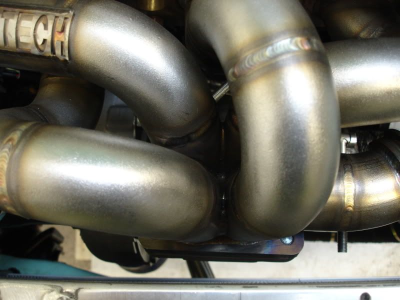

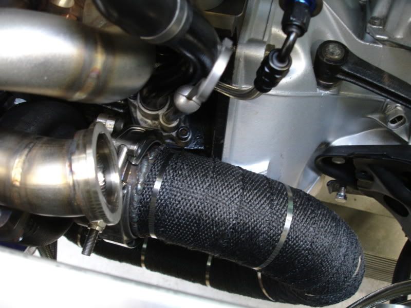

downpipe finished and wrapped
http://i127.photobucket.com/albums/p...172/009-15.jpg

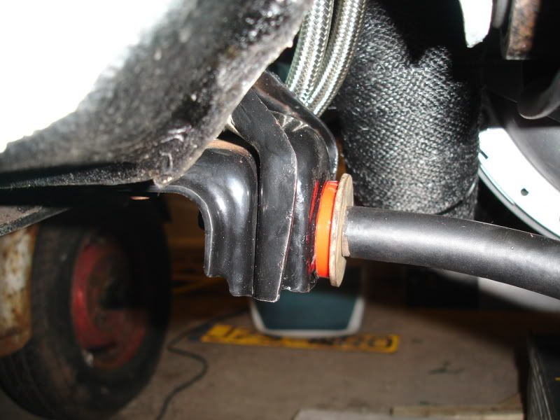

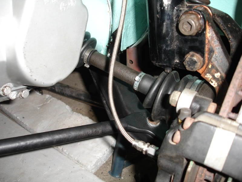

ive also got all running gear back on, brakes are bled up and shafts are in.
decided to go with stock tie bar brackets with poly bushes as i didnt like the look of the rose jointed ones that were on it previously that had been made up using the stock brackets, i did buy a set of rose jointed lowered brackets from protec but they were total trash so i sent them back

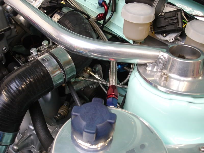

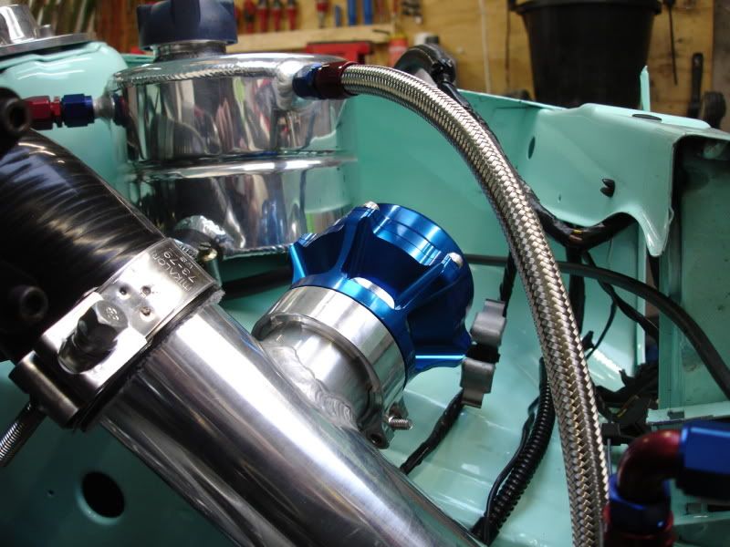

Who modified your header tank Matt for twin inlet & threaded them for Goodridge hose?

You can buy alloy theaded outlets and have them tig welded to your header tank - I have seen the outlets on ebayQuote:
Originally Posted by MARTIN KELSON
If your struggling to find a decent TIG welder - I have a man who can :thumb:
Quick search found these
http://cgi.ebay.co.uk/AN6-6-6AN-JIC-...item4cf4ed9843

i got mine from speedflow as i did with most of my fittings etc heres the linkQuote:
Originally Posted by fearless
http://www.speedflowshop.co.uk/-6-ma...9-06-896-p.asp

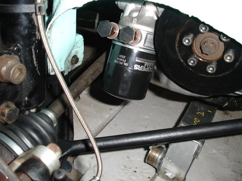

shafts in and running gear all bolted up
http://i127.photobucket.com/albums/p...172/006-32.jpg
http://i127.photobucket.com/albums/p...172/007-22.jpg
poly bushed stock tie bar brackets
http://i127.photobucket.com/albums/p...172/005-29.jpg
Have you thought about modifying the tie bar brackets yourself to lower them?
