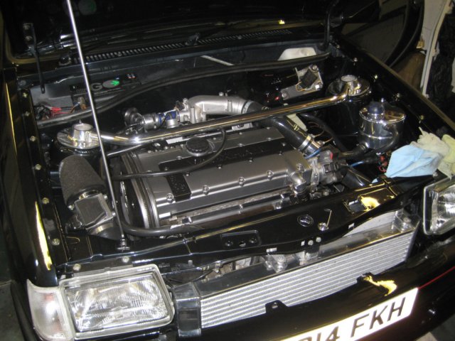

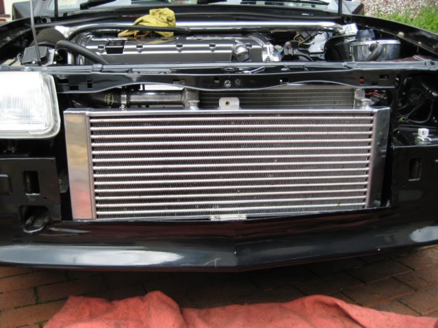

While the car was off the road last winter I decided to modify it slightly, so I set about stripping down the front end again as we needed to re-weld the turbo pipe that snapped while I was out at the ring last year.
http://www.nova-turbo.co.uk/NovaTurb...9/img_3912.jpg
http://www.nova-turbo.co.uk/NovaTurb...9/img_3916.jpg
I also cleaned up the thermostat/housing and painted it up and replaced the seals as this had been leaking for a while.
http://www.nova-turbo.co.uk/NovaTurb...9/img_3994.jpg
While it was in bits I decided to send the injectors off to be cleaned and refitted these.
http://www.nova-turbo.co.uk/NovaTurb...9/img_3995.jpg
Also removed the standard fuel pressure regulator and fitted a FSE type fuel blanking/recirc plate.
http://www.nova-turbo.co.uk/NovaTurb...009/photo6.jpg
Fitted a T-Piece in the fuel line and fitted a fancy little sensor...
http://www.nova-turbo.co.uk/NovaTurb...09/photo11.jpg
Undid the wiring so that I could feed it through to the dash.
http://www.nova-turbo.co.uk/NovaTurb...09/photo13.jpg
Started to make a pod to house my new gauge.
http://www.nova-turbo.co.uk/NovaTurb...09/photo15.jpg
http://www.nova-turbo.co.uk/NovaTurb...09/photo17.jpg
http://www.nova-turbo.co.uk/NovaTurb...09/photo20.jpg
Also Rob made a fancy bracket up to hold my Weber fuel regulator in place.
http://www.nova-turbo.co.uk/NovaTurb...09/photo16.jpg
Fitted the regulator to the bulk head and plumbed it in, also drilled and tapped my enlarged top hat to fit the boost pressure sensor.
http://www.nova-turbo.co.uk/NovaTurb...09/photo23.jpg
Fitted the pod and boost/fuel pressure gauge in the centre console.
http://www.nova-turbo.co.uk/NovaTurb...09/photo26.jpg
http://www.nova-turbo.co.uk/NovaTurb...09/photo27.jpg
I also fitted a phase 3.5 ECU and power wheel, setup the fuel pressure regulator and have been running it since. Took it to the ring again in July, only issues I had was due to blowing boost pipes off the bottom of the turbo, this was easily sorted by fitting some Mikalor clamps.
Car will be cleaned up and tucked away for winter again soon, not sure on future plans for it, going to replace some of the fuel pipes and maybe the injectors, as i'm not keen on running such high fuel pressure and I will also get it setup properly at some point. The thought has crossed my mind quite a bit to sell up and do something else, as I've done what I wanted to the car. Will have to see. :)

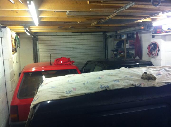

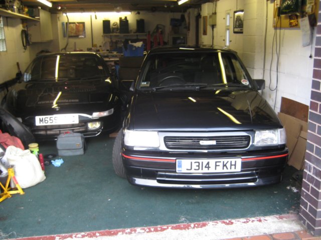

I've still got the nova, think I used it twice this year, once for the MOT and once for VBOA Billing. It's tucked up in the garage with two other cars, my new project as Scott mentioned and another fairly well known nova...
http://www.nova-turbo.co.uk/images/garage.jpg
lol that must be a very snug fit in there!
Do you leave window down to stop condensation ruining things?

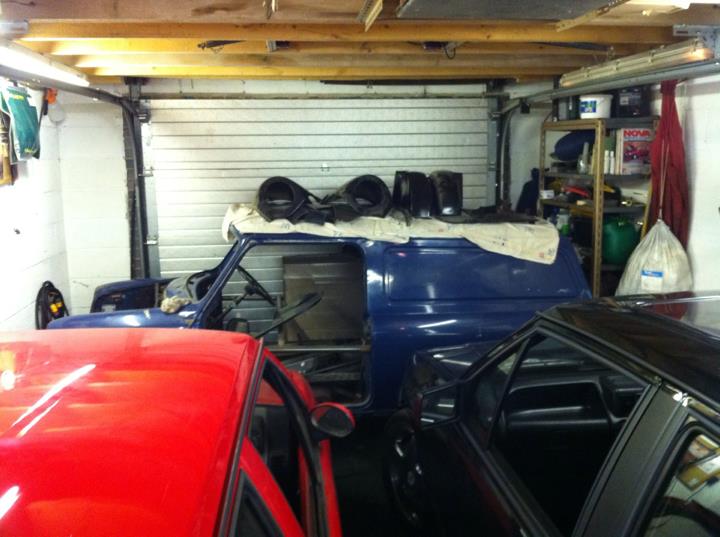

It's a bit better since I moved things around at the weekend, Nova's are right up against the front door and Mini Van is behind, with room to work on it and get to the bench. Yeah that Scott and being able to lean in when moving them about.
http://www.nova-turbo.co.uk/images/garage2.jpg

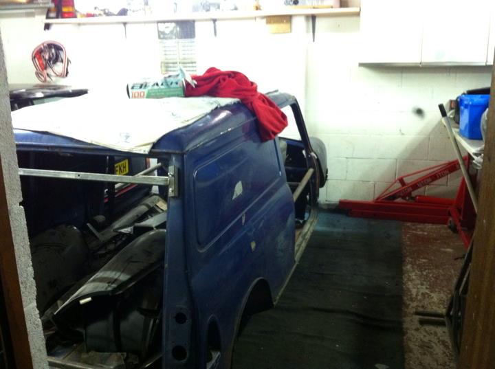

Good to see that karls old car is still about. Does he still own it? mini van will be awesome! are the braces to keep it all "straight"? :)
Yeah Karl still owns the Nova, he brought it up to Stoke a few months ago so we could get some work done on it. Braces between the door frames and a the bar across the car between them are to keep it straight. The bars on the rear door are to keep it straight and also for the spit to attach to. I brought it as a work in progress project, It's already had one side of the floor replaced, most the panels are there to get it done. Just doing lots of research and planning what to do with and what engine to put in it...

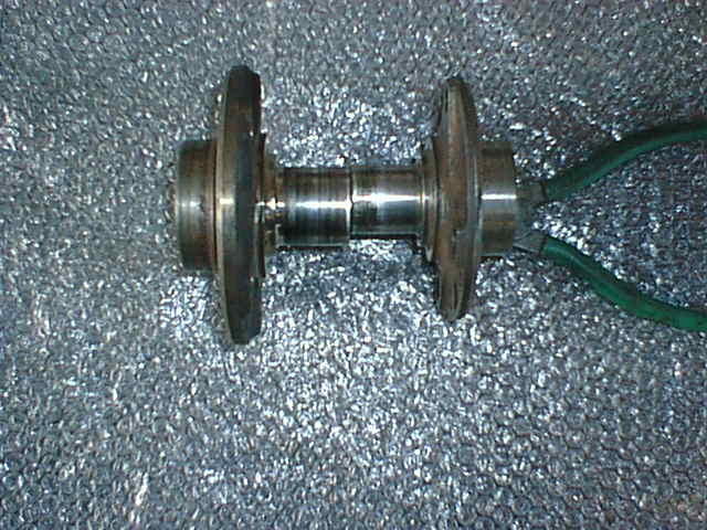

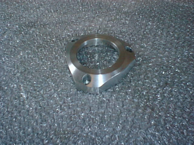

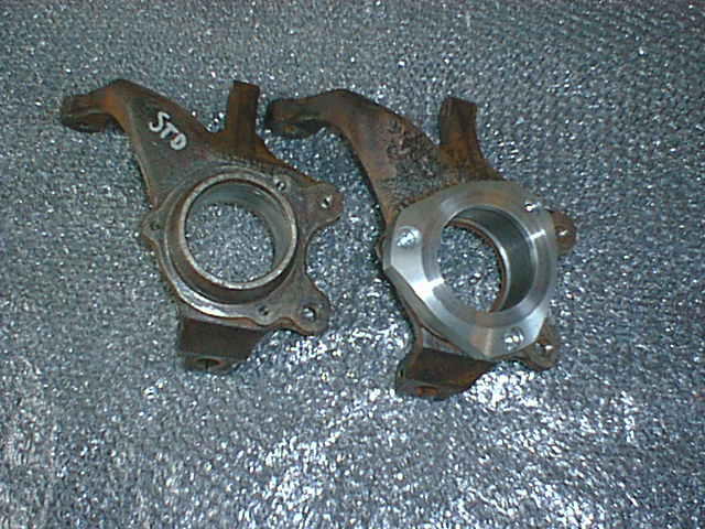

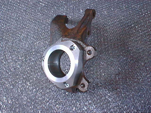

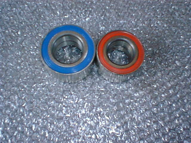

Thought i would put these picture of my hubs on here as I found them today and a few people had been asking about the setup on another thread.
http://www.nova-turbo.co.uk/hubs/hub...ckle%20mod.jpg
http://www.nova-turbo.co.uk/hubs/hub...%20cap%202.jpg
http://www.nova-turbo.co.uk/hubs/hub...ring%20cap.jpg
http://www.nova-turbo.co.uk/hubs/hub%20bearing.jpg
http://www.nova-turbo.co.uk/hubs/hubs%20flanges.jpg
